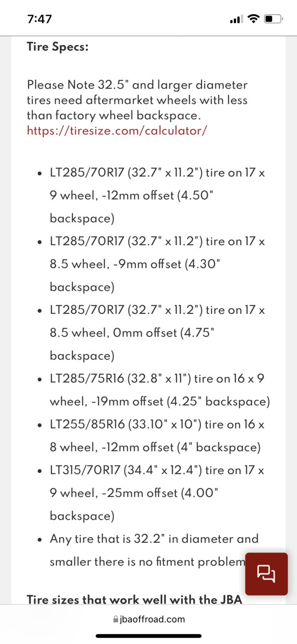

    Scroll to the bottom of the page you linked earlier. JBA specifies what size wheels and tires will work with their UCAs.
    Edit: looks like they could possibly work for you as long as you don't get larger tires.

    Are the size listed the ones that will work with the JBA UCAs? I have 17x8.5" and planning on upgrading to 285/70/17s with these springs.

    It's the backspacing that matters for clearance of these JBA UCAs, which results from the confluence of rim width and offset. Check the offset of your rim to determine if the backspacing is sufficient

    Awesome! Since mine are +0mm 17x8.5, the backspacing would be 9.5/2 = 4.75"

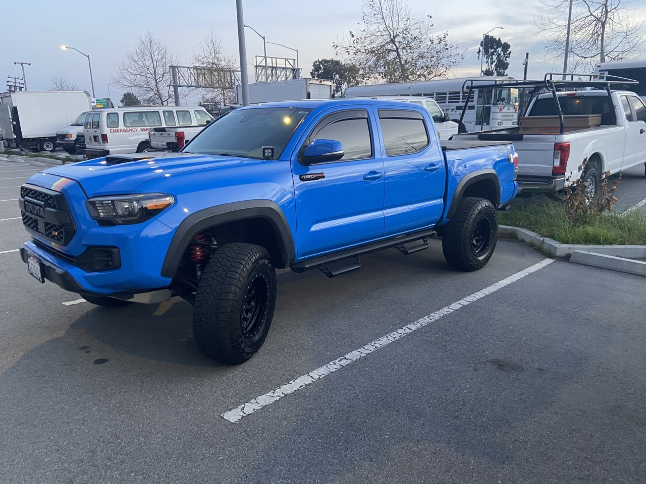

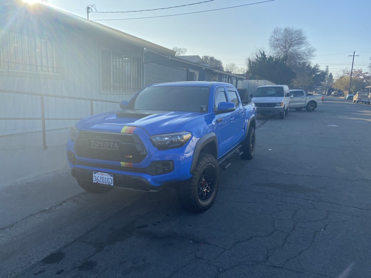

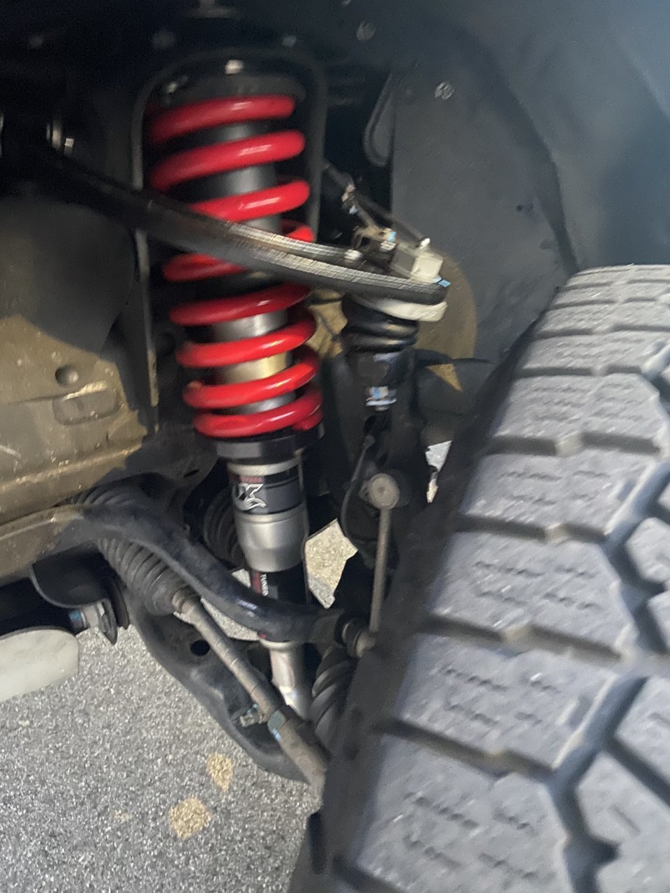

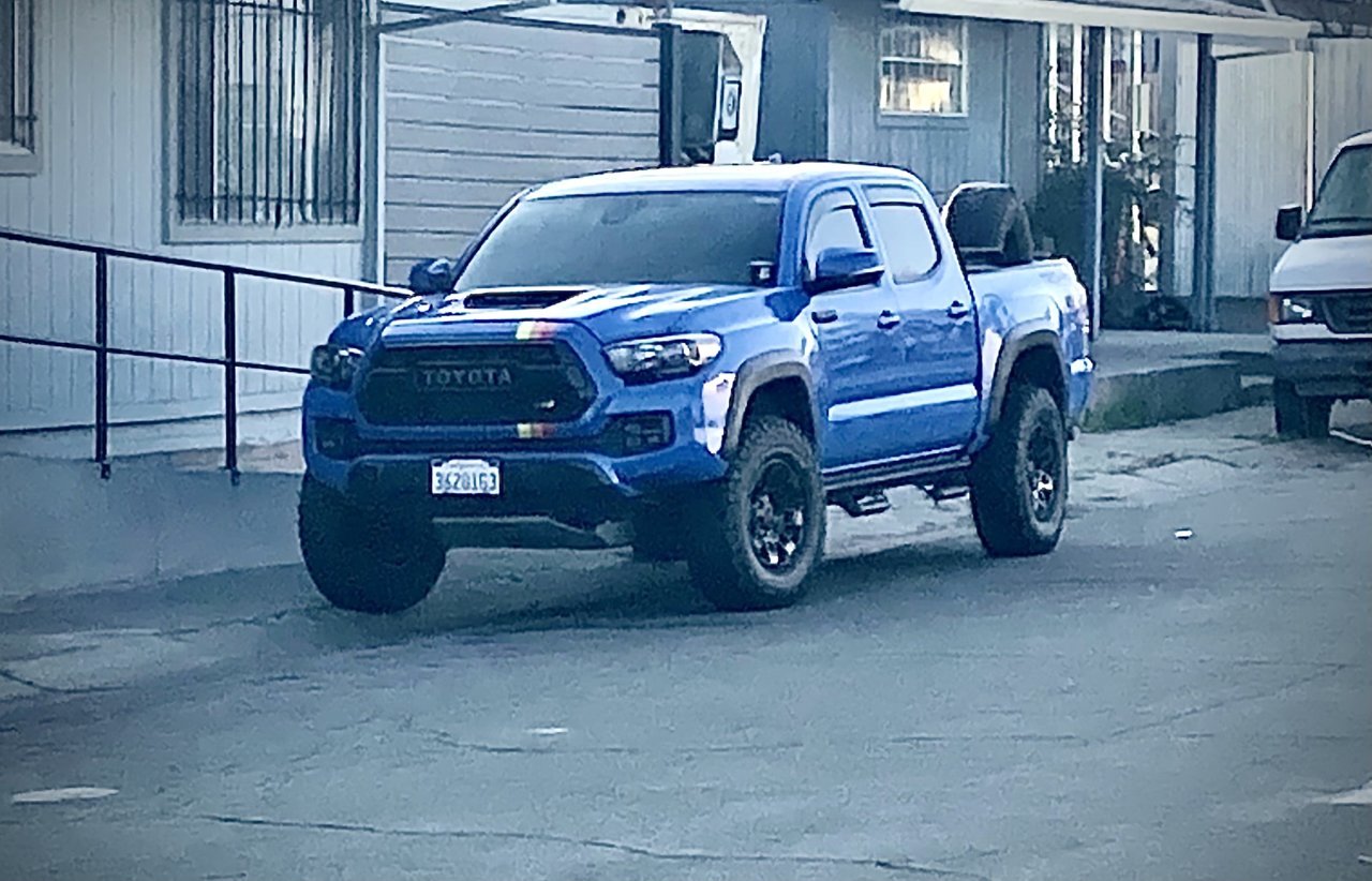

  20. Jan 30, 2022 at 2:44 AM
    #1520
    bluelinetaco
    bluelinetaco Well-Known Member
    Aug 26, 2019
    #303320
    324
    North Cali - Yay Area! (707)
    2019 TRD Pro VooDoo Blue
    COOL Stuff I can't afford . . . But I bought anyway!

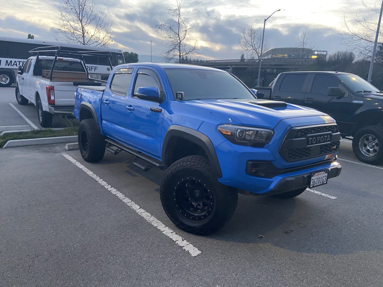

    For those wondering, I had Stellar Built Fabrications do my install in Sacramento CA. The installed the Eibach Pro springs WITH the Westcott perch lift. I cleared 34's w/ a CMR no prob. They said they'd never done the combo of the two together. So far the ride and stance is great. Firm but not harsh on the ride. Likely limited down travel, but not a huge problem for a light of roader. Combined saw +/- 3.2" front lift w/ oem bumper. Will probably settle of course.
    Eibach's w/ Wescott and SPC UCA's
    Before Lift OEM w/ Dakars in rear
    After lift w/ added 1" Eibach lift block with Dakars
