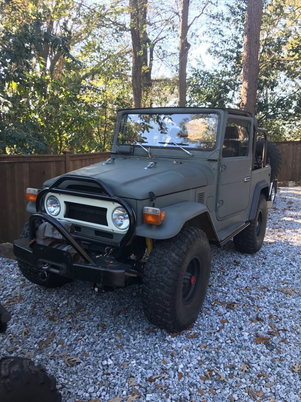

    Love the 80, one of my fav yotas I have owned. I enjoyed building and wheeling all of the LCs, bought this guy out of TN for 5800. I love this 40, just not as practical as my 80 was, but I love it.
    I have seen you on ih8mud, that’s a sweet rig.

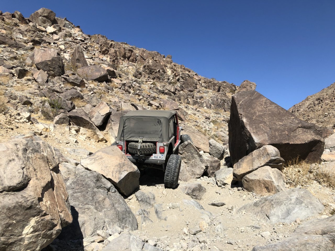

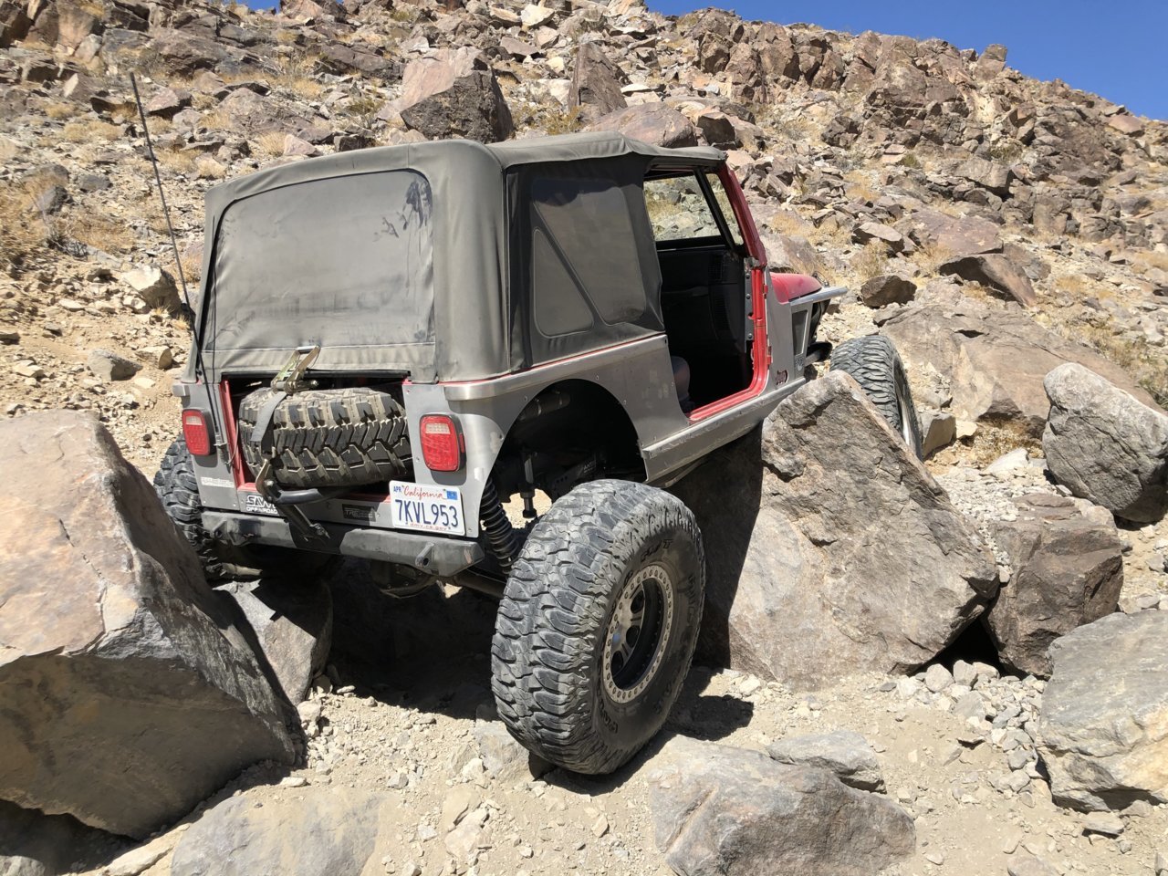

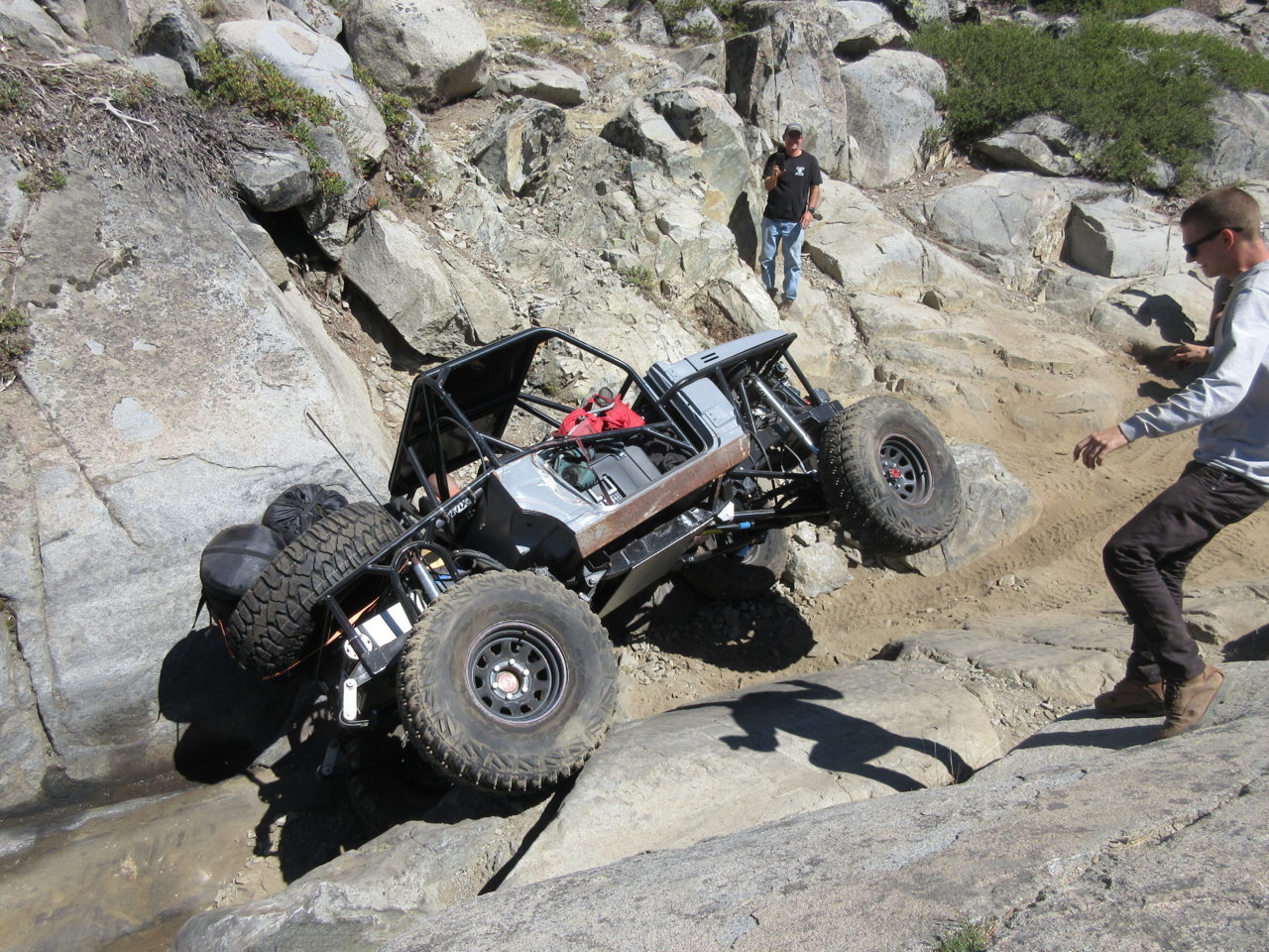

    nice rig, looks like near the start of the rubicon trail. I too like to climb big rocks. Some of mine from fordyce, wrecking ball and sun bonnet pass in Johnson valley.

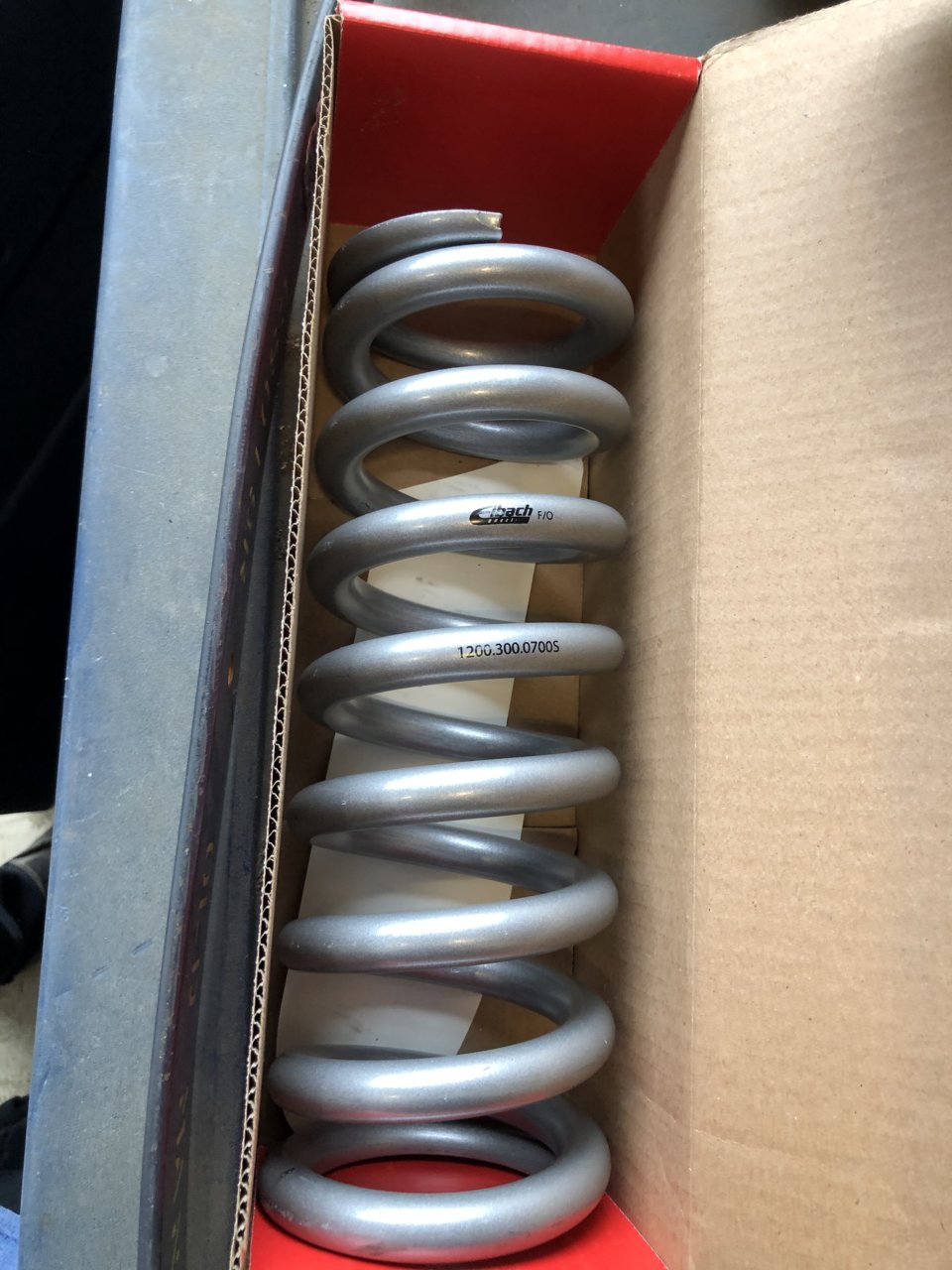

    These springs, they aren’t a barrel spring like the pro coils are so they get a little close to touching the body of the shock when fully compressed, so they are very very close to the same length, and flat top grind as the pro coils and close to the same ID and OD.

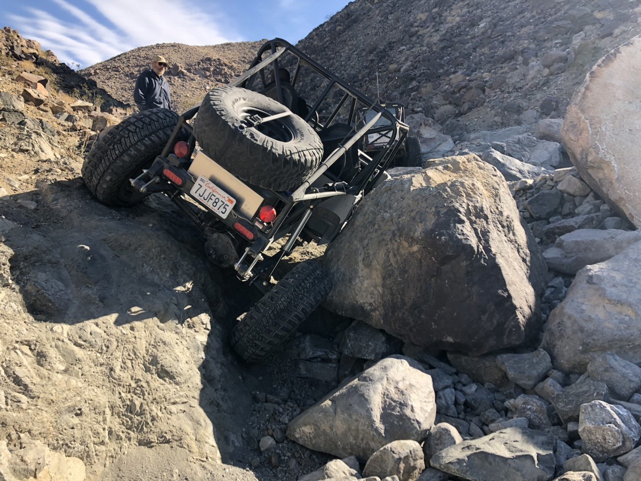

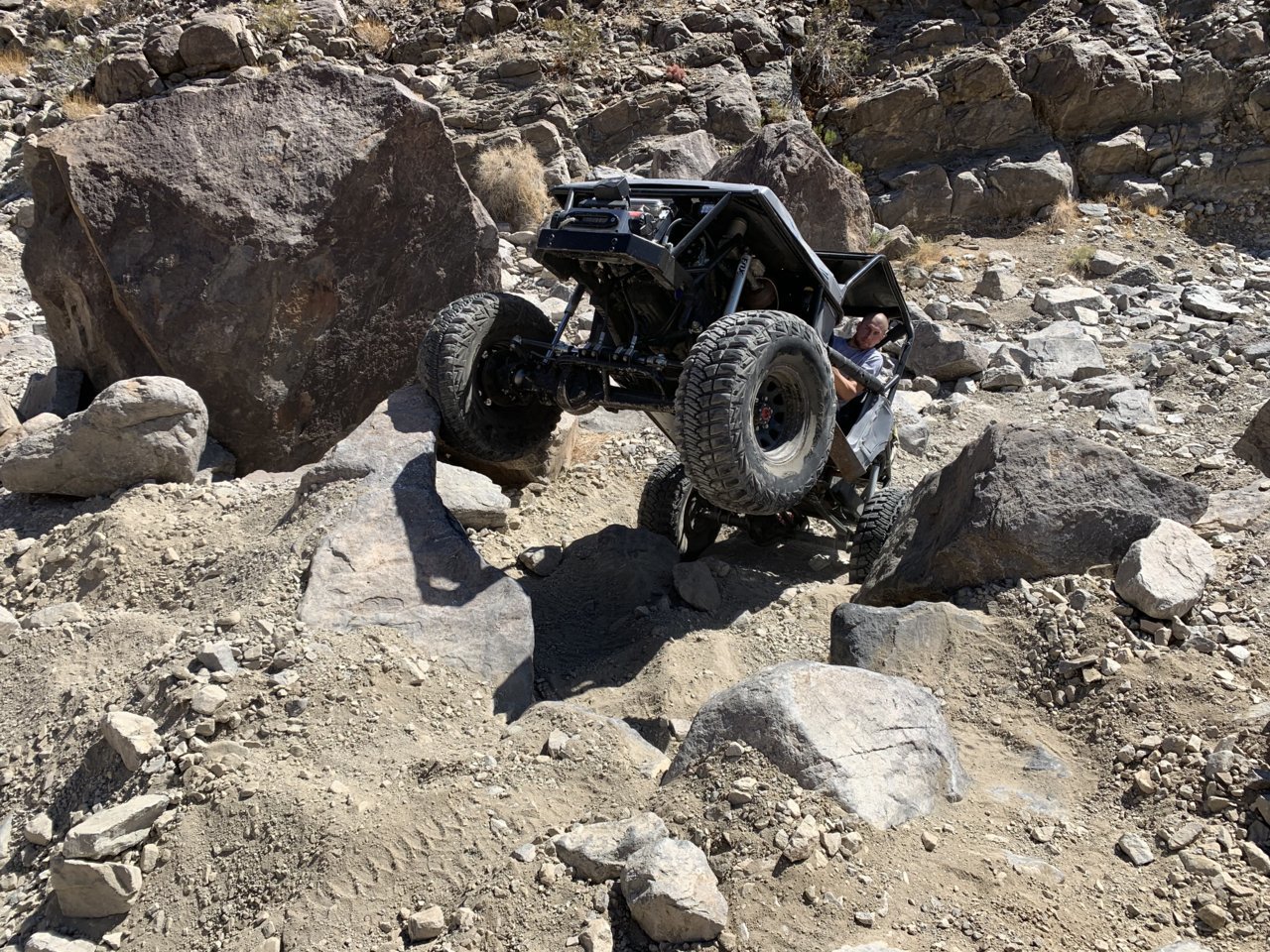

    Shouldn't that front axle be articulating more? Seems like, even with a wheel in the air, it really doesn't want to droop a side. You running an aggressive sway bar up front?
    RobP62 likes this.
  12. Dec 27, 2019 at 8:03 AM
    #152
    Anderson5290
    Anderson5290 Well-Known Member
    May 30, 2018
    #254979
    758
    Brandon
    Corona, Ca
    2018 Tacoma TRD OR 4x4
    Tuned Fox 2.5 resi with dsc, JBA HD UCA, total chaos knuckle gussets, rear trd pro fox shocks, Deaver U402 stage 1 rear leafs, archive garage u bolt flip with fox 2.0 air bumps, White knuckle off road rock sliders, BAMF 1/4” steel skids, Magnaflow exhaust, Archive Garage Hammer Hangers, Cbi high clearance rear bumper, 285/75/16 tires.
    You would think, it has something to do with how the front links and air shocks work with the rear leafs and anti wrap bar, with my coilovers on the front it doesn’t seem to do it nearly as bad because the shocks don’t unload like that. That rock Huge tho, this is my brothers rig on 40 inch sticky’s, he made it over. I broke my rear anti wrap bar on this which took out both my rear shocks at the same time and I had to limp back. But regardless when the front was on leafs, linked and with air shocks or coilovers I always lift a tire trying to follow my bro.
