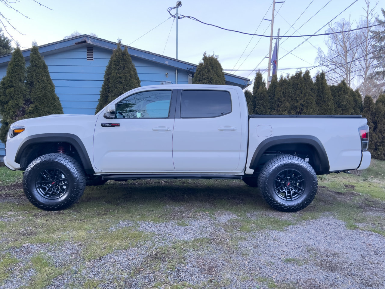

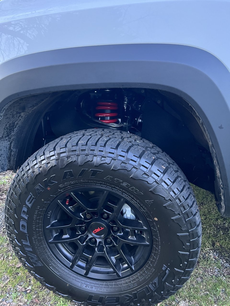

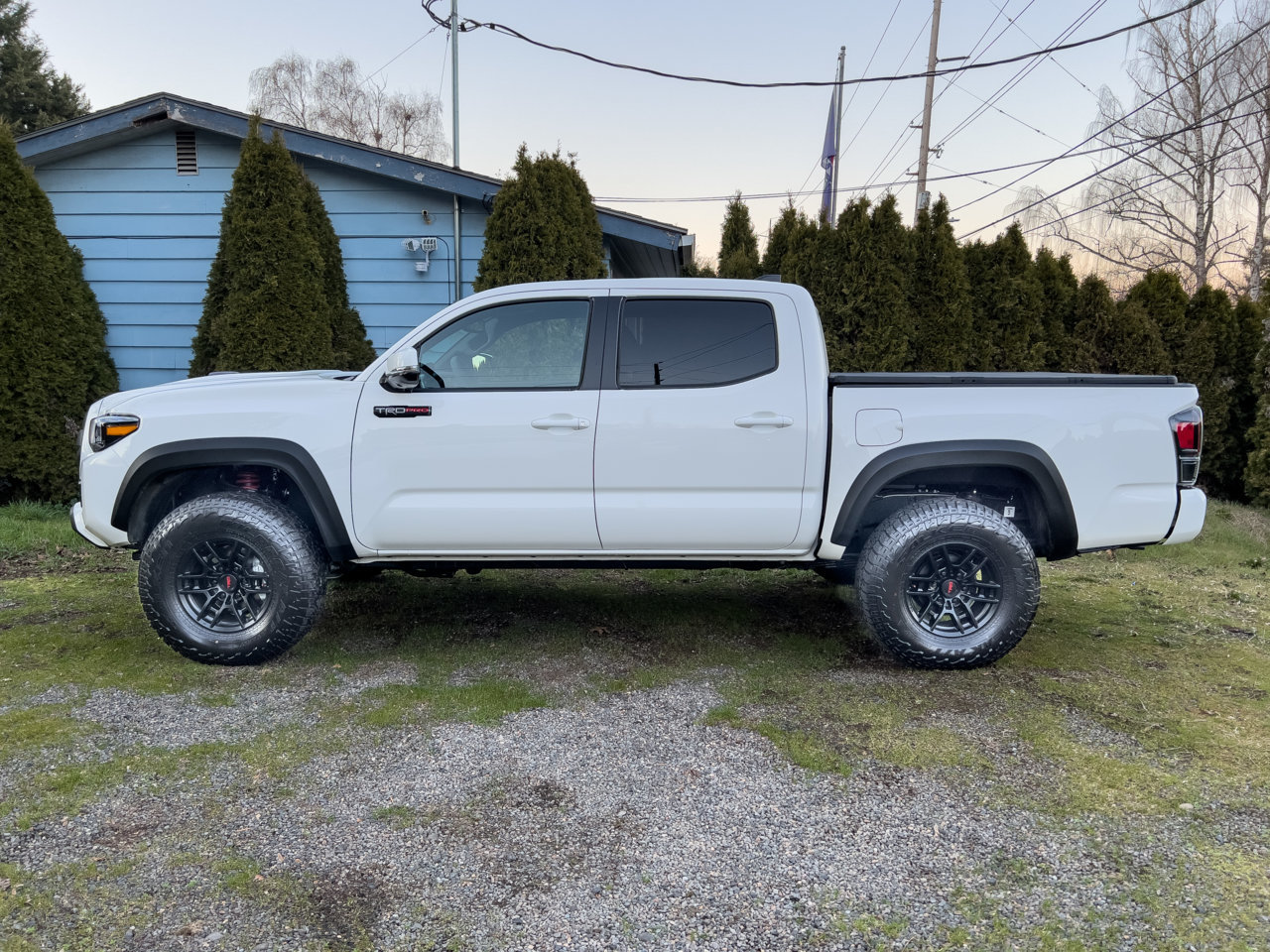

    Can't help you with long-term-ish feedback, but I'm a few days in and can't feel a difference (mine never really had the brake dip and the rake was fine, but I don't miss it because I'm not hauling a ton). No UCAs needed and my Toyota mechanic (and GM) assured me the warranty would continue to cover the truck (not the springs, of course).

    Thanks for the before and after. Did you install sliders as well? Mind sharing which ones you went with?

    Yah, wish I could’ve done it justice. Yes, the night before actually. I went with SOS because of the price and reputation, but their customer service and lead time (18 weeks!) leaves something to be desired.
