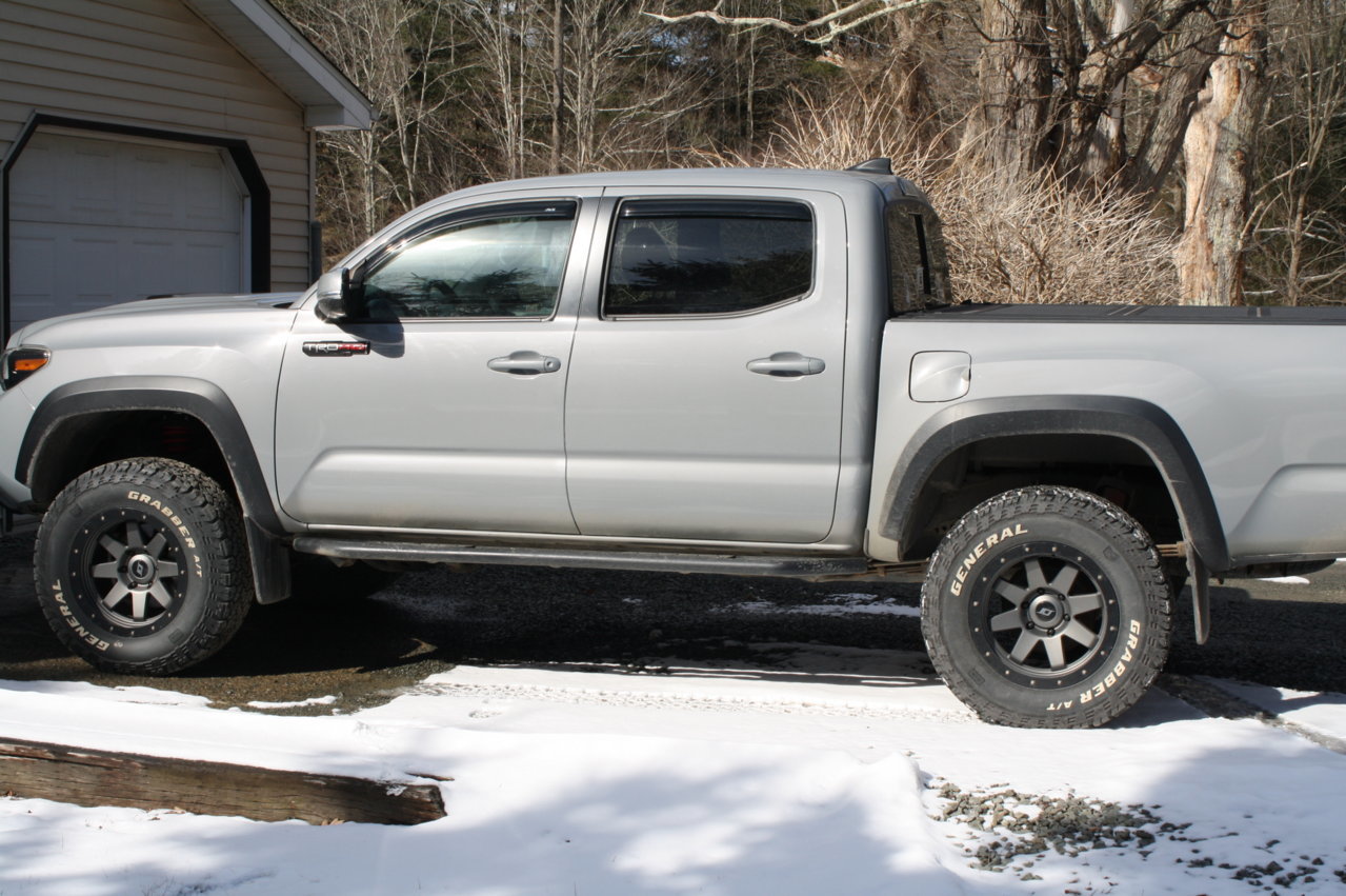

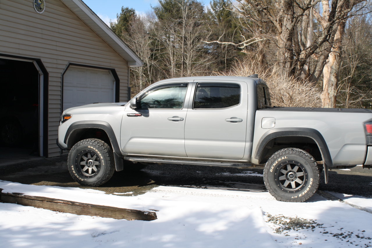

    i already had a 1 in. block in rear, with aftermarket fox front shocks adjusted to be level, so when i installed oem fox's with 1/4 in spacer BOTH sides with upgraded eibach springs,, at that point the front was 1 inch higher, so i took out 1 in. block and installed 2 in tapered block, truck sits level i will get some pics posted,
    with a 1 in. block and just the eibach springs, no spacer, the front would probably be 1/2 in higher due to the 5 yr. old oem leafs.. thats my thinking, love the way it drives and looks..

    yes i do, i need 285's next.. 265/70/17's now.. sits up pretty good now..

    Haha, I've seen you post this picture a few places now - clearly a proud owner! Happy for you. Have you stretched out those fancy new UCAs? Lots of people are curious about them. Also, I think my truck now rides the same height as yours in the front, not sure if the latest Eibach spring upgrades work (i.e., would be a wash) for the '22s.

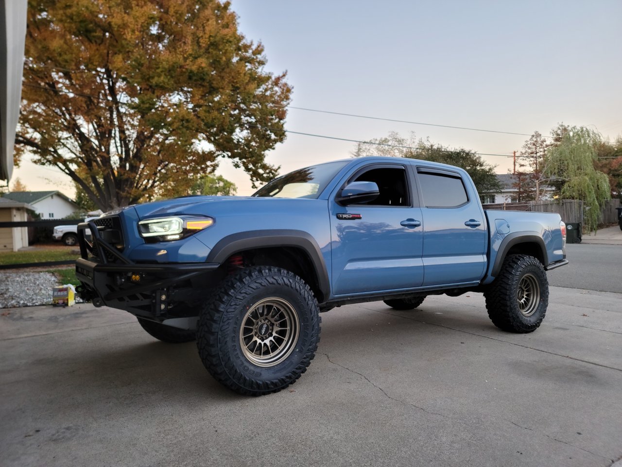

    I don't have any vibration issues. Ride feels same as stock to me lol. I drive pretty hard.. removed sway bar as well.
    IG is - slimthungc
