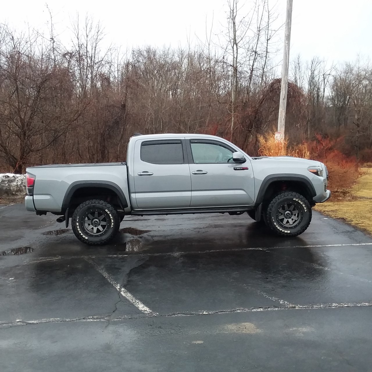

    shop said it was level, after a week i measured it myself, 3/8 in. rake.. both rear sides are exact, both front sides exact, 3/8 lower in front.. cant really notice it.

    just put the eibach springs on my 2017, with a 1/4 in top plate spacer both sides,, which brought the front up about 2 1/4 inches, added 2 in rear tapered block, truck has about 3/8 rake, factory UCA's and it aligned great,,,,, love it more, puts a smile on my face even after 5 1/2 yrs ive had it.. gonna throw some 285.s on it soon
