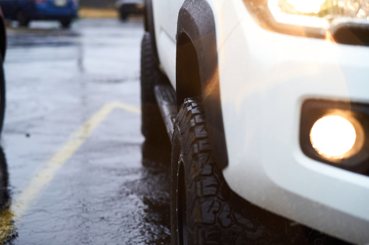

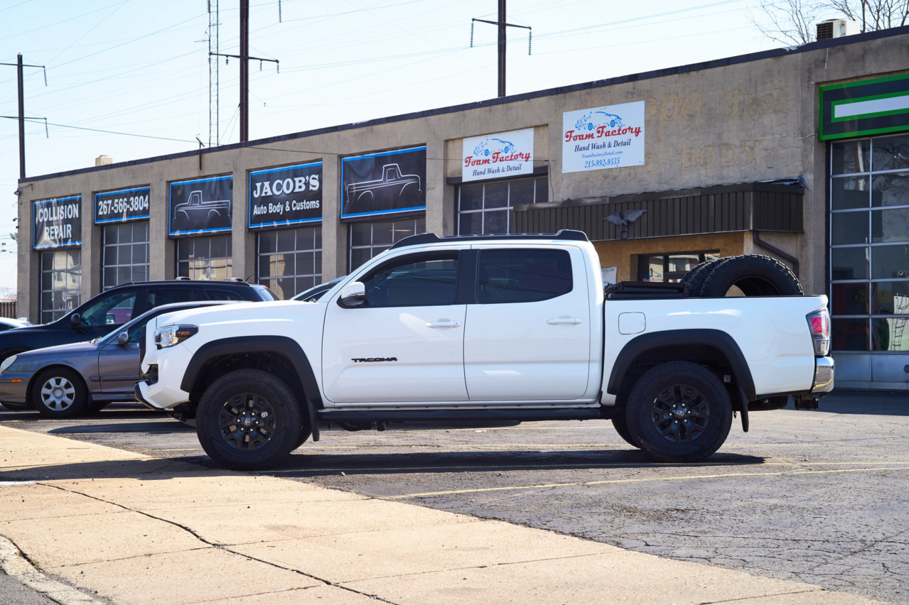

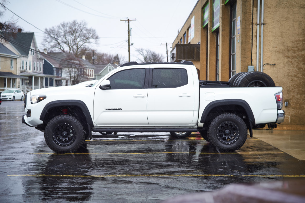

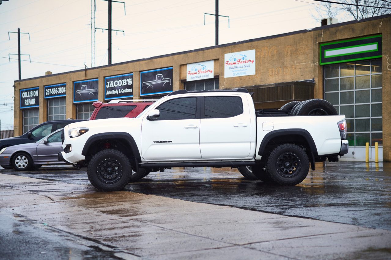

    What's up guys. Thanks for all the info.Quick update. Just got the Eibach Pro Springs installed onto 2021 trd pro fox shocks that I bought used with 2k miles on them. These went on my 2021 Trd OR. Got about 2.3 inches in the front over stock OR. Did an Icon AAL for about 1.5 inches of lift in the back. Although some of the photos it looks lower (due to approx 400 lbs of gear and tires in the back). SCS Ray10s 17x8.5 -10 offset wrapped in 265/70/17 KO2's. No Rubbing even on stock mudflaps or when entering a driveway hot. Very Happy with the ride so far. Feels firmish but softens up a bit on bigger potholes. Much better of a ride than the stock bilsteins. They were too soft for my taste. Still have to test this set up in the NJ Pine Barrens which are mostly sand trails with some good whoops. Love the height, the stance, and the ride. Before and after pics below.

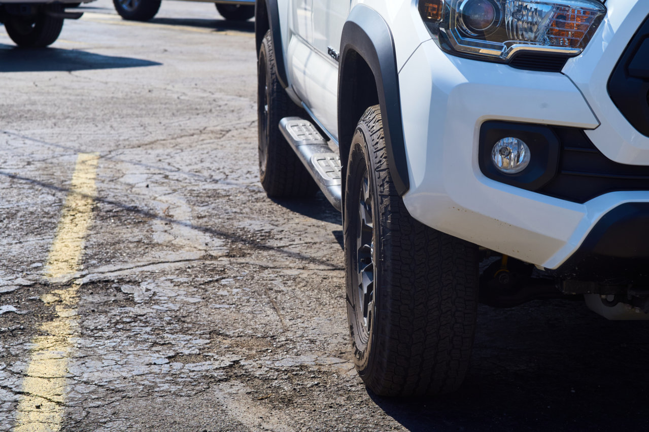

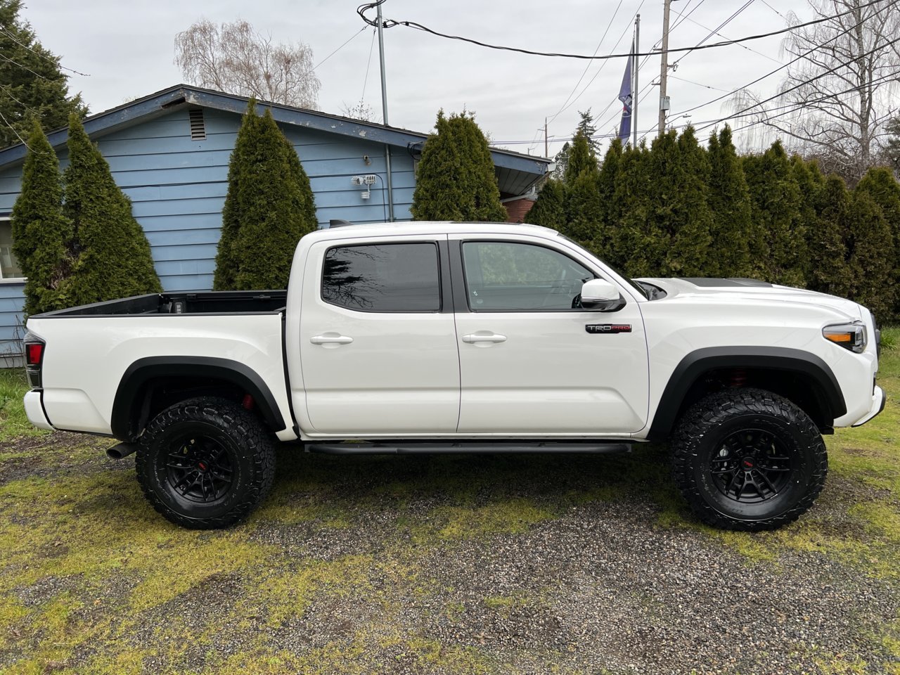

    285/75/16. Two angles so I don’t get in trouble like last time :rolleyes:. Dude said I have between 3-5mm between the tire and UCA. No rubbing; looks like I have plenty of clearance.

    Looks good! What tires?

    Thanks! ko2s from FW at3w. Substantial weight difference, but change in power people report must be nominal, or it's simply disguised better with a manual transmission.

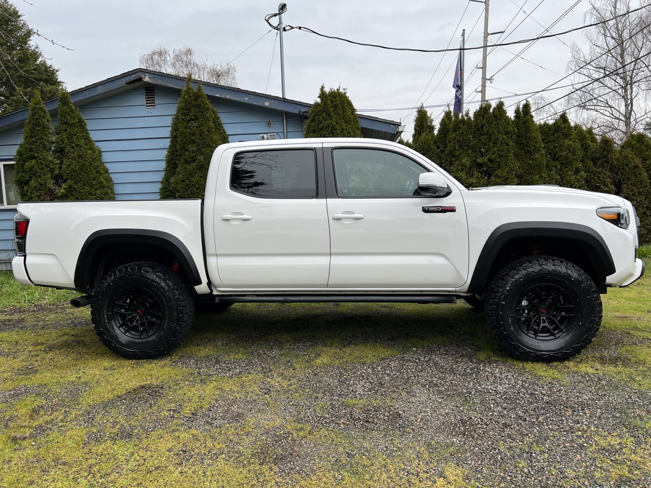

    Finally got around to installing the Eibach's and AAL on my 2021, very happy with the result. Ride is slightly stiffer than stock but I actually prefer it. Perfect stance and is exactly what I was going for, not too high in the front with a slight rake.
