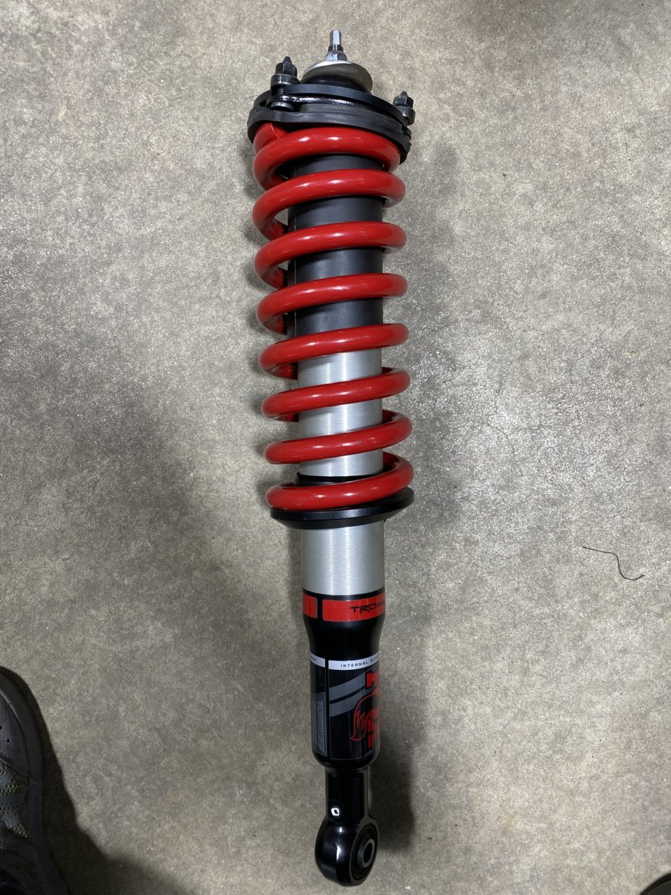

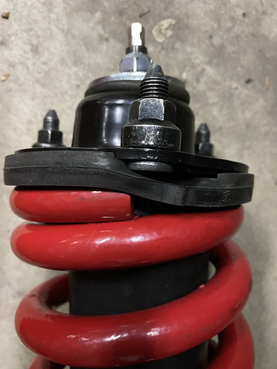

    Running into an issue with reassembly. Its as if the top of the springs cannot lay flat like the OEM springs. Maybe someone here can help.
    We installed the 2020 Eibach springs made specifically for the 2020 Pro Fox shocks onto the shocks, and the top hats are sitting at a crazy angle. Tilted. I’m sure they are assembled properly. Is this normal? Does it settle? Should I attempt to install them like this? We tried a couple of times reorienting things, but this has been the net result.
    Really confused since I thought these springs were made specifically for the 2020-2021 fox shocks. Now I am second guessing - did I get the part numbers wrong? Are we reassembling them wrong? They were out together just like they were taken apart, from a stock Pro.
    Fox shocks are: ptr61-35201
    Eibach springs are: E30-82-069-03-22

    Looks like the springs are upside down. Is there a groove on the bottom bracket. Pictures of the bottom spring

    117
    Yup… do a 180 and it will be golden.

    2020 Cement TRD OffRoad
    They aren’t upside down. 100% sure.

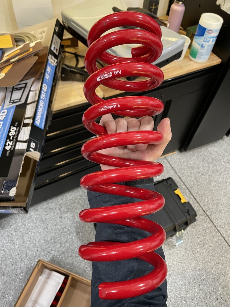

    RIDE Shocks 255/85r16
    Spring orientation isn’t an issue here. The top of the spring can be identified by both the Eibach logo, as well as the end of the spring touching the first coil below it.
    The bottom of the spring doesn’t touch any other part of the spring.
    Idk what is causing this specific issue, hopefully others have some insight.
    In addition to the top hat being angled, the strut is not centered inside the coil :/
