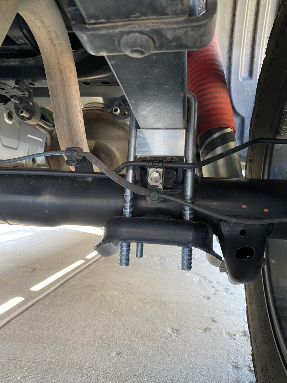

    Installed rear blocks today which leveled things up nicely. Went with Low Range Off-road 1” tapered blocks (which are actually a little more than 1”). Perfect height match for the Pro shocks with Eibach springs.
    Considering making a move from 265/70/17 BFG KO2s to 275/70/17 Toyo Open Country ATIIIs sometime soon.

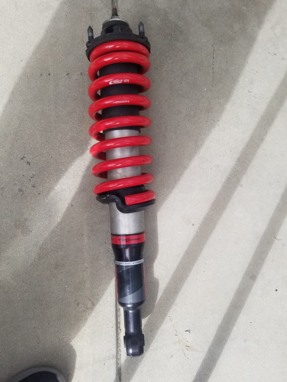

    Heres what they look like before installing on truck.

    Lopsided tophats - looked just like mine.

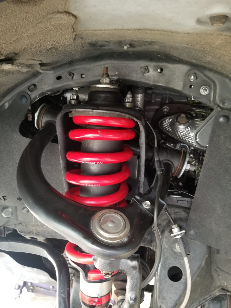

    Here they are installed. Not sure why butndriver side bushing on the coil i am not able to get it tight, i can kinds rock the top washer but unable to torque the bolt any more? Any has this problem

    If it's spinning the shock shaft, you'll need to put a wrench on the top of the shaft to hold it in place.
