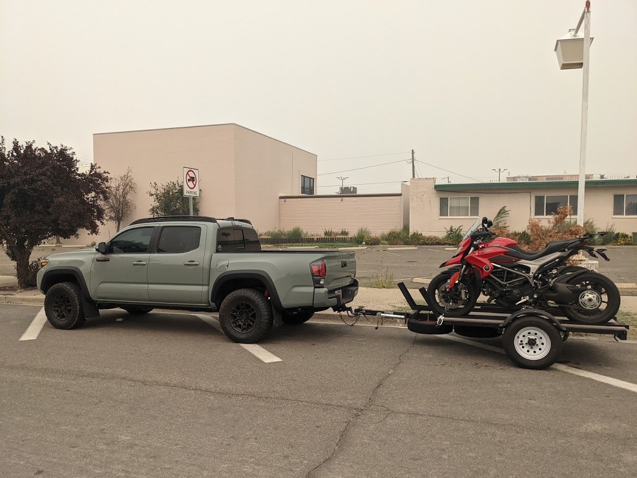

    On my 2021 Pro, that I do a fair bit of towing with (Camper Trailer/Motorcycle Trailer) - What is the best match for the rear?
    I'm not interested in blocks. I had a Wheelers 1.5" AAL on my last truck and was happy with it, and you can't beat the price. Is a full leaf pack better (at five times the cost)?
