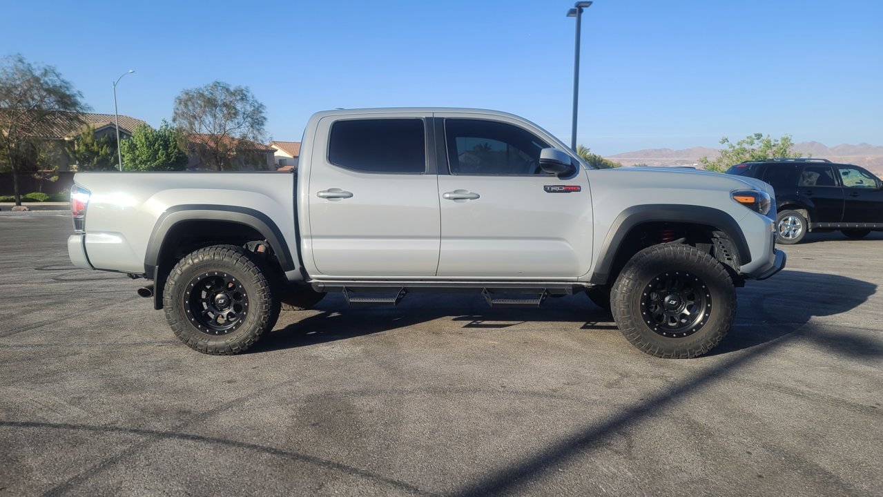

    Okay, got my Eibach springs installed today with the Headstrong 3-leaf AAL (1.5").
    My measurements PRE install:
    LF - 20 inches / RF -19.875 inches
    LR - 20.25 inches / RR - 20.75 inches
    Measurements POST install:
    LF - 22 inches / RF - 21.875 inches
    LR - 22.625 inches / RR - 22.875 inches
    Looks like the springs added 2" at front and the AAL added a little over 2" at the rear. Also interesting that the AAL brought my left and right sides a little more even to one another at the rear than they were before. The ride is great, maybe even a little smoother at freeway speeds than before. Off road test was brief, but no noticeable issues and no rubbing. Still lots of room at UCAs and a little more room to cab mount than before but CMC is still happening tomorrow.
    As it sits now.
    I'm parked on a slight uphill slope here. The rear is about .75" higher than the front which I like. I know this lift is only a couple of inches difference but man my tires seem small now. Do I go all the way to 315s? I feel like the wheel wells aren't filled proportionally like they were before.

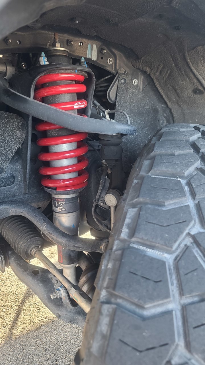

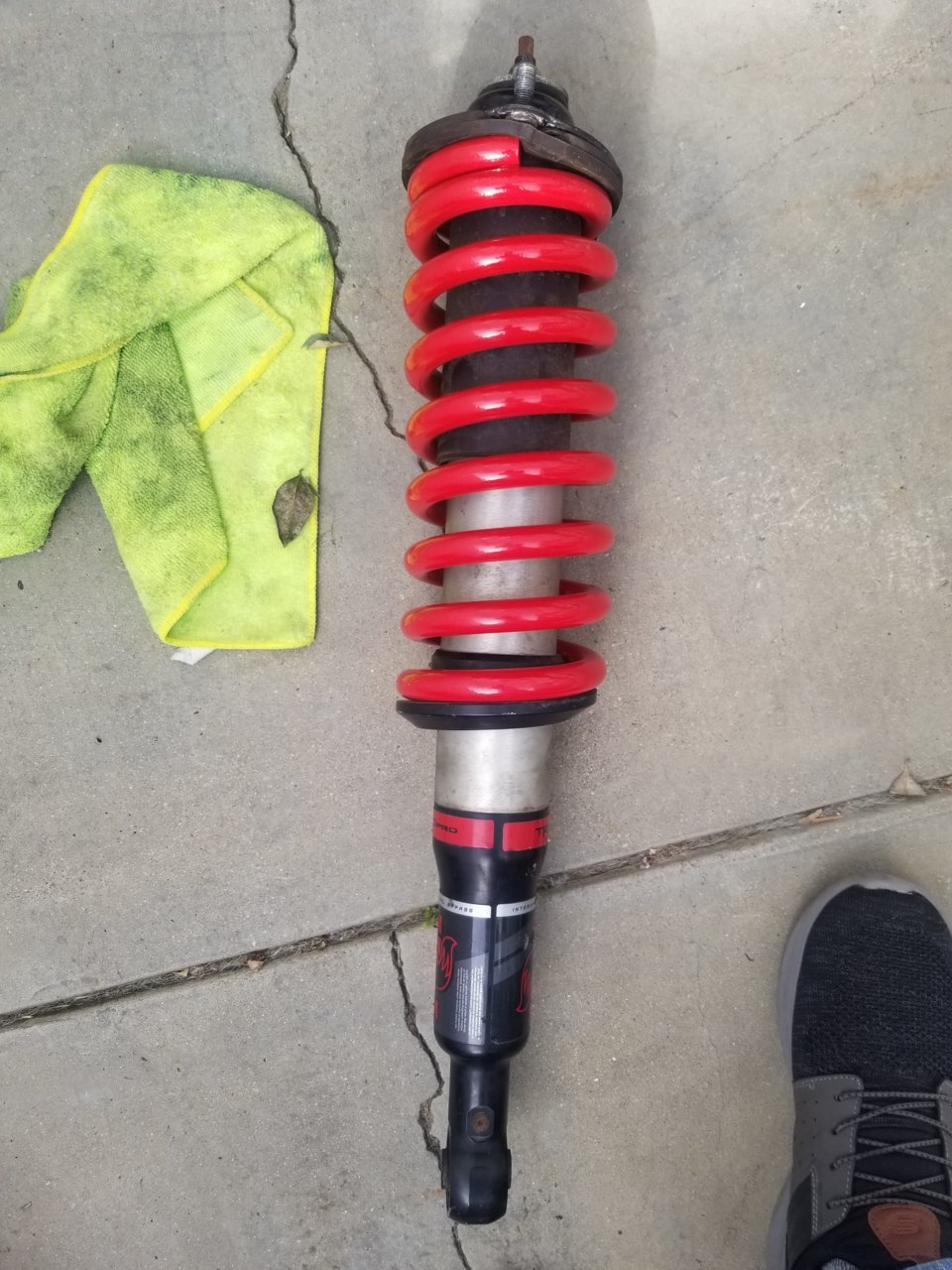

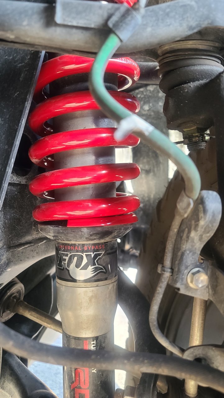

    Springs - LF (bottom plate sitting higher)
    Springs - RF
    I didn't really notice until looking at these pics but the flat bottom of the spring hangs over quite a bit and also basically touches that 1st coil too. Did the OEM ones do that?

    My '18 OEM ones look like that, nothing to worry about.

    i noticed in this pic that the end on the spring on top is right under the mounting bolt, would it not sit better if it was turned so it wasnt resting on the bolt.. humm..
