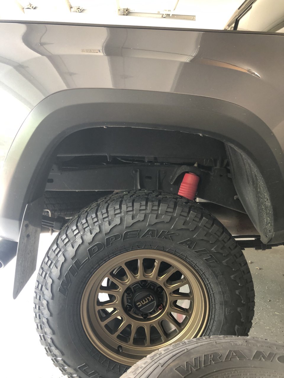

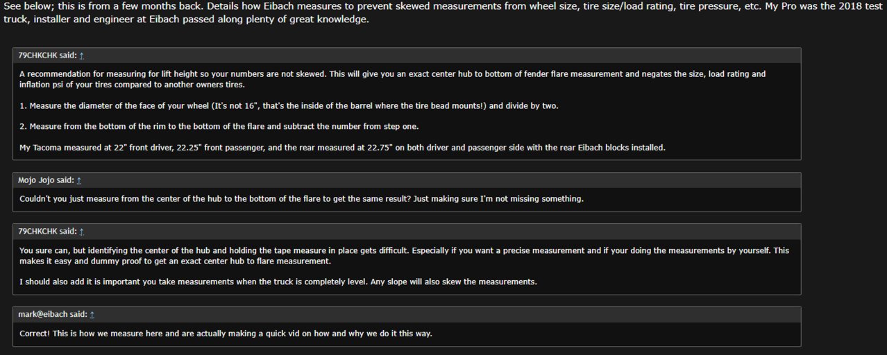

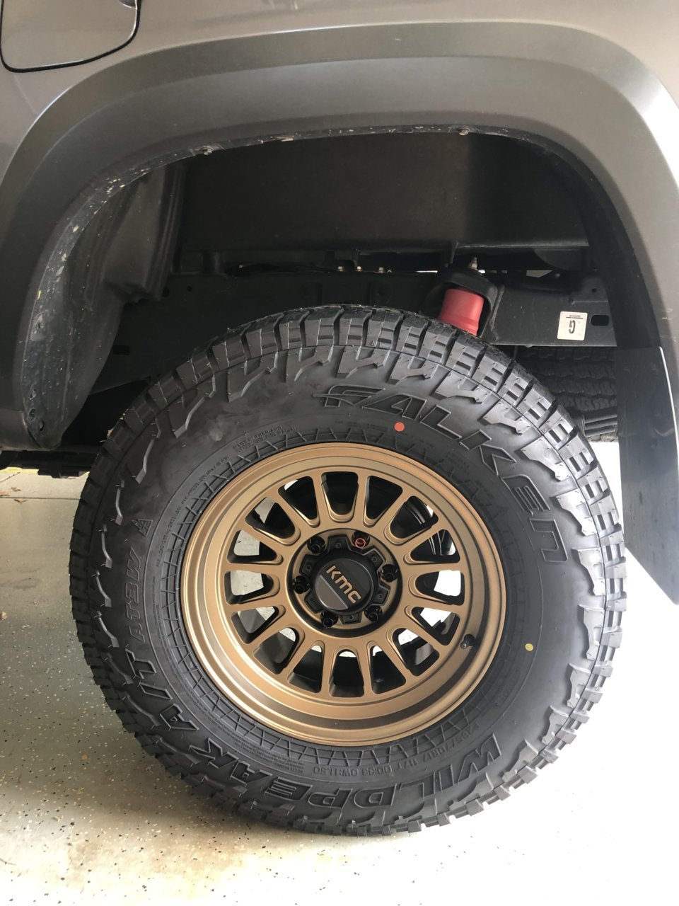

    I am curious where you all are measuring rear height from. Mine came out considerably higher than others. I’m sitting around 25 1/2 and 26 measured from the center of the wheel.

    That is weird. Should be right from your M on the KMC to bottom of the fender flare. Do you have the full truck weight on it as I see jack stands under front. 1" block should be exactly that.

    Post #1566

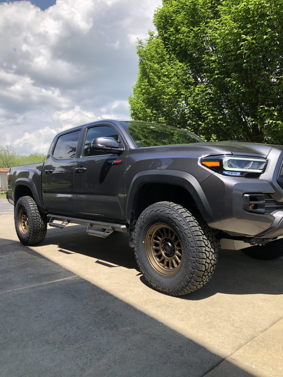

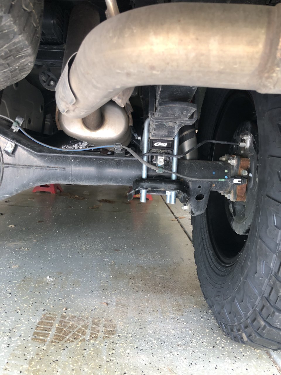

    yeah I was premature in my post. Once the full weight of the truck was down, it looked much better. Quick dirty pic of the completed product.

    Looks awesome.
    Makes me want to go back to bronze wheels on my MGM.

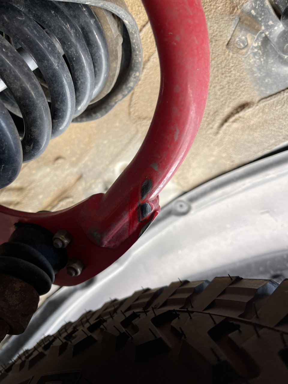

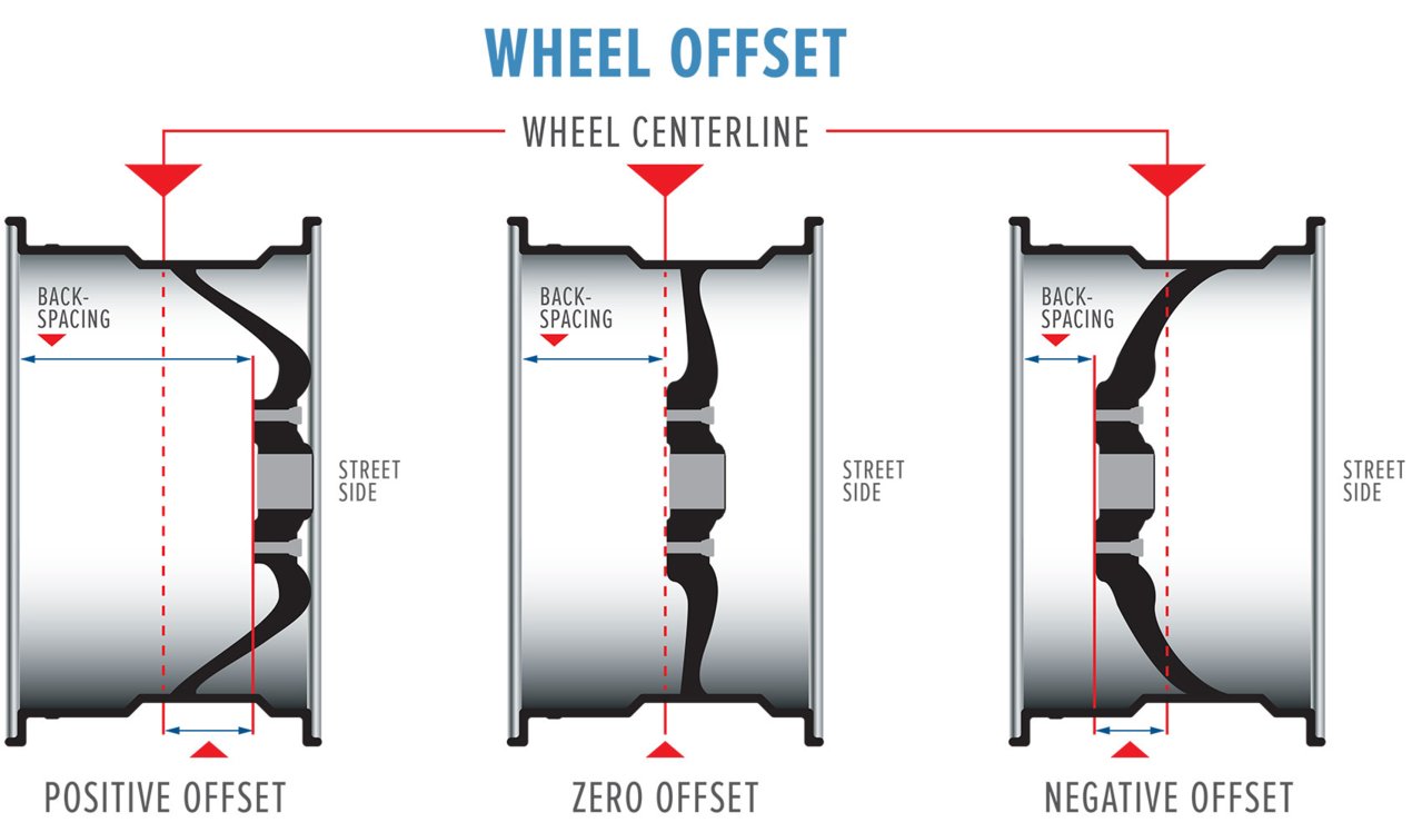

    Could use some help, as I have been looking for answers throughout this forum and I can't seem to find what I am looking for.
    So here's the deal:
    • I have the Bilstein 6112 lift upfront set to 6/5, with JBA UCAs.
    • I am running the TRD Sema wheels which I believe are 17x7 with +4 offset and 285/70-R17 wheel.
    • Now here's the deal, I was out cleaning my truck and putting in new grease into the bushing and noticed my UCA has wear from rubbing.
    • I feel like these wheels are pretty popular, but I can't seem to understand what the backspacing is and what I need it to be so I am not rubbing on the UCAs.
    Can anyone help me out so I don't go crazy searching for answers?

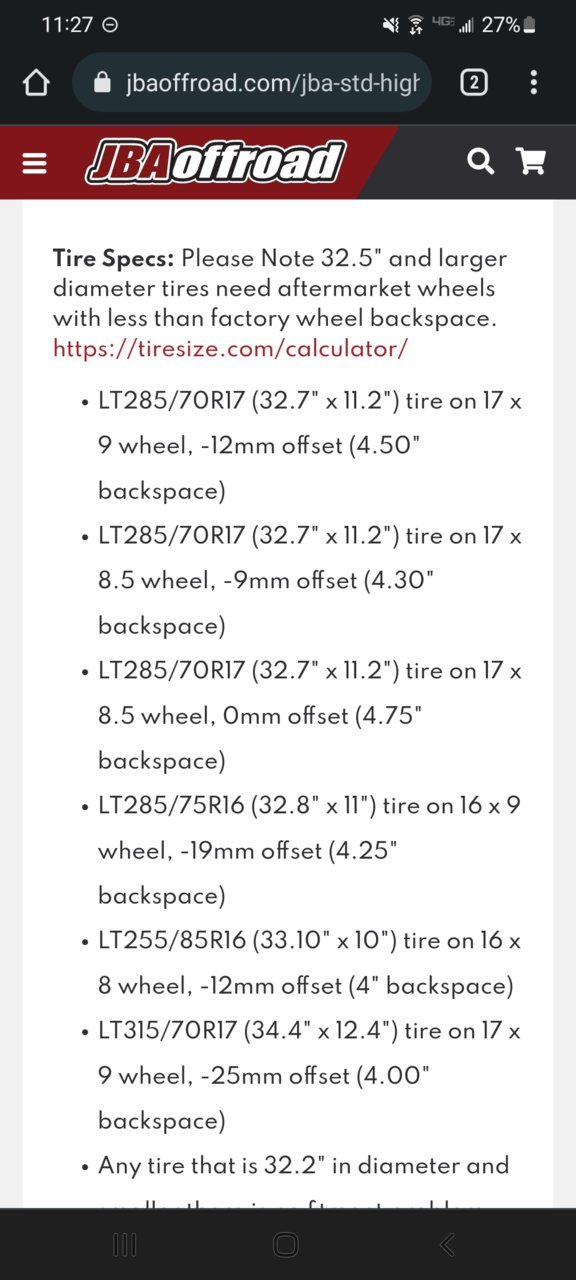

    Accoding to JBA, to run that size tire, you need a wheel with minimal backspace.
    Your wheel has positive offset, that pushes the inside of the wheel/tire closer to the UCA. A negative offset moves the wheel/tire further from the UCA. You can see this in the diagram below.
    Offset is a factor when combined with the wheel width. You can use these two numbers to calculate your backspace.
    Your backspace is 4.16"

    Thank you for the easy to understand explanation. So I would need to run a spacer in order to create less offset which in turn would reduce the backspacing?
    Or get a different tire size or wheel
    Bertw192[QUOTED] likes this.

    Correct
