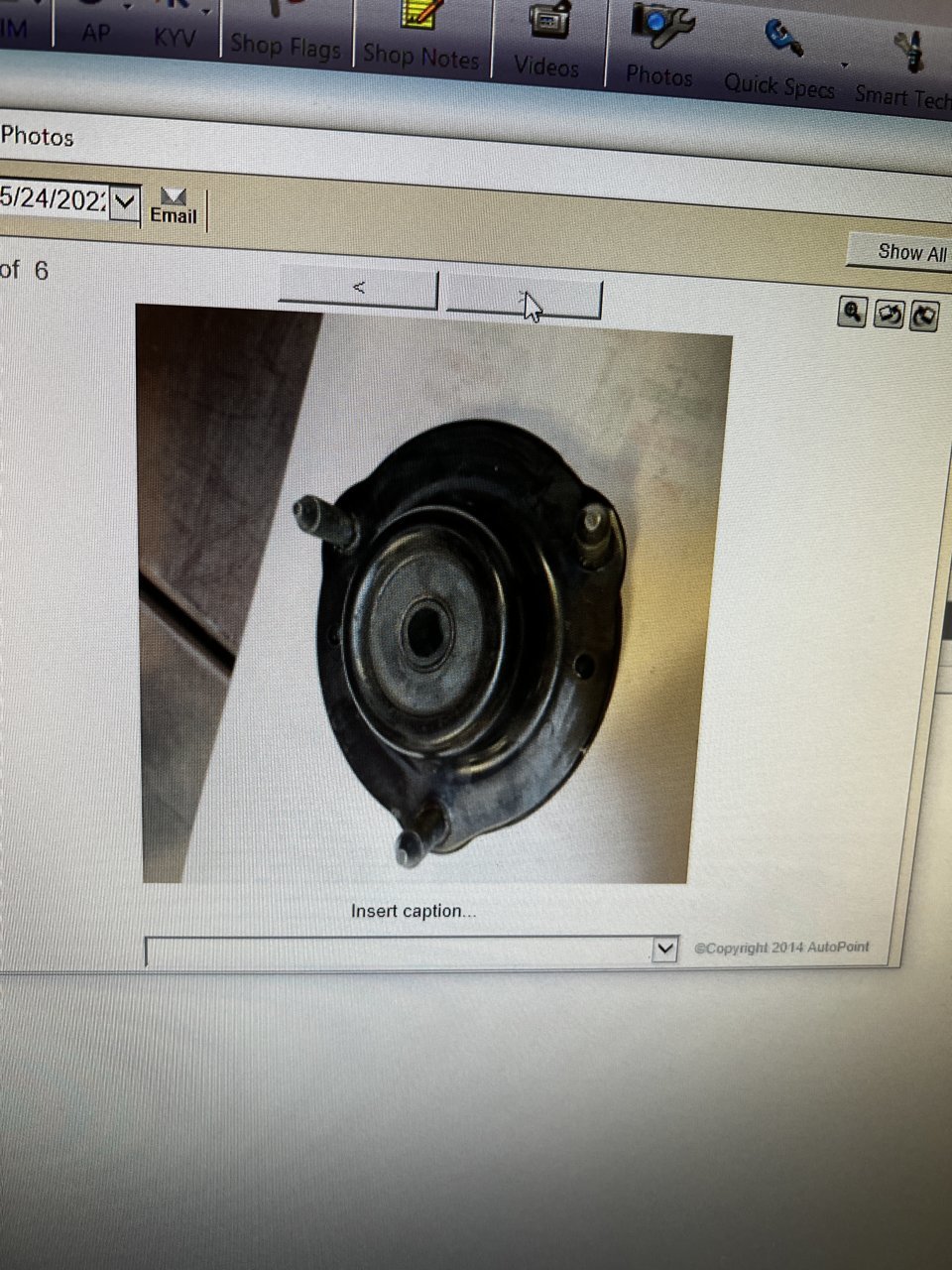

    Anyone else have issues with their shock top hat and bottom mount causing everything to squeak? In the dealership having them replaced as I type. They are attributing it to the spring upgrade. I'm suspicious, however.

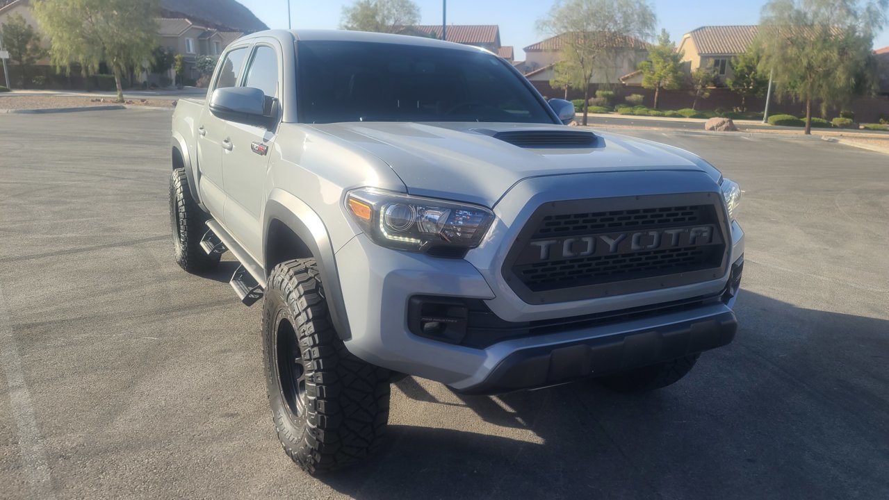

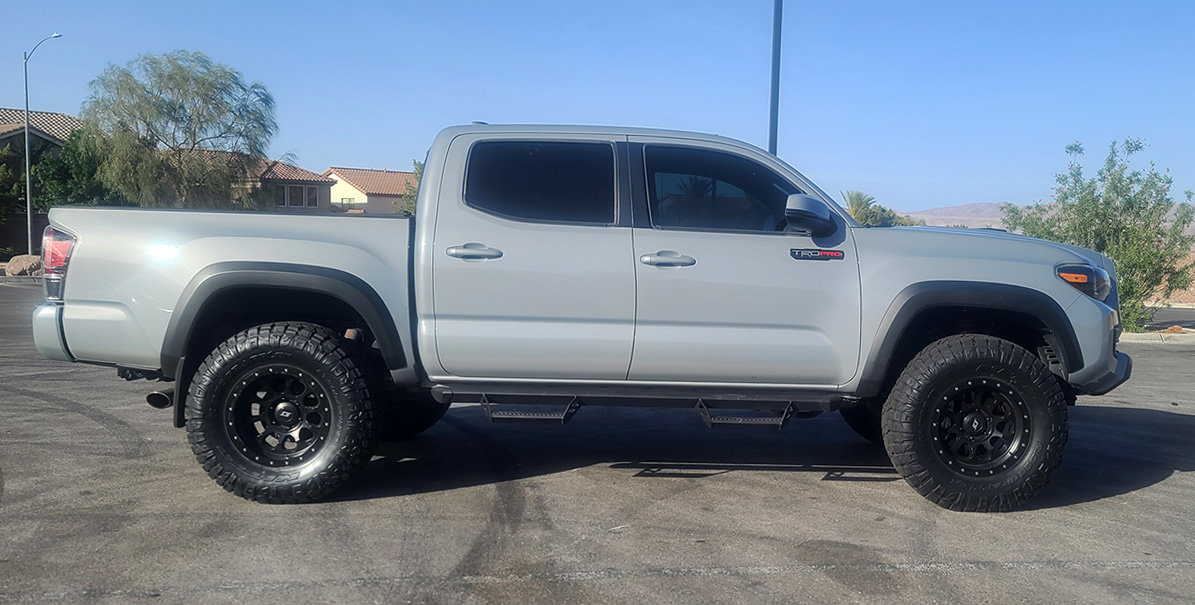

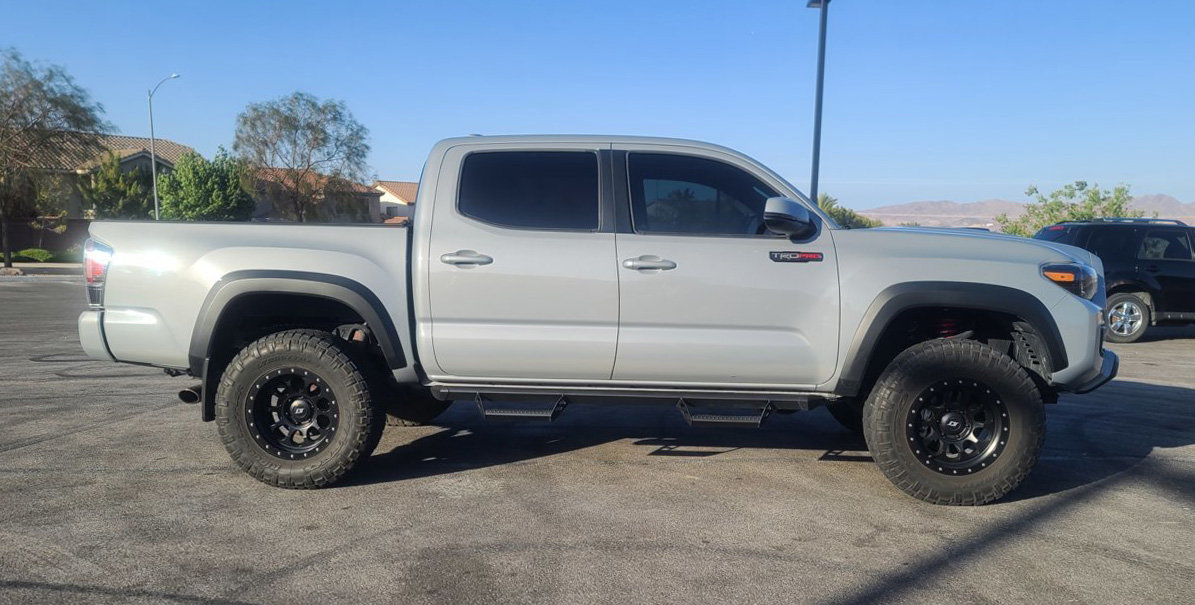

    As a matter of follow up. I did go ahead with moving from 285/70/17 to 305/70/17 after the Eibach spring upgrade, the HS 3-leaf AAL, and a CMC. I also reshaped the fender liners, hammered my pinch welds, and took a grinder to metal at the rear side of the front wells just inside the fender trim.
    I first had the tire shop do a fitment with 315/70/17 and they cleared fine but I could tell there were going to be issues off-road. I was ready to move down to 285/75/17 which are still a good inch larger in diameter than 285/70/17 but something about the upright looking stance and ratio bothered me when I saw them installed. I think I had been staring at my 285/70's for too many years which have a certain width to height ratio that just looks right. So....I went with the less conventional 305/70/17 size as the final selection and I like the look much better.
    BEFORE (with springs and AAL already installed)
    285/70/17
    AFTER
    305/70/17

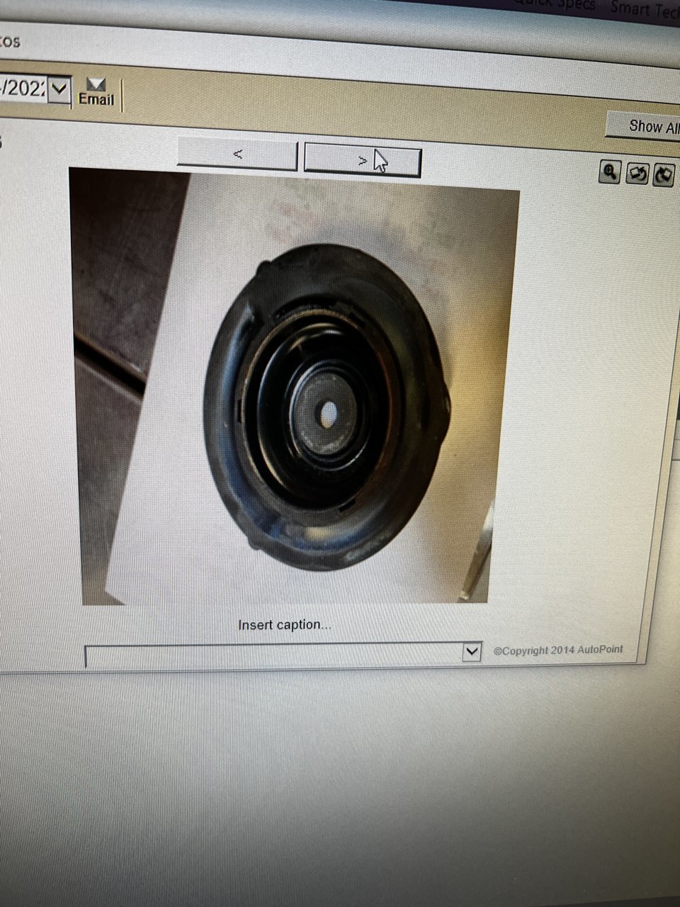

    Problematic down the road? Did they notice metal on metal wear? I find it odd mine are squeaking as I marked the top hats and they are oriented on the new springs exactly as they were on the stock springs.
    Odd that when I rotate the nut on the top hat it spins the shaft and the shock but the squeaking stops for a bit.
    I do not have many miles on the kit, but it is already pushing me to upgrade to kings and a leaf pack much earlier than I had anticipated.
  17. May 24, 2022 at 10:02 AM
    #1877
    RTweet
    RTweet Well-Known Member
    Jun 29, 2021
    #369956
    1,323
    Oregon
    2021 White TRD Pro, MT
    Yah, it was worn down quite a bit and metal/metal (I was able to look at it). They said it shouldn’t happen again, which is intriguing considering they blamed it on the lift.

    Do you have pictures where the metal on metal was happening? Now I'm interested
  20. Jun 1, 2022 at 11:43 AM
    #1880
    RTweet
    Jun 29, 2021
    #369956
    1,323
    Oregon
    This is all I got from them. My knowledge is limited, but nothing here seems potentially catastrophic…
