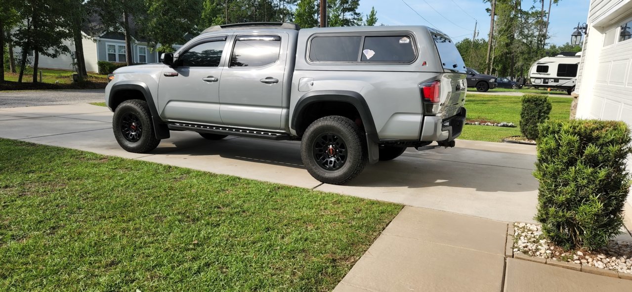

    I have a brand new set of E30-82-069-04-20 Front Coil Springs for 17 TRD PRO and and brand new rear HeadStrong AAL still in box and unopen that I am not going to be using. I am selling as a complete set in Chareslton SC area if anyone here is interested. Im going to post them after I get all the pics but if anyone here in this thread is interested PM me. I thought Id offer it up here first since I know some folks are waiting on back orders.

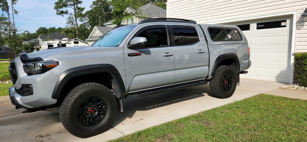

    I decided to go ahead with the spring and aal since noone was interested in buying them from me. After i ordered them I was just going to upgrade the suspension all together but figured I'd installed these since I already had the parts. Im happy with the results as it's now sitting pretty level and the ride quality is very similar to the stock ride other than less MPGs and maybe a little stiffer. No off-road test yet or even bumpy roads as she probably hasn't had much more than 80 miles since installed. I'll put some 285s on next.
    Unrelated question: is there a market for the original springs? About 60k on them

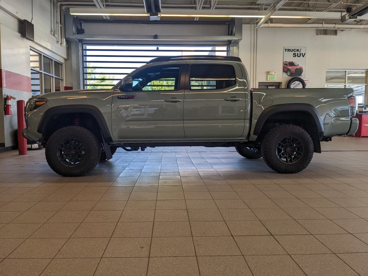

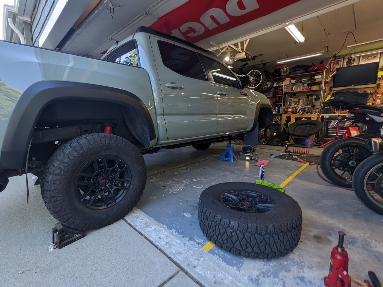

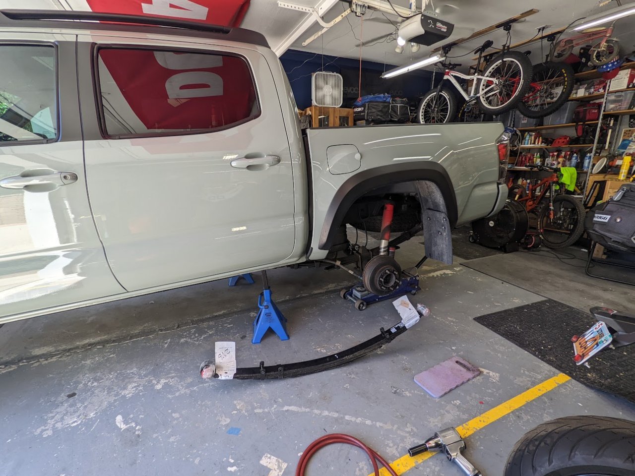

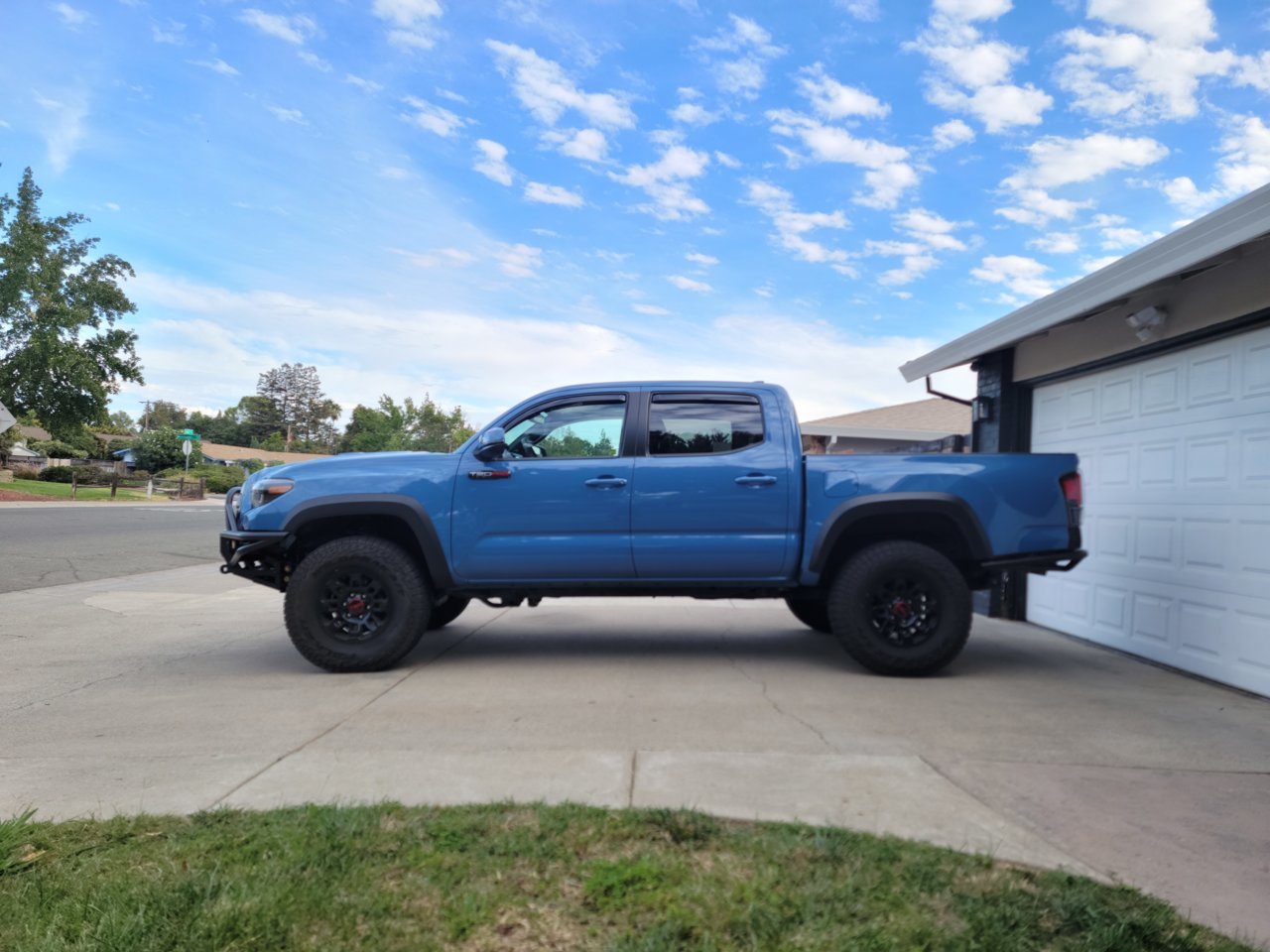

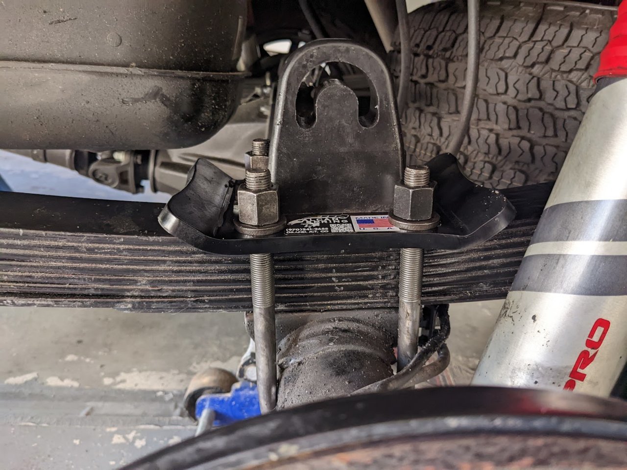

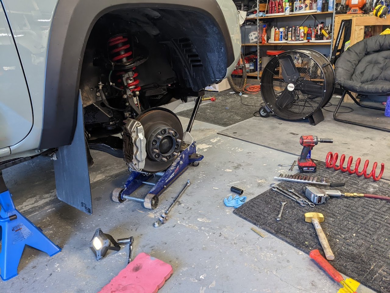

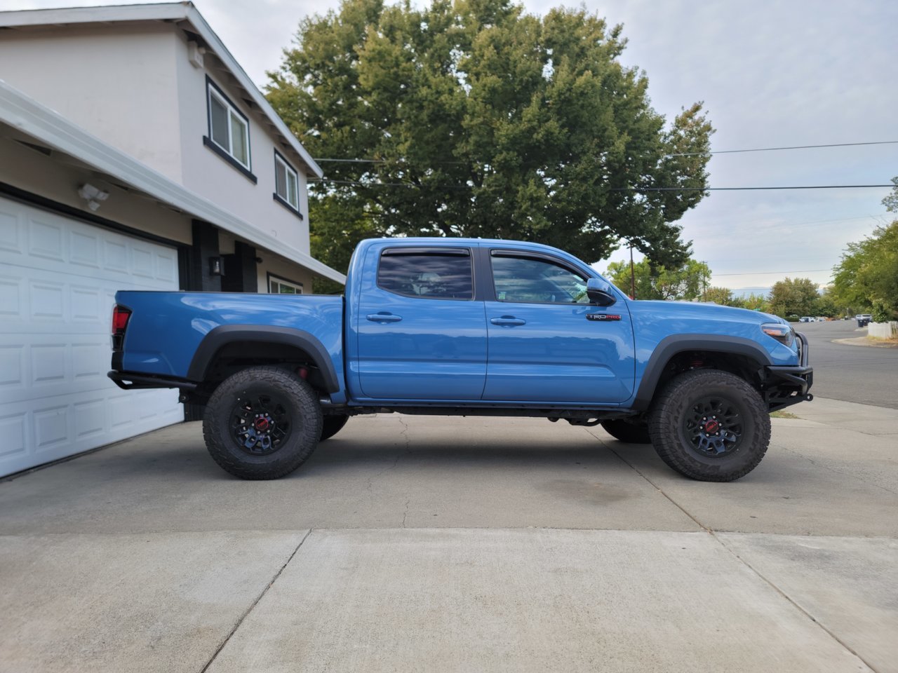

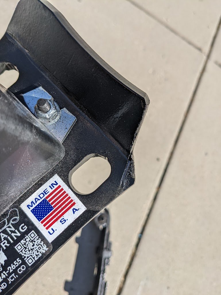

    I installed mine last night. The entire job took about six hours. I thought it was super easy, especially on a new truck that has been doused with lanolin. Every bolt just came out nice and easy.

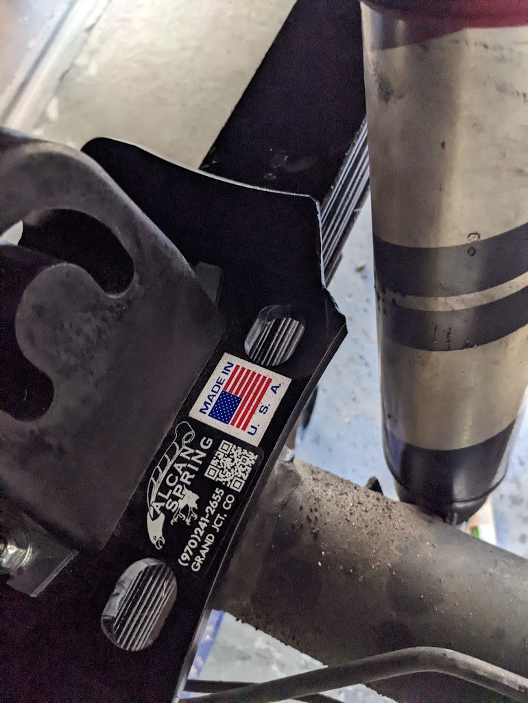

    I opted for a custom leaf-pack from Alcan with the "flip kit" and an upgraded bump stop. The flip kit on the right side fouled the rear shock, so I had to make a modification.
    Installing the front springs using the lower-control arm method - not sure why people freak out about this - it's easy-peasy. We used to do this in High-School all the time, I thought that was just how it was done. However, one tip with this is; once I got the top of the shock barely through the hole in top hat, I'd just pull the spring forward until it seated correctly. Also, since the top hat stays with the truck, make sure you put the coil over back in the same way it came out so the spring sits in the top hat nicely.
    I'm not sure how much these settle, but the front's seem a lot taller than I was expecting.
    My concern right now is I really want the rear to be sitting higher than the front. Depending on how these settle, I may end up putting my overload leaf back in, which I'd rather not have to do. I effectively got the exact same left/right height. Current measurements from the center of the wheel:
    Front: 23 1/2
    Rear: 24 1/4
