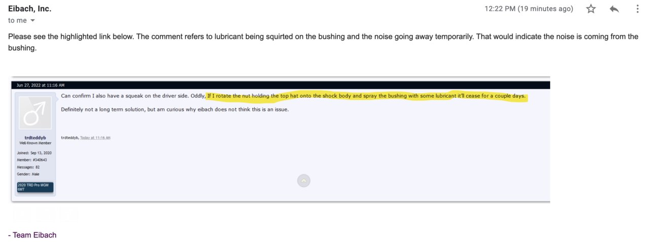

    mark@eibach any ideas?

    Didn't take long for the Eibach guy to look at the thread I sent him...

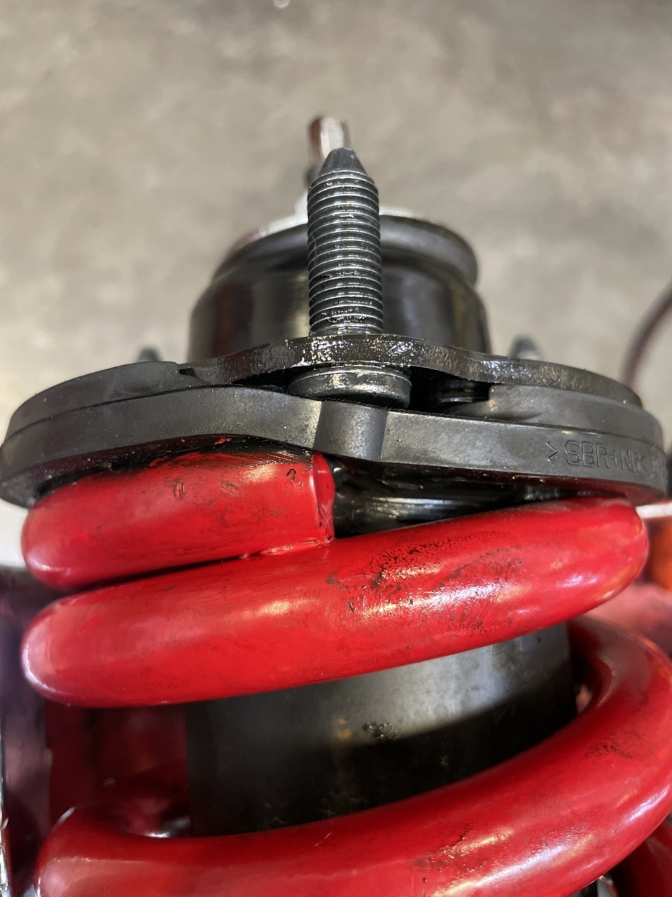

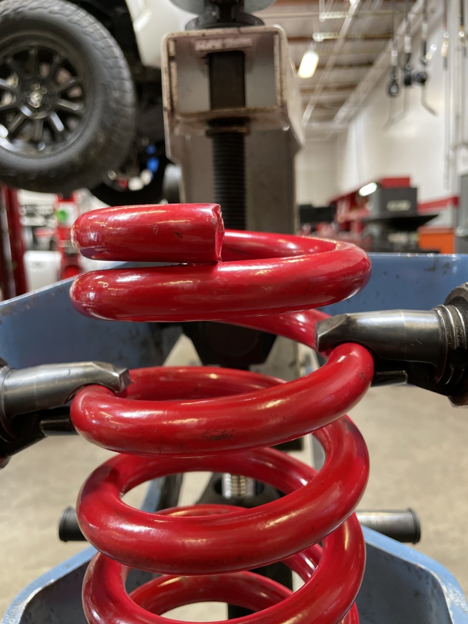

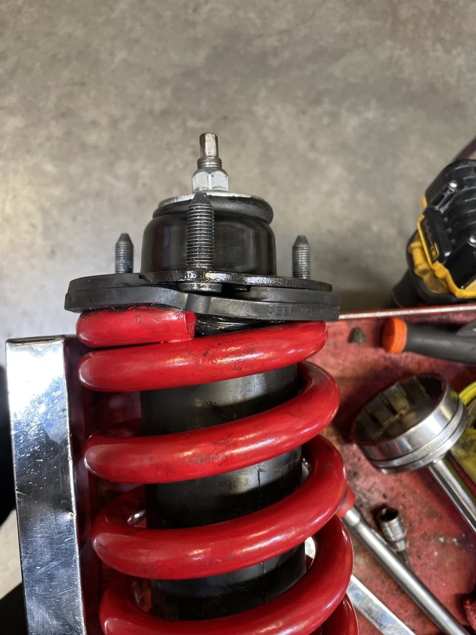

    The latest from Toyota: “Good morning! Yeah sorry for the late reply. We are still trying to figure out where the rubbing is coming from. The springs have a offset cut that is causing the top hats to not sit properly. We’re trying to determine where exactly it’s rubbing and what the next step is.” Didn’t we conclude in this thread that it’s a manufactured design that normalizes under load?

    The older models had the spring ends ground flat, with flat perches. The newer models are not ground and have a lower perch that accommodates the spring coil without being ground flat. But, the top hat only has the rubber isolator, so until the coilover is installed it might be a little crooked.
    I'm wondering if this is the source of the squeaking. As the suspension moves up and down, there might be a slight twist at the top against that isolator. Putting some grease on both sides of the isolator might be worth a shot.
