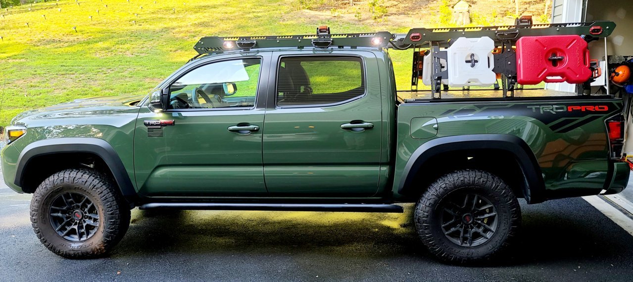

    Didn't know about this issue. I went w toytec and as u can see in this pic the springs are flat at the ends. Everything went on easy and without issues. Sorry some are having to deal with this. I don't know eibach so I'm not bashing on them. Just really sucks when you make an investment to make it better.....

    Yours looks to be a 2017-2019 style TRD Pro Shock, were the spring is flat on both top & bottom. From the looks of it, those springs do not have squeaking issues.
    Issues seem to be happening with 2020+ TRD Pro Shocks, were the OEM open spring design causes the aftermarket springs to squeak.

    I'm a 2020. The springs in the pic are the toytec not oem. Total lift after installation is 2 more inches (every inch counts!!). lol. Totally changed my drive and even getting in and out.
