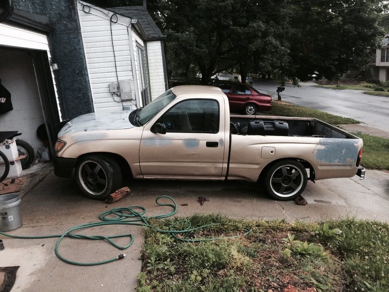

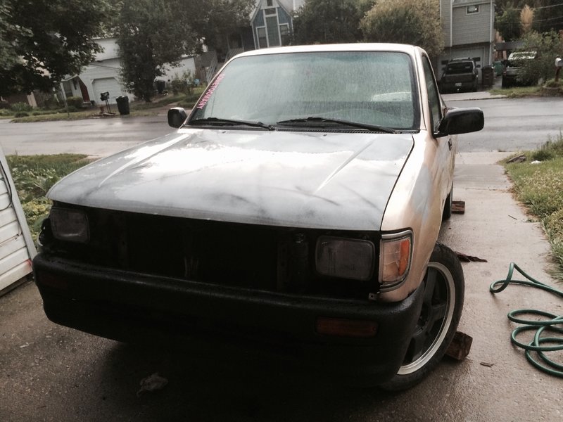

    Hey guys so I bought this truck with my tax return and got a little in over my head but am proudly turning this project around. When I got the truck it smelled like a dog house and claimed it used to be a farm truck. The kid claimed it was his uncles and was given to him...as I have it now the carpet is trashed the seats are out of an 80s Celica and mounting holes were drilled in the floor carelessly. Ac condenser is cut and removed...the air filter was panty hose....valve cover jb welded... Front springs are cut, rear has lowering blocks. And ebrake cables are cut and missing the parking brake lever that the cables connect to mounted 0n the frame...God knows why???
    My plans for this truck are for it to be my weekend warrior for when I go out of town to race vintage motocross.
    Things I have upgraded/plan to upgrade: 4Runner bucket seats(eventually want to trade for 60/40 bench so the wife can nap...), new carpet, condenser and compressor for a/c, 4Runner air box with custom intake and deck plate mod, 15x10 steel rims
    Things I need(donations?): stock 5 lug Tacoma springs, stock 5 lug rear u bolts. 15x10 steel rims, parking brake cables and lever under bed.

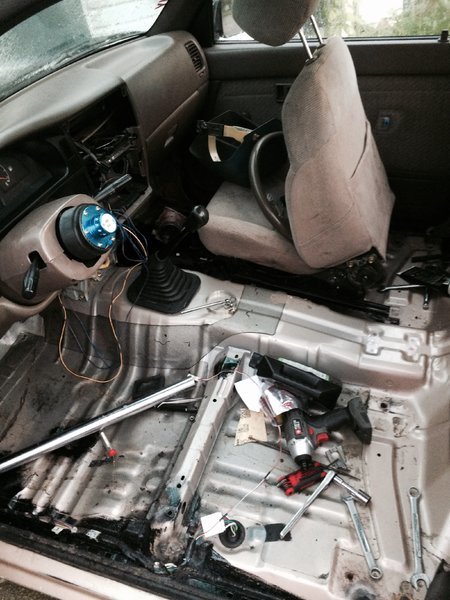

    I am currently in the process of welding all the holes shut so no moisture enters the cab. The carpet is torn out and I am fitting the 4 runner seats. I am using the legs from the bench seat and drilling the rivets out and welding the legs in place. The front inner mounts in the 2nd gen 4Runners are the same as first gen tacos the front outer brackets from the bench can be used to fit and the outer rear should be moved to the inner rear and welded jb place. The only bracket that needs to be fabricated is the outer rear. I will post detailed pictures later. Personally for the fabricated bracket I just cut a section out of one of the unused brackets to make it work!image.jpg

    Forgot to mention I am also using a heavy duty rust preventative paint to prevent any rust from spreading. I will also apply it to any metal that was welded as that is usually the first to rust.

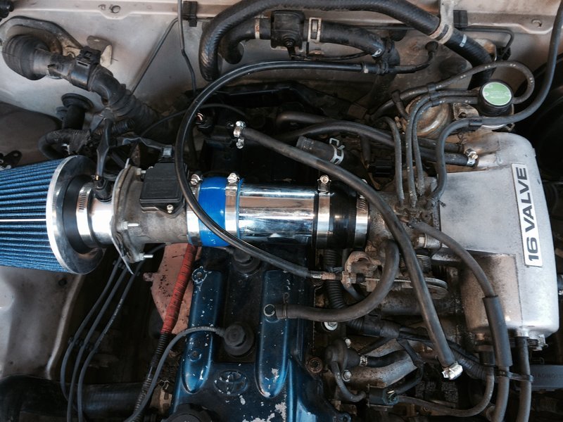

    Your cold air intake is sucking in air right off your exhaust manifold. Did it not have an intake tube when you bought it?

    No this is how I bought it. But I have built a great intake with the 4Runner air box since I bought the truck. Will post pics tonight.
