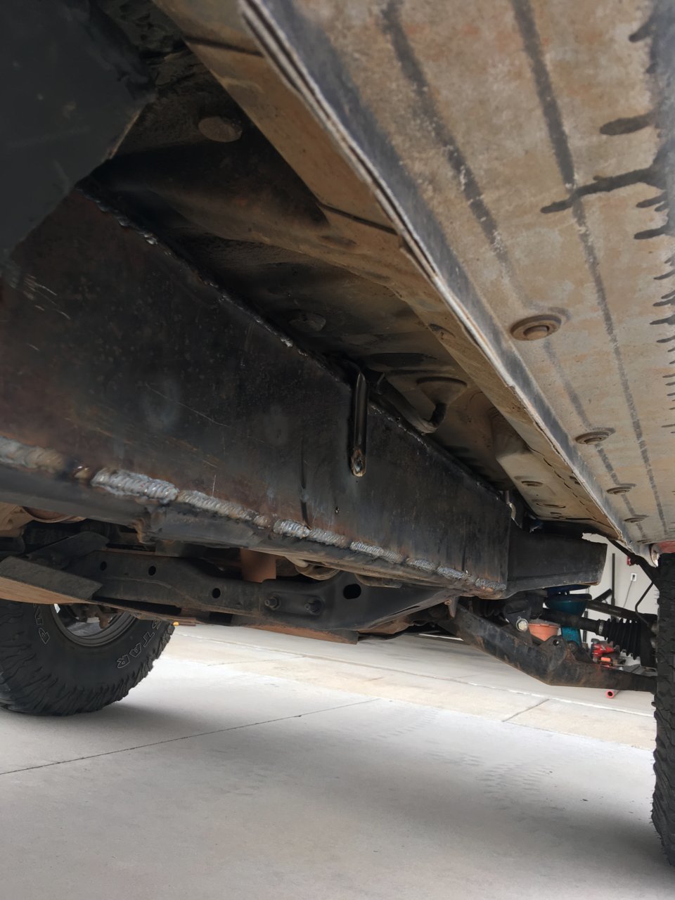

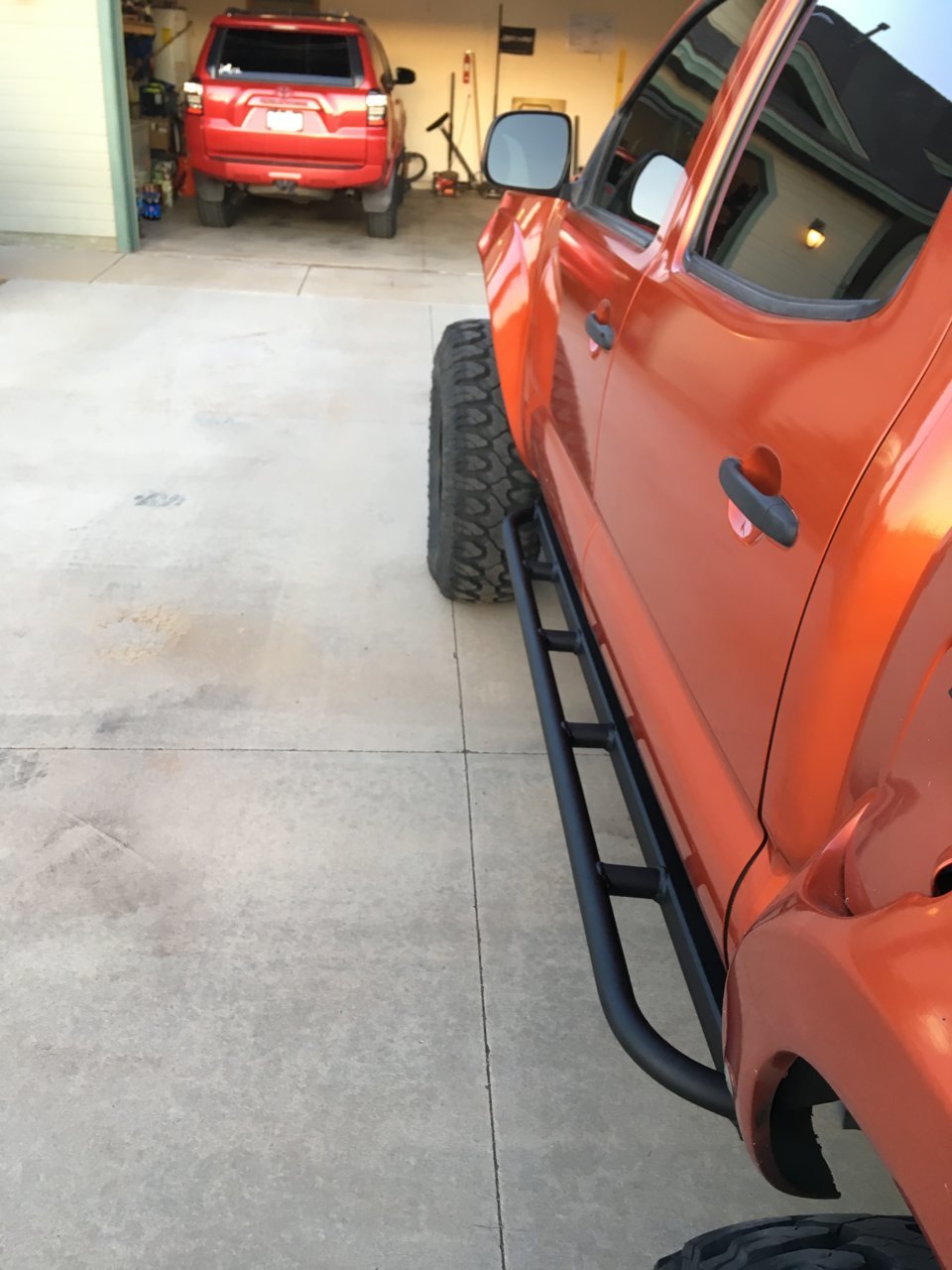

    Only 7 months after bending the shit out of my old sliders, I finally finished chopping the old legs and plate off the frame. And to give the new sliders a fresh start, I did some 3/16” plate overlays down the frame. Rosette welded all the factory holes on the back side of the frame.
    Next step will be to fold over that pinch weld so the new sliders can tick up nice and close.

    Mmmm 1/4” beef. These suckers are gonna be strong and totally overkill.

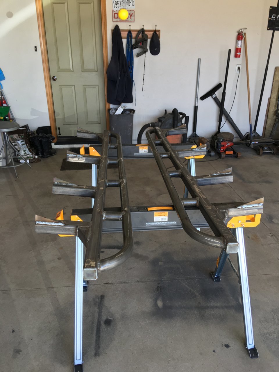

    And done. They’ve got a slight taper to make them stick out about an inch further in the back than the front. Kicked up at about 7.5 degrees. And bent the pinch weld back underneath the door seams to tuck them up about another inch than they could before.
