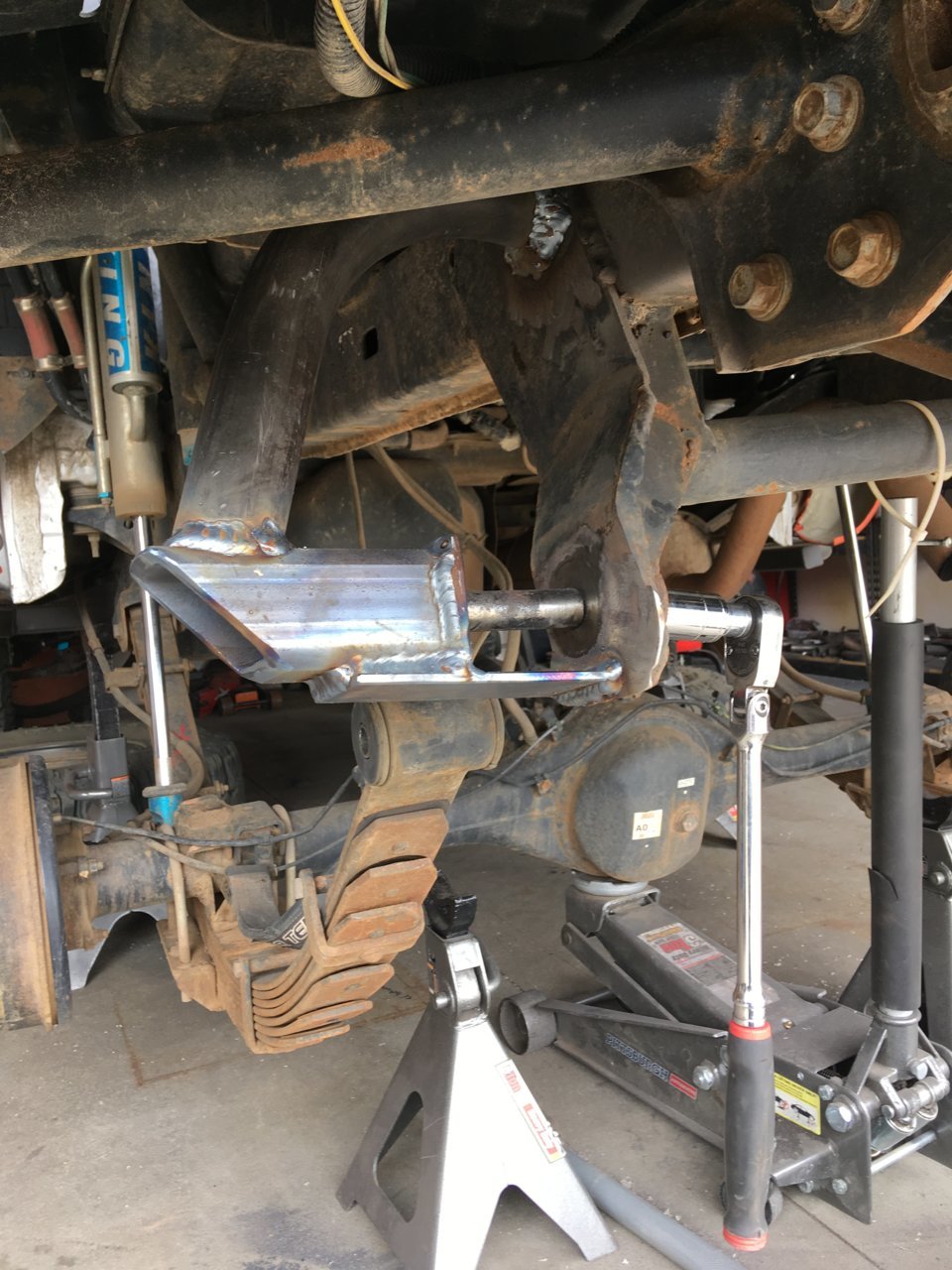

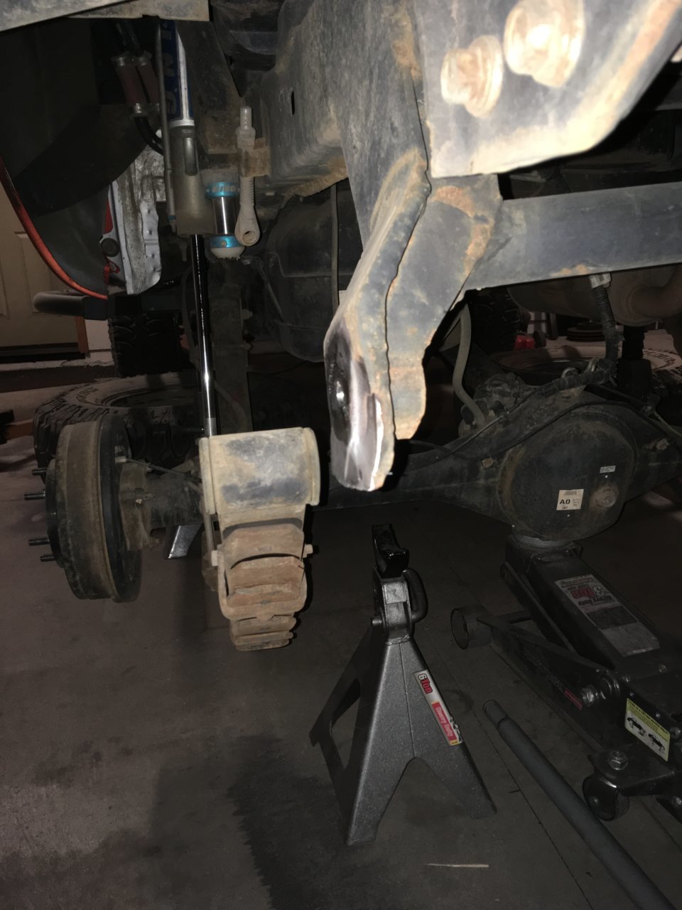

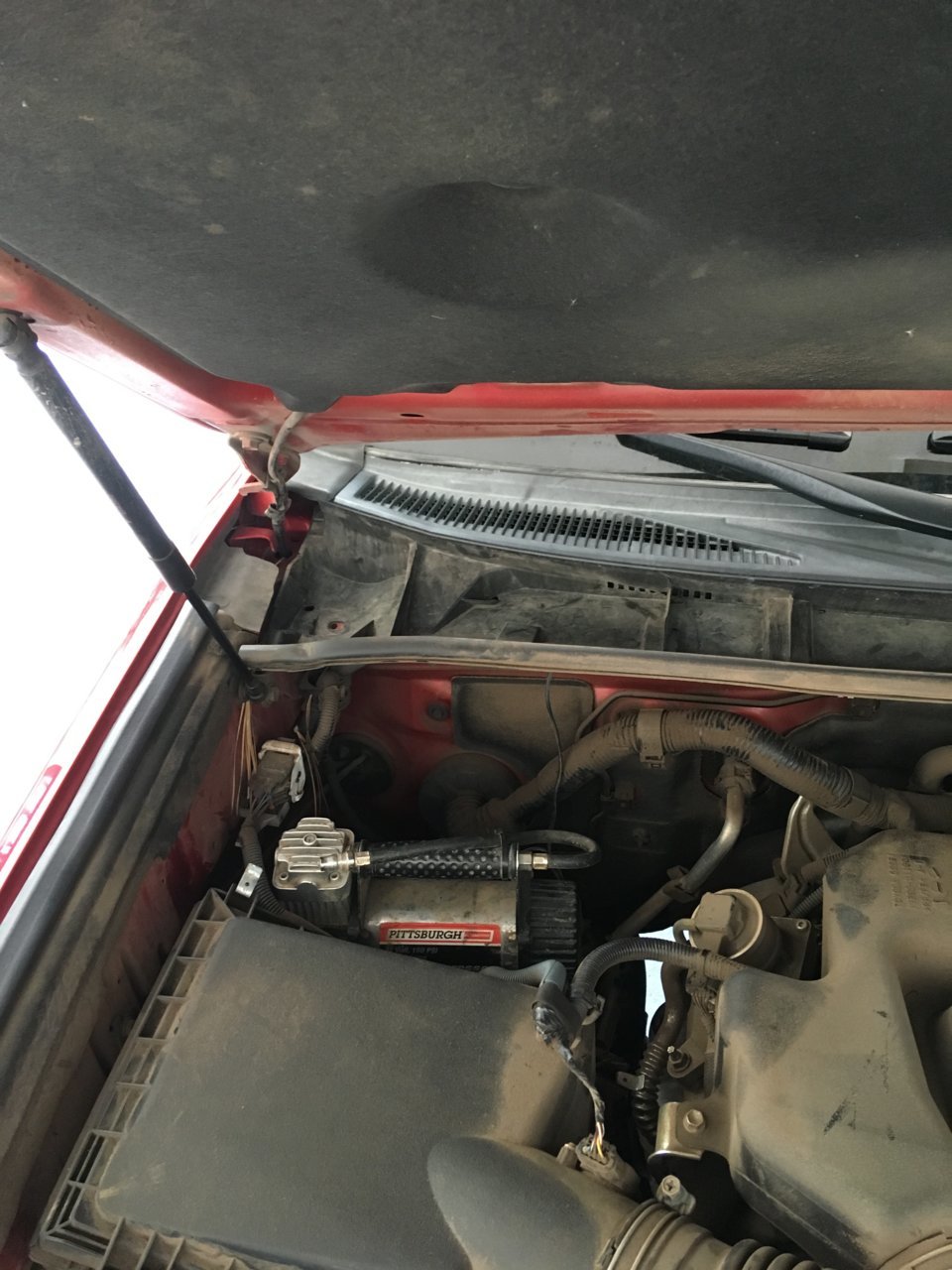

    I did manage to hopefully finish beefing up my rear shackle hangers for the last time.
    Used some leftover 1/4” wall from my sliders.
    And mount my old compressor in the wife’s 4runner.

    Couple questions - were those square tubes hrew in your slides? Can I see how you attached the extension to your HF jack - been planning on how to make one too and not spend like $100 for a pro eagle one which may still not be high enough.

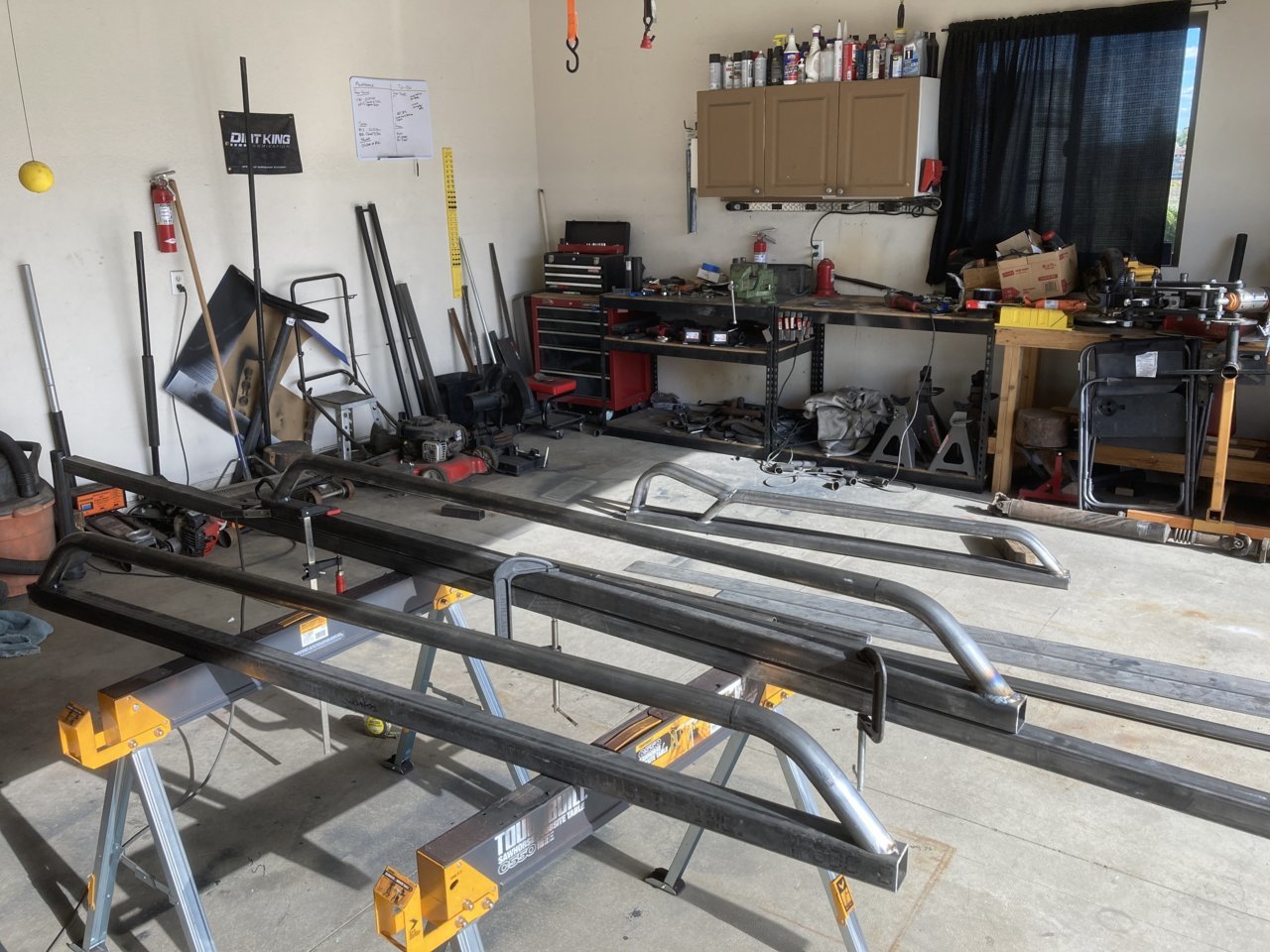

    Yes my new sliders are all hrew, but all 1/4” wall so much stronger than .120” wall DOM.
    And without pulling everything apart, the bottom of my extension has a plate welded to it with a hole in the center. E2857765-49E7-49F5-99A3-982BEAE460C1.jpg
    I replaced the pin with circlips with this hitch pin and then the green circled pin that normally holds the circular base plate drops down through my extension and holds it in place.

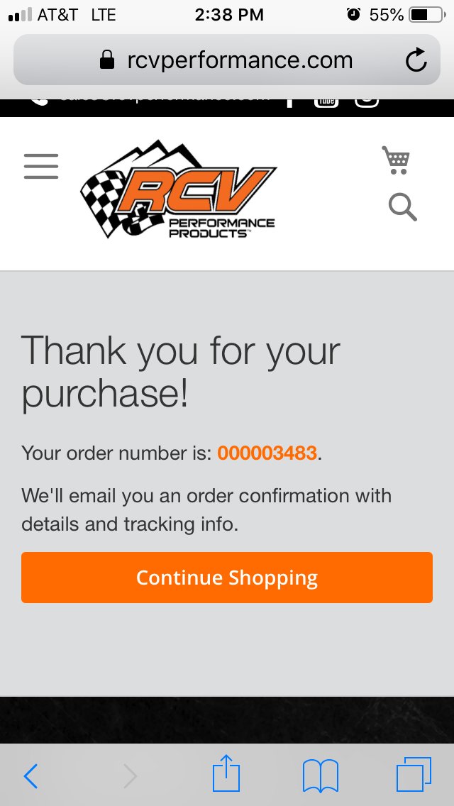

    Well... not using the stimulus check, but had a feeler on my current axles and got called out. Time to worry less about axles with the 37’s...maybe

    Haha found the meme yesterday so technically no since working out the current axle sales took a few hours. I did make an RCV account and have the axles in the cart about halfway though working out the selling details though
    Edit: if you need more pics of the jack mount and extension setup I can get them this weekend. Just let me know.

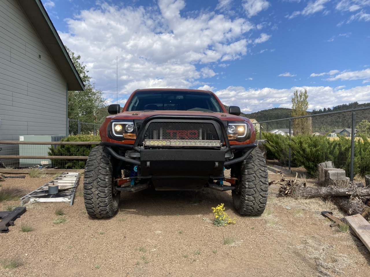

    Little updates and a laundry list of little things I’ve been trying to work on.
    First, I added some hood louvers and moved my intake a little to try and lower intake air temps since they jumped up about 40 degrees in warm weather since doing the engine cage.
    And got my tune updated with some minor tweaks and an extra spicy trans tune. Truck runs better than ever.
    Next is some much needed wiring tidying up. Top=new, bottom=old.
    Painless wiring fuse block and no more bundles of wiring and 5 power wires bolted to the battery terminals.
    Boo on the front end work though as I found out both headlights have broken tabs and one is leaking. Guess I need to start saving for that and make some better tabs off the cage for the new ones.

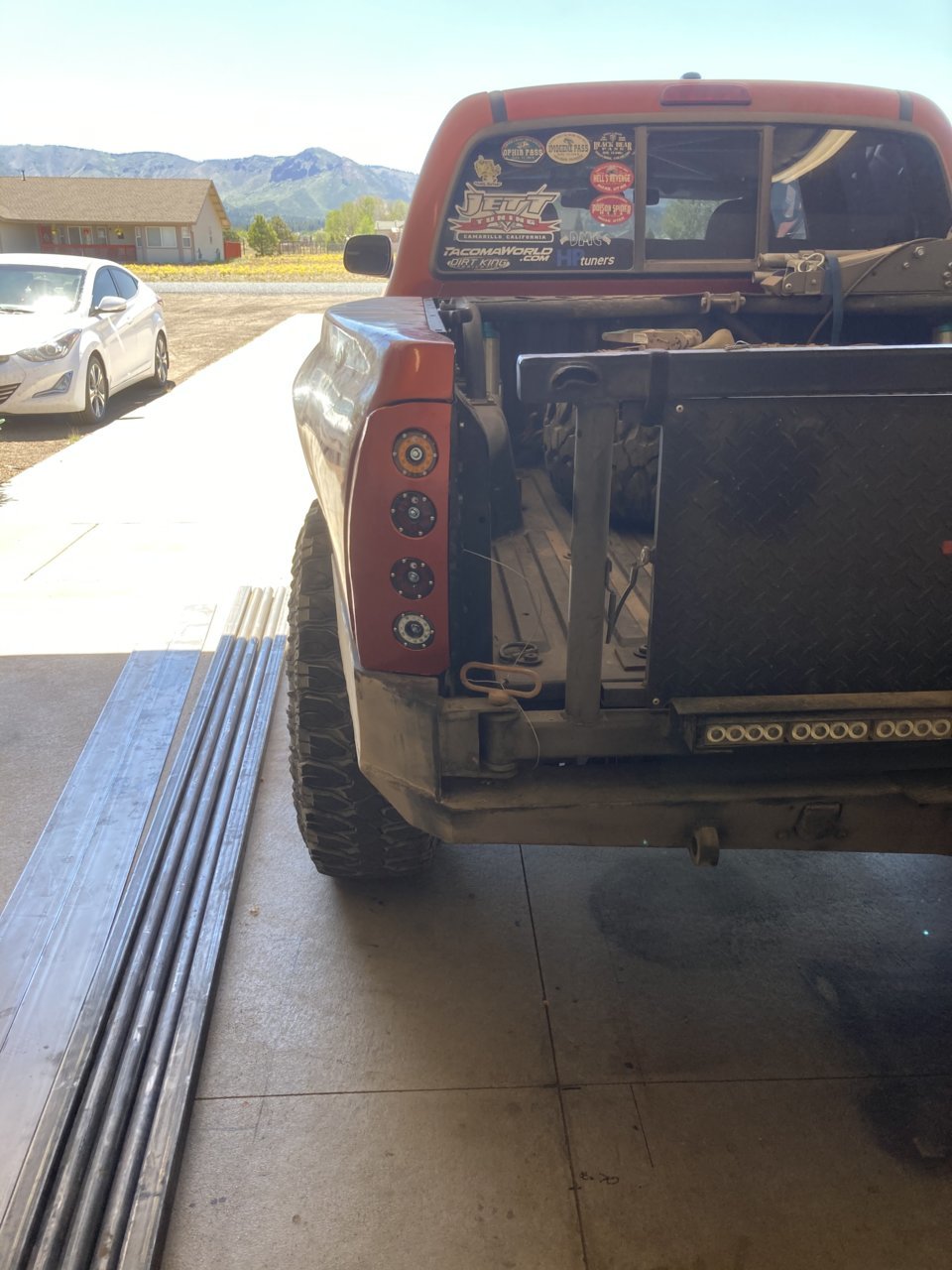

    Started on some tail light housings that will house KC Cyclones for new tail lights.
    Also on the to do list is to fix/ add more rock lights and connect them to the new fuse block.
    Wire the amber turn signals with a secondary switch and maybe a strobe unit to act as chase lights as well.
    Last but not least is to freshen up the rear suspension.

    What gauge are you using to make the tail light housings?

    16 gauge. Just winging it really

    My sheet metal work isn’t the best, but I managed to get one done and wrapped in some extra vinyl I had laying around.

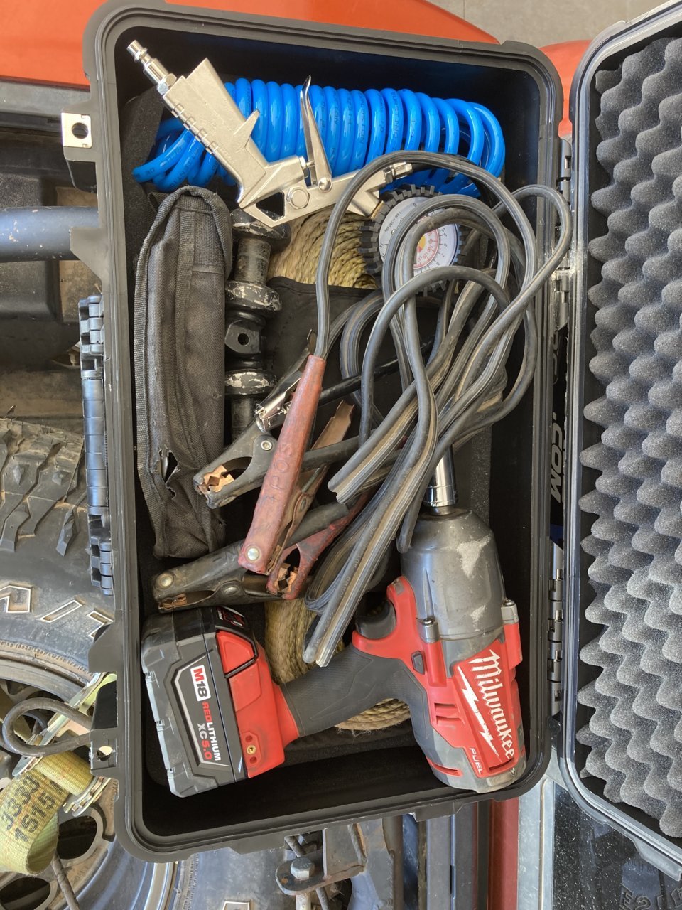

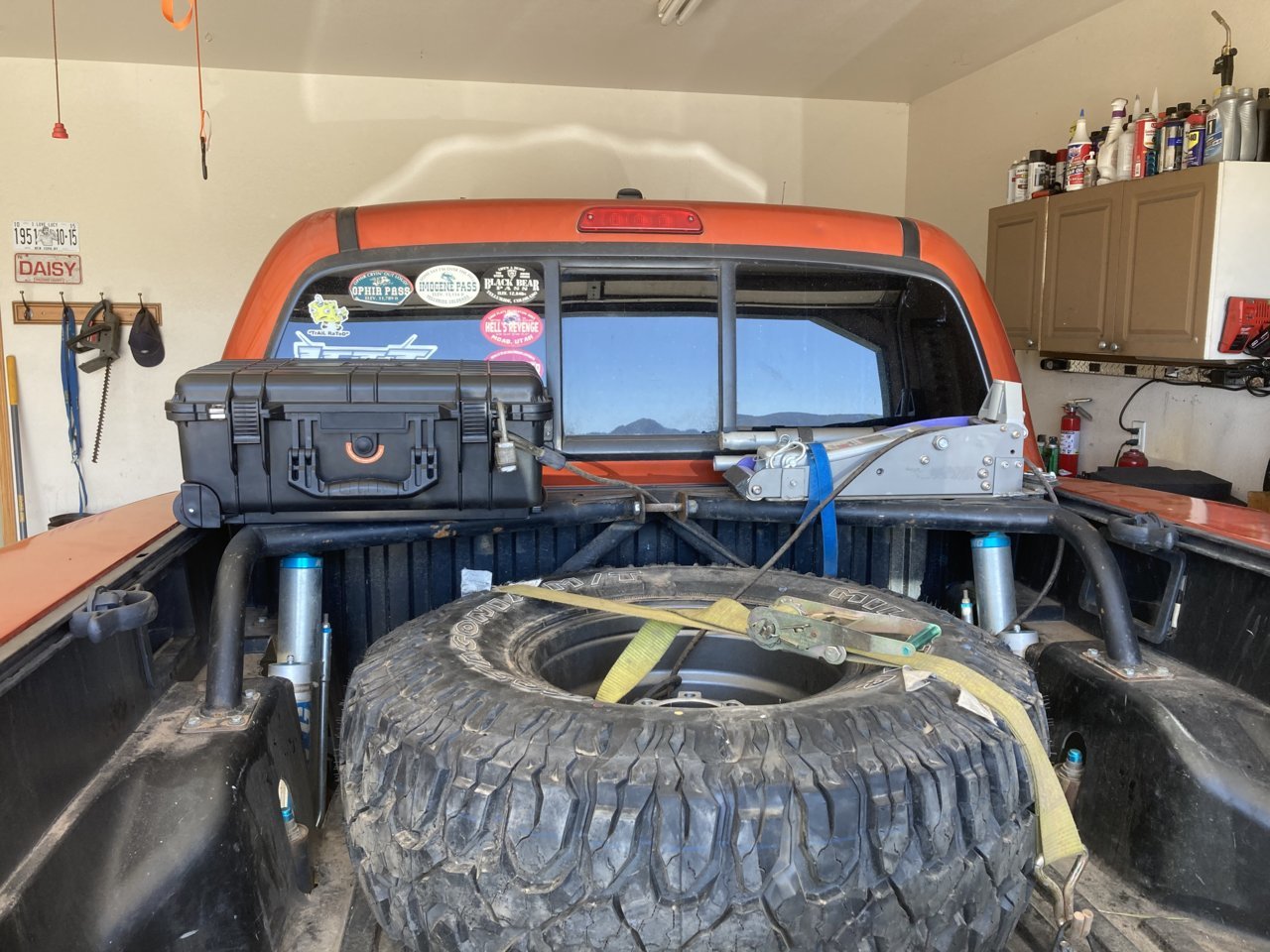

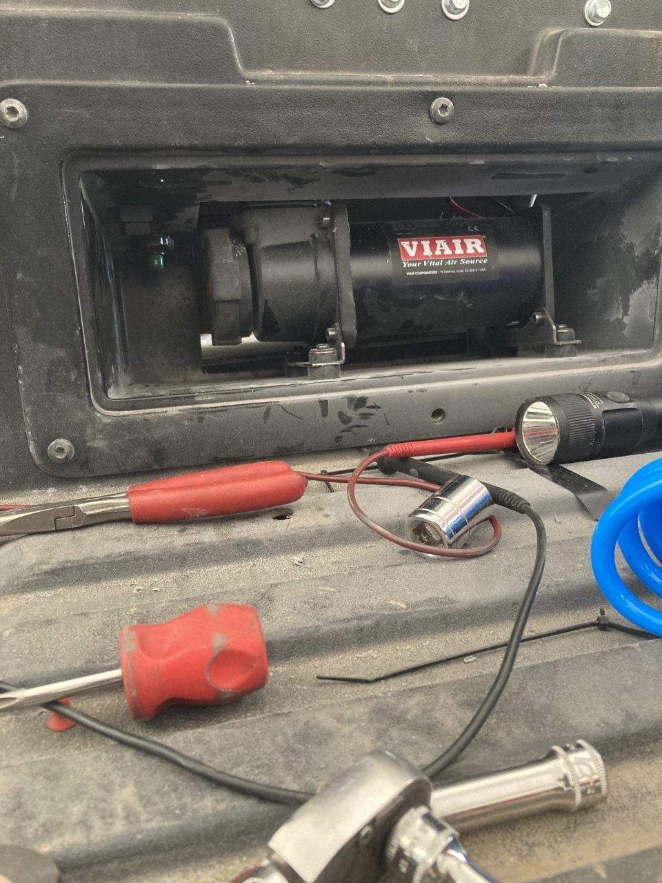

    Few little add ins for the truck in the last week or so.
    Twin Viair 425c compressors got installed behind the bedside and in the little cubby. Took one tire from dead flat to road psi in 3.5 min.
    And added a little storage box to the top of the bed cage for easy access to recovery items, air hose, impact and what not.
