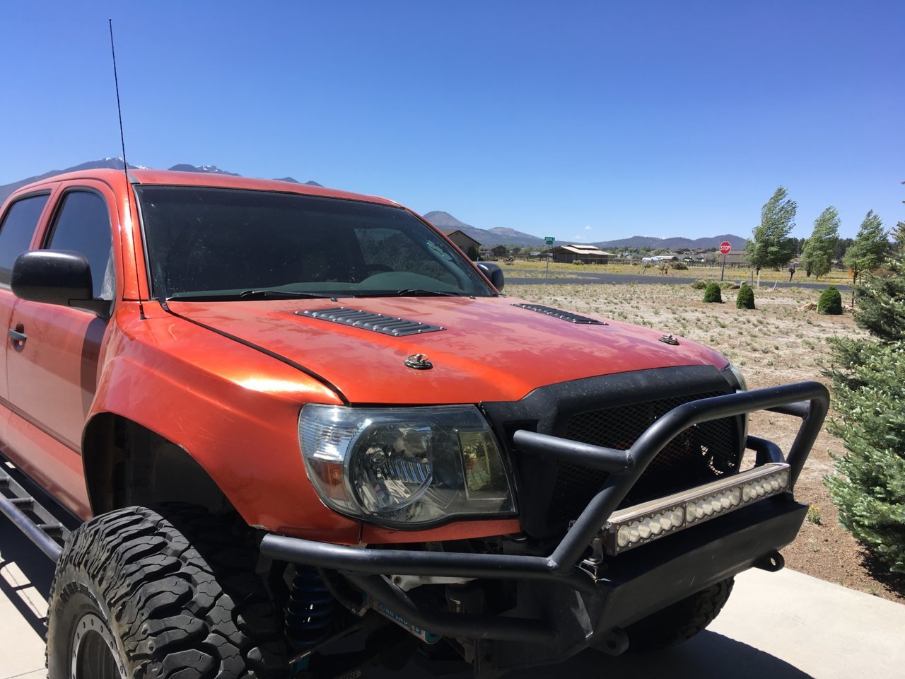

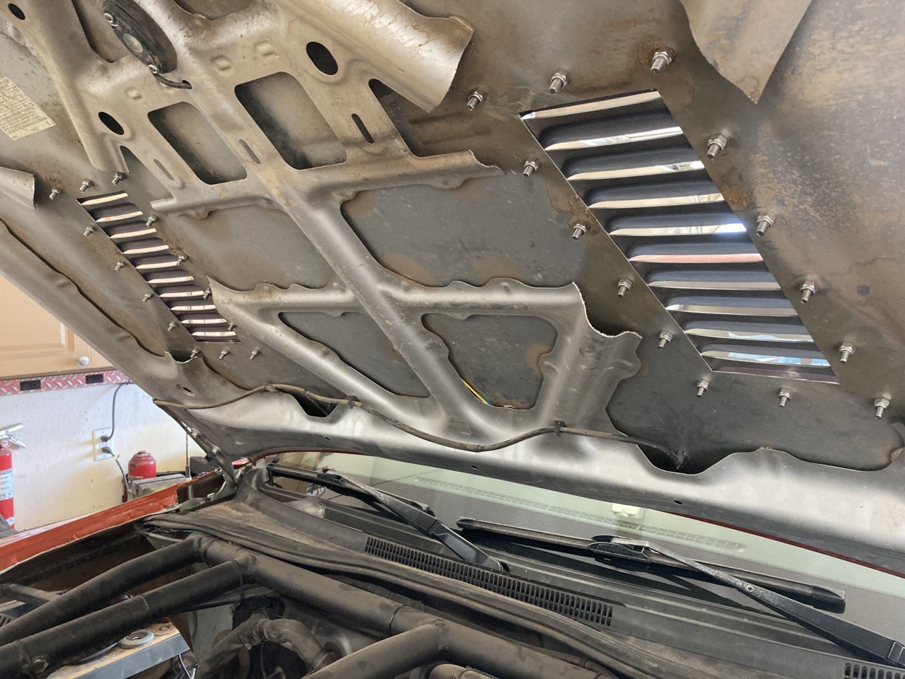

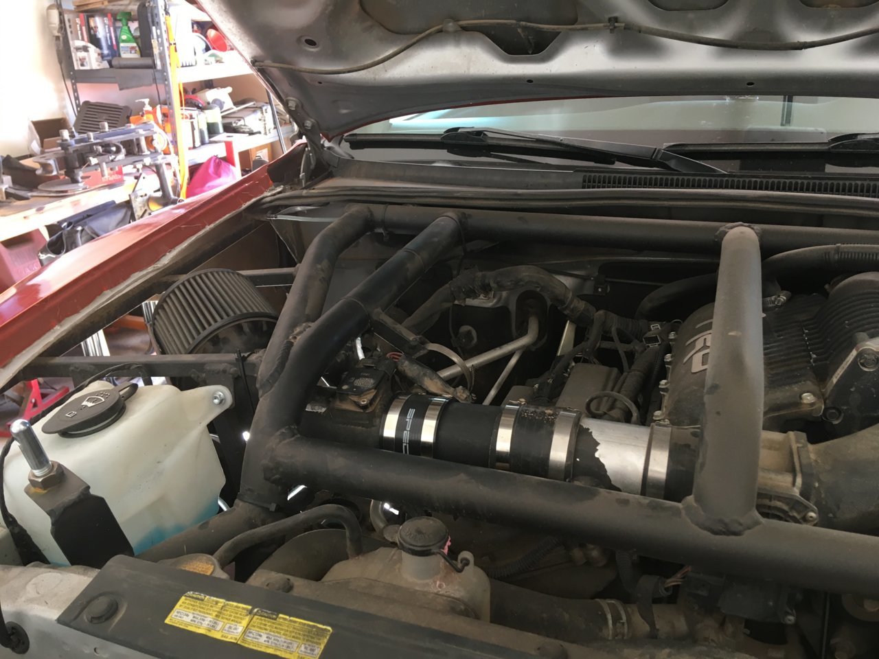

    not sure if this is what you want. Kinda a pain to pop the hood with where I park in my garage.
    But yes I did notice a difference. My metric for comparison was intake air temperature as I noticed it had skyrocketed when I did the engine cage and moved my air filter. First step was to move the air filter further out into the wheel well where I was seeing IAT’s on a mid 80* day somewhere around the 100-110* mark depending on cruising speeds. After the louvers it dropped my IAT’s to 85-90* in similar conditions. They still jump up at slower speeds or when idling, but are probably 15* cooler than without them. You can see the heat pouring out of them though when idling or after you park

    That’s perfect thank you. I’m running a snorkel and the intake pipe gets crazy hot during our South Carolina summers.

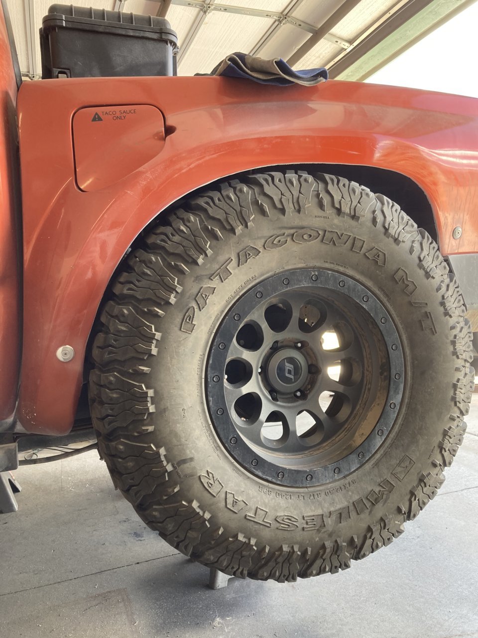

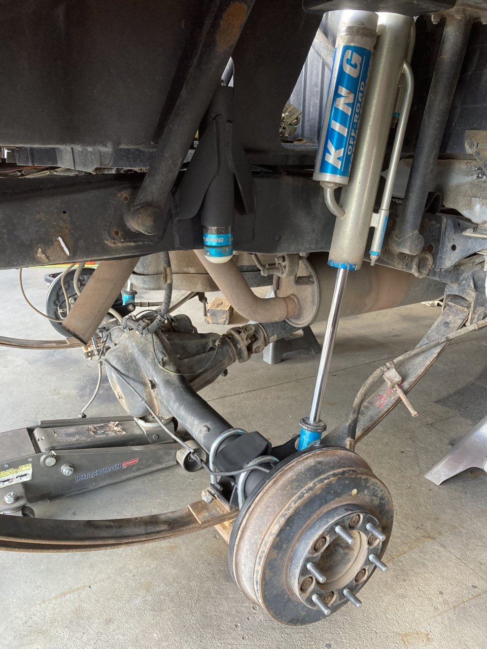

    Some time consuming but minor tweaks to squeak out some more travel out of the rear ended. Bumps moved up an inch or so and now squeaking out right at 17” of travel. C87D8AF9-79BE-41F8-A0BE-B8F5D46C3A2B.jpgAD5E8CB0-8783-4BD0-84CE-85E936E73542.jpg 499DBC0F-1BD0-4D67-9F4A-B2DB72B50A31.jpg
    Fenders needed a touch of trimming but not much.
    Honestly with my modified shackle hangers I could probably get closer to 19-20” of travel if I made some longer shackles, but leafs would separate and after talking to Tim at dmz the travel wouldn’t be “clean”. I’d rather stick to tuning what I’ve got until the jump to links in a year or two.

    Digging the hood louvers! Did you get the inspiration from watching Matt’s Off-road Recovery?
  14. Oct 7, 2020 at 12:38 PM
    #574
    snowsk8air2
    snowsk8air2 [OP] how hard can it be?
    Sep 16, 2011
    #63607
    10,571
    Flagstaff, AZ
    Supercharged TX Pro
    2011 S/C and basic mods
    Thanks and no, no inspiration from anything other than me wanting to cool down intake and engine temps.

    Where did you get the louvre panels?
  16. Oct 7, 2020 at 12:43 PM
    #576
    snowsk8air2
    Sep 16, 2011
    #63607
    10,571
    Flagstaff, AZ
    Supercharged TX Pro
    Amazon. If you search there’s a bunch of different styles. These were chrome but I painted them before install

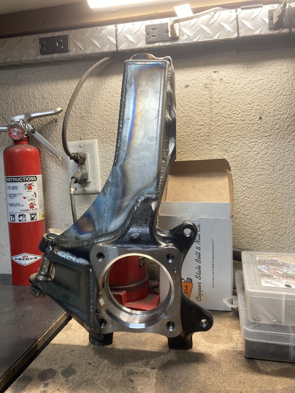

    Ooh, new spindles featuring the JD Fab gussets and double shear steering. Best fitting and designed gussets I’ve installed thus far so I’m glad they are for me.

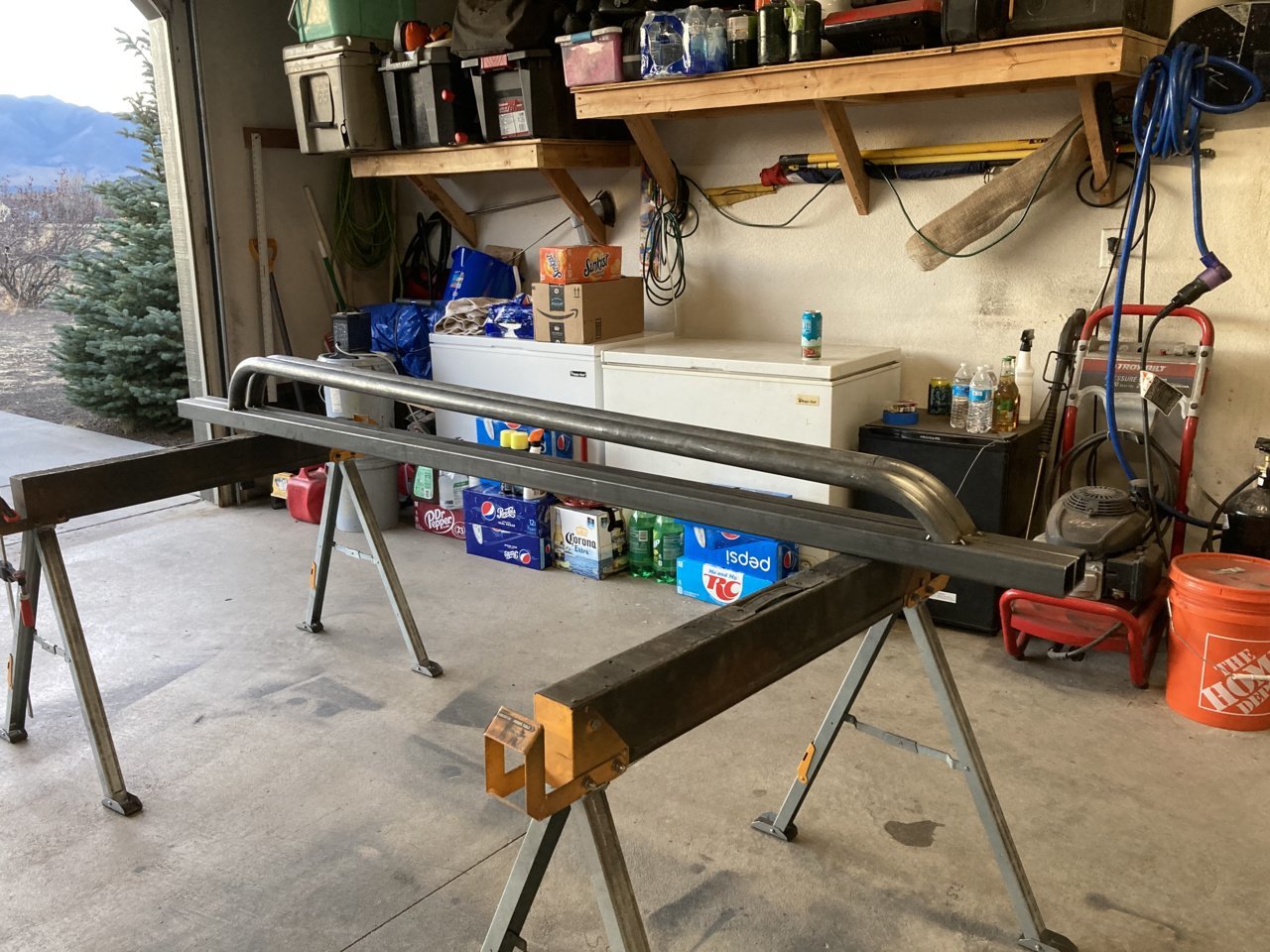

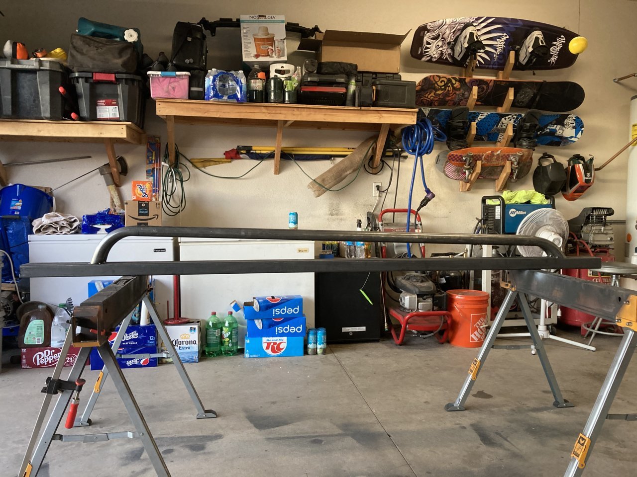

    Some newer tundra sliders in the works.
