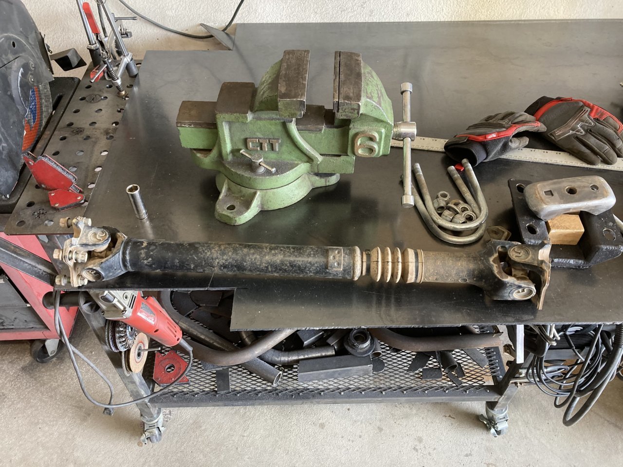

    And did a 2wd low mod and pulled the front drive shaft.
    Such a cute little shaft.

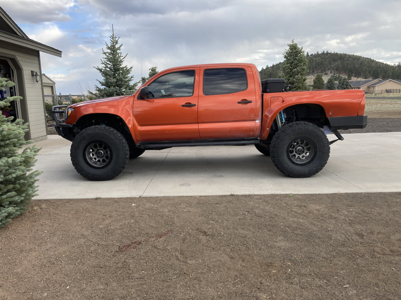

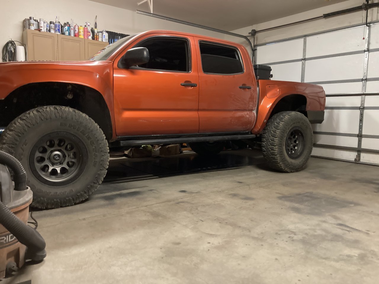

    Back on her own 4 feet again. At least for a moment.
    Final stats come in as such:
    18" of travel, drive shaft is the limiting factor.
    10" of bump travel at ride height, so 8” of droop. Shackle is at 47* back at ride height (goal was 45*).
    At droop the shackle is 12* back (goal was no less than 10*) so even if I had the ds shortened I wouldn't gain much more travel. Probably take it to 18.5-19”.
    So, gonna call it good at that and just strap it there.
    Need to strip it down so I can set bump strike pads and shock mounts. Run brake hard lines. And run electrical for the locker and wheel speed sensors. Goal is driving by Tuesday

  4. May 2, 2021 at 4:46 PM
    #724
    snowsk8air2
    snowsk8air2 [OP] how hard can it be?
    Sep 16, 2011
    #63607
    10,206
    Flagstaff, AZ
    Supercharged TX Pro
    2011 S/C and basic mods

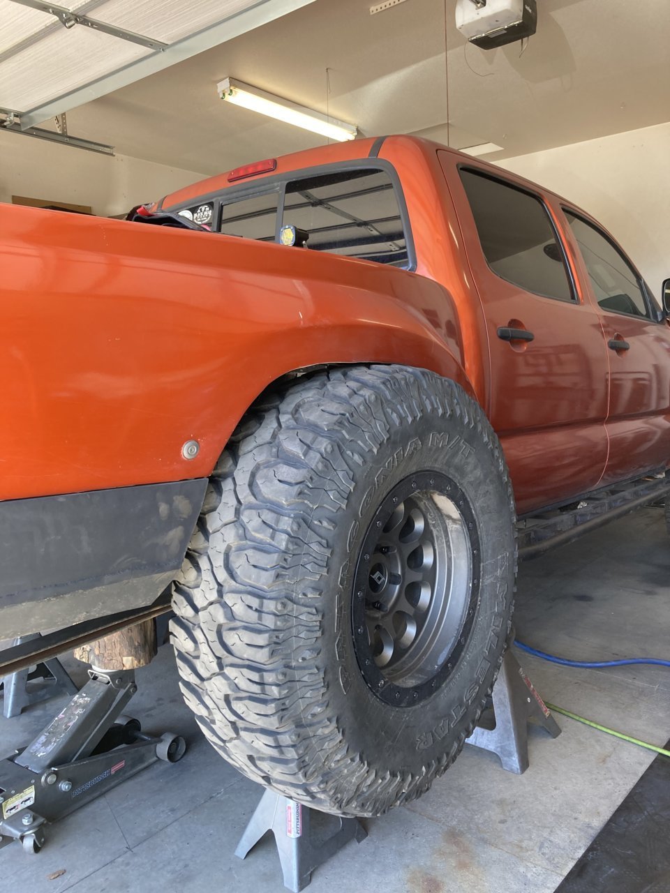

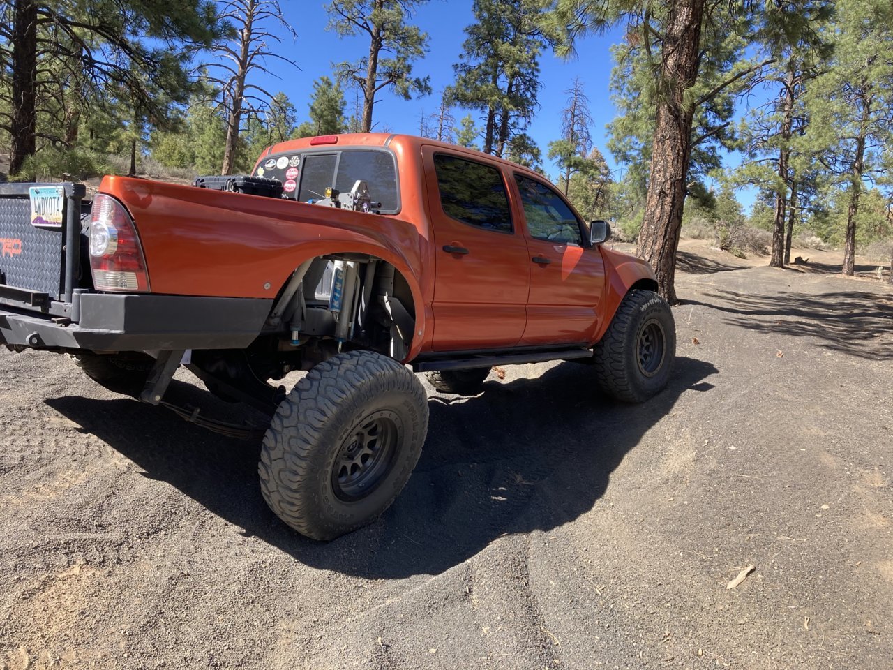

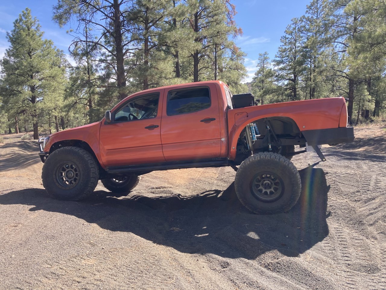

    FAD4CFC8-57BA-4C63-A892-E9D158A82C73.jpg 474C3F1C-3ECC-4CEA-A2B5-EB6FAAB52478.jpg
    First drive just happened. She's sitting a little proud in the ass but that's ok. I'm waiting on new limit strap clevis's so I'll pull my add a leaf out next weekend when I set limit straps.
    Other than that the 5.29's are gonna be great. Sitting at 2k rpm at 65 and 2wd low is low. Only negative comment on the first drive is brake which I figured would be bad. I'll need to ditch abs and get the tundra master cylinder and brake booster to make them work good

    Second drive and this time in some dirt. Pulled the add a leaf out and it’s sitting much closer to where I want it for ride height so this will probably be where it sits.
    Bad luck with u-bolts and center pins cost me probably 3 hours of running around town and cutting shit off which was frustrating. But got it done.
    In the dirt the rear seemed to have a good bit of side to side movement even with the shackle sliders so I ordered up some delrin upper shackle bushings to try and keep the flex down some.
    But talking about flex...
    The high tire started rubbing bumper so I’ll need to trim that up some more to truly fully flex it out.

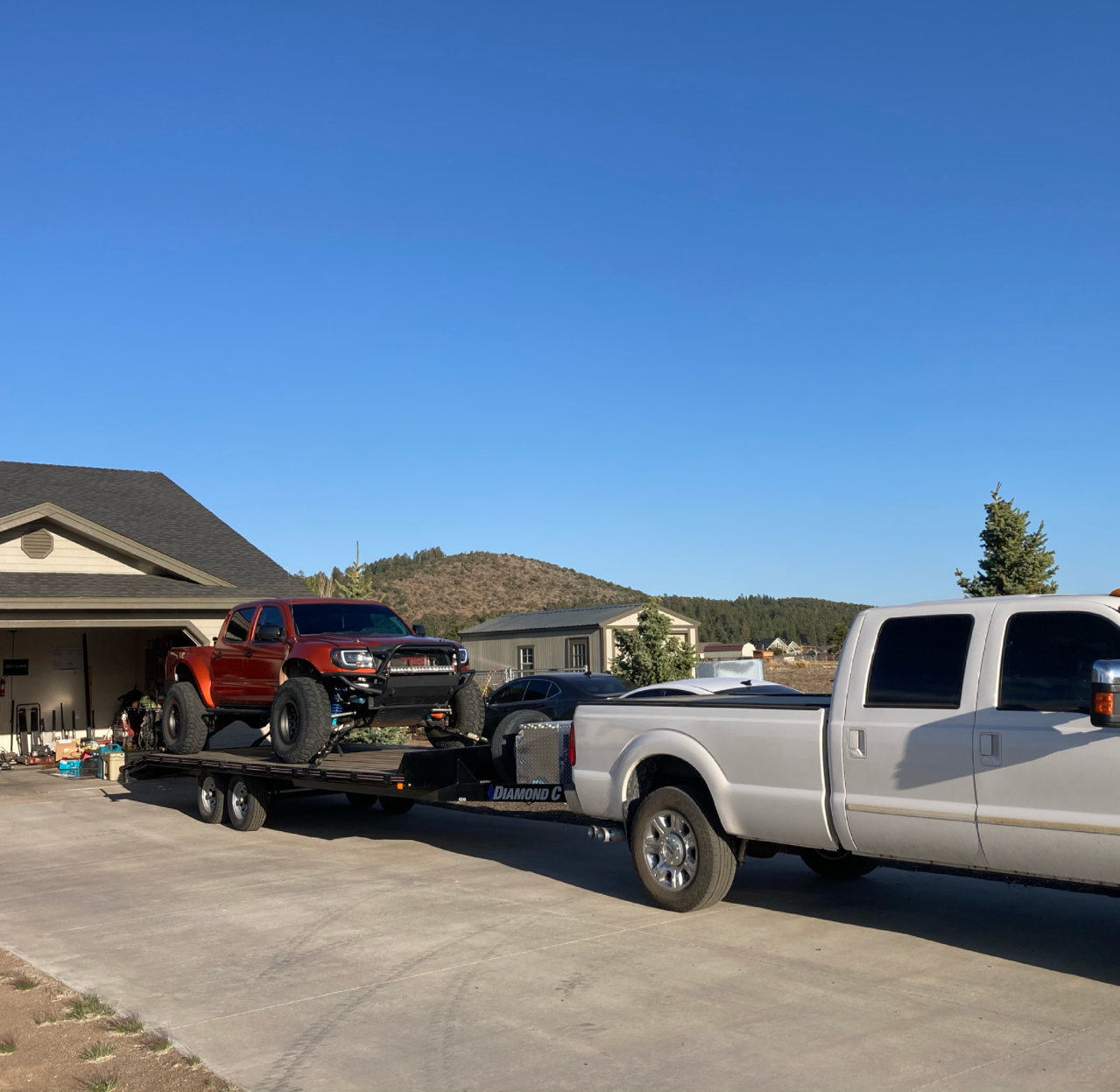

    Ready for some real testing this weekend.
    Excited to get the anti wrap bar in the next week or so. But a little late for this weekend but real excited for the 5.29 gears. 2wd low just idled up the ramps onto the trailer
