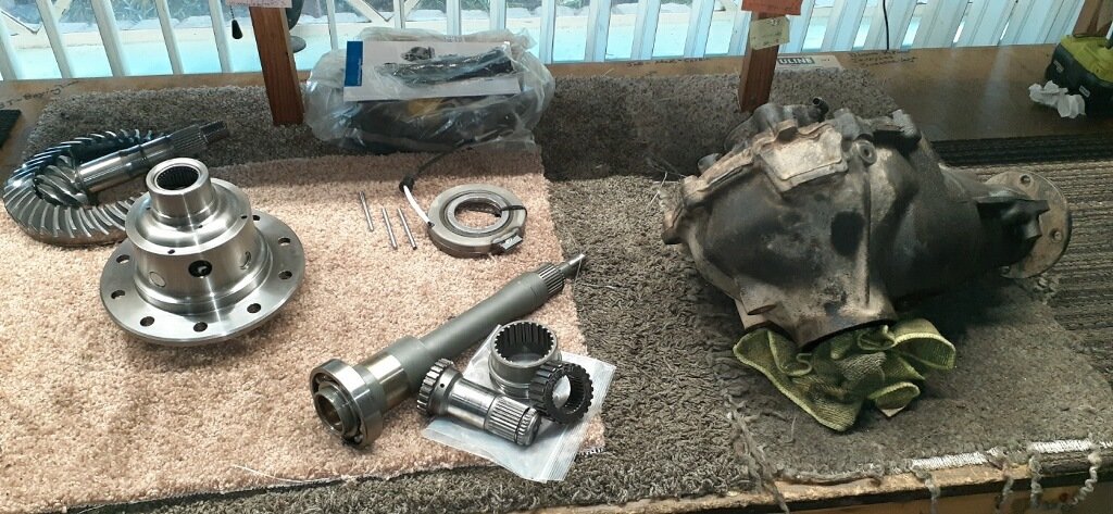

    Way too much lacking of beers for these types of late night shenanigans. But it’s finally time to get 4wd back. Going with 5.29’s, REM polishing and cryo treating the ring and pinion and a Eaton e locker. Also having the little axle and stub shaft from the ADD cryo treated. We’ll see how long it lasts haha.

    Mmmmmmm parts back from REM polishing and cryo treatment. Ready for Zuk to build the front diff for me to pick up this weekend.

    4wd up and running again and it feels great.

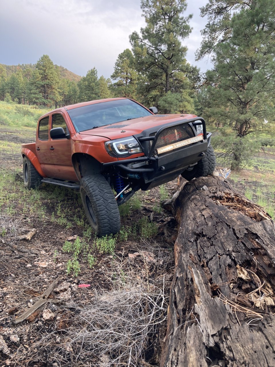

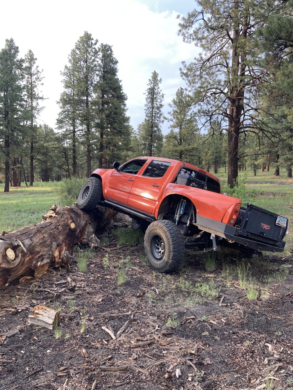

    Any damage from that ledge on the pumpkin / DS?

    Nope all that cleared. Drug the pumpkin on a few diff grabbers throughout the trail but never the ds. Glad the anti wrap bar sort of acts like a guard for the ds. And glad I added a piece of 1/4” on the bottom of the diff as a “skid”

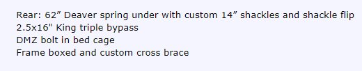

    Are your rear leafs outboarded at all or are they still stock width? Need to get rid of my stock shackle hangers asap and going to switch up to a setup like yours with the shackle mounted mid way on the frame. Thanks

    Ryan can go into further explanation of his setup, but the short answer is yes. Was originally DMZ I believe. :thumbsup:

    What he said. The frames on these trucks dove tail some after the cab. So the front leaf hanger has the leafs sort of straddling the outer edge of the frame but the rear is completely outboard of the frame.
