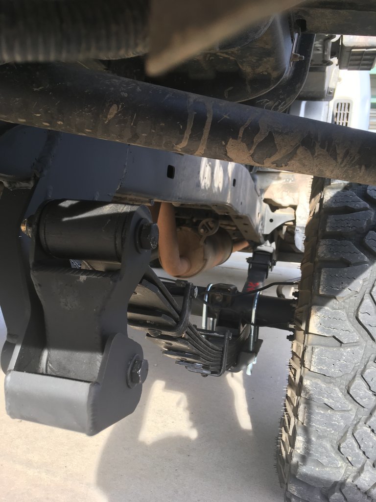

    Buttoned up the sua today. Just waiting on shocks so I can cycle everything and set bumps and straps. Lost about 2" of lift but a quick test drive has no driveline vibes at least up to 45mph

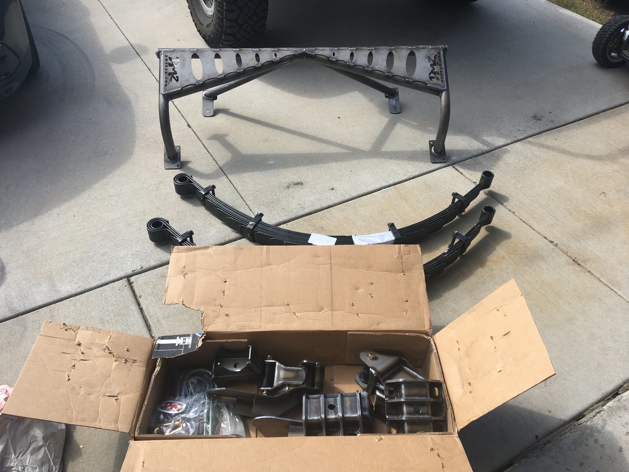

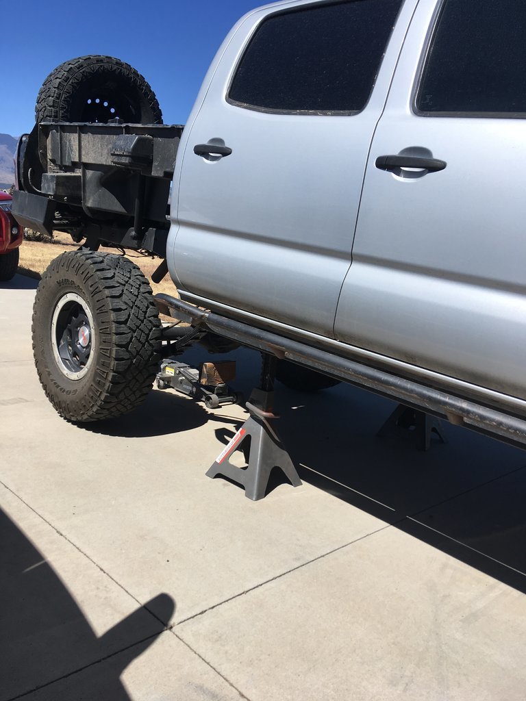

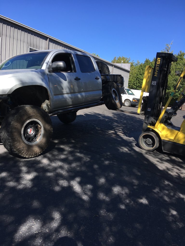

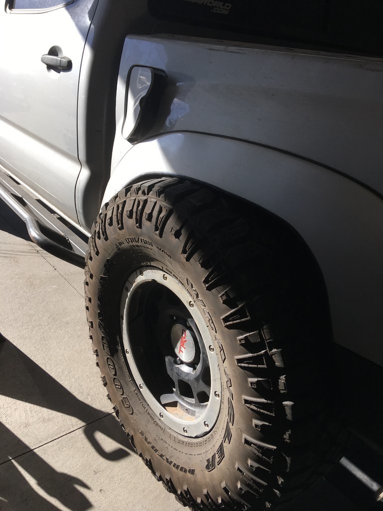

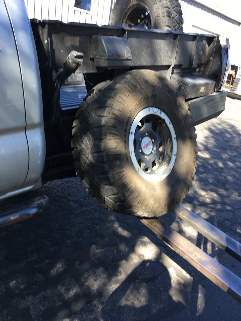

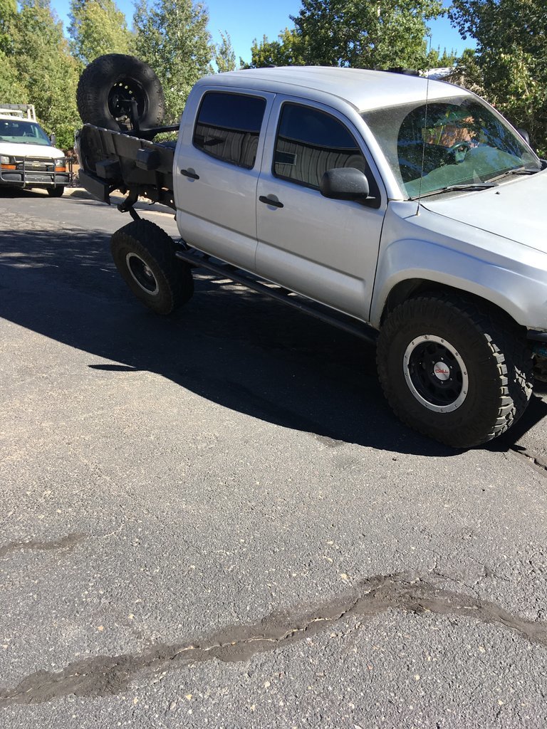

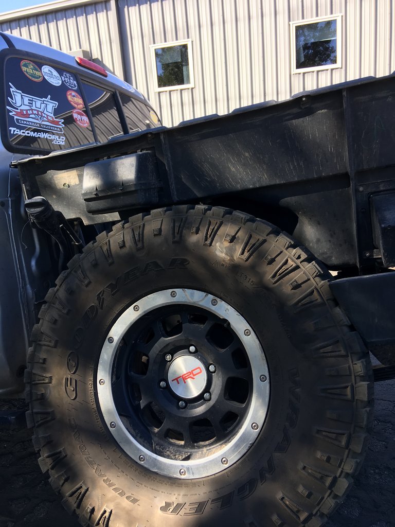

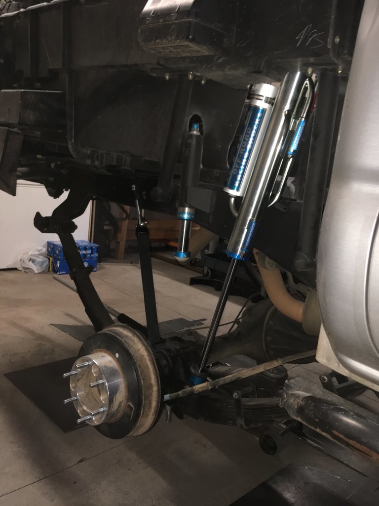

    Had a spare car and garage space last week so I spent the last two weekends doing the actual sua install. Just been waiting on shocks so I can tear down the leafs and set my lower shock mount and bumps. Cause driving around without shocks is a little sketchy lol. But did get to play around with the fork lift a bit on Monday and flex it out. Tire rubs on the bed cage and rear bumper, but that's right around where it will probably be bumping at, so we shall see if it is going to be an issue or not.

    Looks good. What kind of travel numbers is it looking like?

    Didn't actually measure anything. Guessing it will be between 16-18"

    Well I was able to lift the tire 34" off the ground on the fork lift before the other tire came off. So that means I have 34" of travel right? :notsure:

    So 17" per side :)

    Probably true. Like I said it'll probably pull 16-18 when done.

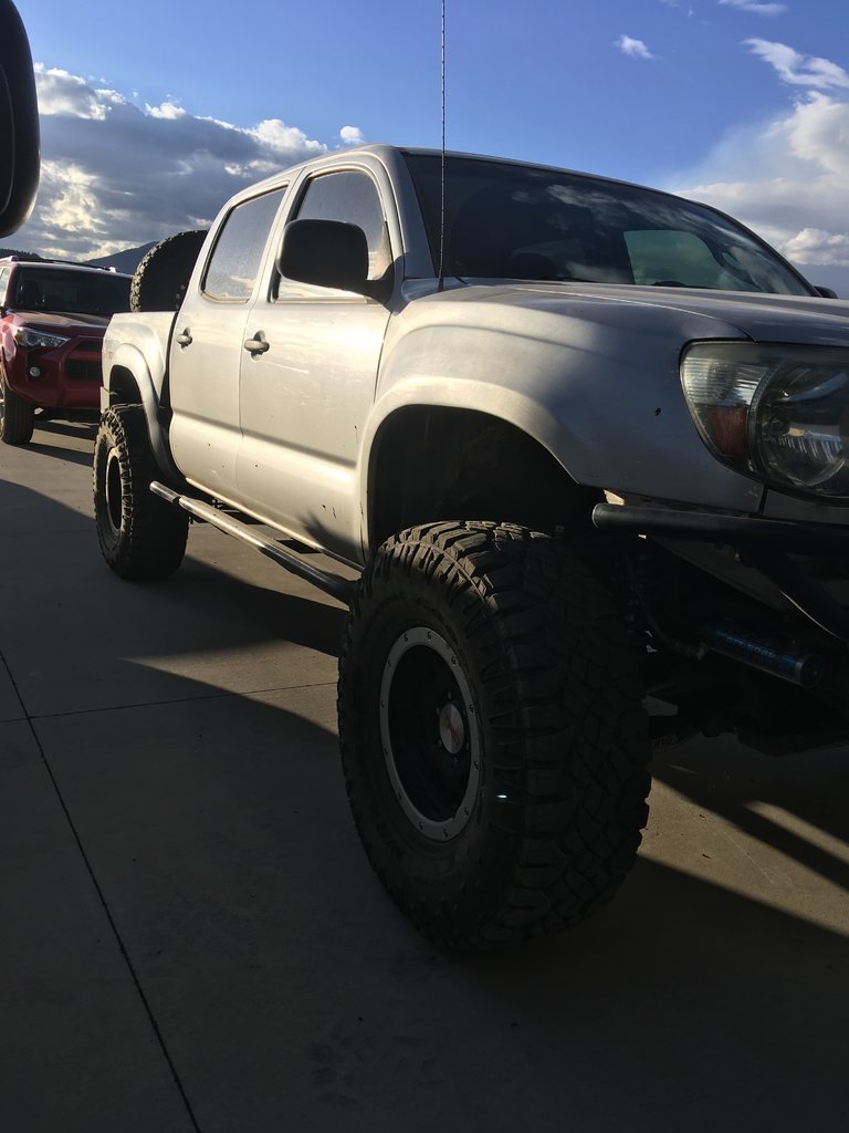

    Only 16" after setting my bumps. And either gonna have to trim my fenders another inch or so, or commit to the group buy on fiberglass. Terrible pics but I'll get good ones and some videos when it is all said and done.

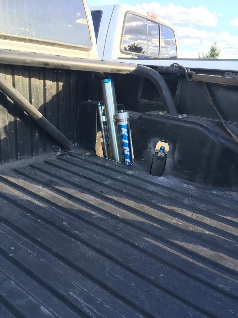

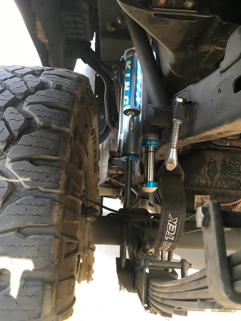

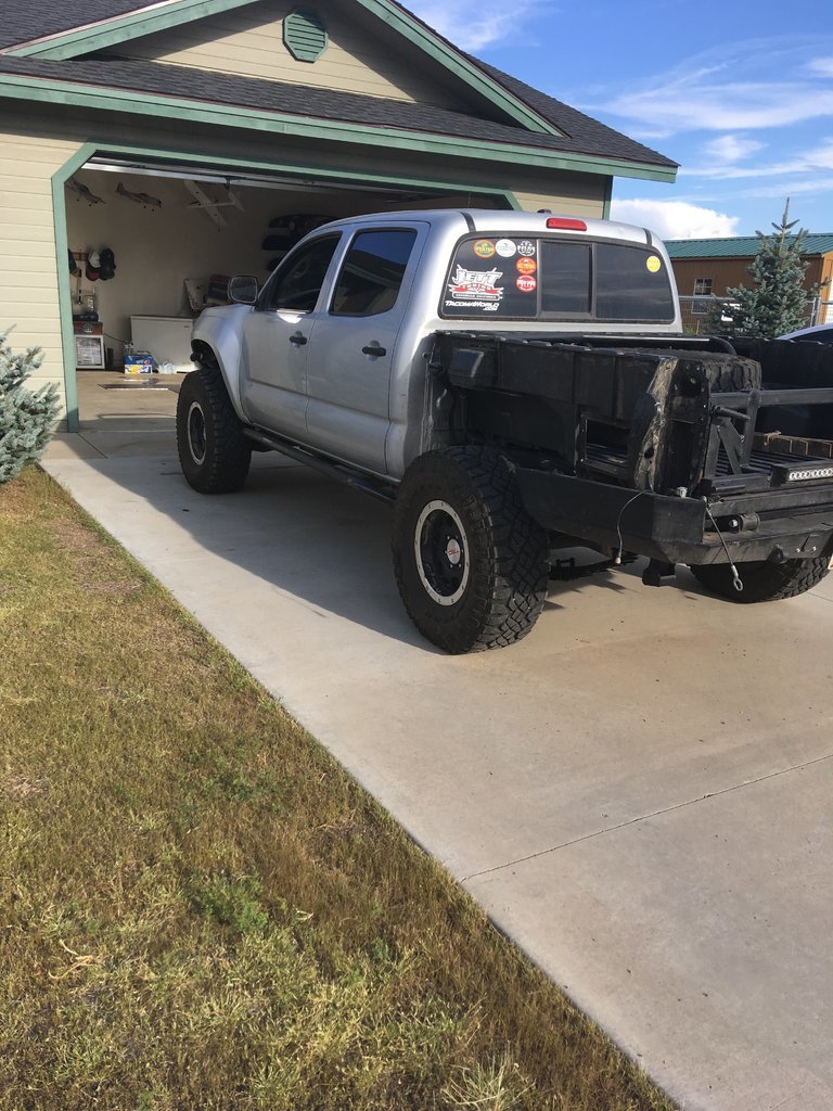

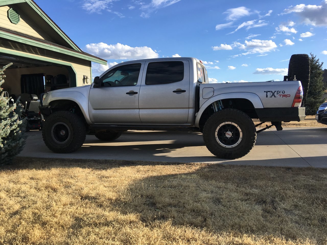

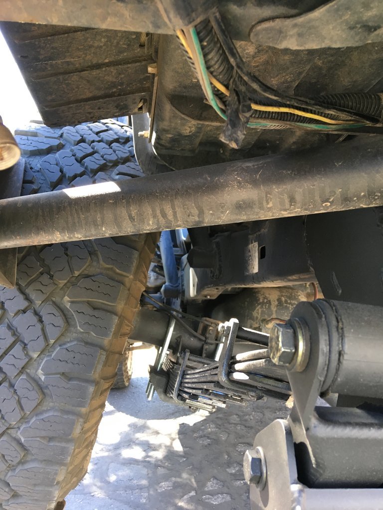

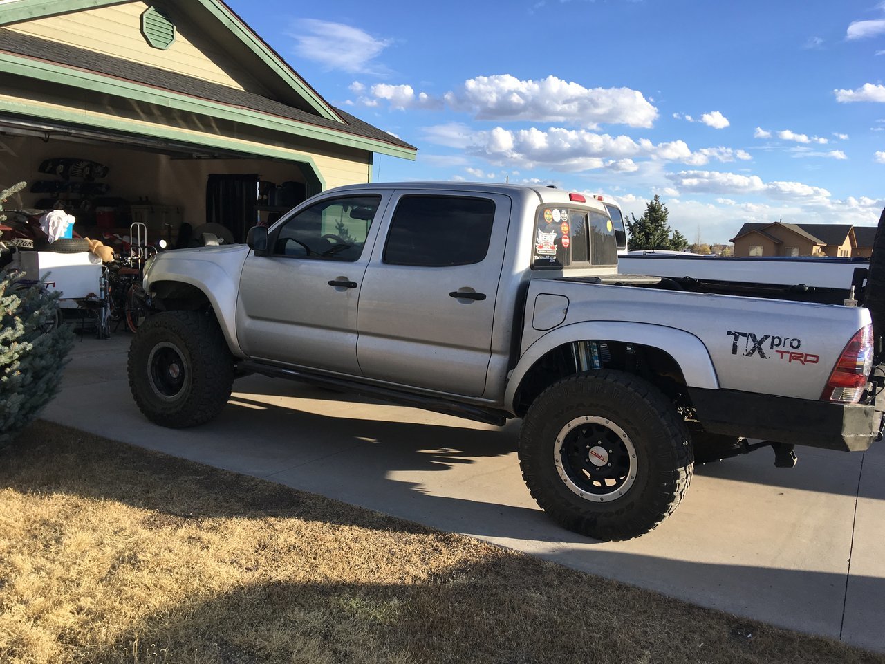

    All buttoned up and ready to tune bypasses this weekend. Added back some of my front preload, but still about an inch or so lower than I'd like. That'll change when I save up and have deaver make me an add a leaf or two to help the rear out. But doesn't look too nose high now that I have the bedsides on. Fiberglass is ordered and should be here in a month or so

    Looks awesome. Who did you end up ordering your glass from?

    I got in on the advanced fiberglass group buy that closed last week and went with their flat top bed sides. Gonna keep the stock bedsides for rock crawling bodywork that I don't care about banging up.
