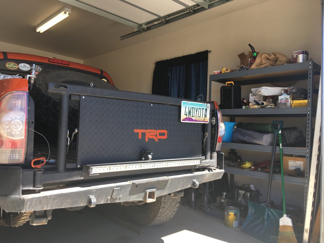

    And I finally got the plate for my tailgate/ table, painted and installed this afternoon

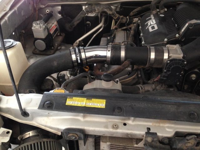

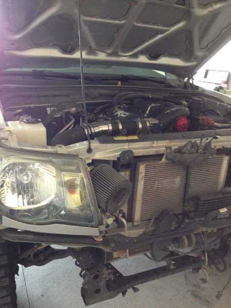

    Do you have any pics of your URD tcai install? mainly interested in the supercharger intercooler clearance and mounting bracket up front. Im about to put one on my truck and thats the one thing i heard you have to work around

    I wish, moving my cross brace forward to make room to add supports for the shackle hangars.
    As for the tcai, I ran it with the standard parts for a year or so and noticed it was running the intercoller. Bought a intake elbow from auto zone, made a quick bracket and modified it to this configuration.

    Nice, thanks for the info!
    Looks like a good option for extra clearance:thumbsup:

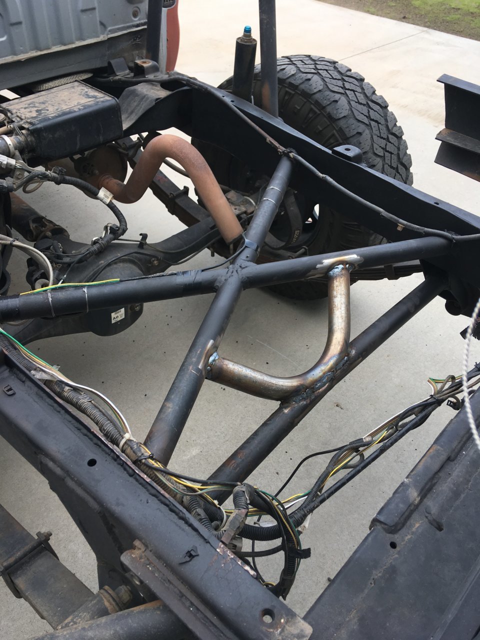

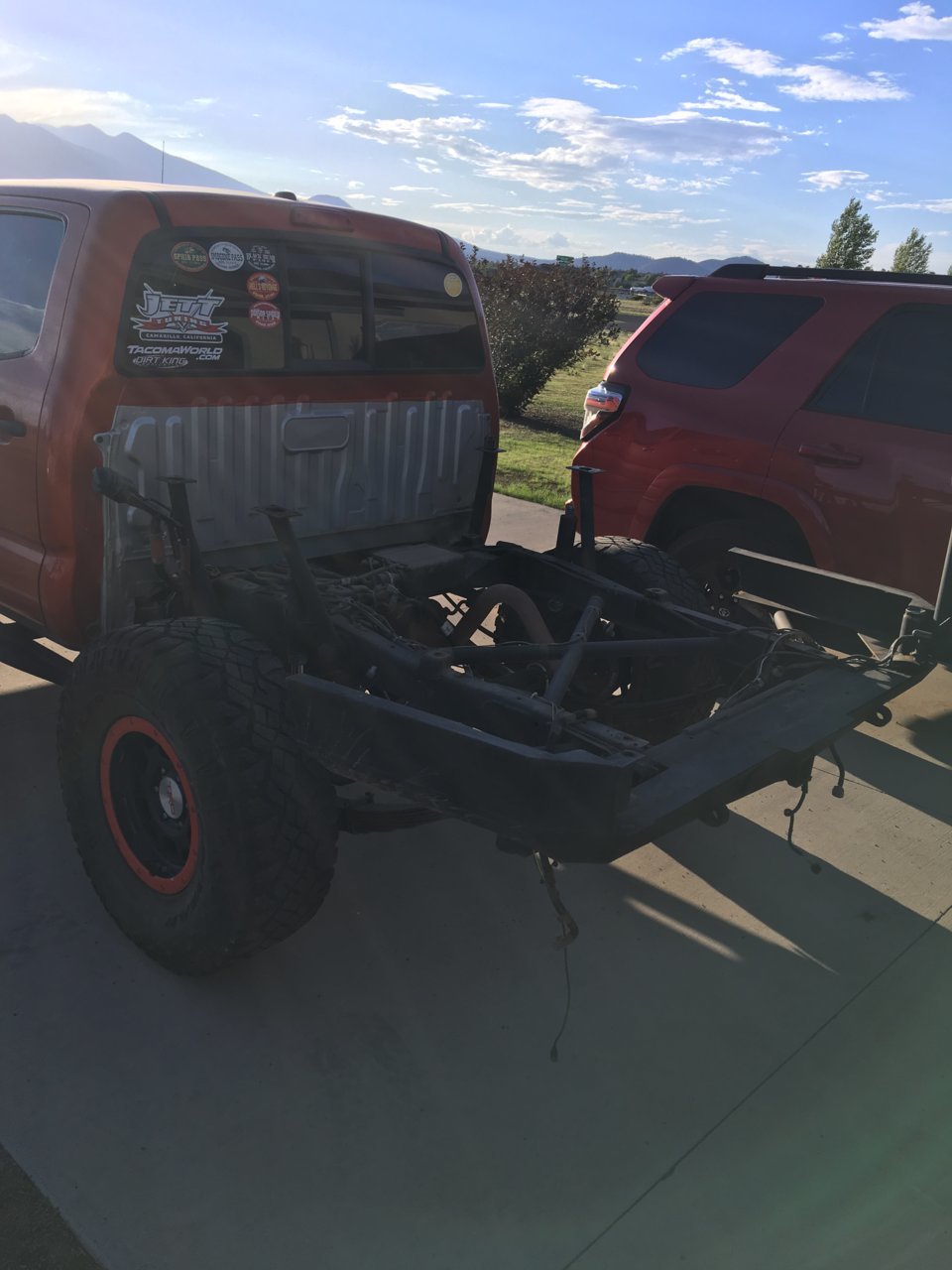

    Frame plating round 2. First setup was probably plenty strong, but X brace was in the way of adding my shackle hangar supports. Easier to cut the old one out and just plate the whole thing this go around then modify what was there.
    Should have the new cross braces and shackle supports in tomorrow

    Frame plating and shackle support progress. 95% welded and I ran out of wire and paint. Gonna grab that and finish up this weekend.

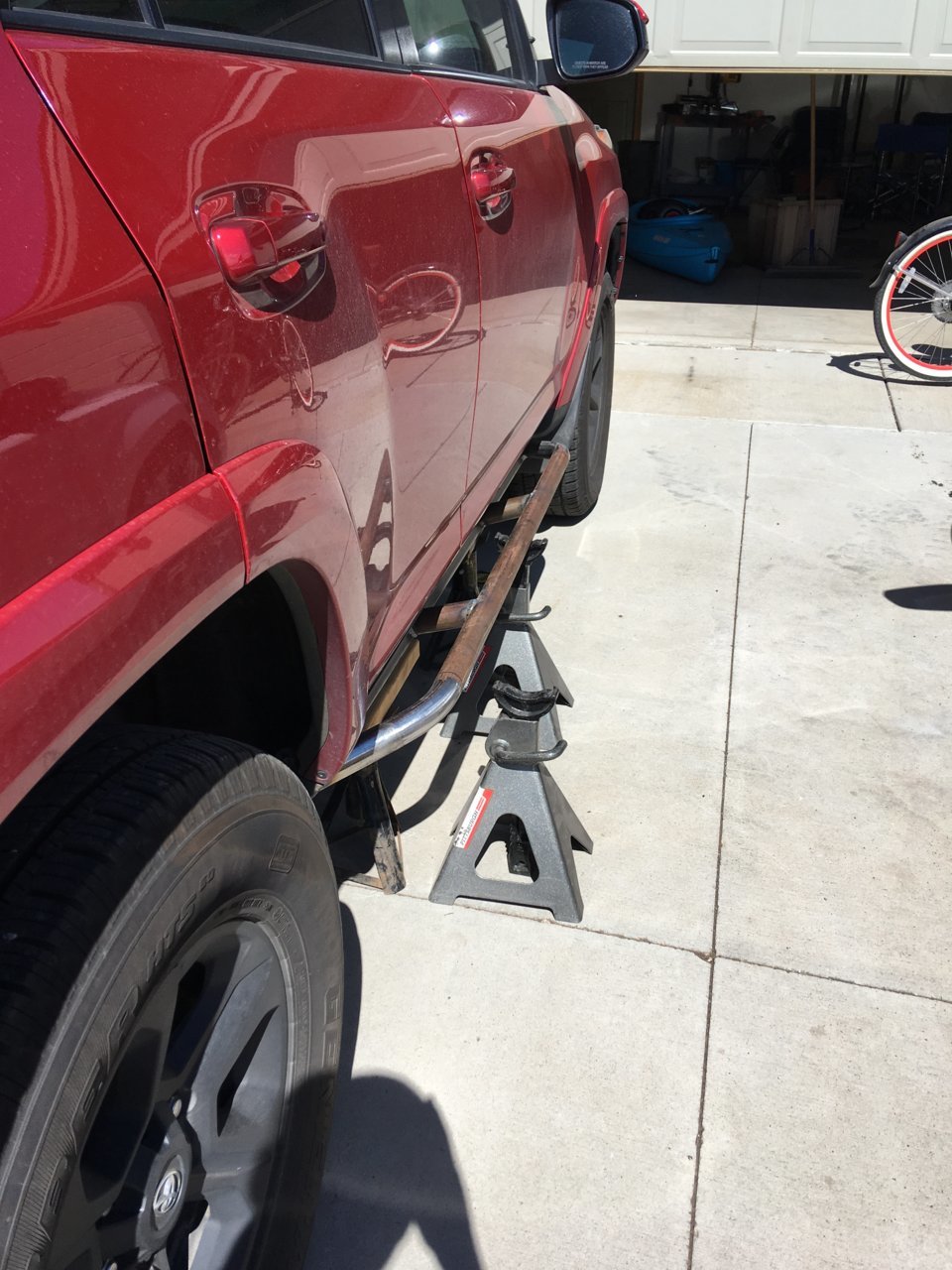

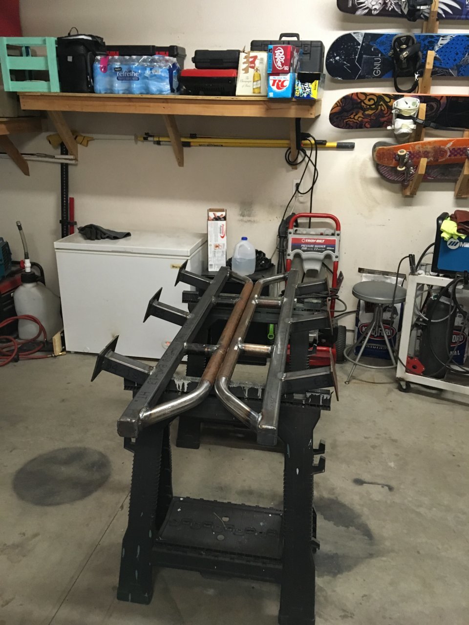

    Whipped up a set of rock sliders for the gf's 4Runner. Ready for paint and install this weekend. IMG_2716.jpgIMG_2703.jpg

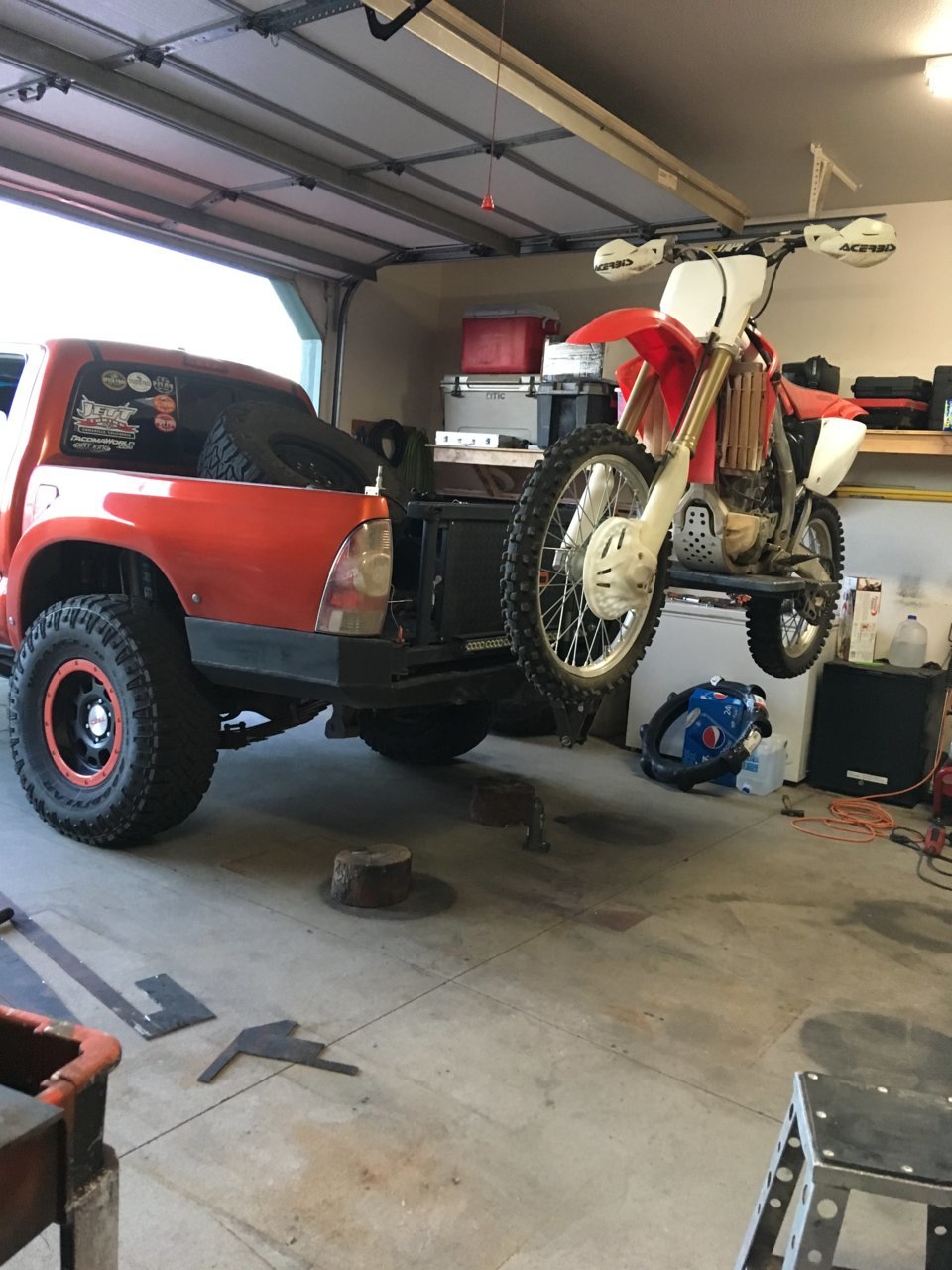

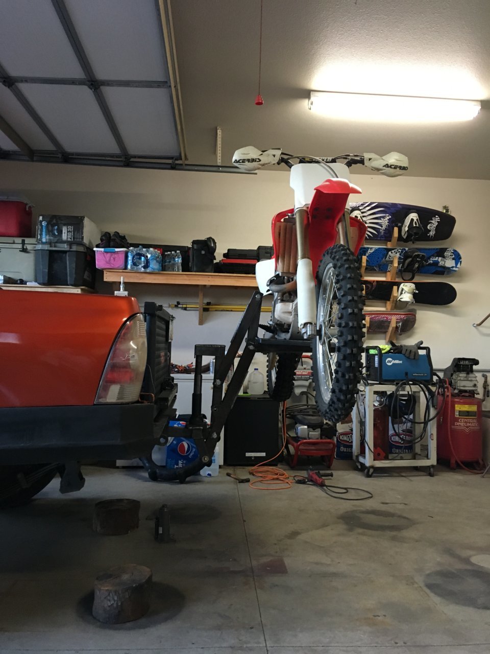

    Been working on a mx hauler that gets the bike way up and in the air so nothing drags getting to wherever I decide to ride or camp. Coming out pretty damn good. Just a few things to button up and she will be ready. IMG_3001.jpg IMG_2999.jpg

    Holy shit that is cool. Is that the factory bottle jack as the lifting mechanism?

    Yeah I sacrificed it. I was going to use a 4ton hydraulic jack, but the maximum lift height on them includes when you unscrew the top and get another 4" out of it, which is tough to do with all that weight on it. The dual stage of the factory jack works great and gives it enough lift. Just insert factory jack handle into a drill and it lifts the bike right up.
