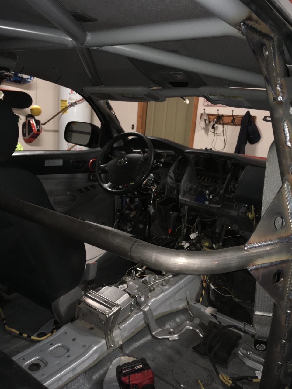

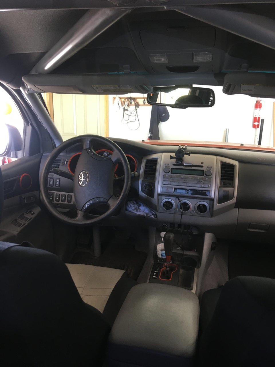

    More progress. Got the headliner in and cage welded up and in place. Planned on the headliner fitting a little better, but it’s my first time. Then went a little crazy on the trimming to get it to fit. Oops. At least the grey on grey isn’t too unsightly.
    Also lowered the rear of the front seats to gain some much needed headroom not that there are tubes in the way.
    D7C06A0C-ADB0-4060-BF2F-36E2D23E496D.jpg 89C650D9-3F3F-49E8-A3A0-0AB98FD592D1.jpg EFE60200-DF67-4832-BF03-447C67D0F072.jpg 25DB9BB4-CA4B-45A8-BCE5-B18C38E922BD.jpg

    First drive, harnesses in with the cage basically finished. Need to strip the trim, paint and add some sound deadening to the floor. Oh and have a windshield put in. Surprisingly not as loud inside even without a windshield at 45-50mph as I would have thought. Just a little grumblier at idle and under accel, but cruising is not bad at all.

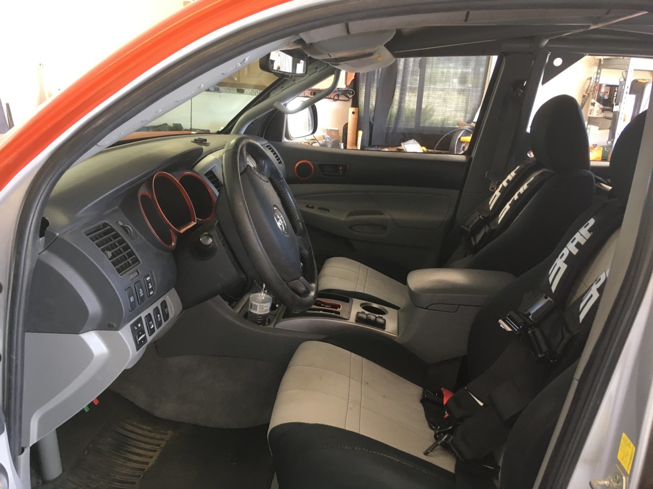

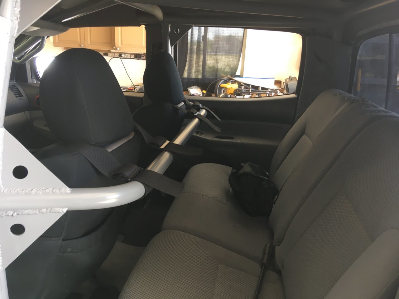

    Turns out I remembered how it all went back together. Cab cage is complete!!!
