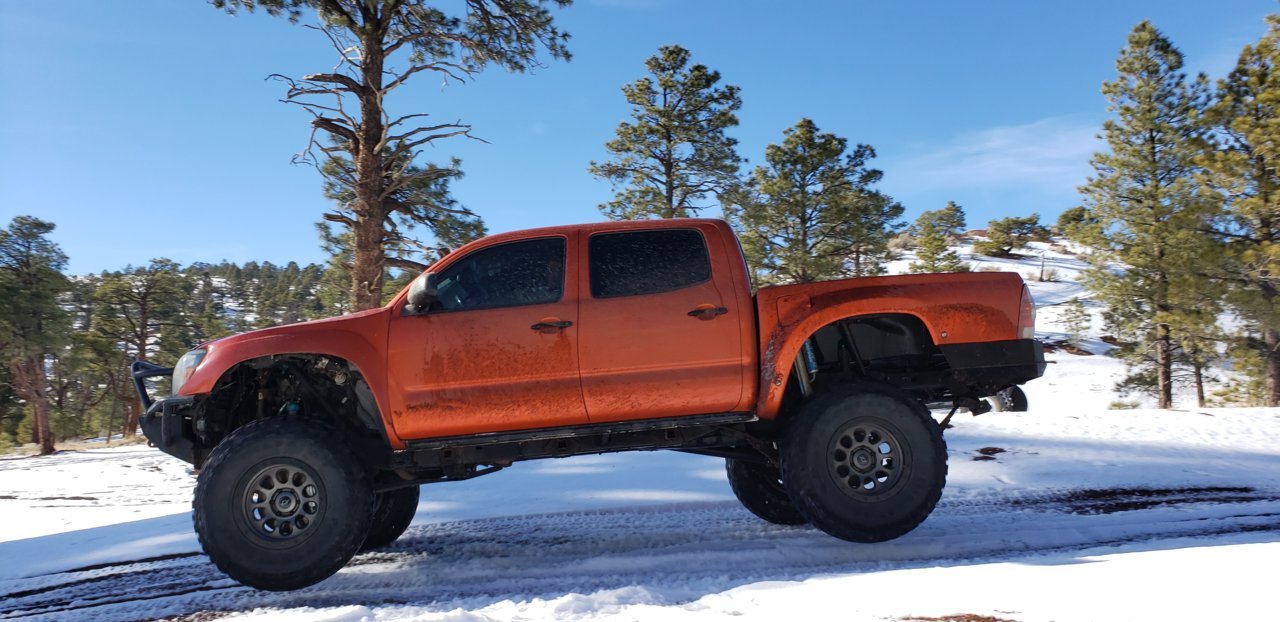

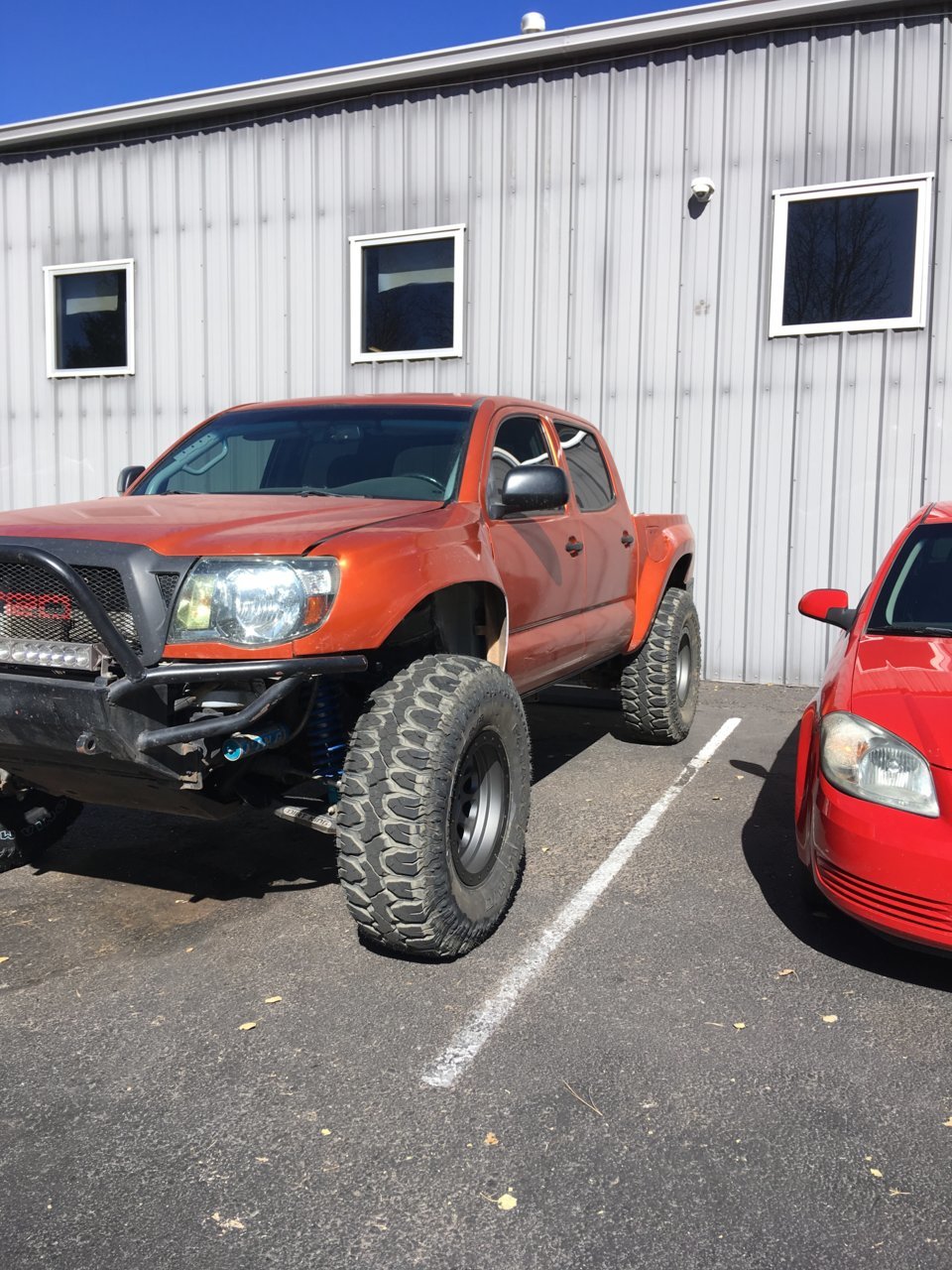

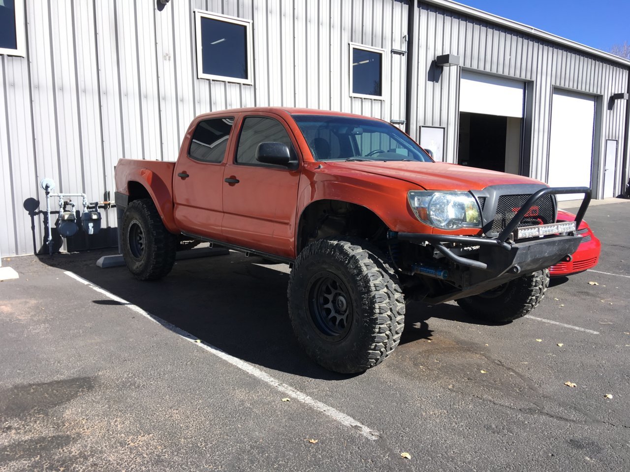

    Trimmed fenders so I could drive around a little bit this week. Still need to tub the drivers side, but I have pretty good turning radius at ride height at least. Only issues have been parking but hopefully I’ll get that finished up this weekend.

    Haha thanks man. Added bonus to having to trim the front fenders is I trimmed just up past my body damage/ scratches that I got over the summer.

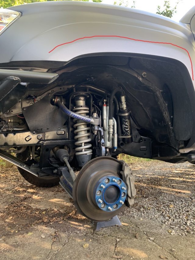

    I did my best to follow this first body line and rough cut with a cutoff wheel. Then used a dremel with a sanding wheel on it to clean up the rough cut and get it closer. Mine is by no means perfect but it got the job done238723FA-D656-47C8-B9F9-67EB5E08BBA7.jpg

    Yes. But depending on tire size you may or may not need trimming or may or may not need to trim up to where I did. My 35’s cleared the fenders with no trimming. Best to cycle suspension while installing your kit to see exactly what needs to be done

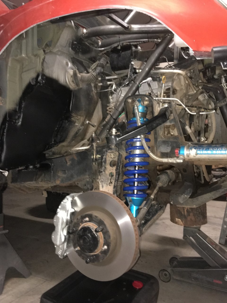

    4tunner brake upgrade happening tonight. Just waiting on my helper to get home so I can bleed them.
    Hoping to strip everything down this weekend so I can paint e engine cage and get back to enjoying the truck for a little while. Still need to address my tweaked shackle hangers but they’ll be fine for a little while.

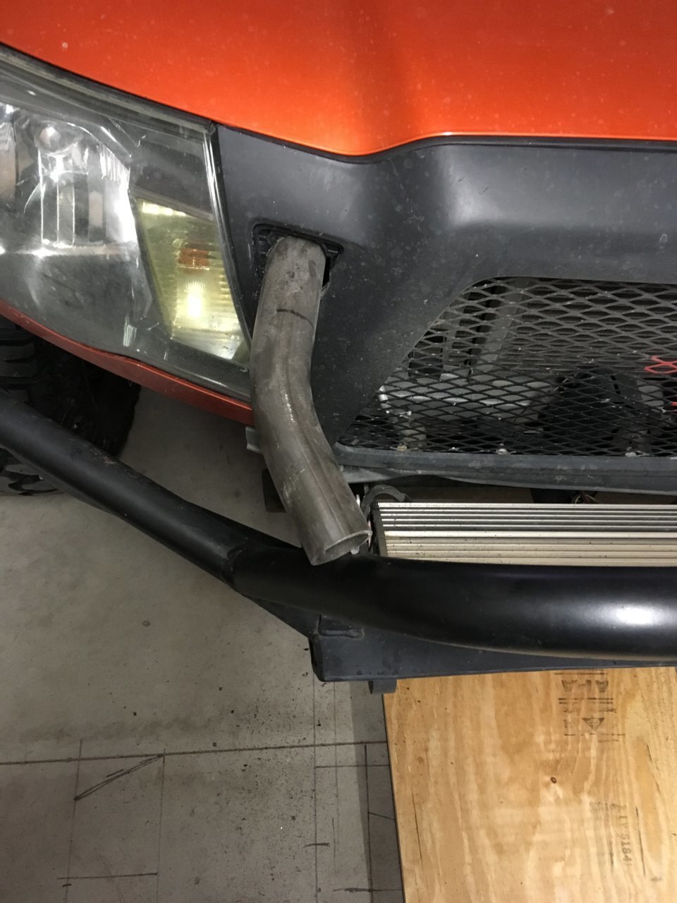

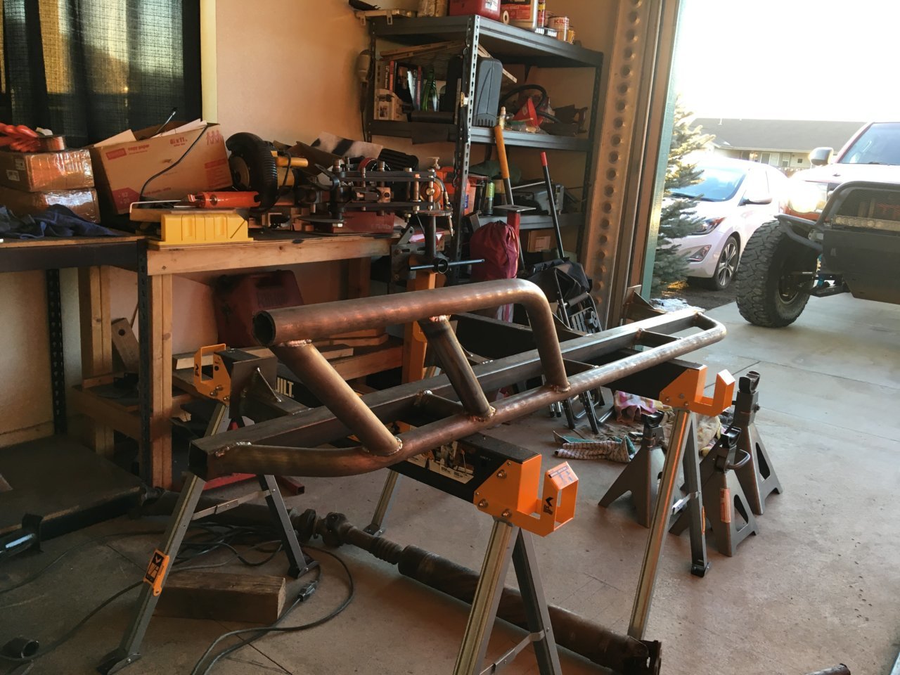

    Just when I think I’m done with tube work for a while I go and decide to add these through the grill to connect the engine cage to front bumper.
    These tubes will also be used to build a few hood pin mounts off of which is the true reason they are getting added now, along with strengthening the front bumper. But I noticed excessive hood flutter driving down the hwy and have heard of hood latches breaking off the core support and flying open. Don’t want that happening ever, so a few hood pins will go in as a safety precaution.

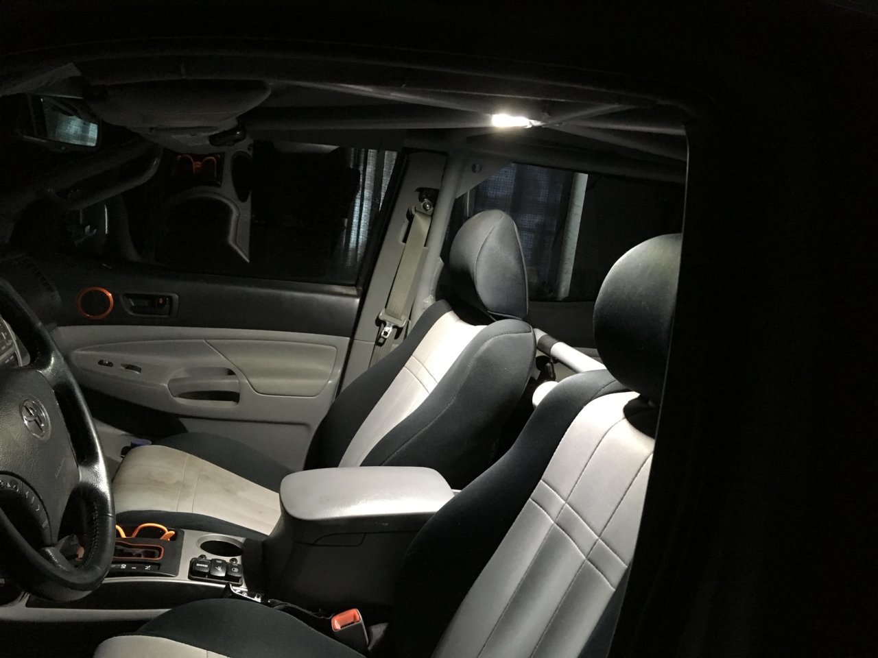

    Wired up a KC cyclone as an interior light. The Tacoma Beast led kit just wasn’t cutting it with the cage in the way.

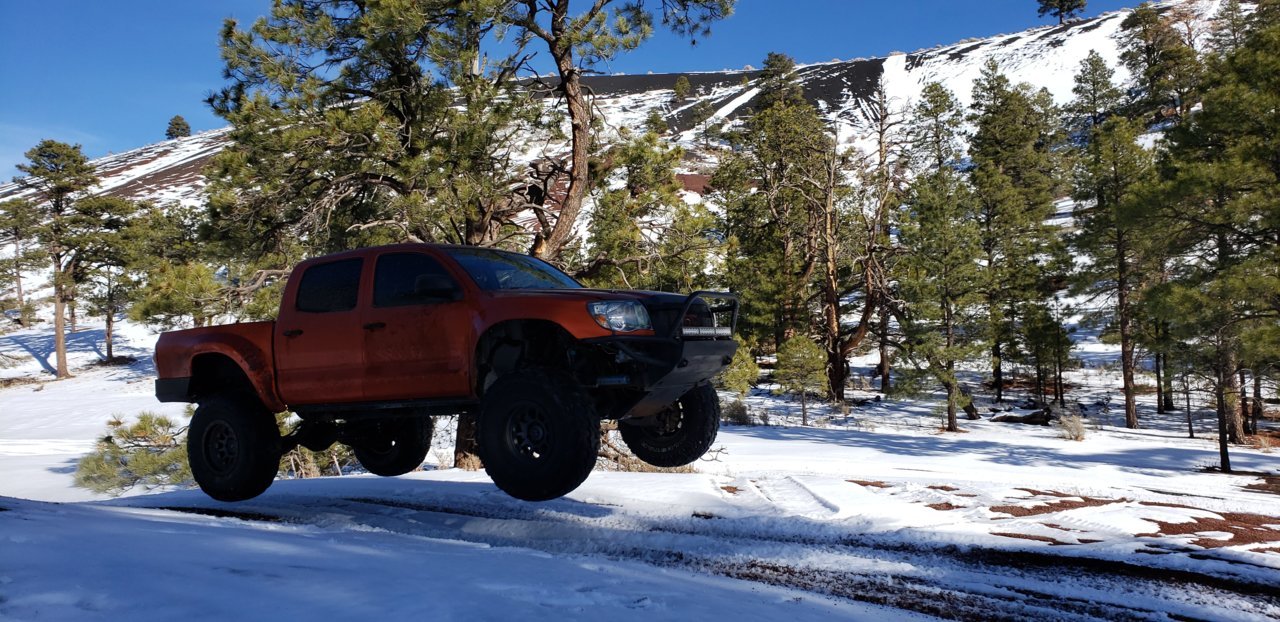

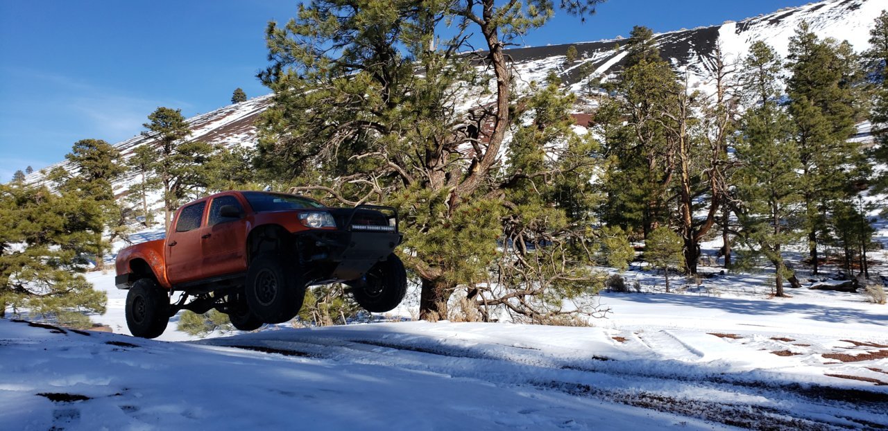

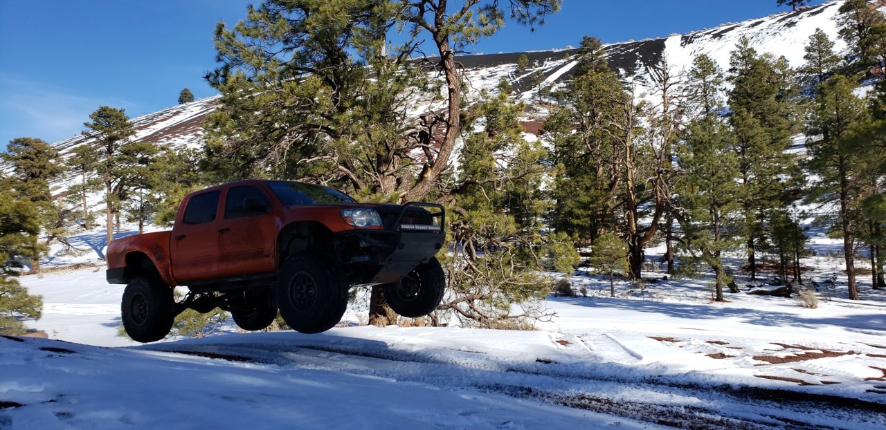

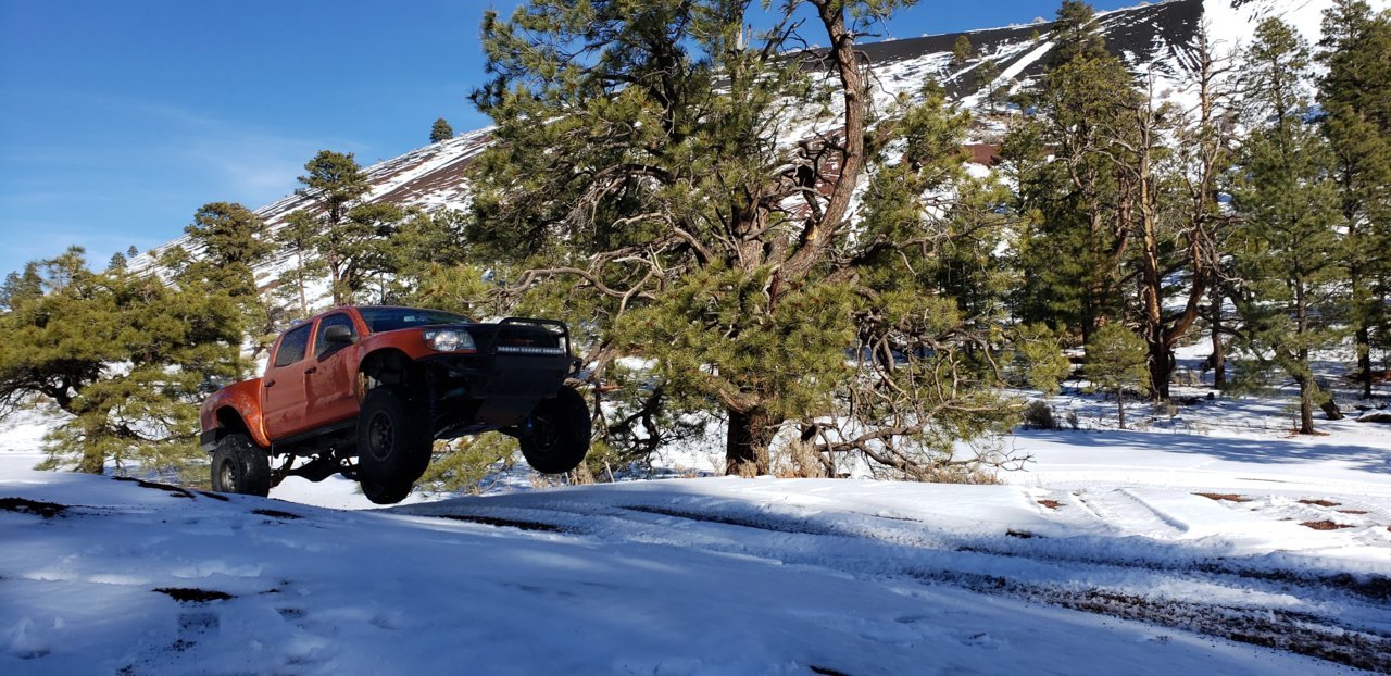

    39897AA5-CA43-4563-8514-3AA02D98DF72.jpg 16B042EA-5EF9-4C18-B7BD-D7244299A026.jpg ED02FDBA-049D-4D87-B67B-D70014463771.jpg F3F195B5-33D1-4F80-889A-7F6904EE8A50.jpg E75944C0-174B-4679-BE9C-58C796A6F3AE.jpg E8DE8E83-52F9-4553-A35D-9C494F045F3A.jpg 46AEB0F2-1441-4D0A-8D4C-4B6C270A23C5.jpg E2C378B6-9024-47A6-A37C-649DB50D0561.jpg E4885454-DC56-445E-B306-AA543731884D.jpg Terrible day in the snow.

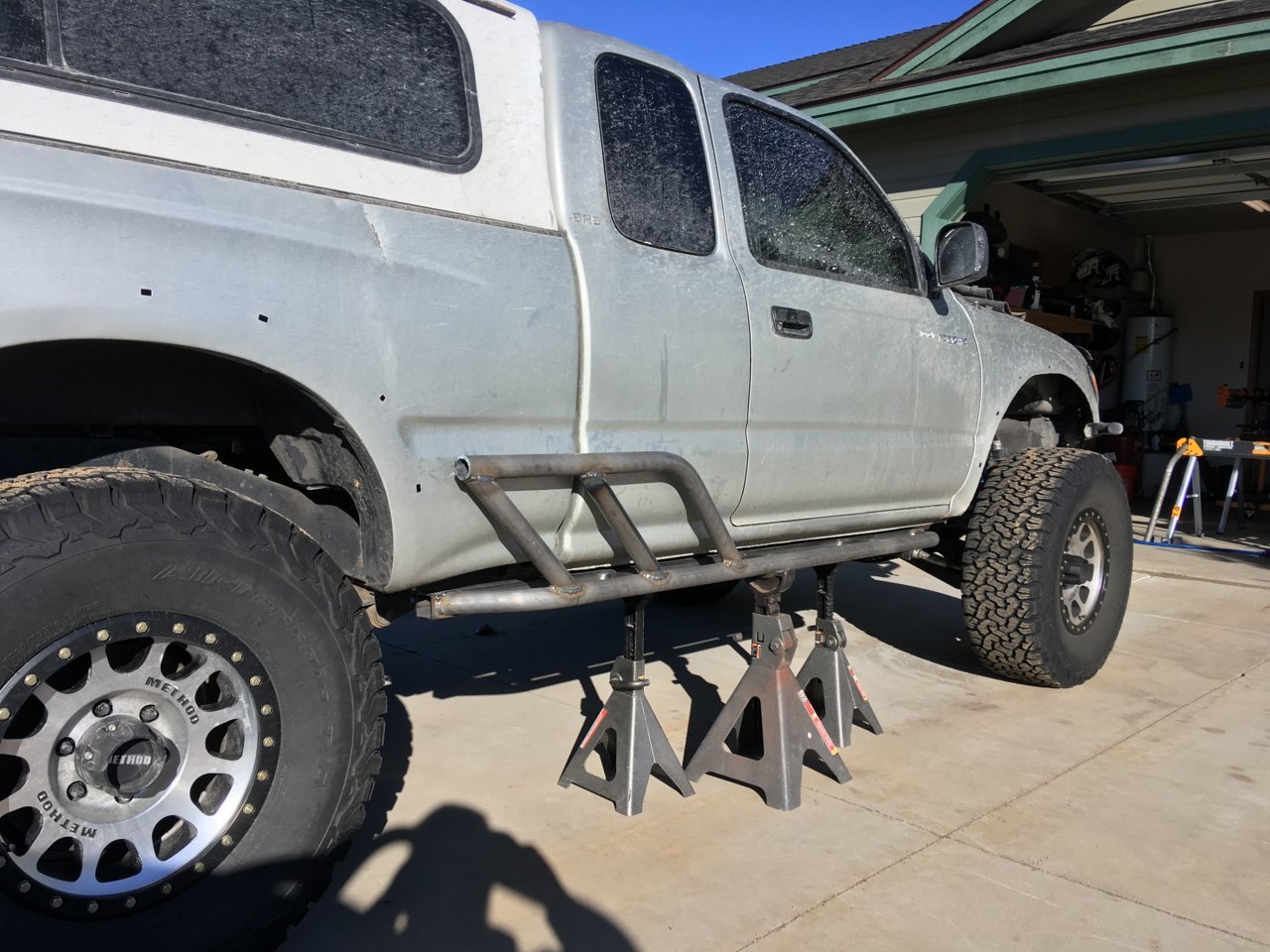

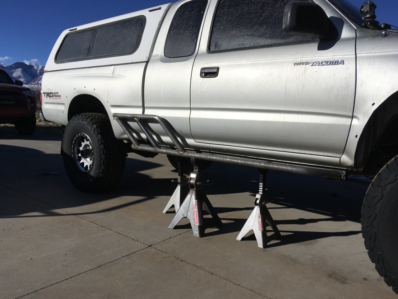

    Some 1st gen sliders ready for powdercoat before we install. Yes I capped the ends, just didn’t snap that pic.

    Those sliders look sick man! One suggestion, run the gussets towards the vertical wall of the square tube leg so that if the sliders take a super hard hit, they won’t crush into the square tube at all. If you run them towards the left or right of where you have them over the vertical wall of the square tube then it will have more support underneath the gusset. They look super dope. I really like the kick up. Just a suggestion for the next set you build.

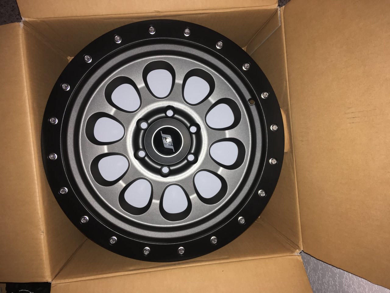

    Truck is getting some serious love in 2020. First time ever it will have a matching spare rim, and first time in about 5 years it will have a full size, brand new, matching spare tire. Big upgrade from the spare tire with 6 plugs in the sidewalk that still leaks lol.
    Just need to pull and paint the faux beadlock bolts black.

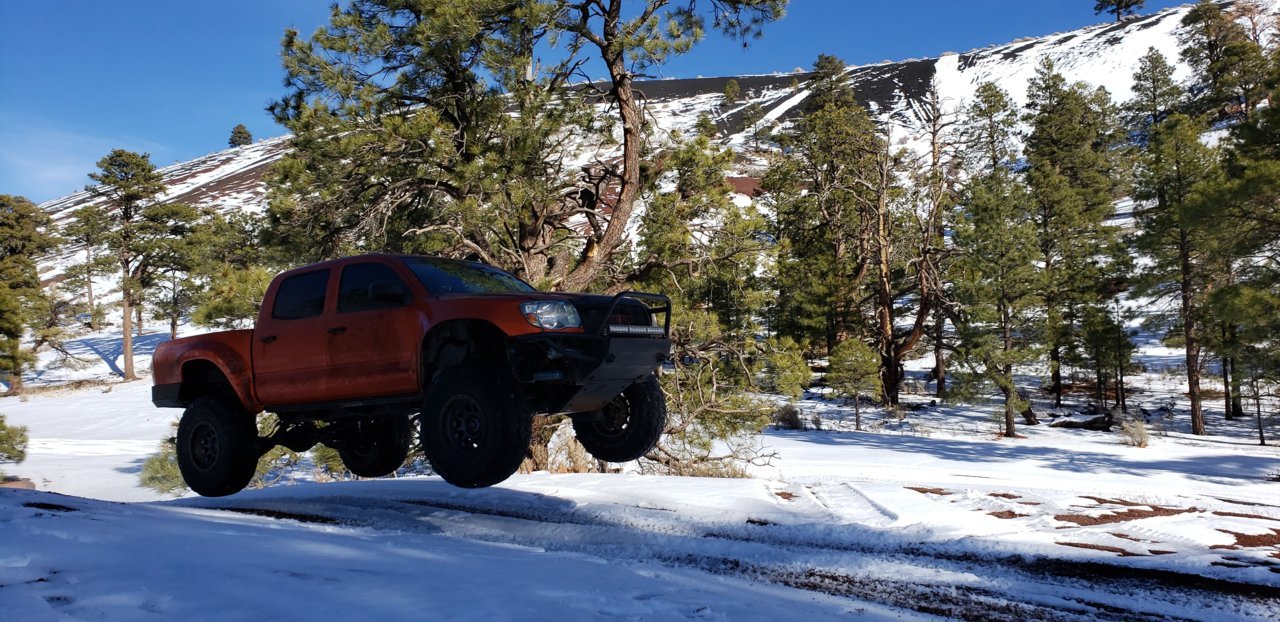

    That snow jump looks like fun... Rad build!
  20. Jan 27, 2020 at 4:52 PM
    #520
    snowsk8air2
    snowsk8air2 [OP] how hard can it be?
    Sep 16, 2011
    #63607
    10,529
    Flagstaff, AZ
    Supercharged TX Pro
    2011 S/C and basic mods

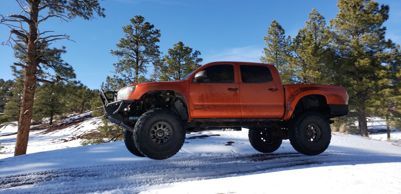

    Thanks man. It had a bit of a rough take off but nice and smooth landing.
