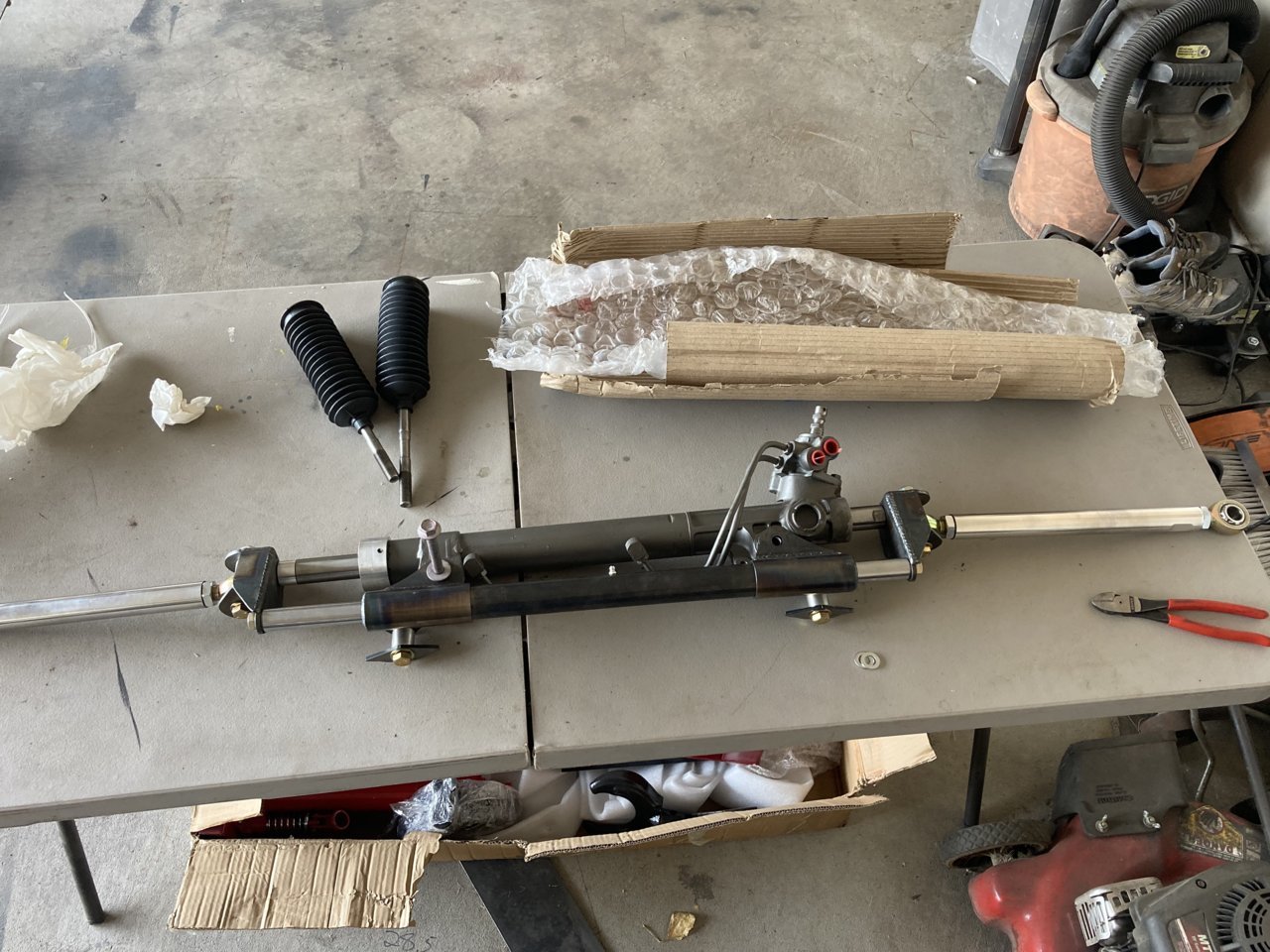

    JD fab slide rack and heimed steering installed over the weekend. Just in time for some cold snowy weather.
    They should be releasing their Howe tc pump kit soon and I’ll add that to help turn things a little easier. Just glad it’s nice and strong now

    Pics of the rack prior to you installing? Looking at designing a similar one since there's less premade ones for first gens.

    This is all I got of it mocked up a few weeks ago. I think there’s some more buried in the thread for all the jd fab stuff

    Interesting so that's a stock rack with a spacer on the left side of the ram? Is moving the tie rod to the bracket between the ram and the slider for correcting bump steer?

    So it’s not a spacer on the left side. It’s a sleeve that brings the OD of that last inch to match the OD of the rest of the rack. For whatever reason Toyota turns it down 0.5mm or so just on the one side. The kit adds seals to the end of the body of the stock rack to keep debris out since you can’t run boots with it so that little sleeve is just to keep the seals happy.
    And yes they move the tie rod to that bracket and forward on it to help with bump steer

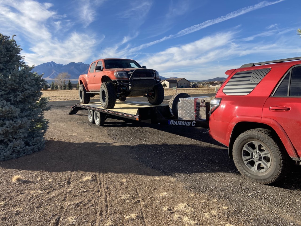

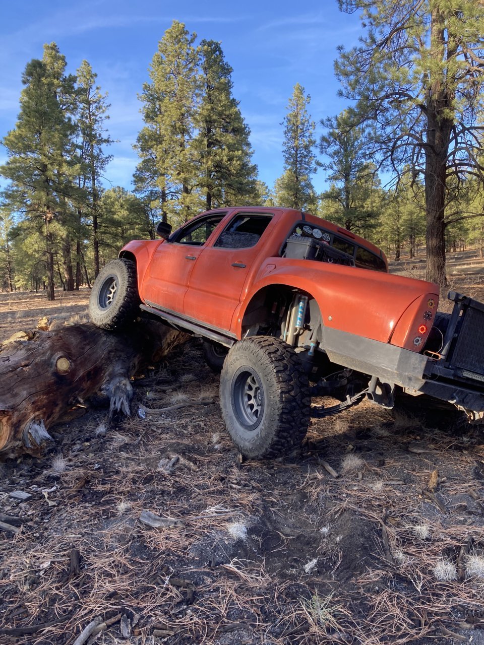

    Stained and sealed the trailer deck to help it last longer, and also took the truck out to test the new steering. Everything feeling tight and right. Biggest tree I could find. Front tire 38” off the ground. 5293D0B7-ECEF-485A-BAF8-C2897EBC88D6.jpg

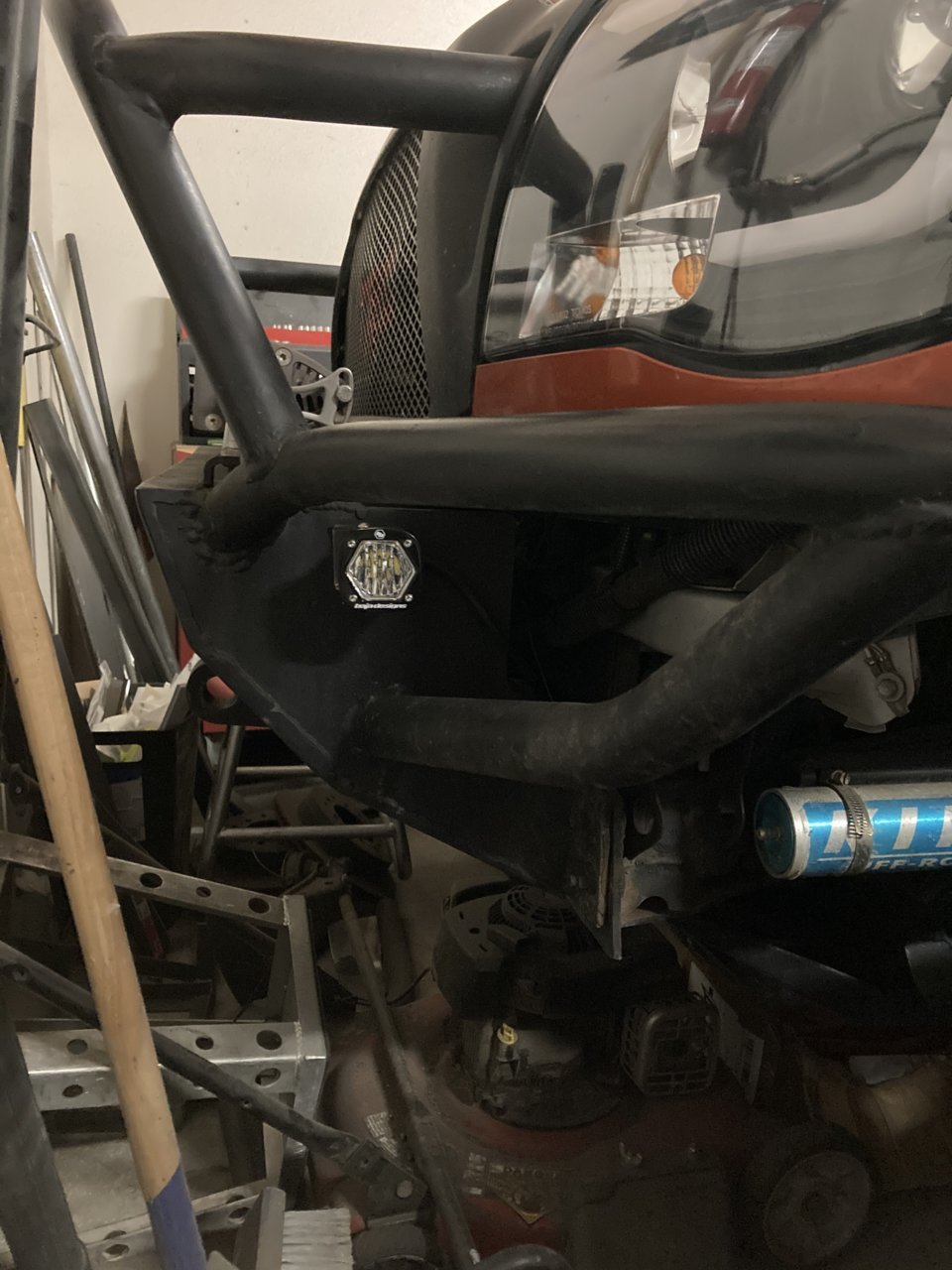

    Drift lights wired up. May end up moving them after a night run but I like how this spot keeps them somewhat protected.
    Dust lights hopefully done this weekend.
    Lfaub03 and Dalandser like this.

    Have anything to compare those to? I bought a set of used s2 pros and I have some s1’s I bought last year on Black Friday. Figuring out where I can put them on my truck

    Not really. Up until now I’ve just been running my onyx 6 bar and cheap chase lights that have been dead but still mounted to the truck for 2 years. I almost went with the S2 for this application but figured I’d save a few bucks since it’s not a primary lighting area. Plus I was able to get 2 white ones up front and 2 ambers for dust lights.
    I will say they are pretty bright and should do perfect for cornering lights. I just might have to move them from that location since they are blocked by the bumper a fair bit.

    Oh alright yeah I have amber s1’s that I made mounts for tucked up in my rear bumper as dust lights / aux reverse lights - if you’re running those for dust lights I’d like to hear how bright they are to see if I’ll use those or the s2’s for backing up which is realistically what they’ll be used for most of the time.

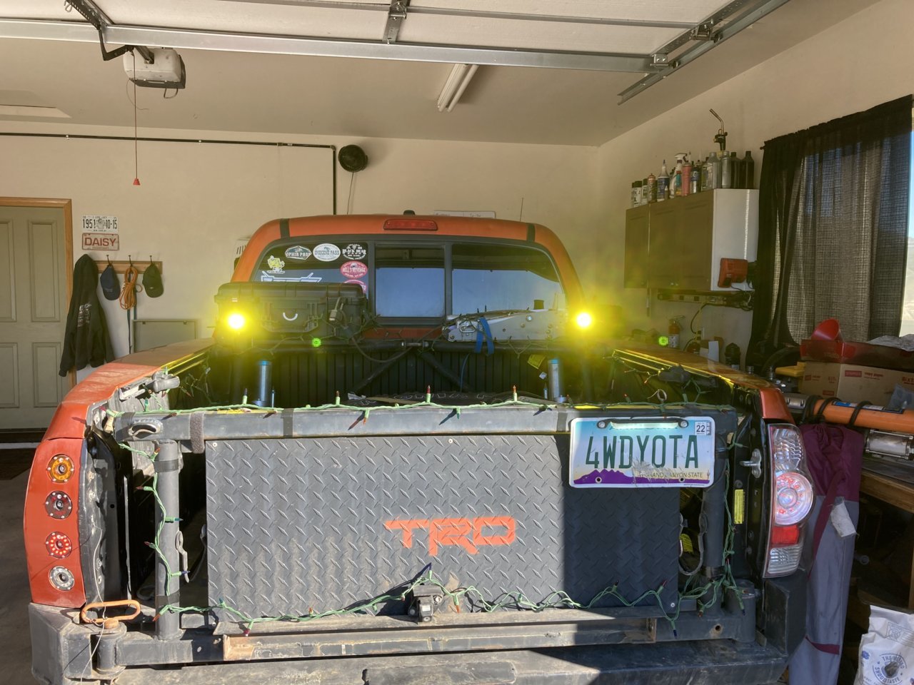

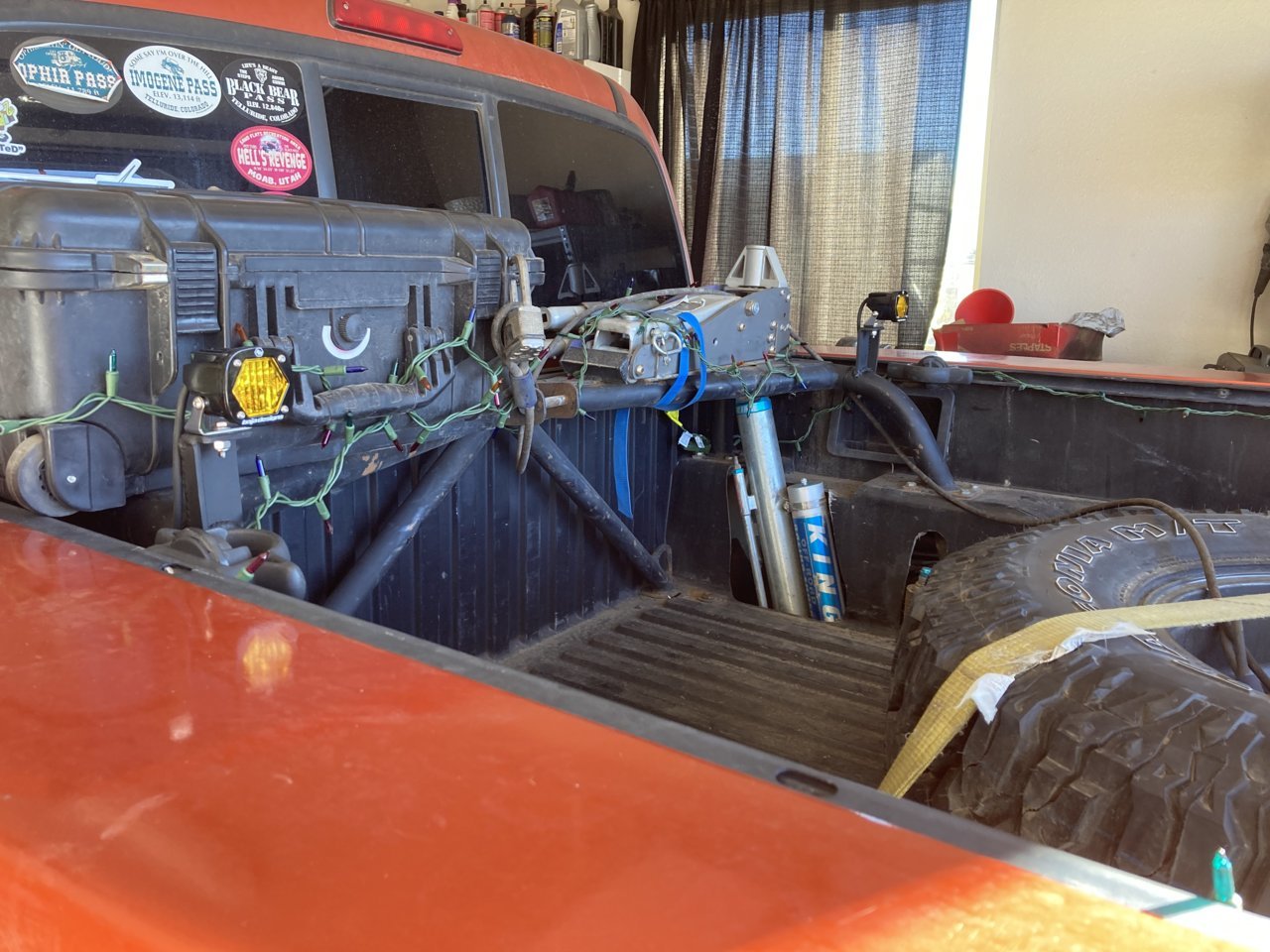

    Just finished up getting the ambers mounted and wired. I’ll try to get a night run in today or tomorrow for a review of how they all worked out.
    3A4D24A0-6542-4F93-81F9-17C97FCB8F97.jpg D8B65933-FC67-47CC-A998-E59219C91A95.jpg
    As for reverse lights, even just that one KC cyclone is awesome. Some day I’ll find the motivation to probably redo that light and build the other side.
