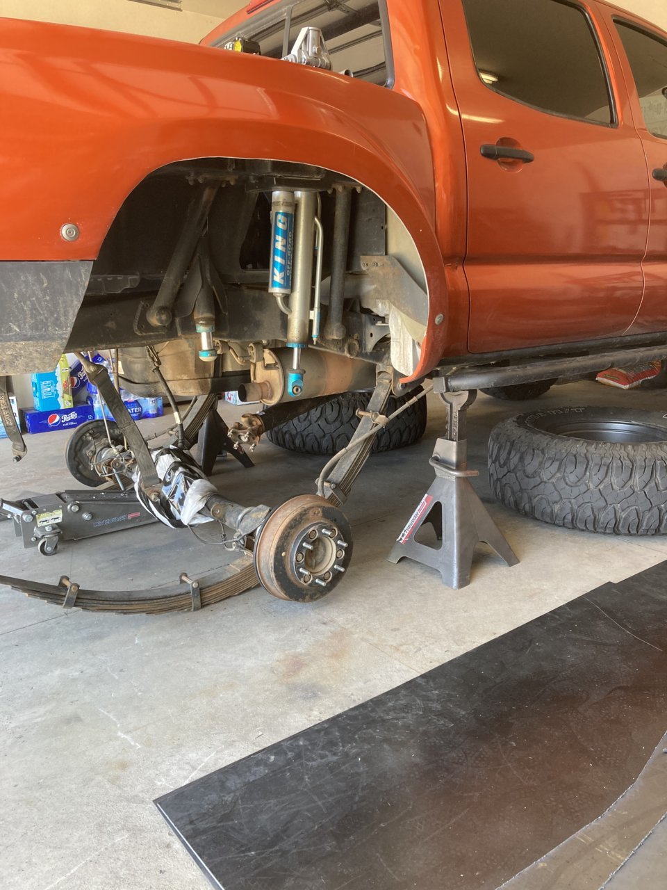

  11. Apr 4, 2021 at 12:09 PM
    #671
    snowsk8air2
    snowsk8air2 [OP] how hard can it be?
    Sep 16, 2011
    #63607
    10,561
    Flagstaff, AZ
    Supercharged TX Pro
    2011 S/C and basic mods
    Got droop?
    If I want to be cool and brag and run some massive 18” shackles is looks like I’ll be able to pull 22” of travel out of these leafs.
    Lfaub03 likes this.
  12. Apr 4, 2021 at 1:55 PM
    #672
    Murphinator
    Murphinator Well-Known Member
    Mar 1, 2015
    #149903
    3,335
    Anthony
    SoCal
    14 DCSB 4x4
    That is nuts!
  13. Apr 4, 2021 at 2:11 PM
    #673
    snowsk8air2
    Sep 16, 2011
    #63607
    10,561
    Flagstaff, AZ
    Supercharged TX Pro
    Yeah it probably wouldn’t work too good. Gonna mock up some things in the coming week or two to finalize the design parameters. I’m at 16.5” of travel now. Hoping for 18”+ when it’s done.
  14. Apr 4, 2021 at 2:22 PM
    #674
    Murphinator
    Mar 1, 2015
    #149903
    3,335
    Anthony
    SoCal
    14 DCSB 4x4
    Your truck is gonna be a beast. How much uptravel does your truck have? The truck i just bought has like 1” bump stop to frame lol
  15. Apr 4, 2021 at 3:08 PM
    #675
    snowsk8air2
    Sep 16, 2011
    #63607
    10,561
    Flagstaff, AZ
    Supercharged TX Pro
    Well with the previous/ current setup I was sitting at about 9” of up travel and 7” of droop at ride height
    Murphinator[QUOTED] likes this.

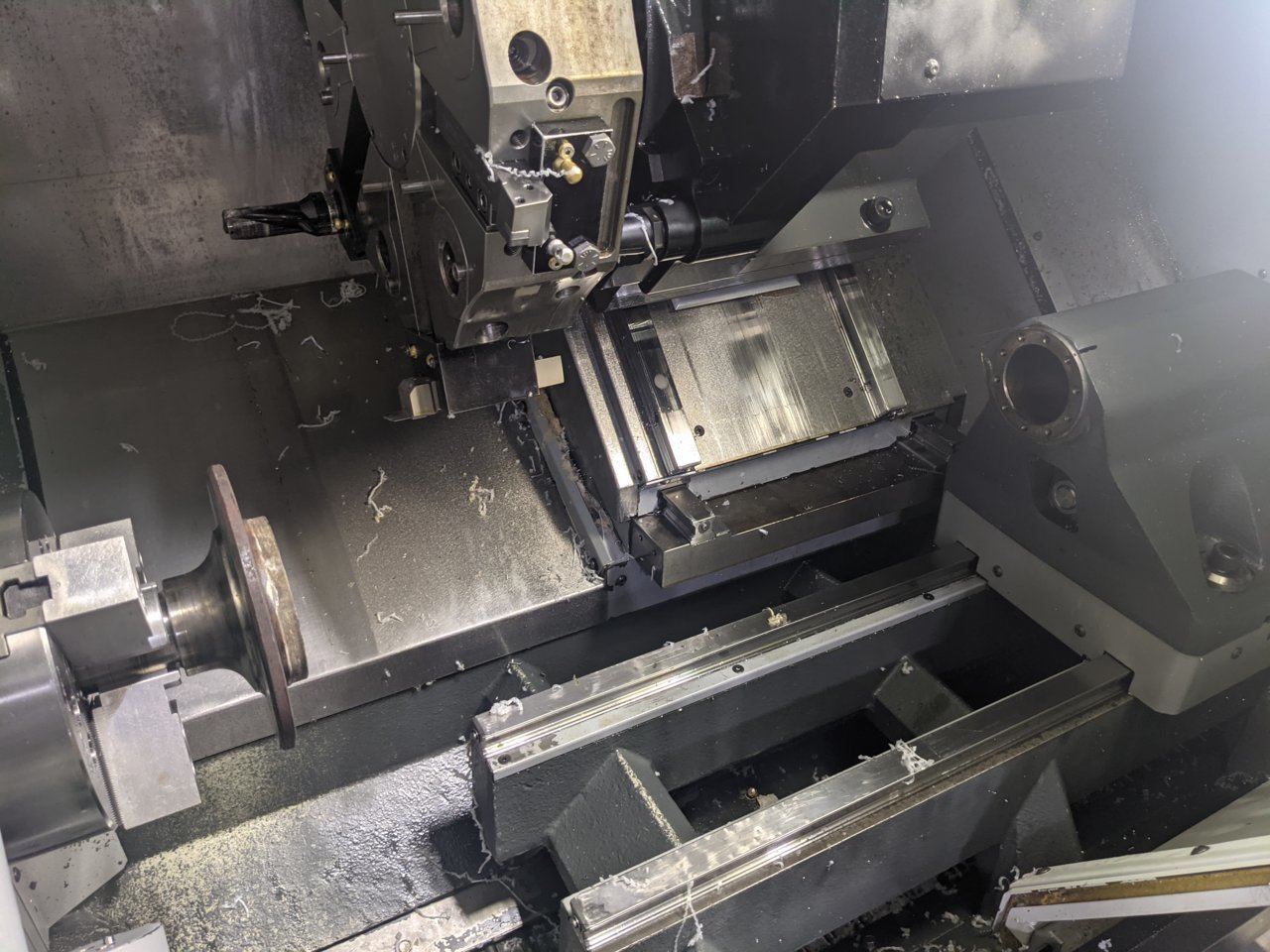

    #676
    XPOTRPR
    XPOTRPR CNC Programmer/Machinist
    May 29, 2011
    #57449
    31,177
    Josh
    Chandler, AZ
    > BUILD LINKS >
    He had to pull the tail stop to swing it in.. but it fits! Less than a .001" run out. Checked on the shaft and the shoulder closest to the jaws. :thumbsup:
    Adventure4x4 likes this.
