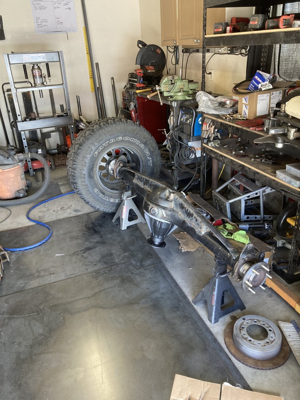

    Well they’re in lol. Couldn’t figure out a setup that offset the axle enough to clear the press. So, took an old rotor off the truck that I still had laying around, used it as a little guide, and “pressed” them in with about 5 swings of the bfh. Everything appears to have seated nicely and lines up good on the wheels. But I’ll definitely be keeping an eye on the wheel torque the first few outings

    Nice! Haha. Whatever it takes. How's wheel fitment?

    Wheel fitment was good. Didn’t torque the studs down but wheel slipped right on and everything appeared centered. So like I said, torque things down and check often the first little bit to make sure the studs don’t wiggle slightly better into place and it’ll be all good

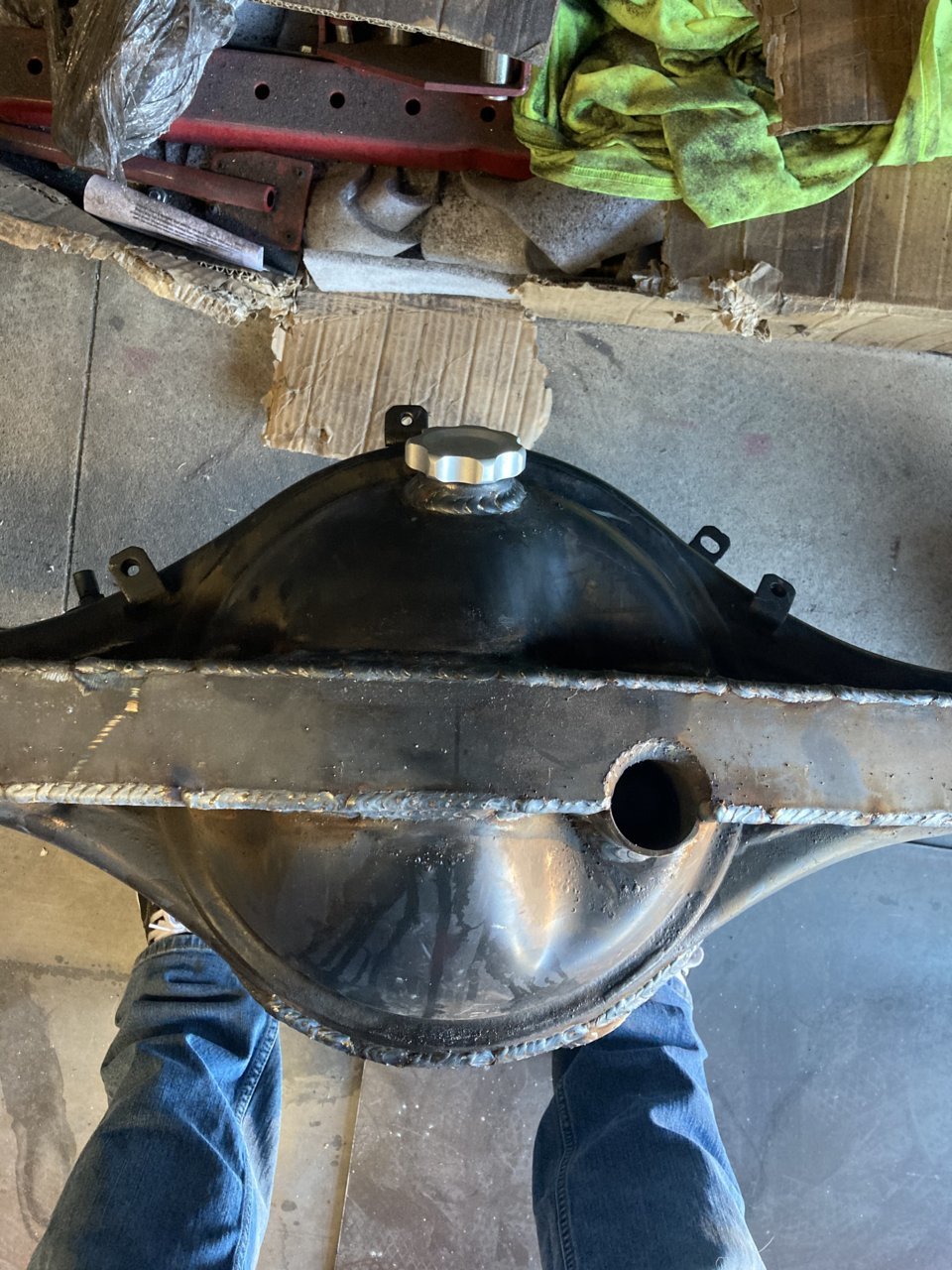

    Did you weld in another diff fluid filler port?
  6. Apr 19, 2021 at 6:19 AM
    #706
    snowsk8air2
    snowsk8air2 [OP] how hard can it be?
    Sep 16, 2011
    #63607
    10,523
    Flagstaff, AZ
    Supercharged TX Pro
    2011 S/C and basic mods
    Yeah I found one on summit and threw it up top for easier fills and also checking the gears off needed

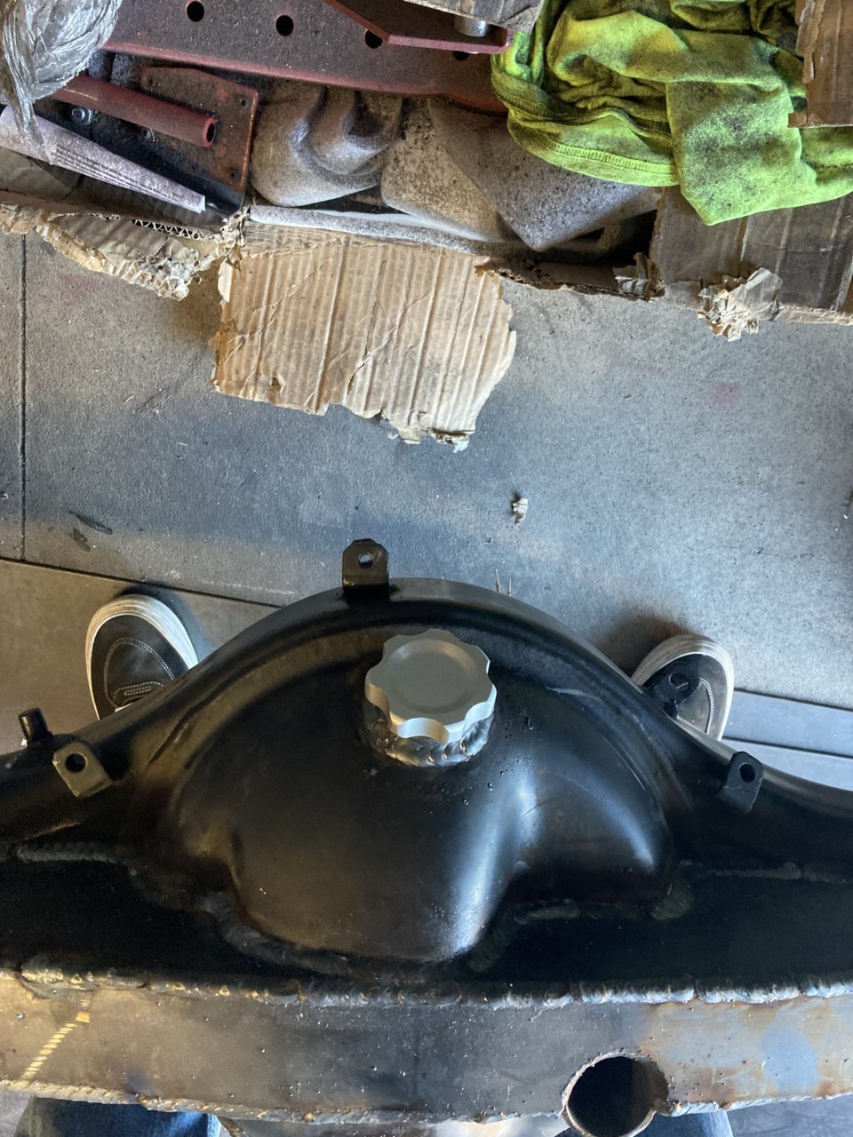

    Do you mind posting a pic of the location on the diff when you have a chance? Curious how it looks
  8. Apr 19, 2021 at 6:33 AM
    #708
    snowsk8air2
    Sep 16, 2011
    #63607
    10,523
    Flagstaff, AZ
    Supercharged TX Pro
    Top and centered. The lip where it seats was just slightly bigger and 1.75” so I used that size hole saw and then a porting tool to finish it off.

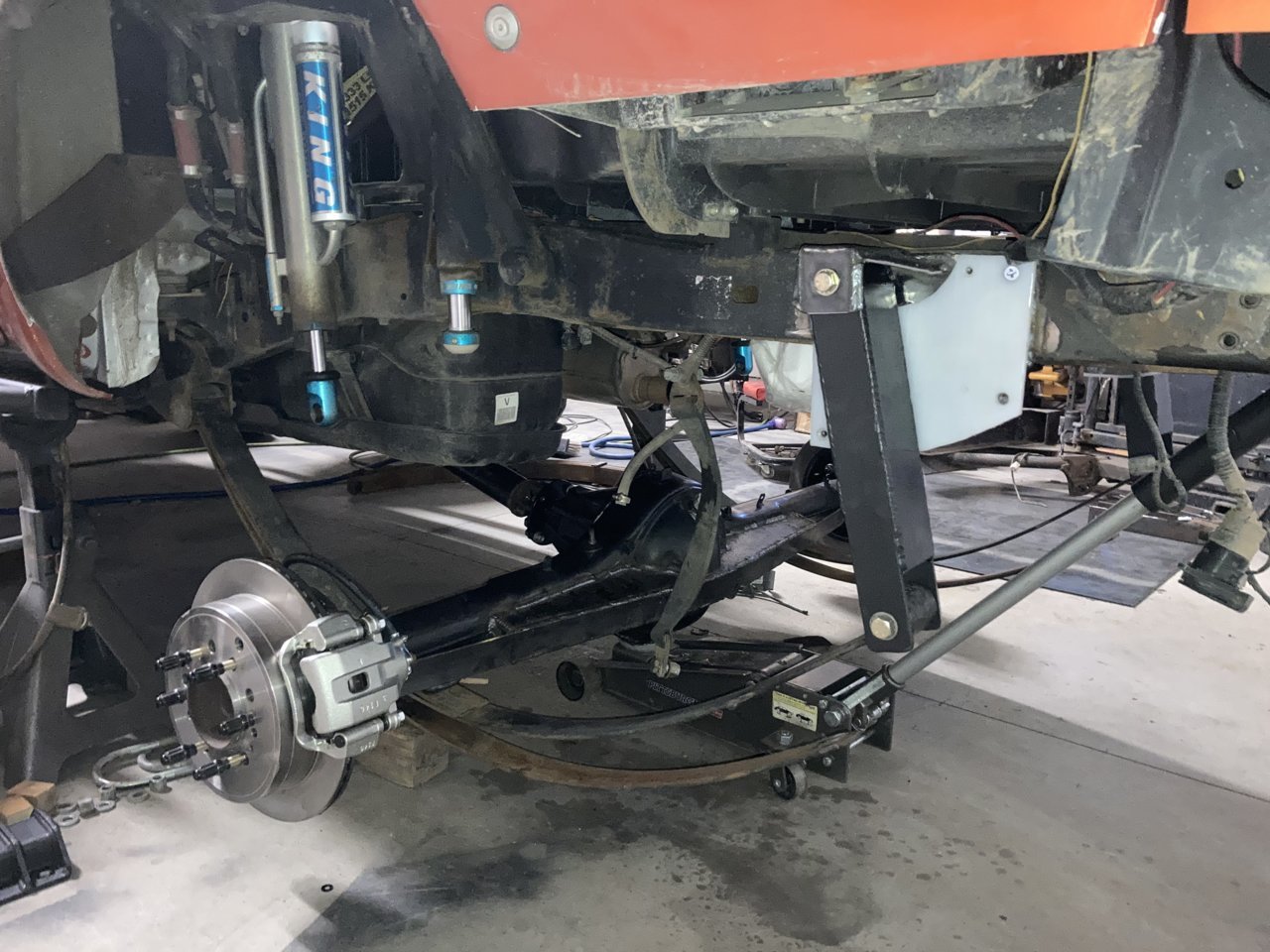

  15. Apr 19, 2021 at 6:10 PM
    #715
    snowsk8air2
    Sep 16, 2011
    #63607
    10,523
    Flagstaff, AZ
    Supercharged TX Pro
    Rotors drilled, brakes mounted. Gonna wait to run hard lines until I cycle things with the new axle in just to make sure there aren’t any clearance issues. But we got a roller!

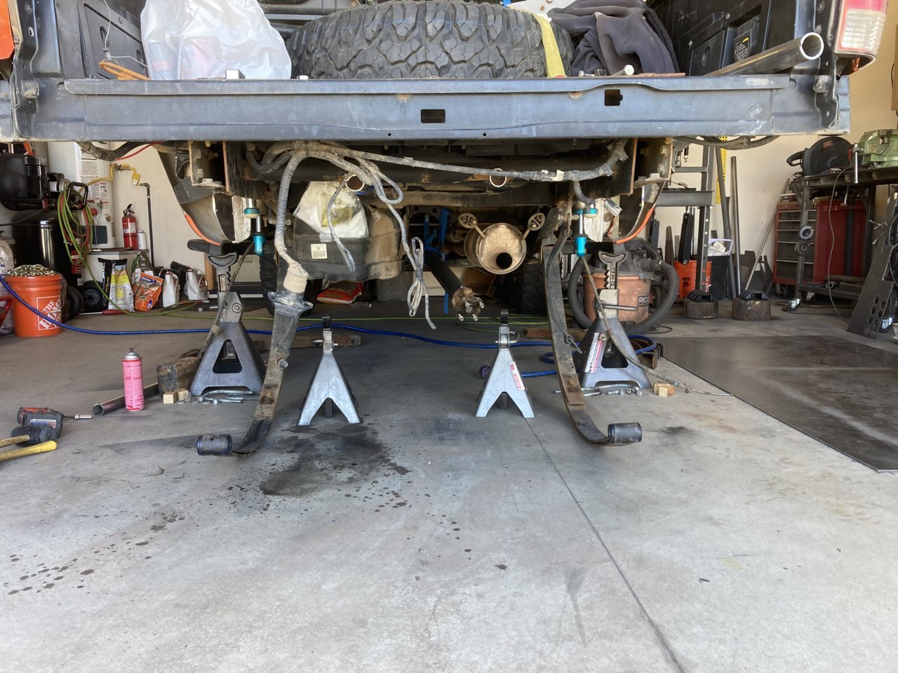

  16. Apr 25, 2021 at 12:11 PM
    #716
    snowsk8air2
    Sep 16, 2011
    #63607
    10,523
    Flagstaff, AZ
    Supercharged TX Pro
    Out with the old

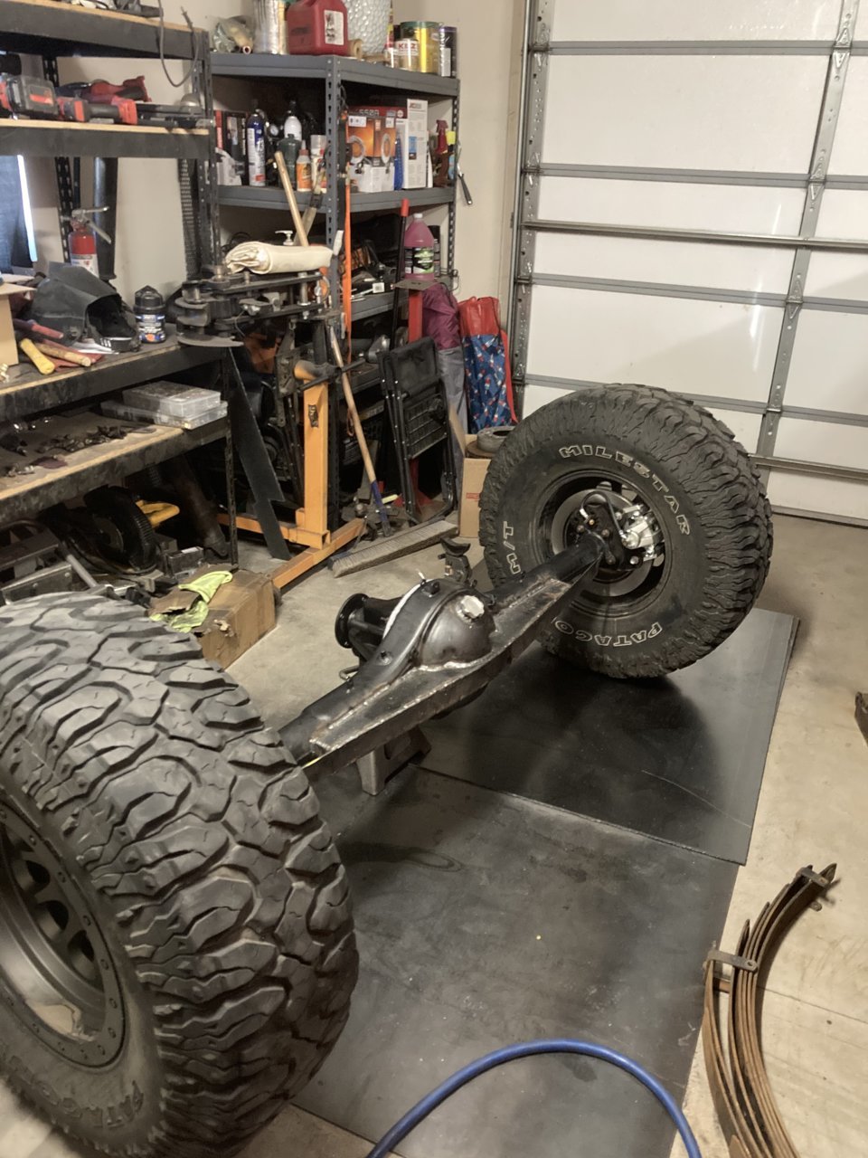

  17. Apr 25, 2021 at 5:12 PM
    #717
    snowsk8air2
    Sep 16, 2011
    #63607
    10,523
    Flagstaff, AZ
    Supercharged TX Pro
    And almost in with the new.
    Turns out when you try to stuff a bigger axle in, you can’t re-use your old u-bolts
    :annoyed:
    So that hindered some progress today. But those are on order snd should be here middle of the week so I can cycle things. Right now it’s looking like the driveshaft is going to be the limiting factor pending pinion angles.

    This is still stock. 1330 to 1350 u-bolt with a tundra rear yoke so it bolts up. Hoping this will work but really need to cycle things and find out.

    If you have an issue with the stock drive shaft, I believe DTF slid his carrier bearing forward. Not sure how much room that gives you though.
