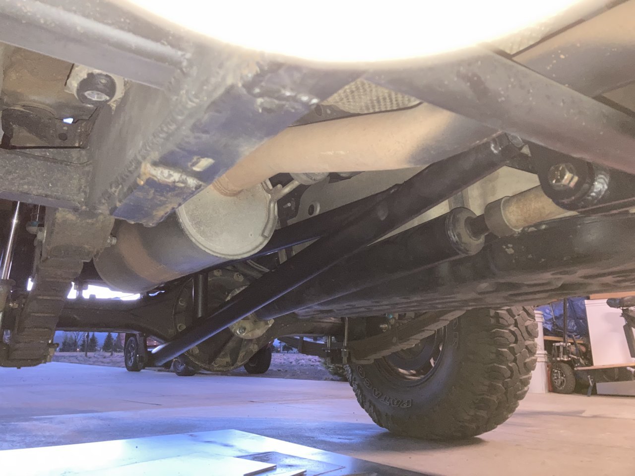

    Anti wrap bar is in and a huge difference. It either still has some wrap or I now have some anti squat because the rear still rises a touch on a launch but It's no worse than it did with the dmz setup.

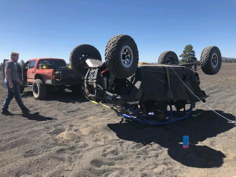

    Well, buddy didn’t make it too far on our drive this morning.
    Tie rod bolt snapped and threw them into a sharp turn doing about 55mph last I saw on the gps. Luckily the turn scrubbed their speed down to about 20mph before a nice slow pirouette onto the roof.

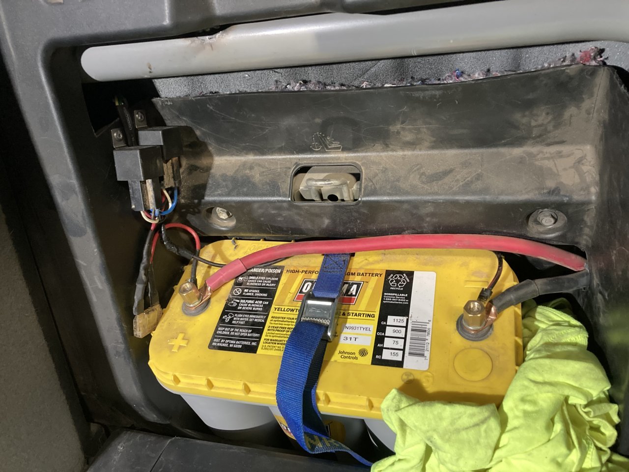

    Decided to finally get around to fixing my compressor wiring yesterday. Winter snow weather and some snow wheeling with relays and wiring pretty exposed didn’t make it last too long. Oops.
    So I completely reran wiring for it, new relays, new switch, moved the relays and fuse to behind the back seat. Switch and some wiring are still exposed as are the compressors in the wheel well. But I sealed as much of what I could in there with some urethane so it should be weather proof. Still might try to make some sort of shield to half protect things from getting thrown up by the tires back there.

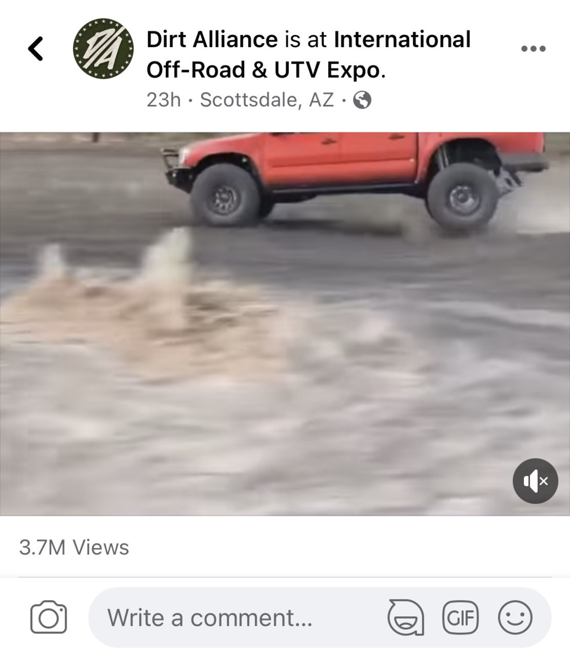

    Someone went viral! 2.2m views on Dirt Alliance's Facebook page, not to mention me seeing this vid everywhere on Insta!

    Holy shit! Last guess I had was around 500k views between all the shares yesterday on IG. Sure wasn’t planning on breaking the internet with this

    Where did you see views count? I only see how many times it’s been shared which is quite a lot as well. Just curious.

    On Facebook if you click the video.
    Up to 3.7m!!!
