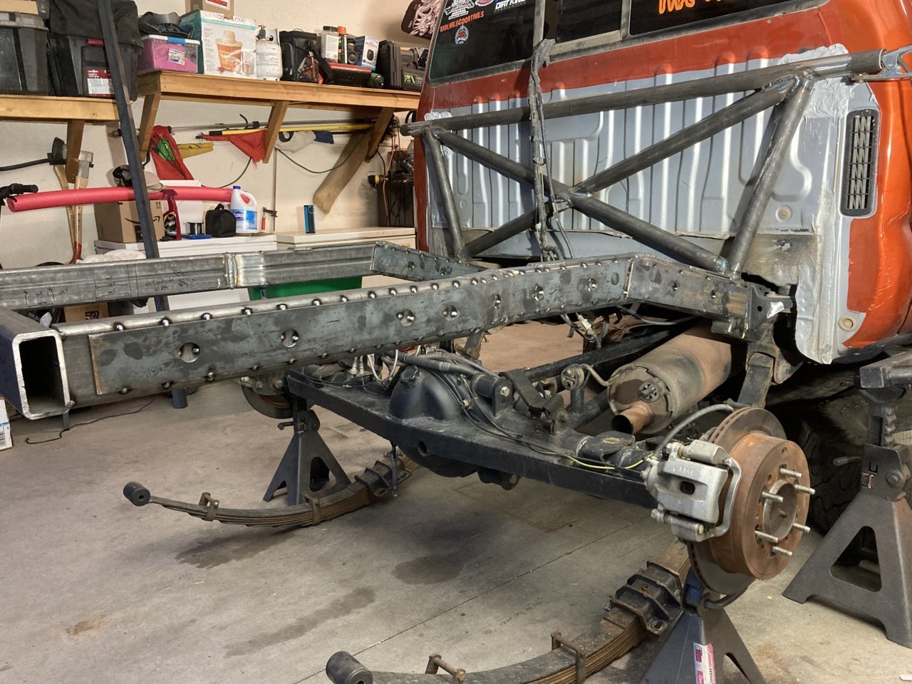

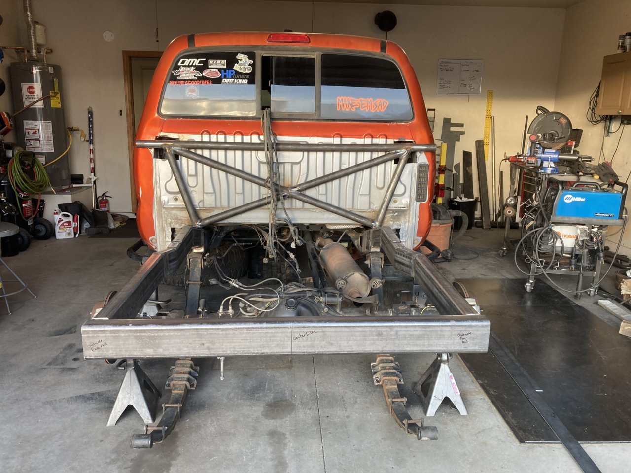

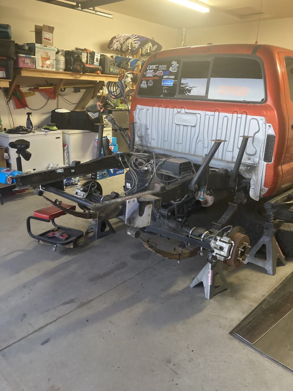

    Well I took about 40 measurements to make sure all the important stuff locates back where it used to. Time to drop the tank and chop at the back of the cab.
    94806231-C70C-4404-A86E-CBA994212DC4.jpg B4600CE5-8FF2-4741-BECC-69F781FF23DA.jpg
    should probably call to get materials on order as well.

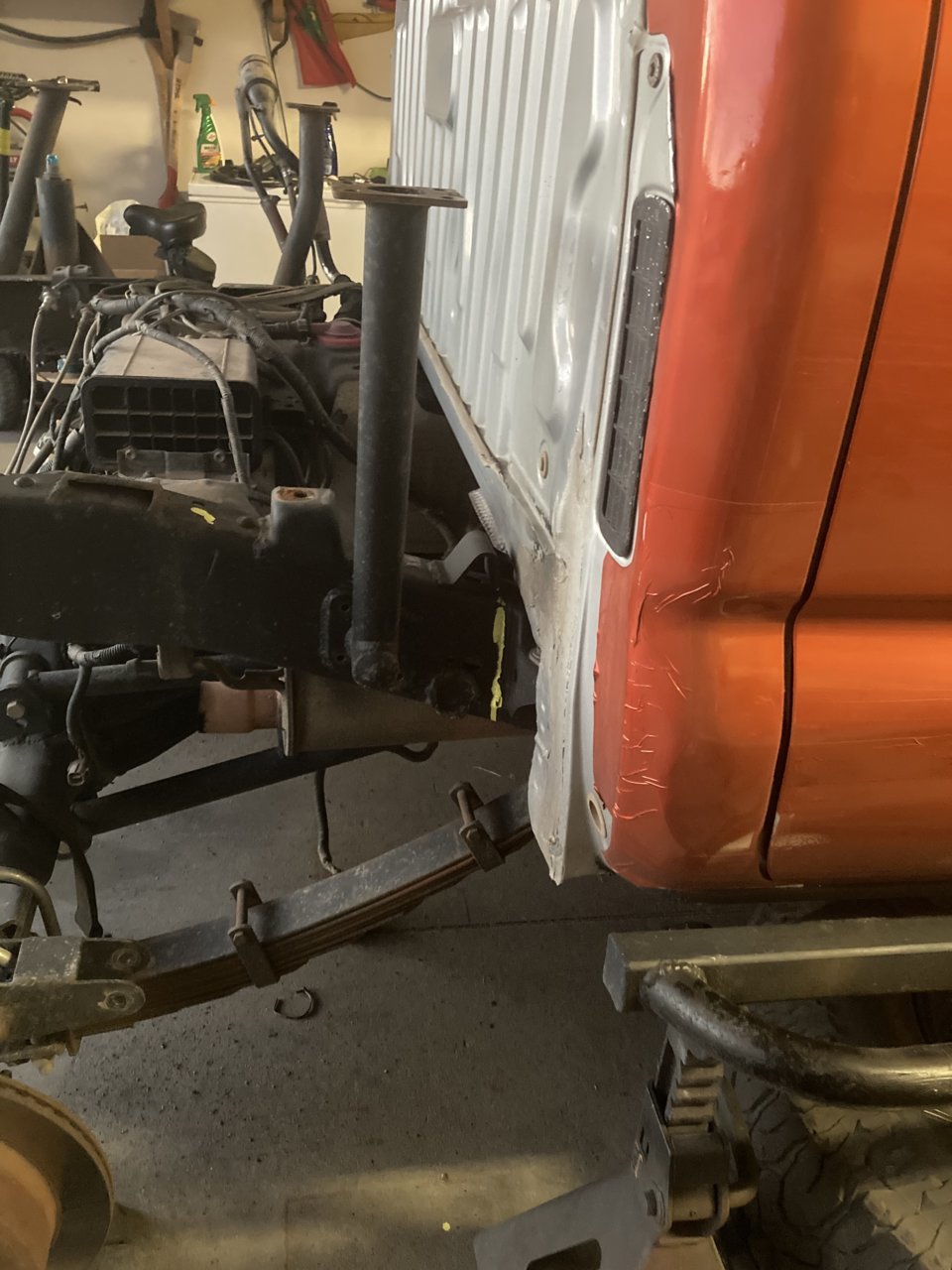

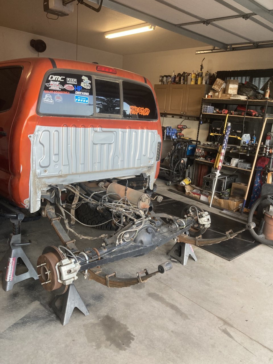

    Stock frame delete complete.

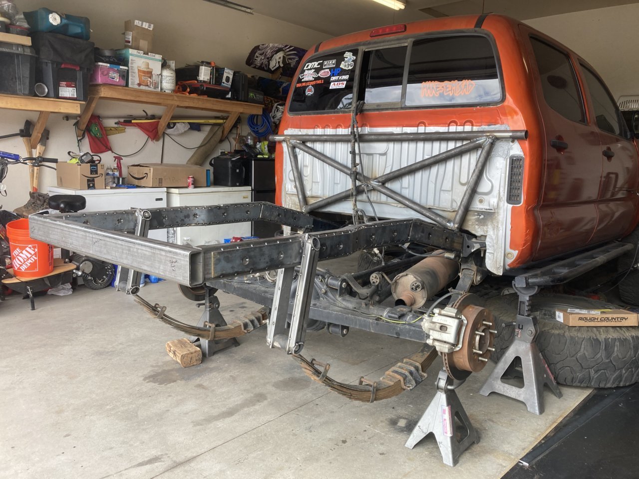

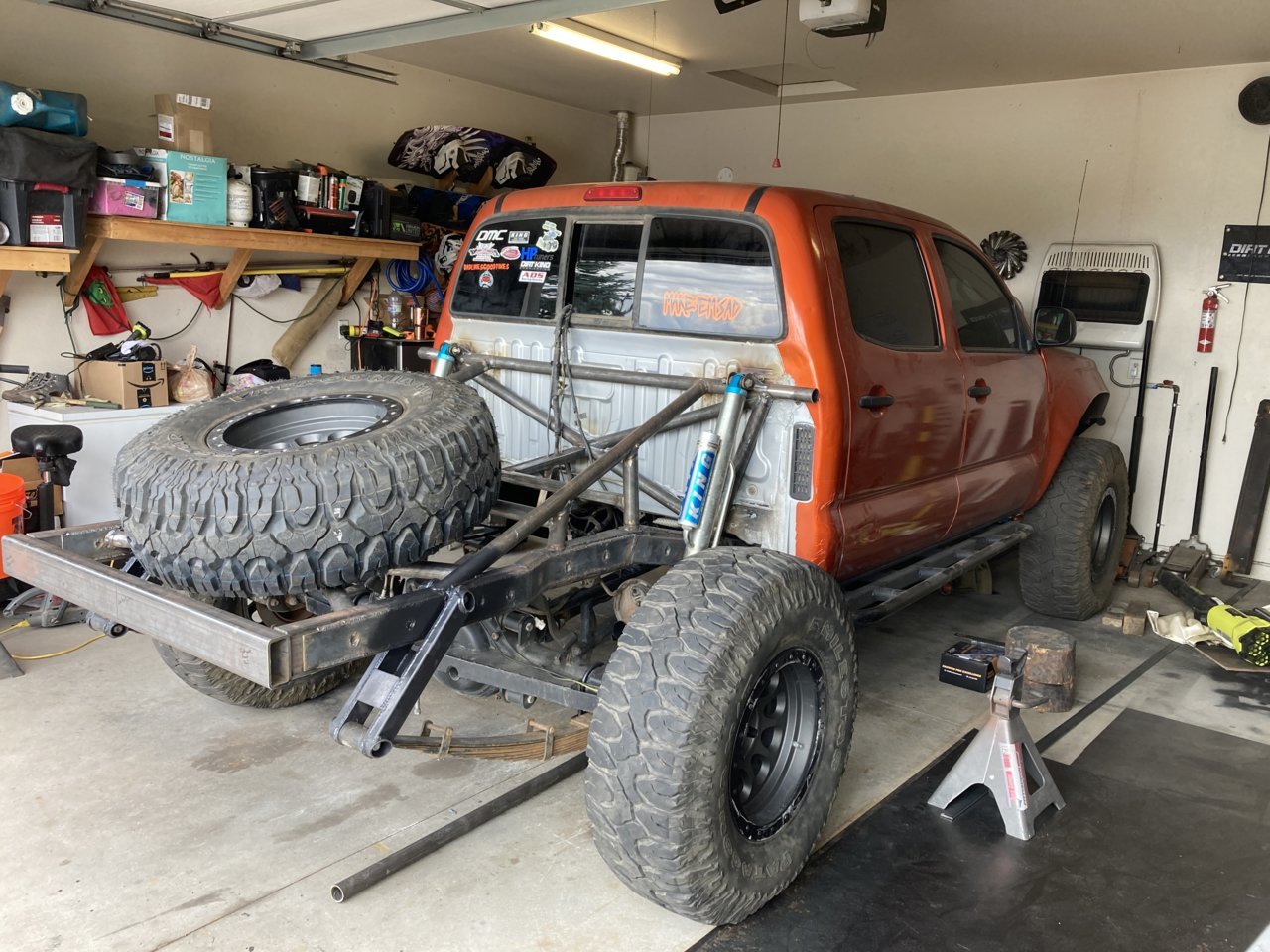

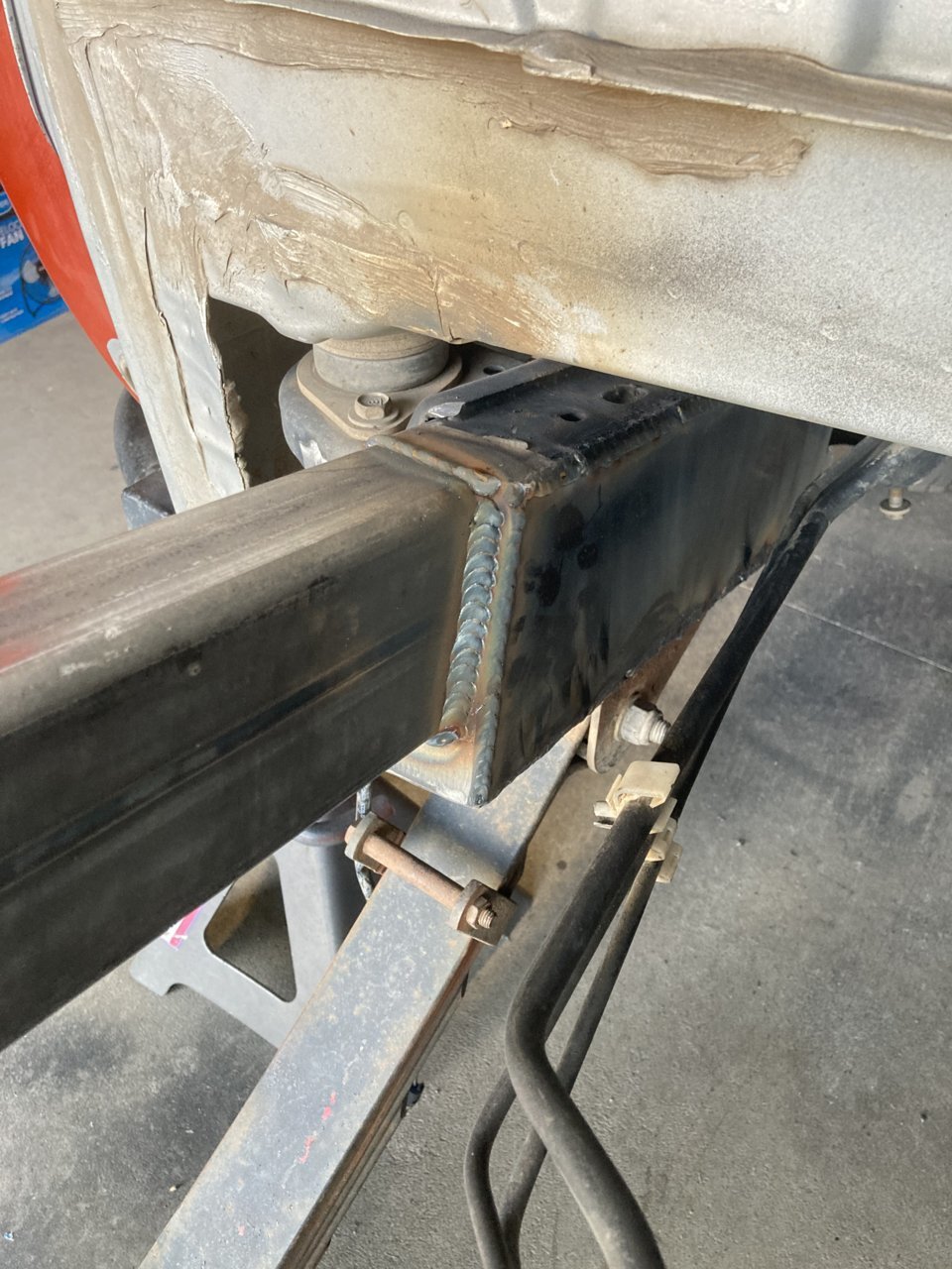

    It’s a start. Frame under the cab boxed in and new legs started.

    Updates. Frame is in place, tied into the cab cage, and slowly making progress. Hopefully gonna get the cab sealed back up this weekend and start working on the new shackles and pivot points.

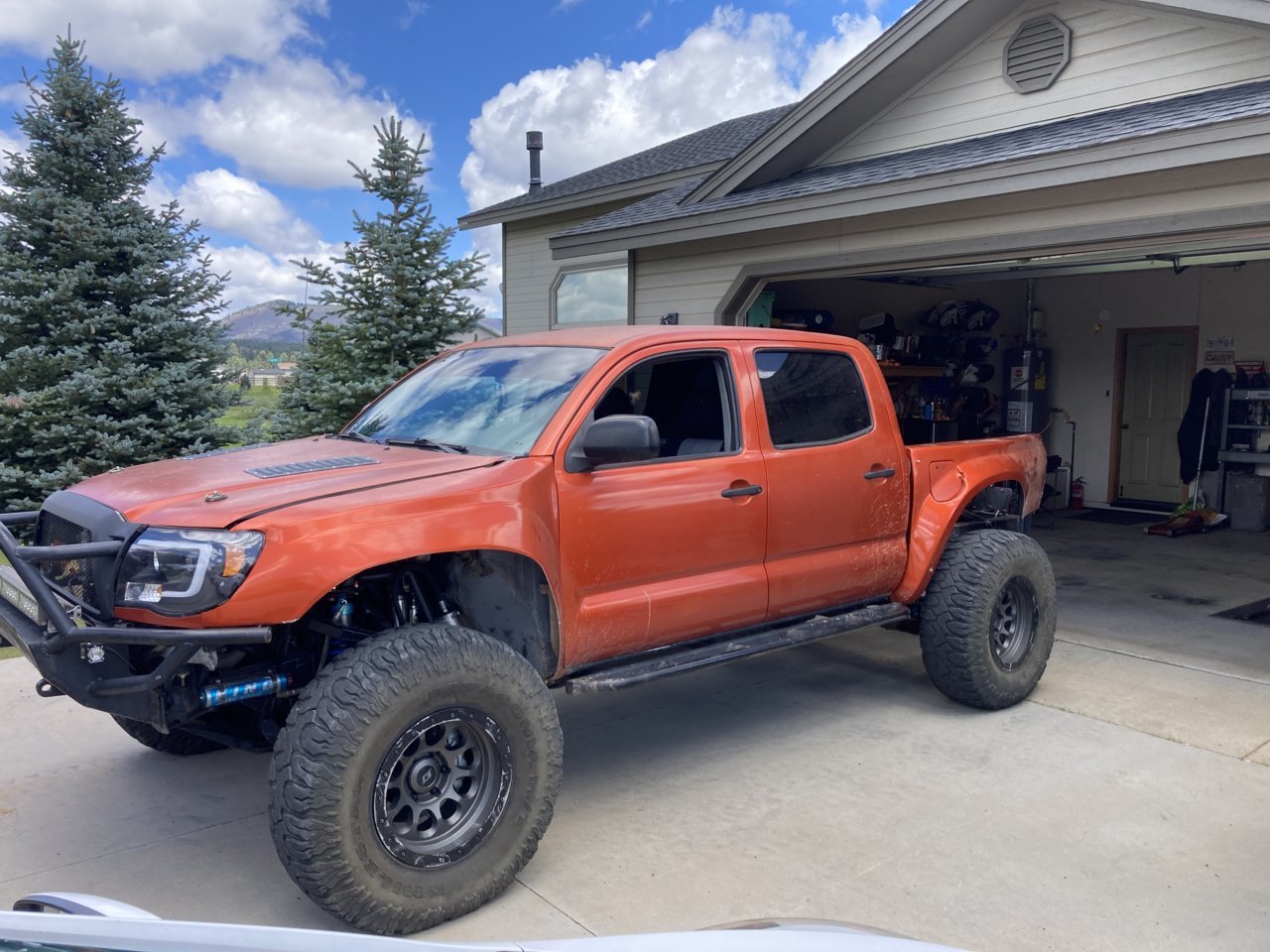

    Back on her own feet today. Still a lot to do but it was a good feeling.

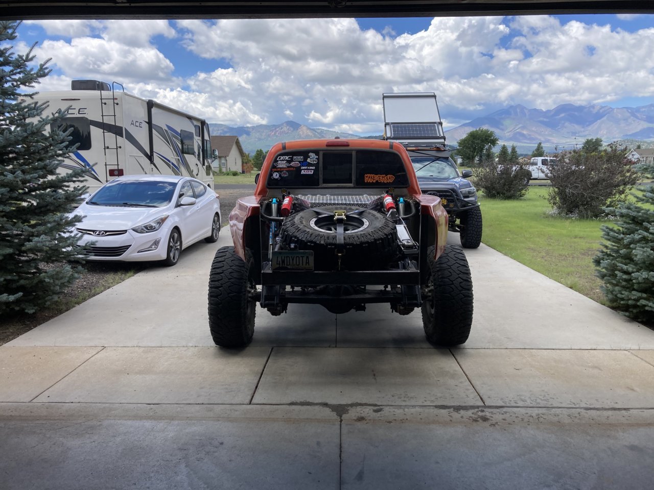

    Progress. Bedsides mounted along with chase lights and jack. Gave them a bit of a dovetail to make the bodywork a bit narrower in the rear since I opted out of bobbing the bed. Took about 10” off the overall width at the tail lights
