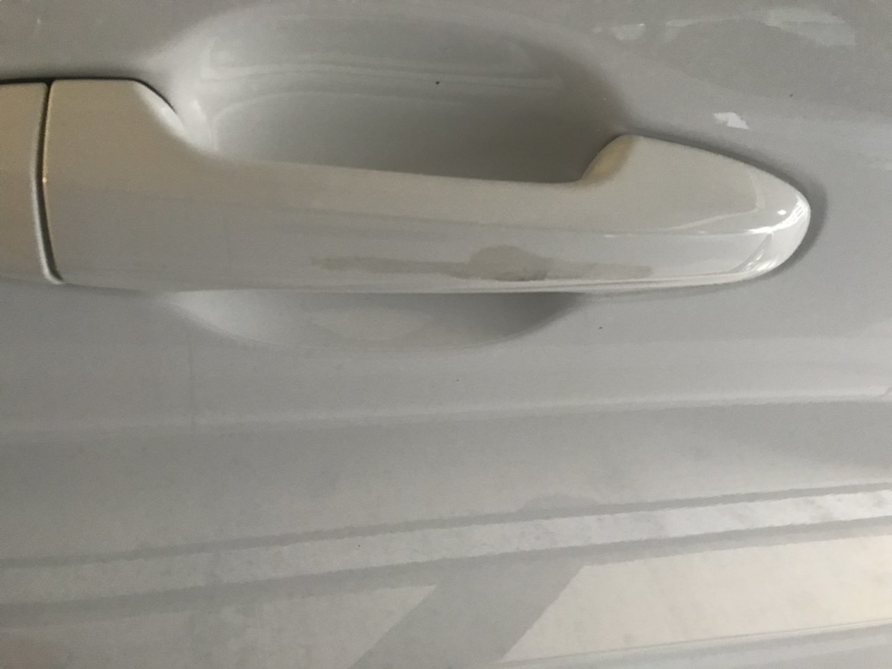

    Looking at my truck in the parking lot today, noticed a F150 parked really close to it. Checked for damage, and sure enough, that ***hole scuffed my white door handle.:annoyed:I left a note but don’t expect much to come from it.
    What am I looking at to repair this? Whole new handle? Or is it a white plastic cover? Or could a shop repaint it? Any advice is appreciated.

    Basically this, just use mothers or meguiars quick detailer with a microfiber cloth. Youll be solid.

    It damaged the paint, no doubt. I used some polish and top layer of paint was basically scratched off.

    Have it painted then. Can’t imagine it’s more than $150

    If you go at buffing it out and it fails to be what you expect you can Purchase replacement door handle with a perfect match from Toyota and they are super easy to install

    Try rubbing compound first.

    It’s hard to tell how deep from that picture or if it’s below the clear coat. But i usually start with the least abrasive and work my way down to something that cuts such as a compound if I’m not getting anywhere. But sometimes you can tel before you start if any type of polish/compound/wax is viable

    The Super White does not have a Clear Top Coat.

    Could just replace the handle if it won’t polish out, think you can get those already painted
