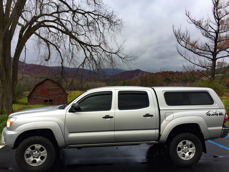

    Here mine is.

    The tightness of that is to be commended.

    Do you have a lift on that? If so, may I ask what it is?

    Yeah. I should mention my configuration and lift amounts in front end are not the norm for the components I used. V6 / V6 4x4 guys will need different coils to get a similar lift.
