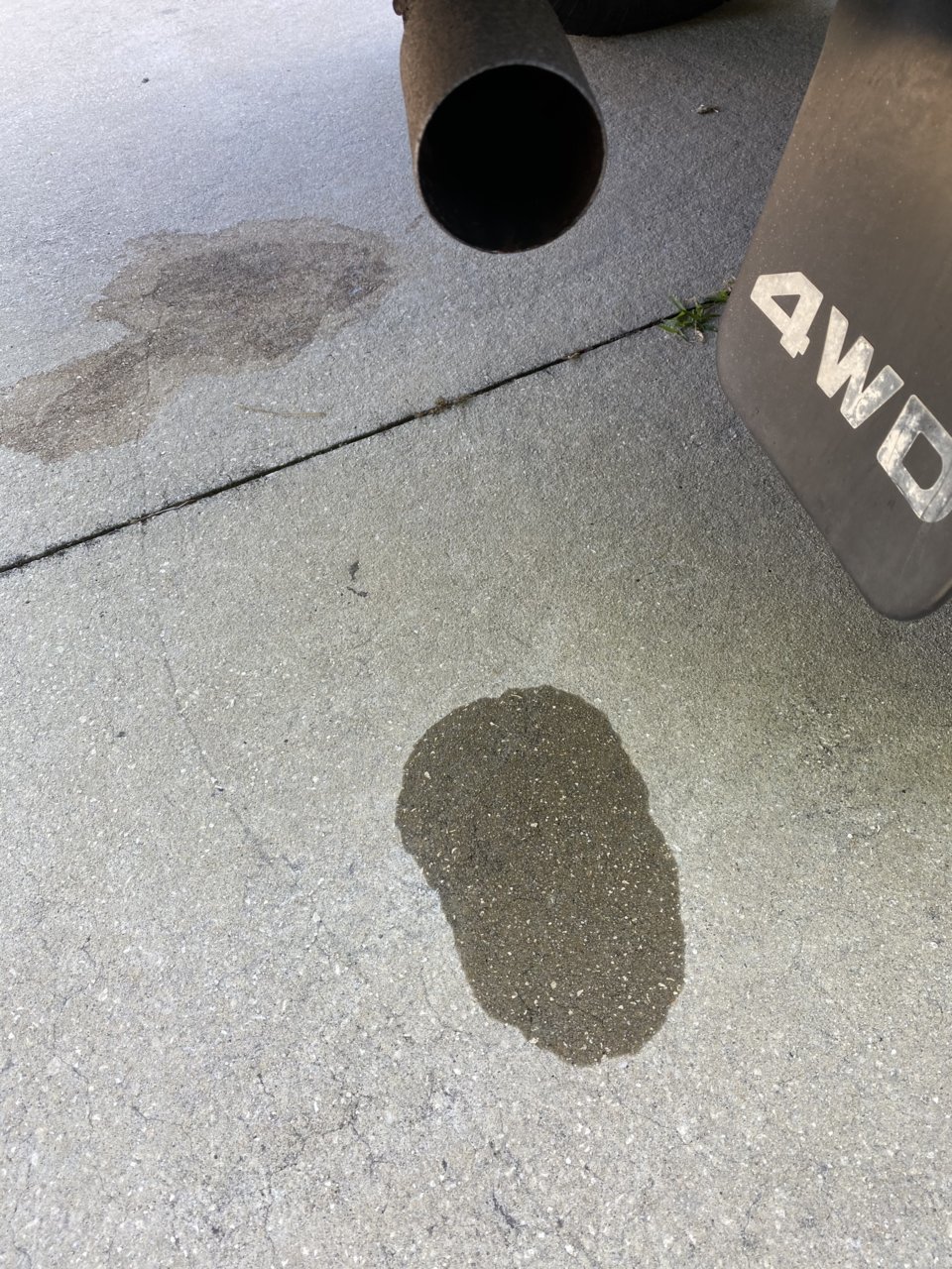

    also, question on exhaust leaks, this may sound stupid but could an exhaust leak cause excess moisture in the exhaust? I’ve noticed in the past maybe month or so that there seems to be more water than I’ve ever seen from it, not like it’s dumping out but more than it used to and more than my old 4runner. I smelled it and has no trace of smelling like coolant nor is there any smoke. Just excess water it seems, my muffler now has a small hole rusted in it and is leaking water. This only showed up in like the past month. Maybe I just never really realized this before but I can’t help but want to fix it haha
    the pic is after about 2mins of cold idle, water started dripping, same with muffler

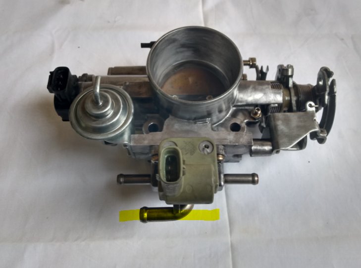

    I don't know about the year model differences, but my 99 model has a vacuum line that is hidden from view. I have it highlighted below. Just something to check.

    Water dripping out of the exhaust after start up is normal...nothing to be concerned with unless it does it excessively after being warmed up for several minutes

    My throttle body has that same line, I’ve checked them all and they all are intact. I couldn’t get the vacuum hoses off of the other two on the sides and I’m waiting for replacement hose so I can just cut them off instead of fighting them

    That’s what I figured, all this other shit on my truck is making me find problems that don’t exist haha
    GQ7227 and eon_blue[QUOTED] like this.
