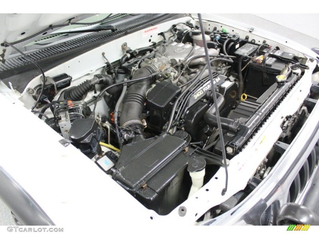

    I’m not at home right now to take a picture but yes it’s stock engine intake.
    This isn’t my truck but this intake has the exact same parts mine has.
    That’s what I thought maybe, that’s why I want to try to do a smoke test to start ruling things out

    Do the soap test on the components up to the throttle body to rule that out. Could have a crack somewhere

    on the back of the 3.4 there are a number of kind of hard to get to vacuum lines. One is for the fuel pressure regulator and on the back of each head there is a vacuum port that feeds the to the air passage under the injectors. There is also a plastic Y.
