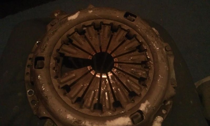

    found what i believe is likely the cause... a broken tooth on the pressure plate n...
