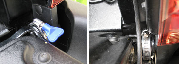

    do the hose clamp method.......cheap and easy, and it works pretty good too man.
    cant find the link......but basically all you do is open the tailgate and use a small hose clamp that will fit onto the part where the tailgate hinges/comes apart from the truck. alot of people have done it and had great results. if i can find the link soon......i'll post it for you.:)

    I have had a tailgate stolen and it sucks. I have been driving a truck since '95 and never needed to remove my tailgate so, as an extra measure, I put jb weld over the worm drive of the clamp.

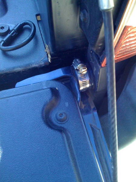

    well mines a little less hardcore than the JB weld but you get the idea

    Good ideas with the clamp and the JB weld. I had thoughts of putting the clamp on then disabling the hex and the slot. Epoxy was one idea. After seeing the pics I will take and look and see if I have room to cut off the head of the screw drive with a Dremel tool.

    use the new hose clamps that use the triangle key. once the key is removed there is just a solid triangle. thats what i have one mine in combination with the pop and lock.
    oh and if you don't want to scratch the paint with the hose clamp, do what i did and use one of those cheap rubber wristbands and put that on before the hose clamp

    I couldn't find hose clamps like the ones above so I used some regular hex head ones that also have the flat screw driver slot. I filled the slots in with JB Weld then installed them on the tailgate with a hex driver. I then put some heat shrink over the hex head and shrunk it with a heat gun. So now the hex driver and screw driver won't fit and someone would have to take time to cut off the heat shrink and then have a hex driver to remove the clamp. I hope this is time consuming enough to deter a thief. BTW the clamp moves with the tailgate and I have not noted any scratches when clamped without padding.
