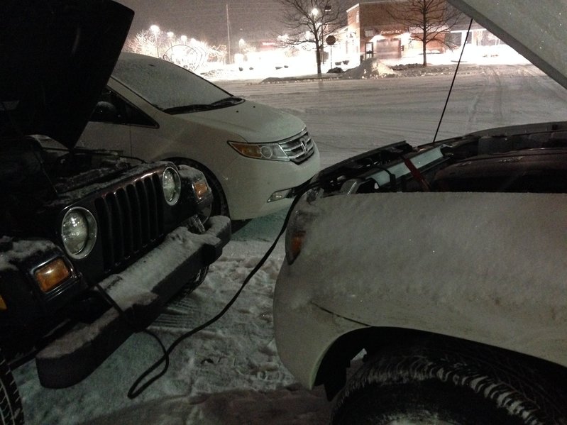

    image.jpg HAHAHAHAHAHAHAHAHAHAHAHAHA!:rofl:
    And guess what? Turns out the battery isn't why it won't start.
    :ohsnap:

    Idk. The lights come on just fine but no cranking or anything when turning the ignition.

    You're not going straight to the battery terminals on the jeep are you?

    He did yes. Why?

    There ya go. You have to ground to the engine or frame.

    You don't "have to". You should for safety reasons, but it certainly is not required. Electrically speaking the negative terminal is connected to the chassis / frame and is common ground.

    That is the recommended method.
    1. Red to dead vehicle positive.
    2. Red to booster car positive.
    3. Black to booster car negative.
    4. Black to dead vehicle frame, chassis, engine block.
    The negative battery terminal, the frame, chassis, engine block are all connected as a common ground point and are electrically the same point.
    The frame chassis engine block are considered safer than the negative terminal as if it sparks when completing the jump circuit (as it does usually) the spark will be away from the hydrogen venting from the battery.
