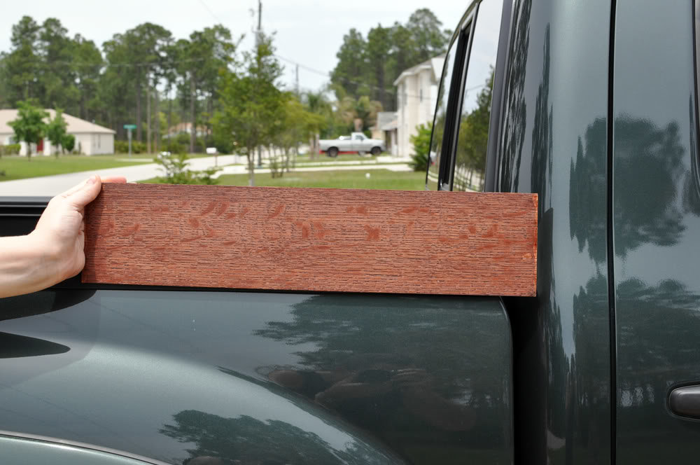

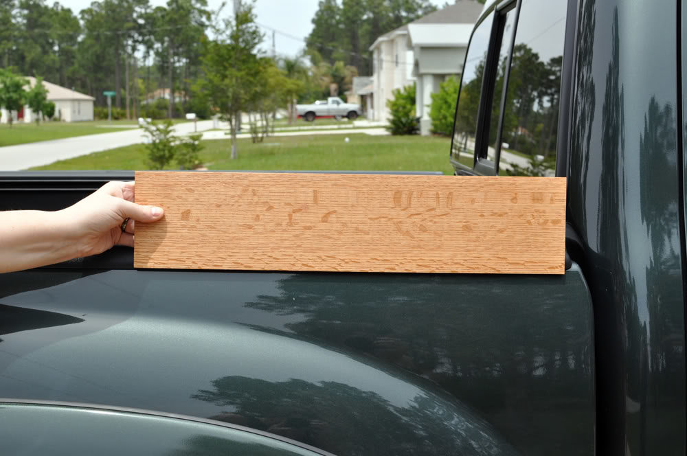

    I made up a test plank for color testing. The lighter color is natural oak while the darker side is stained with red mahogany. I'm leaning toward the darker color.
    We've changed some designs. We'll be using the same techniques used in building strip canoes. The test plank was made up of six 1/4" x 3/4" oak strips then glued up.
    Comments?
