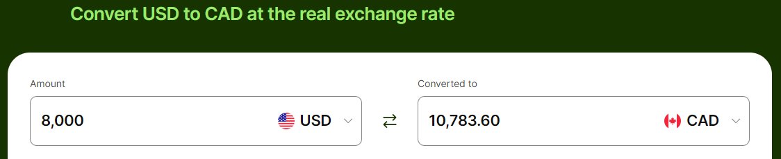

    Fwiw Your $8k USD is on par with @Tac2277 's $10k of funny money Canadian dollars.
