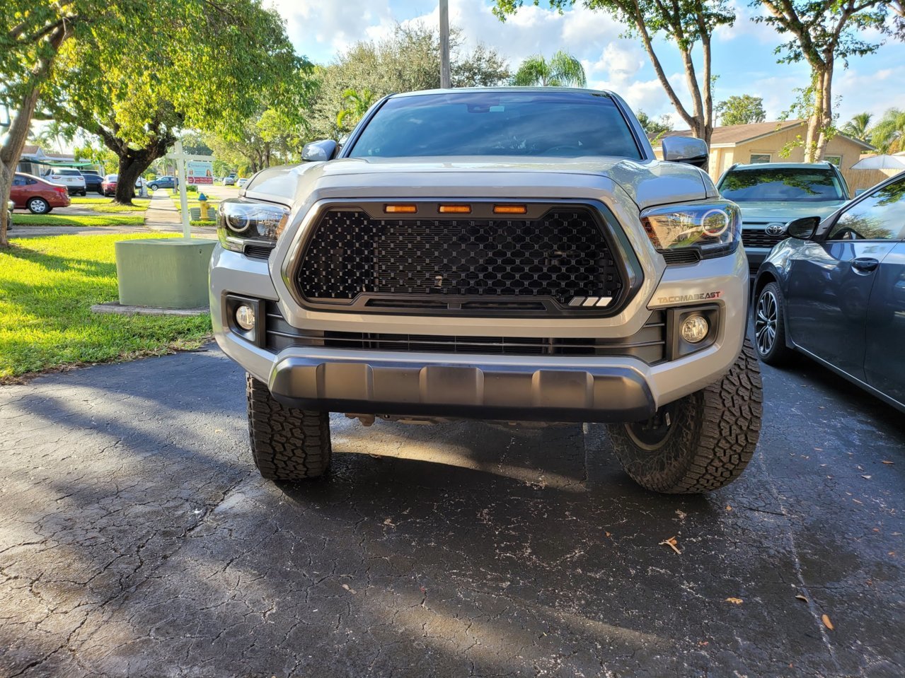

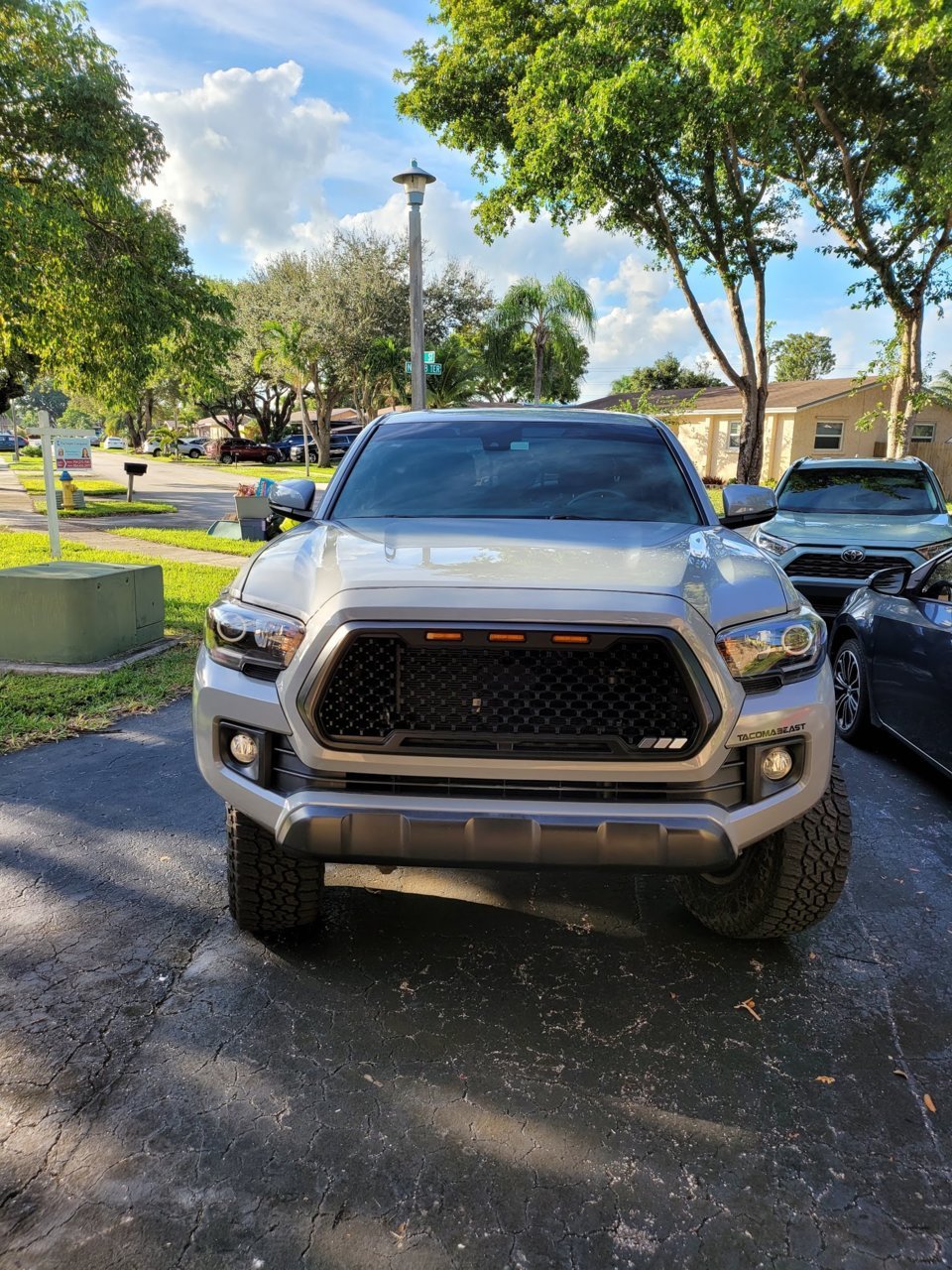

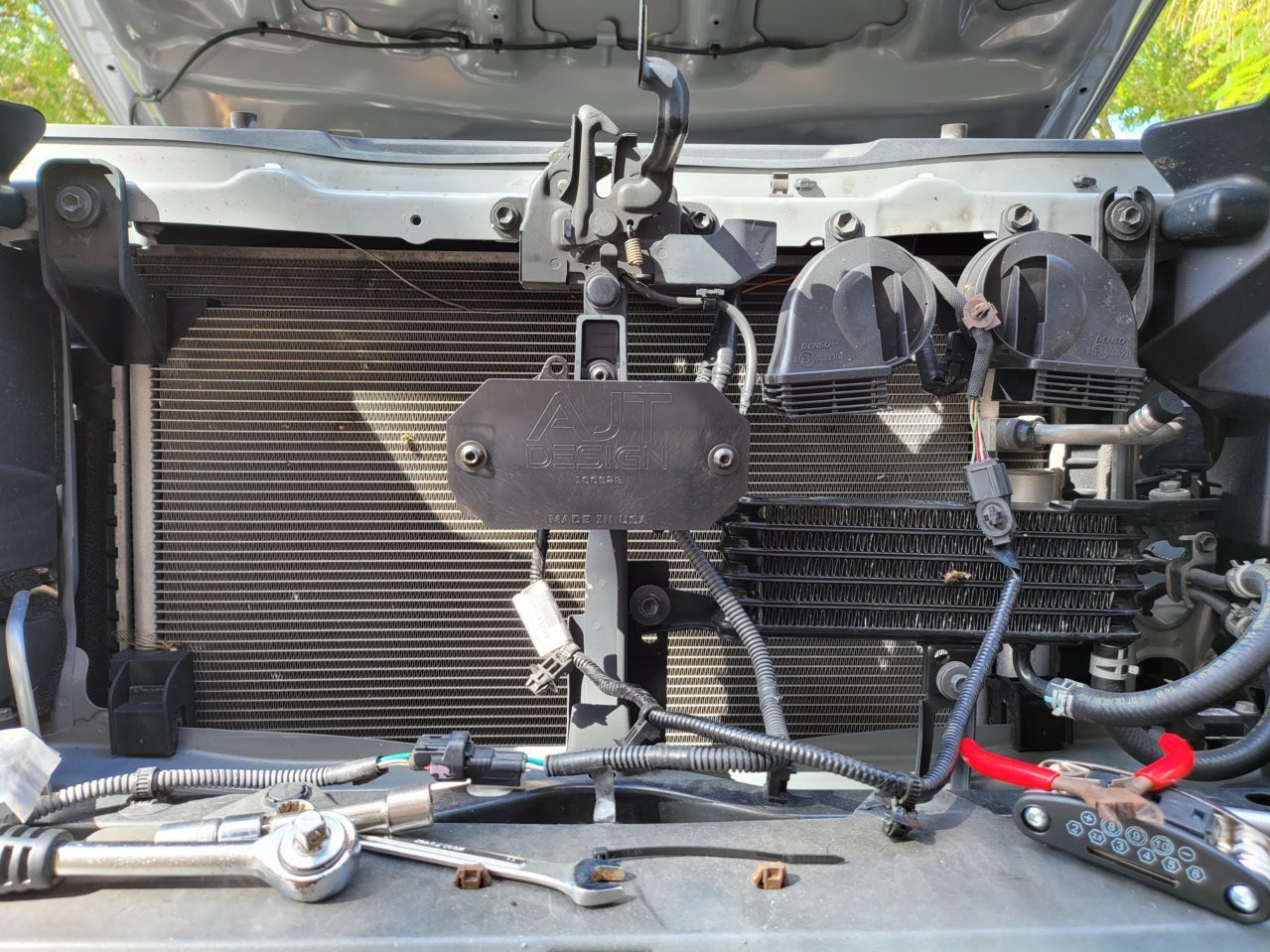

    been running new grille for 3 weeks. Went with Amazon grille and AJT TSS bracket. i received warning light once on first flight but none after.

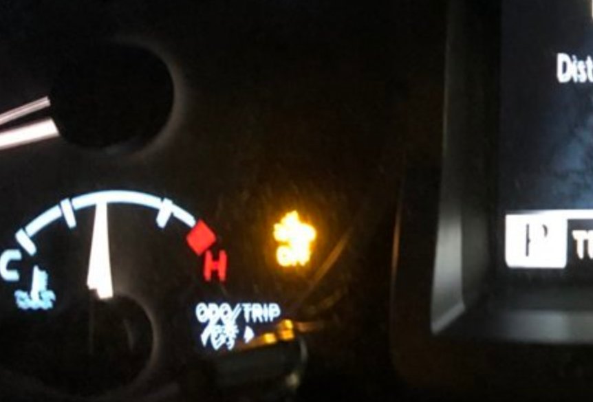

    Correct, it shows the following error in the dash. If you have cruise control on, it would just stop. Usually this lasts a few minutes then it goes away. It has only happen to me on long trips, never while DD a few miles a day.

    I've had mine from taco vinyl for two years and it only gives the tss error on the dash (like the picture above) on extremely hot days, over 110+ degrees in AZ, when I park the truck in direct sunlight. After I turn the truck on and drive for a mile or so it'll stop giving the error. I'm not sure if it's a tss system issue, or because the large holes in the grille, but it doesn't really bother me.
