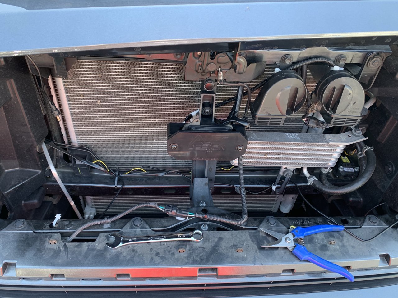

    84744FC1-459A-4900-B8E7-38FC965A4BB1.jpg 8196D115-DF29-4695-8A73-B0B188BDC279.jpg
    alright guys so I bought the ajt design bracket and so far so good no PCS light after a 30 minute drive.
    In conclusion if you want this grill buy the 2016-2017 version and then buy the ajt design bracket separately.

    I was able to make mine work with the ajt/custom grills bracket with the one with the tacoma 2.0..but u could probably just use the ajt and hust drop it down lower
