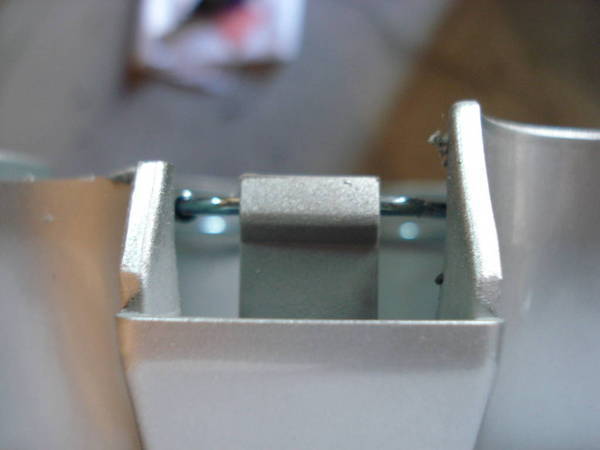

    1. Modded FJ TRD Centercaps
    Tools used:
    Dremmel with Thin Cut blade
    My Trusty SAK
    Dow 44 Grease - Used a bit on each tab for easier insertion

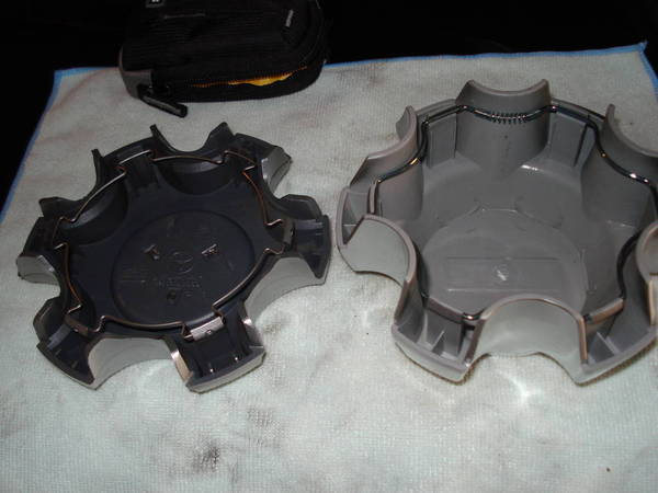

    Height Difference:
    Side to Side Comparison
    Cut - note the amount removed

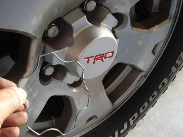

    Finished - I used the Snap Ring in the photo - comes with the TRD centercaps
    It was easier to snap in place by placing a dab of grease in each tab. Pretty strong hold.

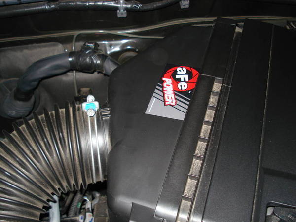

    3. AEF Pro Dry S installed
