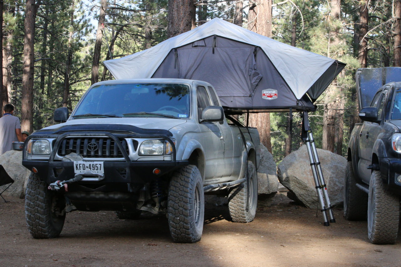

    I always wanted to start a build thread and now that the world is shutdown and I have time, here goes!
    AKAs
    Silvia – She’s silver
    Taco4r – My IG handle. I also have a 5th Gen 4R as my daily driver
    Brand Spankin New in 2003:
    Current Phase:
    Suspension:
    Front: Extended 700lb King Shocks. Total Chaos Upper Control Arm. mstudt non disco sway bar end links.
    Rear: OME Dakar Leaf Packs. Fox 2.0 Shocks. OME Greasable Shackles.
    Future: AAL or new leaf pack. Sagging with ~500 lbs in the bed.
    Brake lines: Wheeler's extended front and rear lines
    Brakes: Tundra big brake 13WL upgrade front caliper & rotor
    Regear: 4.56. Not necessary with my MT but my rear diff went out and was planning to tub and run 35's. I'm happy with my pizza cutters and will go back to stock 4.10 eventually.
    Wheel/Tire: BFG M/T 255/85R16. Procomp 7069. Got a steal on these wheels. 4WP was discontinuing and had display wheels for $25 each.
    CB: Uniden Pro520XL. Mounted in the ashtray location. Firestik currently mounted on bedside.
    Headunit: JVC 6.8" Double Din with Android Auto
    RTT: Area BFE Soft Shell
    Armor:
    - CBI Moab 1.0 Front Bumper
    - CBI Rock Sliders
    Recovery:
    - Hi-Lift Jack
    - Maxtrax
    - Warn Winch 87800 M8000 Synthetic
    - Bubba Rope
    - ARB kinetic
    - Noco Battery Jumper
    Future:
    - Upgrade leaf pack for more weight
    - Rago CB tailgate mount
    - Rago bed stiffeners
    - RCI Front, Transmission, and A-Arm Skids

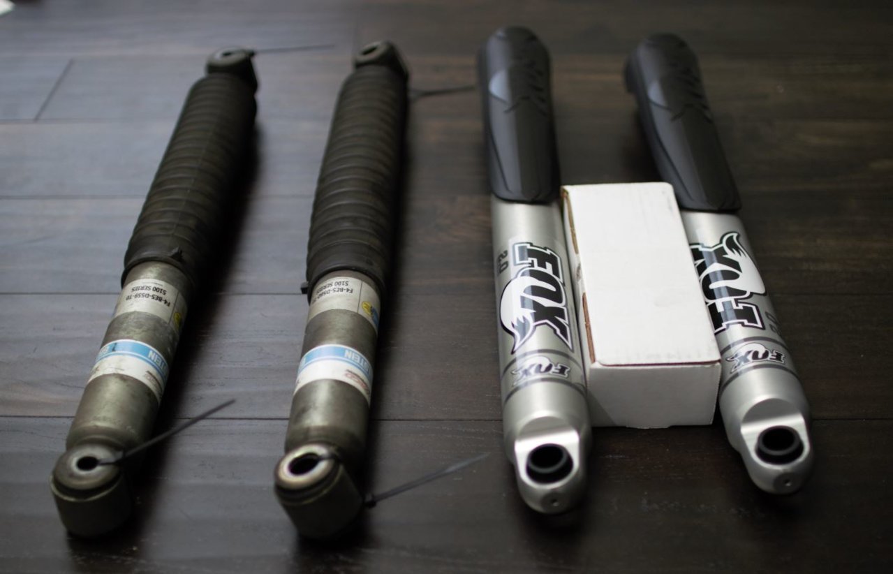

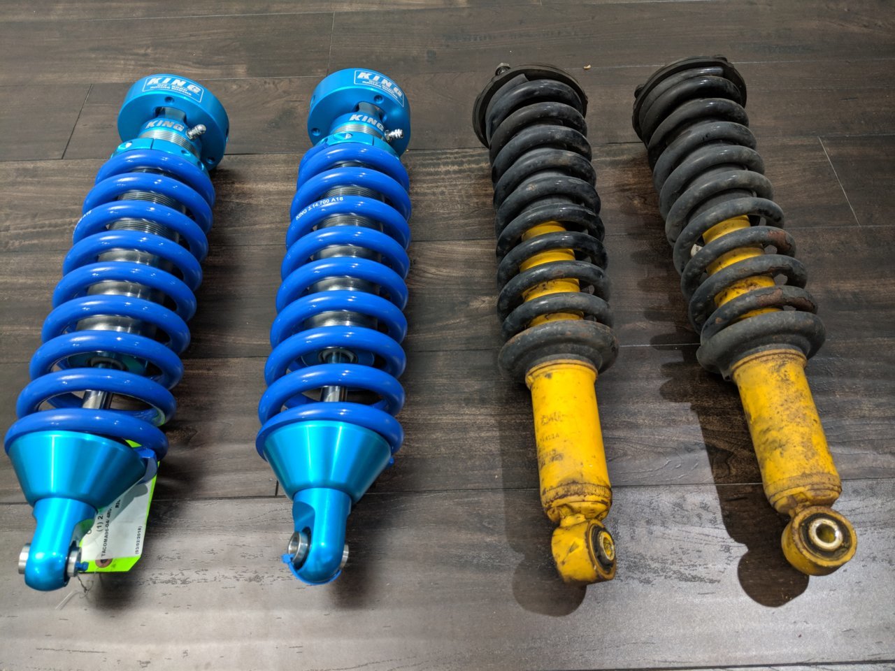

    Suspension
    My OME882s and Bilstein 5100s had over 100k on them and it was time for an upgrade.
    Front parts comparison. All beef.

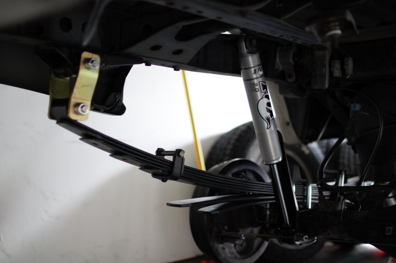

    Rear parts comparison.
    Forgot to compare my Wheeler’s and OME Dakar Leaf Pack.

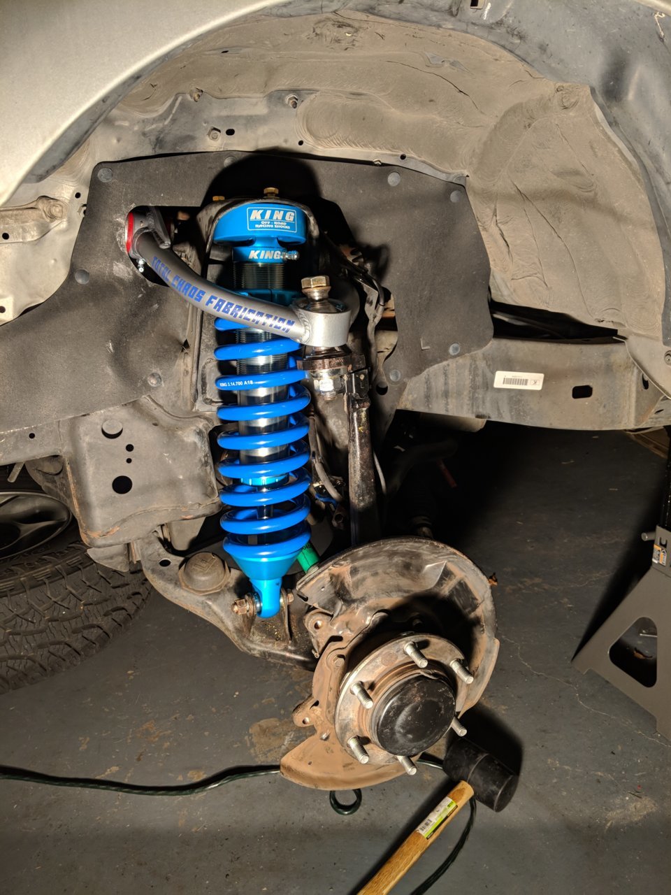

    Installed. That upper ball joint was a PITA to remove. If I can give any advice: Instead of trying to find a perfectly sized socket to punch it out, just cut it off!
    Lift Before and After
    Clearly needs bigger tires! Tires and brakes are next. Stay tuned!

    What’s the part number for those fox 2.0s, did they include multiple bushings for factory mounting?
  4. Jul 5, 2020 at 4:14 PM
    boshak
    boshak [OP] Well-Known Member
    May 23, 2010
    #37663
    750
    AG
    CA
    2003 Manual 4x4 5VZ-FE
    The stock bushing retainers and nuts are compatible with the bushings on the shock.

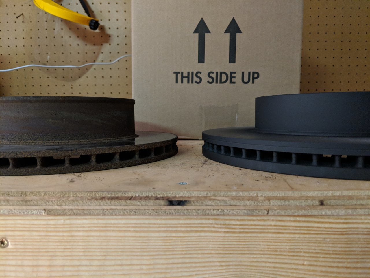

    Brakes: 13WL Tundra Big Brake Upgrade!
    With all that stock power, I somehow had to stop the truck. Jk... With bigger tires and fully loaded, brakes definitely needed a boost.
    Parts Comparison:
    Install:

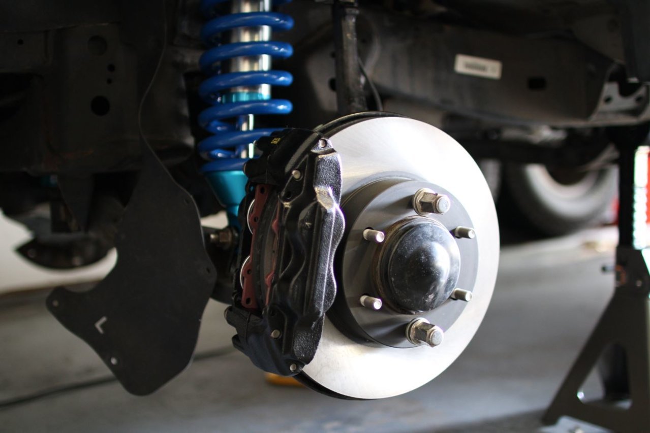

    Tundra caliper requires cutting the dust shield. This is from the test fit.

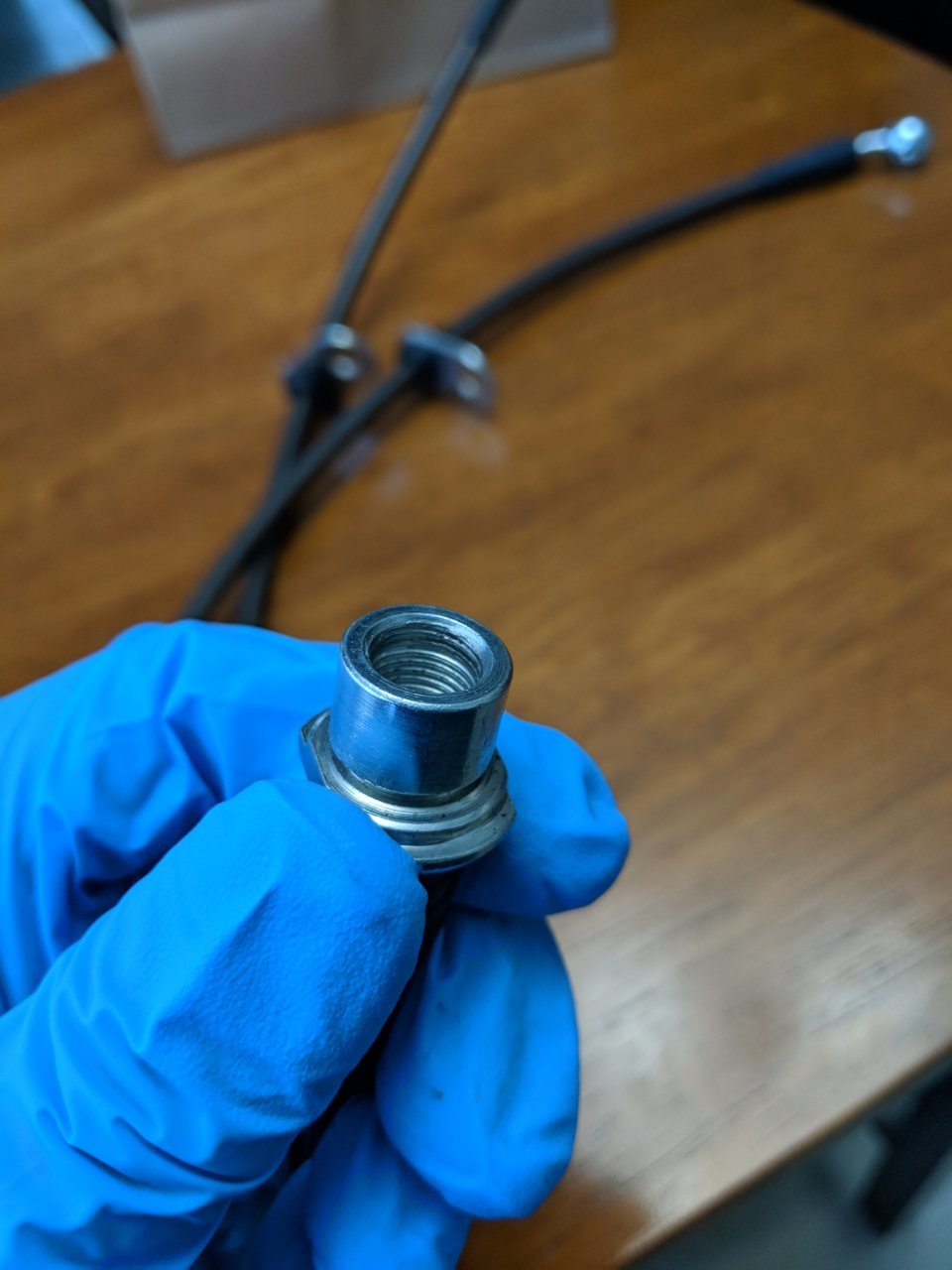

    Ran into a snag with the extended brake line. They shipped to me with bad threads. Wheeler's quickly shipped me a new set. Not worth "trying to make it work" with brakelines.
    To finish the install, I had a friend help me bleed the brakes then spent some time on an open road bedding the brakes.
    Installed: Isn't she lovely?
