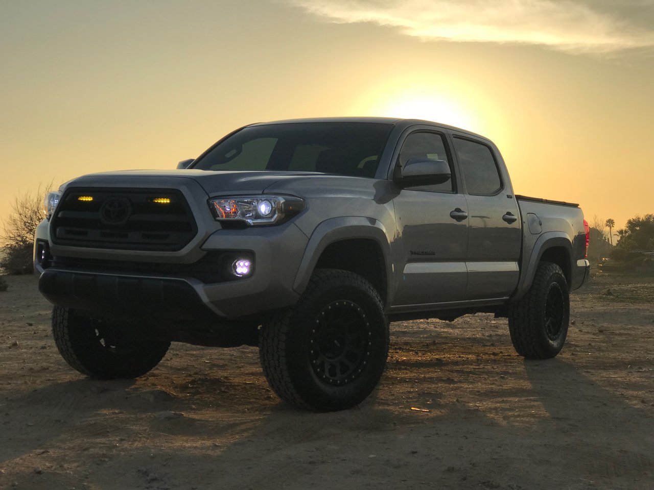

    I am here to introduce my taco, Tallua. I have been into the sport of off-roading for many years but now that I have my own truck, it is time to do my own build. Overall goal of the truck, prerunner.

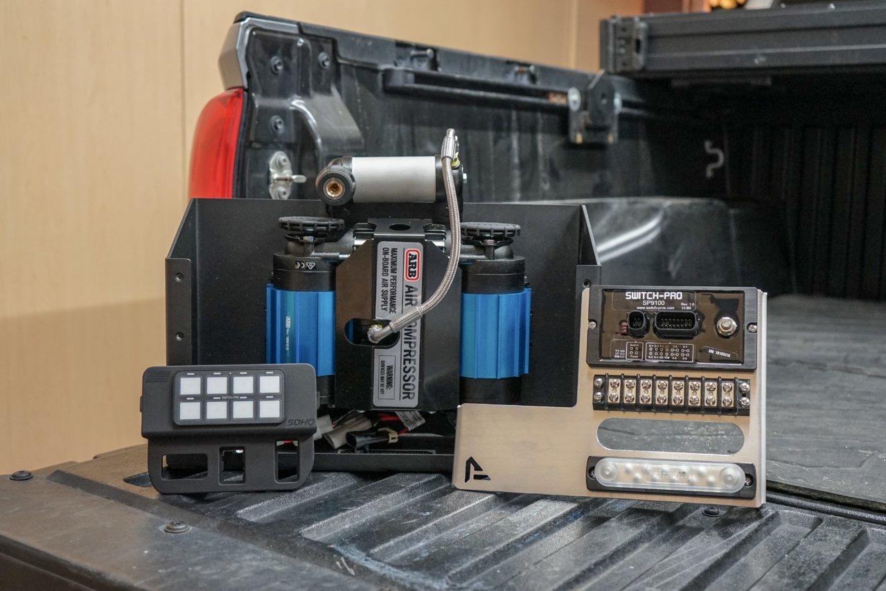

    SDHQ Swich Pros Mount, Expedition Essentials ARB Twin Bedside mount, and Powertrays Switchpros mount

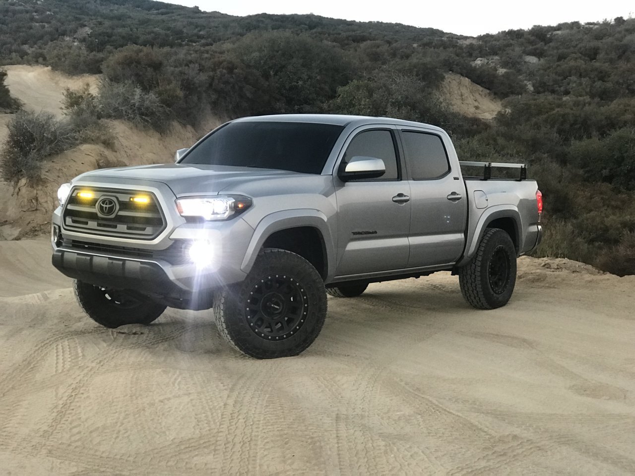

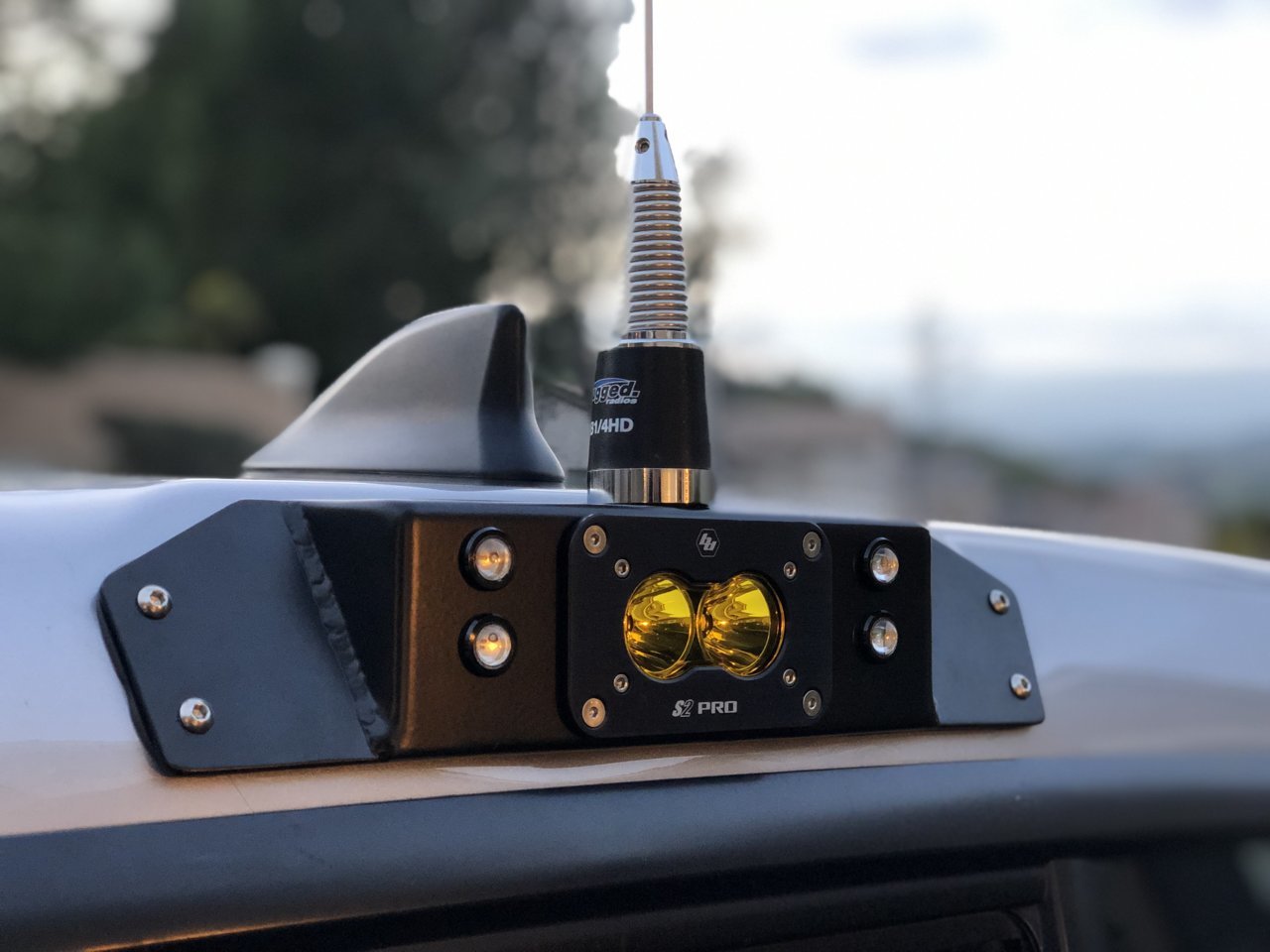

    Most recently I installed the SDHQ dual light bar brackets and rigged up 2 6in amber lights for the SR5 grille! Looks super clean and really proud of how it turned out.

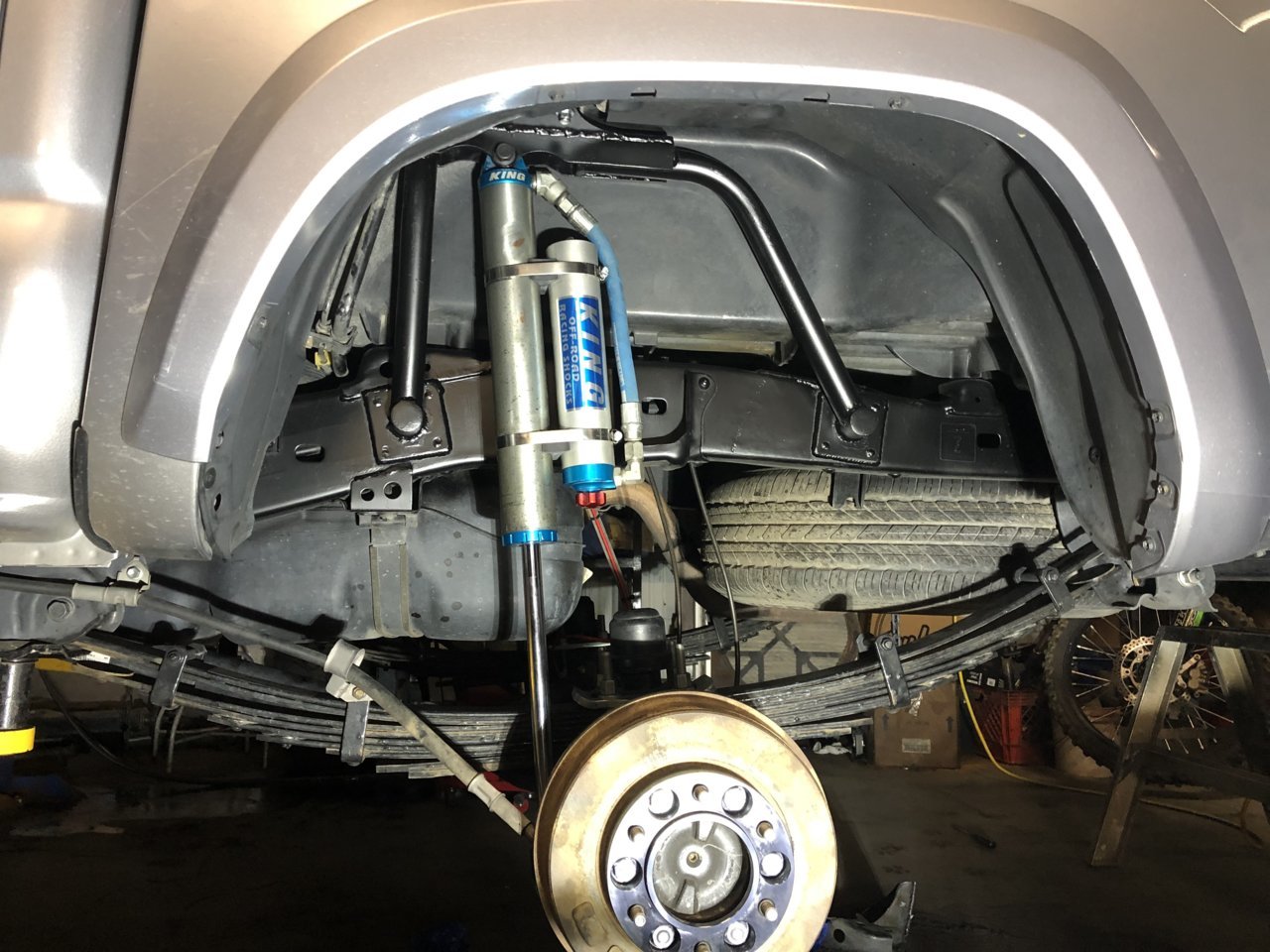

    Nice looking truck. The relocation and cross brace looks really clean. I'm looking at a similar route, got a couple questions for you
    -I see you're planning to go to DMZ spring under. How do you feel about the U402s and the relocate? Do you know what kind of up travel you are getting with the u402s? Are the 285/75s into the fenders before the springs bottom out?

    The U402's and relocation is a great setup if you plan on carrying a lot of weight. Right now I am currently sitting at 8.5in of travel in the rear which I believe is 1.5 over stock. (I don't remember the oem #'s). With the Deaver U402's there are 3 stages to that leafpack in which you choose how much weight you are going to carry. My whole plan for the rear was to match with my 4in maxtrac spindle up front so I needed to compensate it for the rear by doing a 3in lift of a leafspring. The current setup is good for what it is, but personally I knew after my first trip that I am going to need more travel. Honestly am thinking about ditching this current relocation setup. I know I can achieve at least 14in of travel because I know a buddy of mine runs a DMZ with a relocation and 12's.

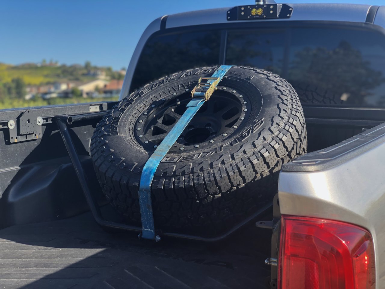

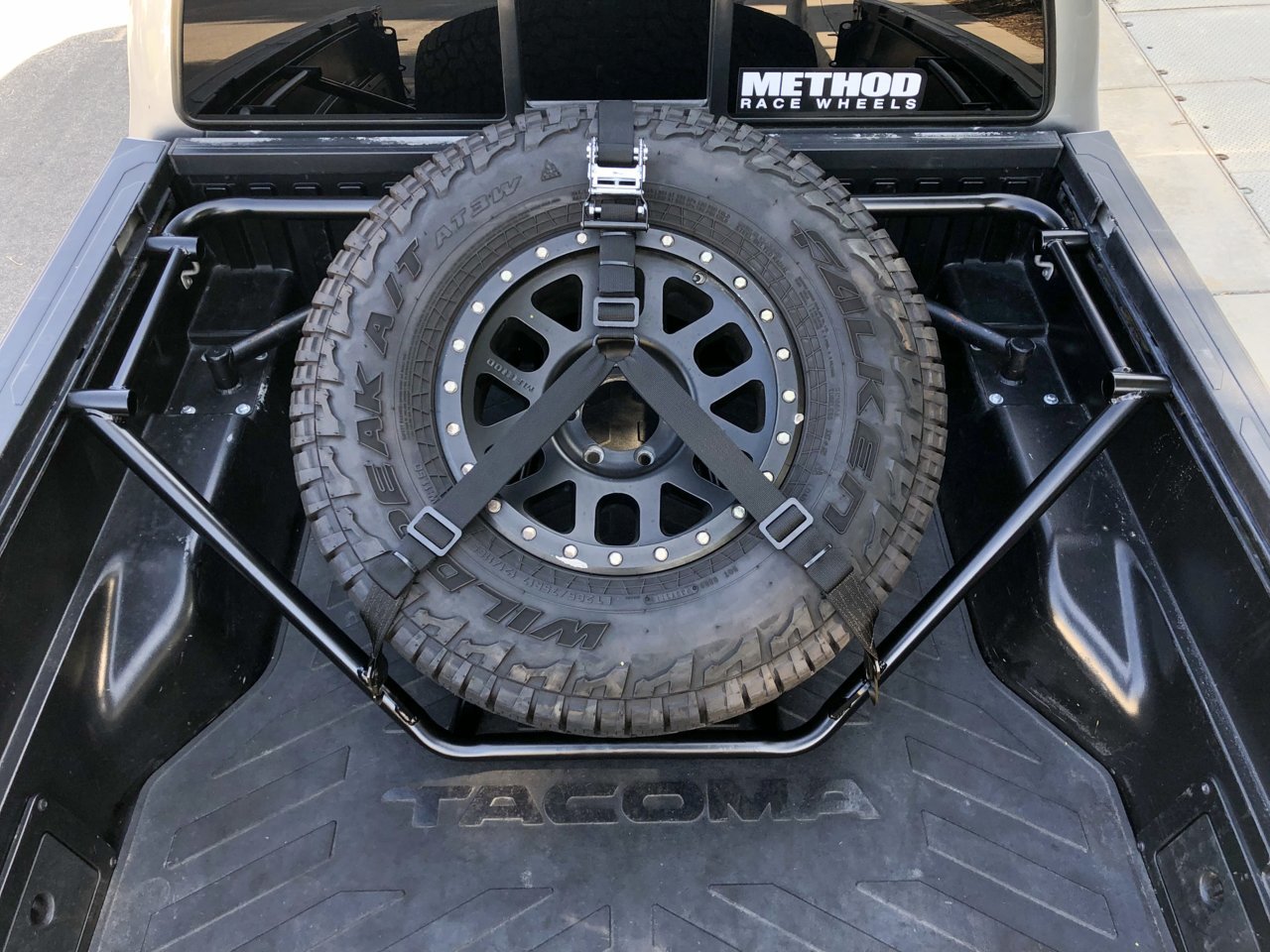

    N-fab tire carrier. Going to probably reconfigure the strap setup to a y-strap instead of the single across the middle. I can already see it shifting when driving. Really happy with it though so far
