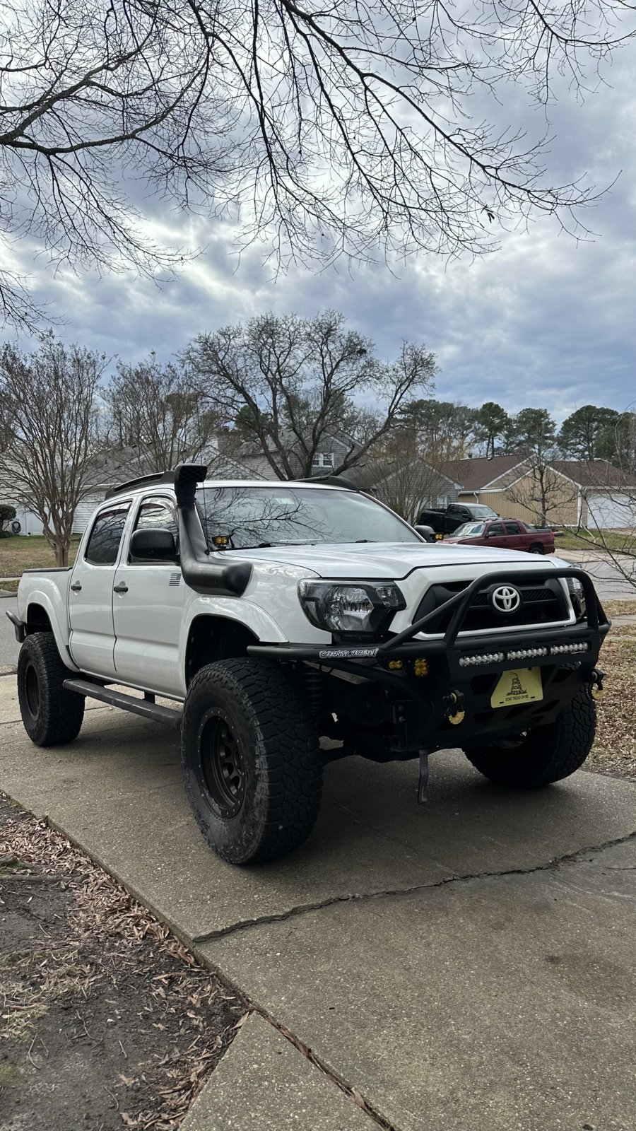

    219705 05Jan2024 Oil change

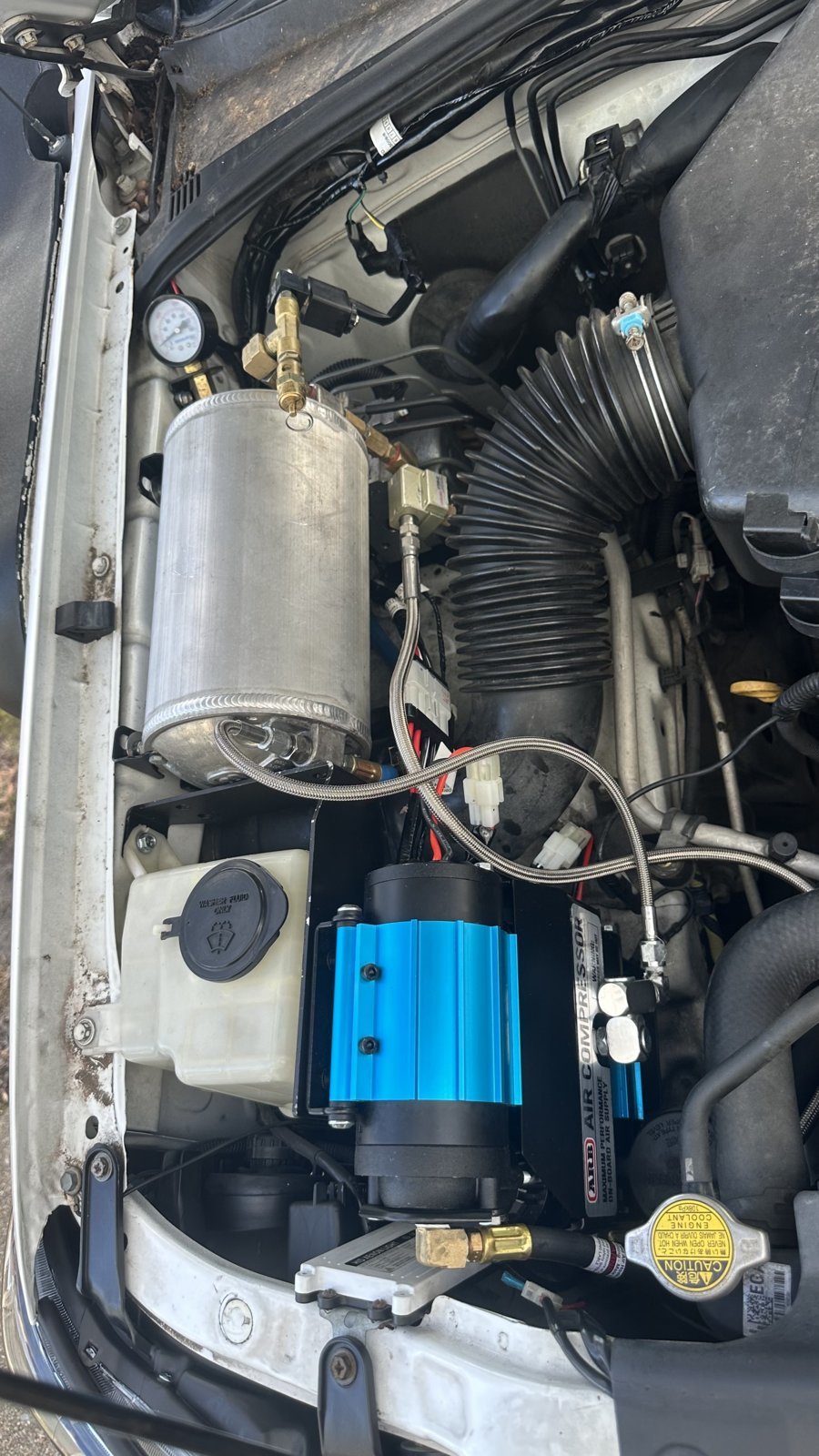

    Installed Sleeoffroad air twin compressor mount with Arb twin compressor, 1gal tank and rear locker solenoid.

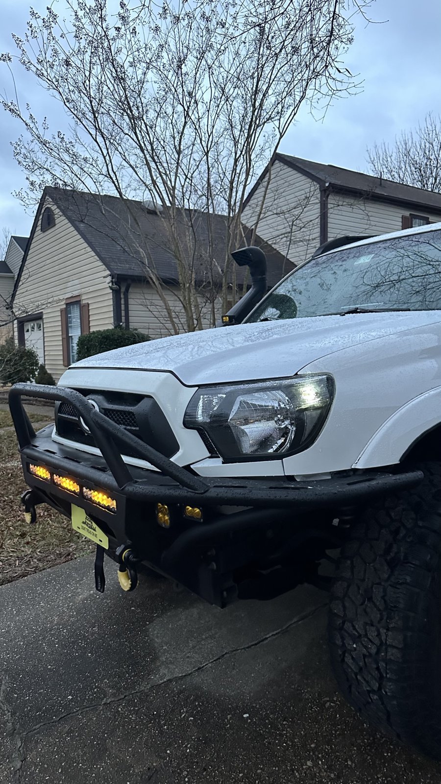

    Then i decided to upgrade Ben’s front end to 2012-2015 got the hood paint match by some random guy in facebook market not doing that again he seems like lied to me i told him the first time 040 is the paint code first he said yes i got the paint then when i bring the hood he started asking me again the paint color code i was like already felt something wrong but i just went with it not bad just a lot lighter white IMG_8225.jpg IMG_8235.jpg

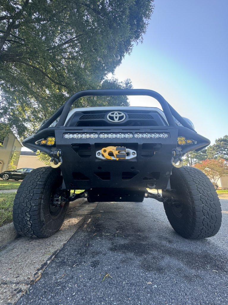

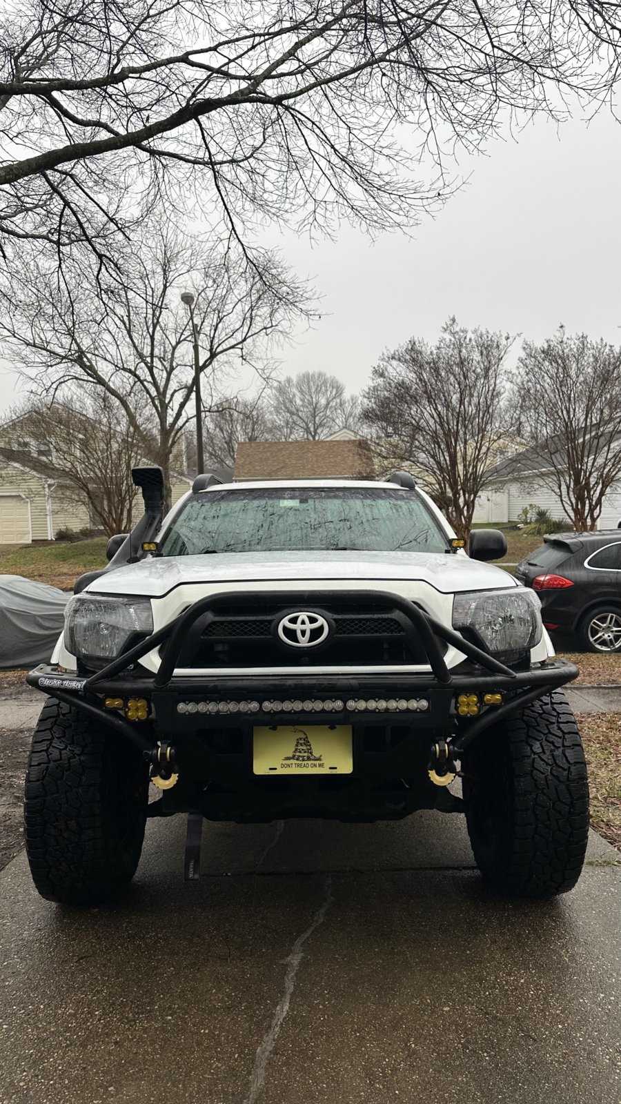

    Upgraded and installed to Tacoben’s:
    MOOG K100128 Alignment Caster/Camber Kit left and right
    MOOG RK621294 Suspension Control Arm and Ball Joint Assembly front left and right lowerIMG_9051.jpg
    Maxtrac Suspension 706840 2Wd Lift Spindles W/ Extended Brake Lines Dot Aprv. Left and right IMG_9052.jpg
    Tacoma Prerunner 2WD complete KOYO or NSK Front Wheel bearing assembly left and rightIMG_9053.jpg
    Awaiting arrival and install for

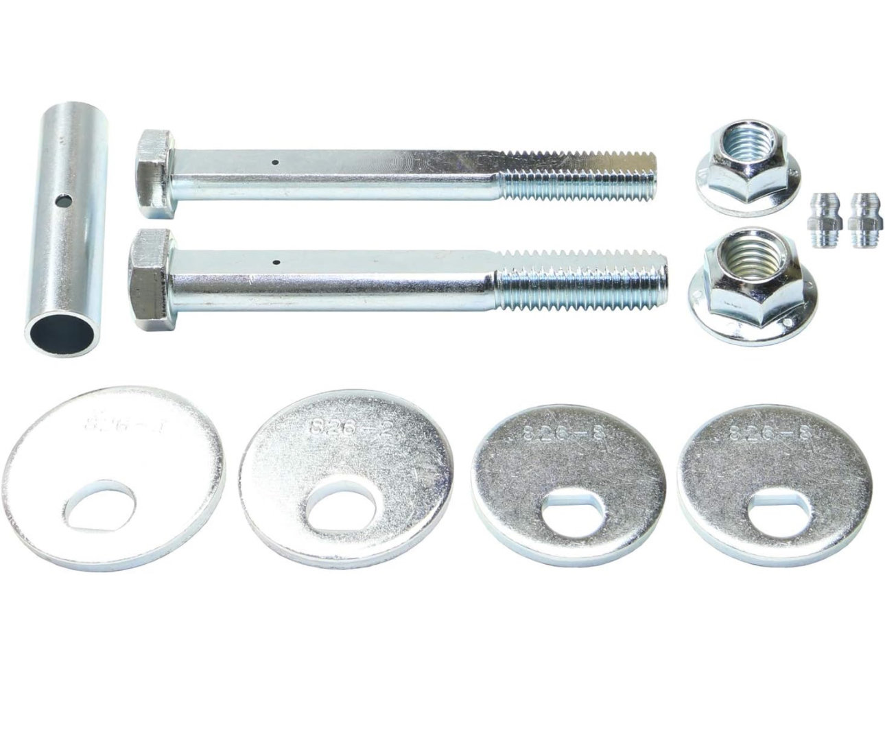

    BEST ALIGNMENT CAM & CAM TAB UPGRADE KIT× 1
    • KIT: OCTAGONS, BOLTS, AND CAM TABSIMG_9055.jpg

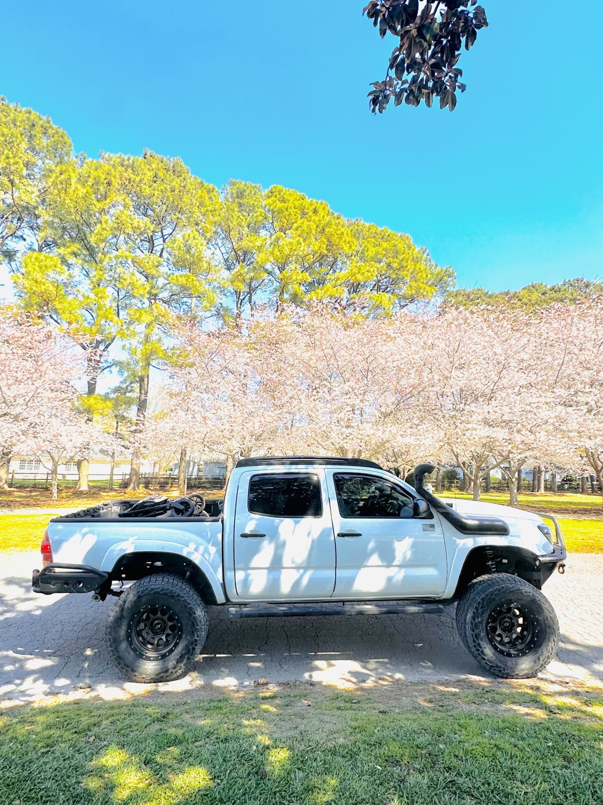

    4" Fabricated Lift Blocks - MaxTrac 810040 and
    2wd/4wd U-Bolts For 3" & 4" Lift Blocks - MaxTrac 910104 with
    2wd Carrier Bearing Spacers & Brake Lines Brackets - MaxTrac 616800
    This is how he sits now

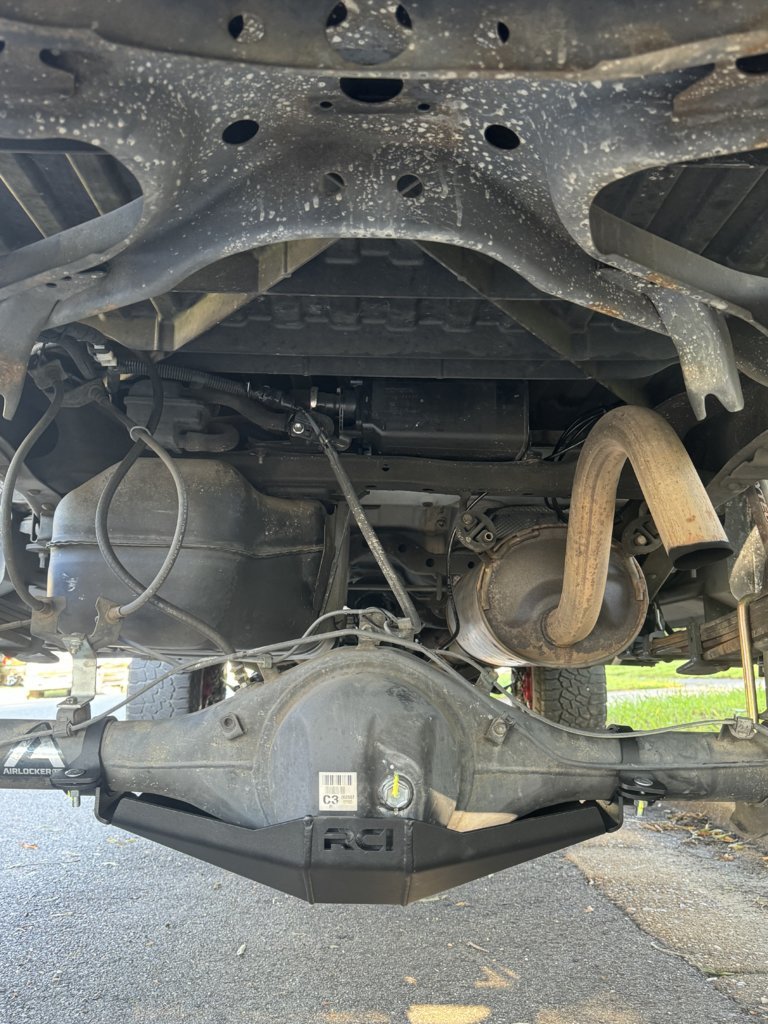

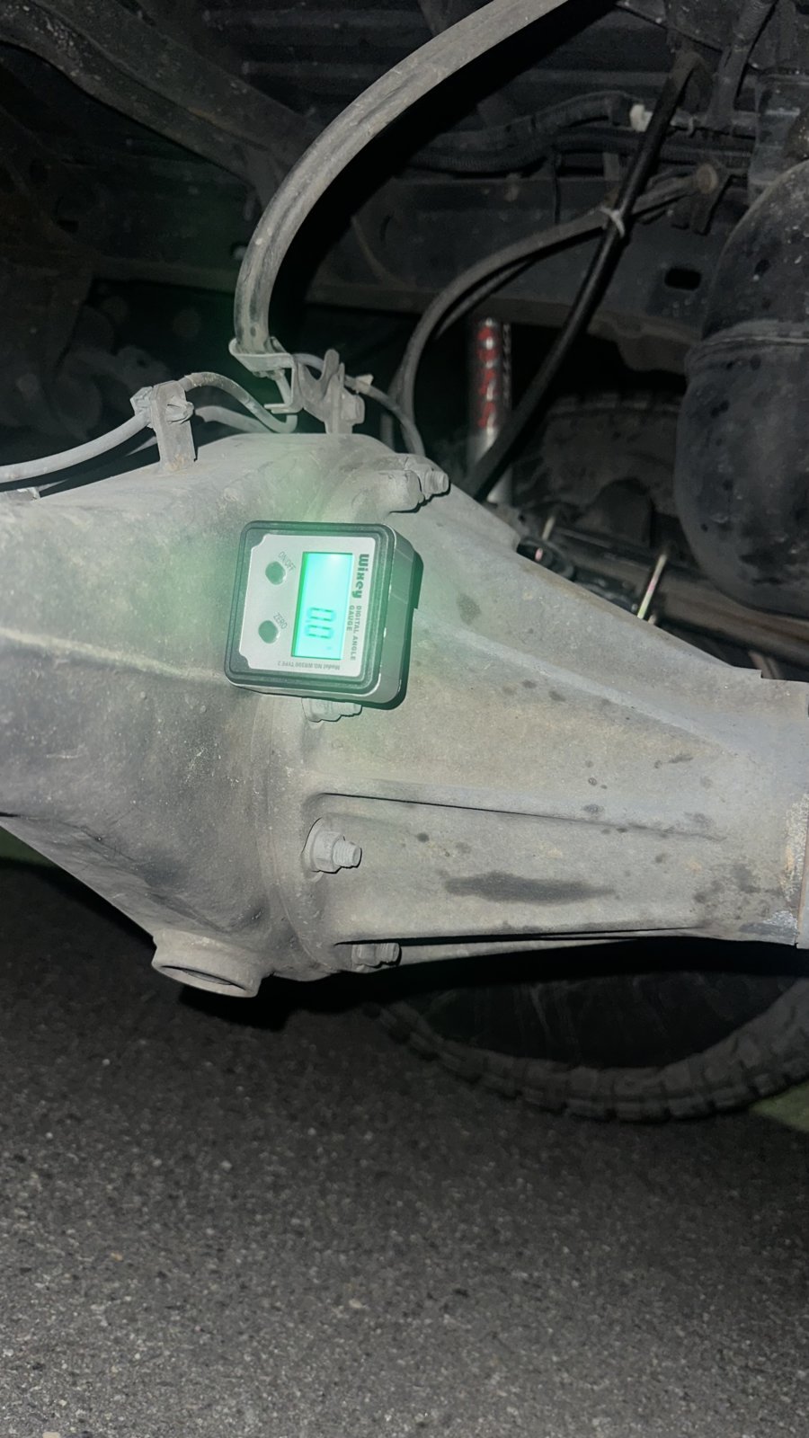

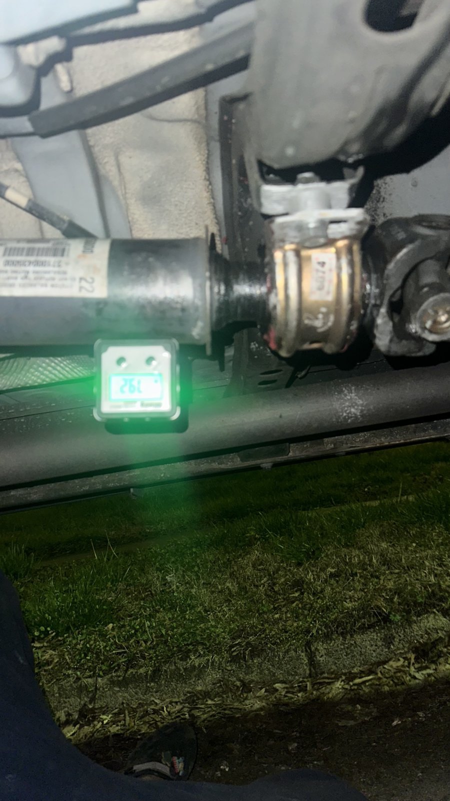

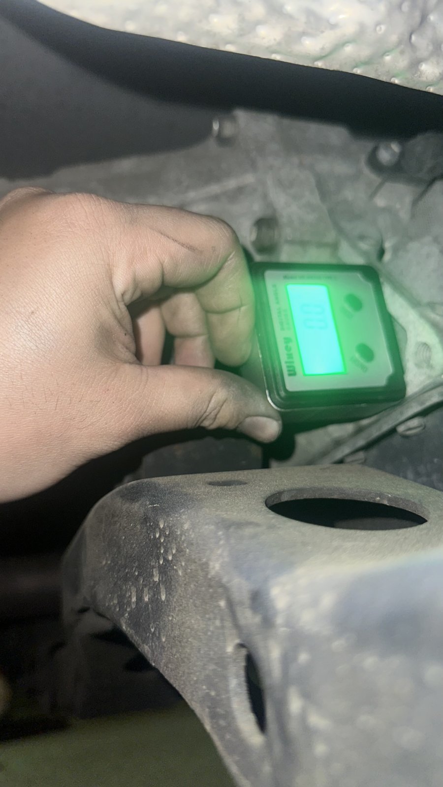

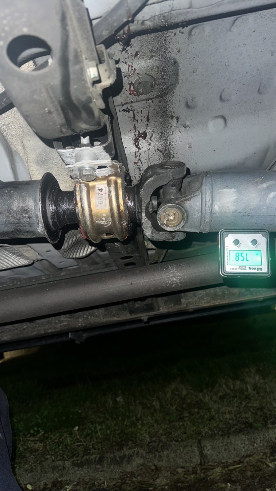

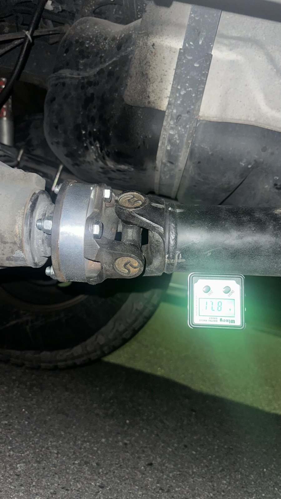

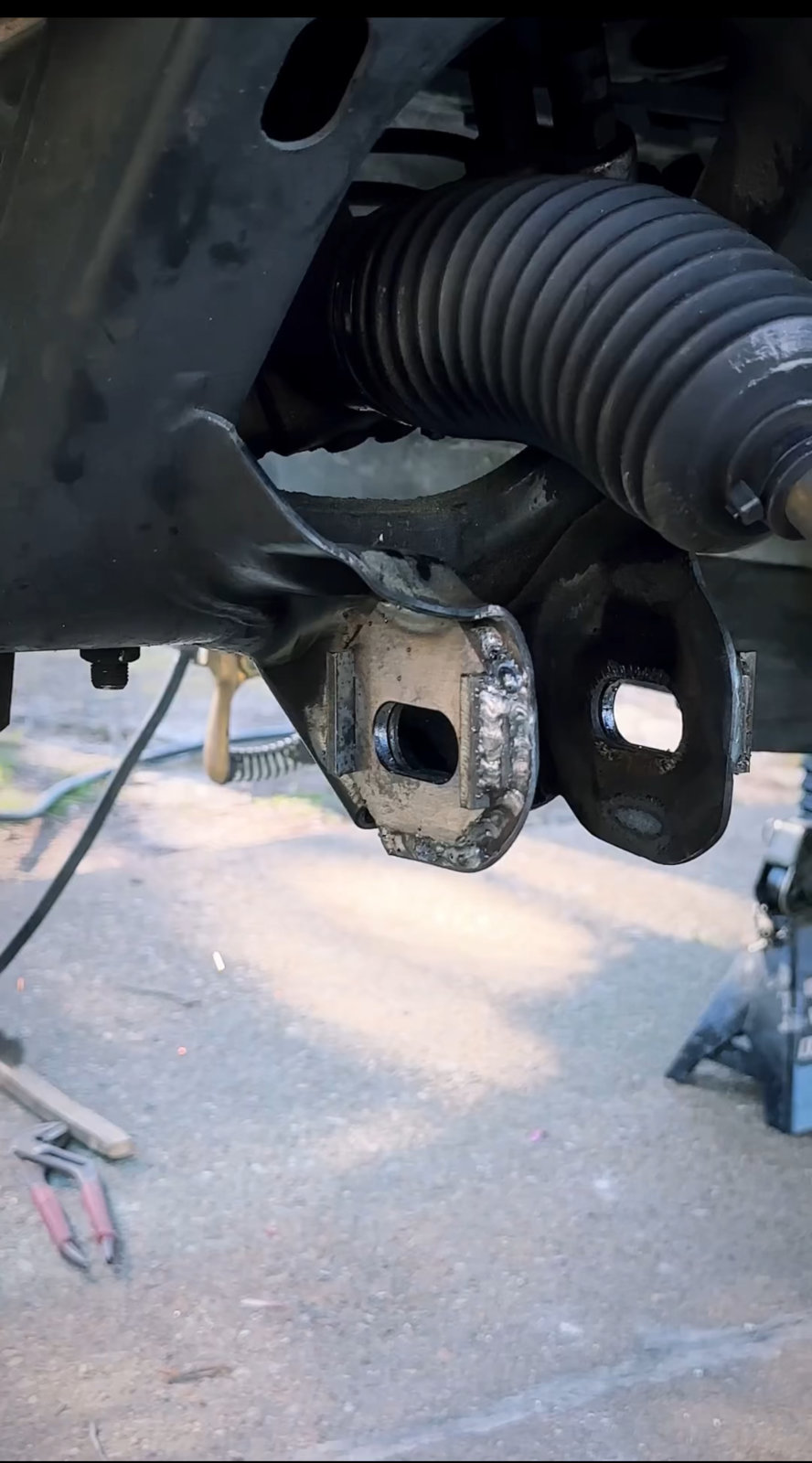

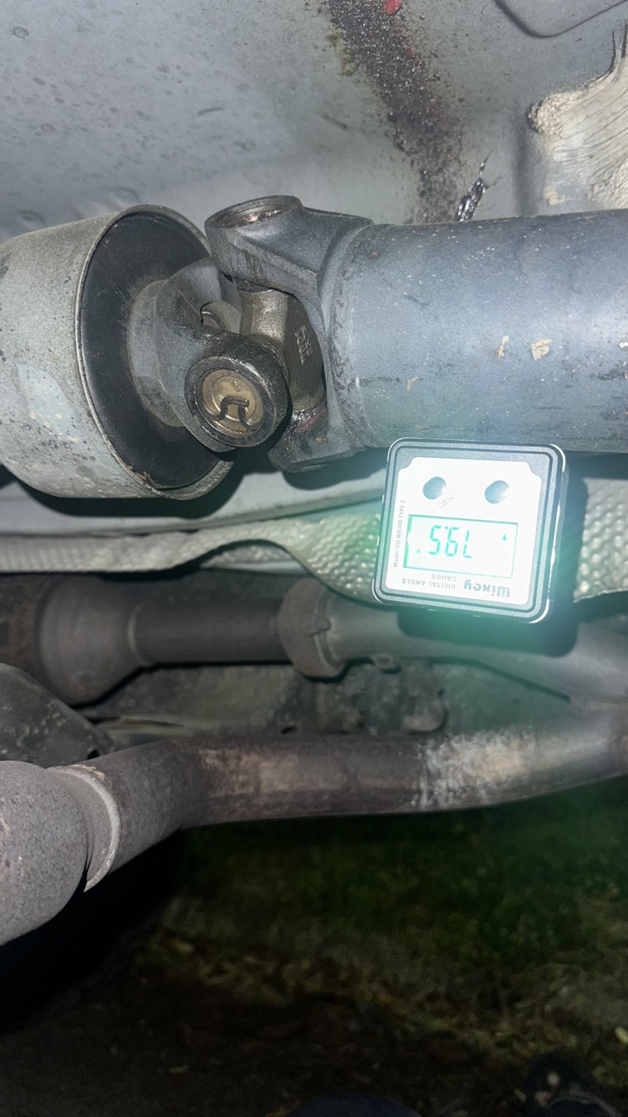

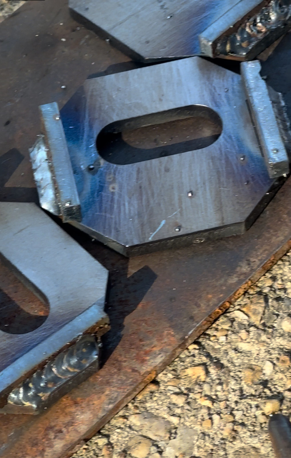

    Installed the Maxtrac 4” leaf spring spacers, 4” U bolt, Needed 1” spacer on the drive line because its pulling away from the trans and creating vibration and slipping then replaced all my cam tabs adding pics along the way follow my instagram for more daily updates archive_tacobenIMG_9882.jpg IMG_9883.jpg
    measure the angles of the driveline
