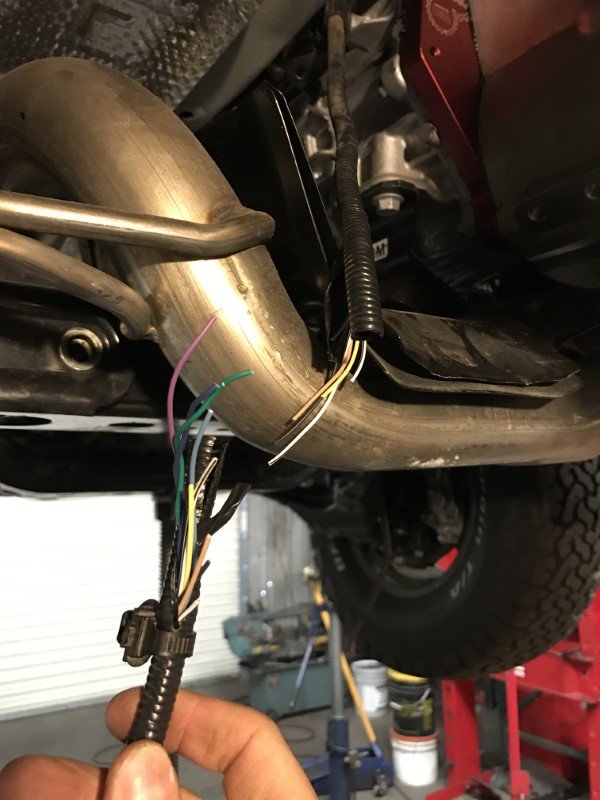

    Note for my previous reply: I got interrupted 100+ times here at work while composing and had to edit numerous times to get my thoughts straight :p
    Thank you for the question. The answer is that those have always been left up to the installer. We do have plans to *finally* update our instructions hopefully sometime this summer, but normally experienced installers are the ones doing the job.

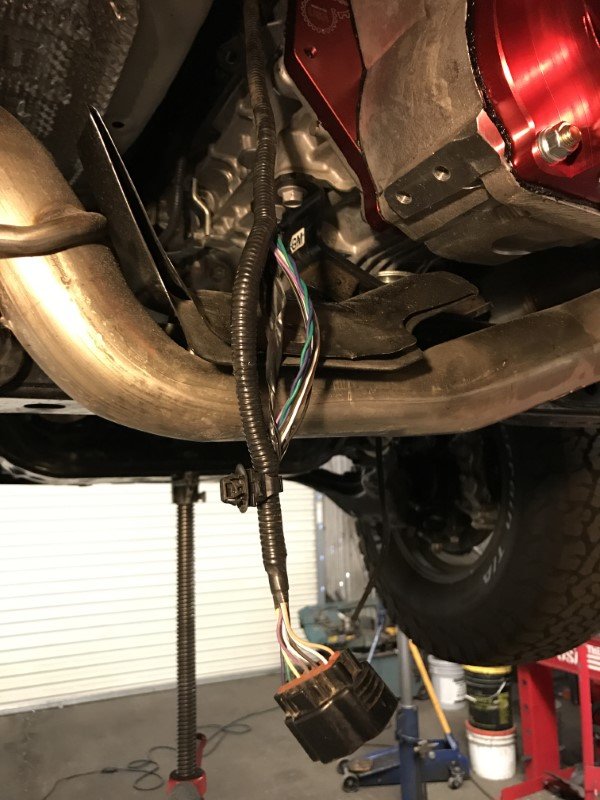

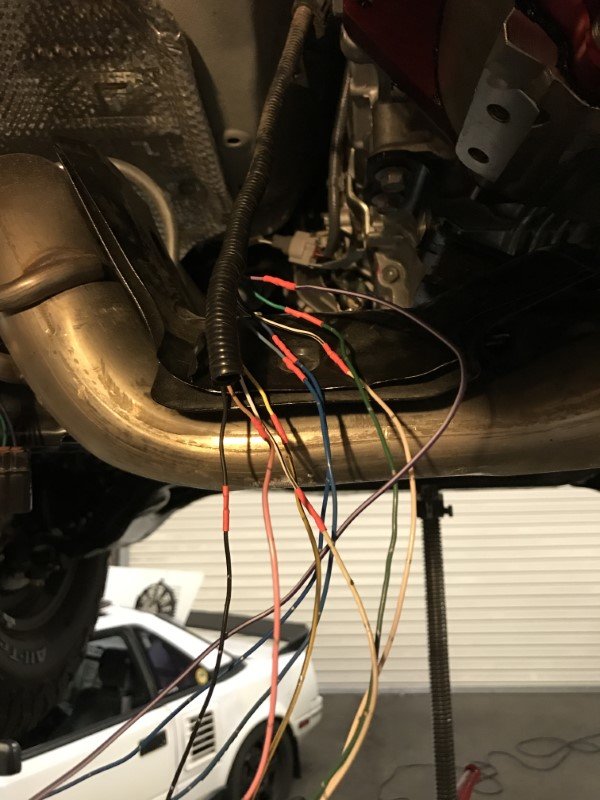

    Wiring
    For wiring, it is a process of cutting and manually lengthening each wire. Granted, this was a piece of cake in the past where we only had 1 wire for early and 2 wires for late model Hilux pickups and 4Runners (4WD light indicator), whereas today we have electronic shift solenoids that can have as many as I believe 11 in AWD Sequoia, GX470, and V8 4Runner installations. For a 3rd gen V6 (pictured) this is a matter of lengthening 9 wires about 10-inches and then covering with new wire loom. (For my setup I lengthened them about 20-inches since I am running Triple Transfer Cases (no one needs to do this)):

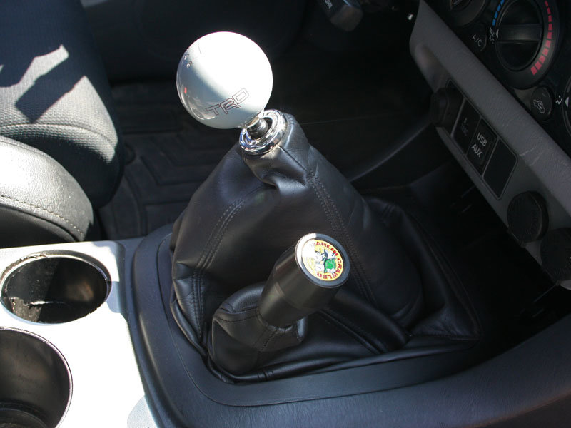

    Shifter
    The Shifter setup is a currently custom built to the customer's shifter location/preferences. It can be made very nice, it just takes a bit more time and effort. Our No.1 TacoBox installed is Rock Solid Toys in SoCal (RST, http://rocksolidtoys.com) and they do a really nice job on the shifter. Here are a couple photos RST has installed into 2nd gen Auto & Manual and I have photos from 3rd gen Installs, also both Auto & Manual, but I can't find them at the moment but will reply back once I do.
    As you can see the automatic setup requires modifying the center console at the expense of sacrificing either your coin slot or alternatively cup holder, and the manual is much less intrusive and we're able to mount the shifter in the same area as the transmission. We have looked into a remote Cable-type shifter or push-pull, but it's been a while and we need to revisit this to try to make shifter installs more straight-forward.

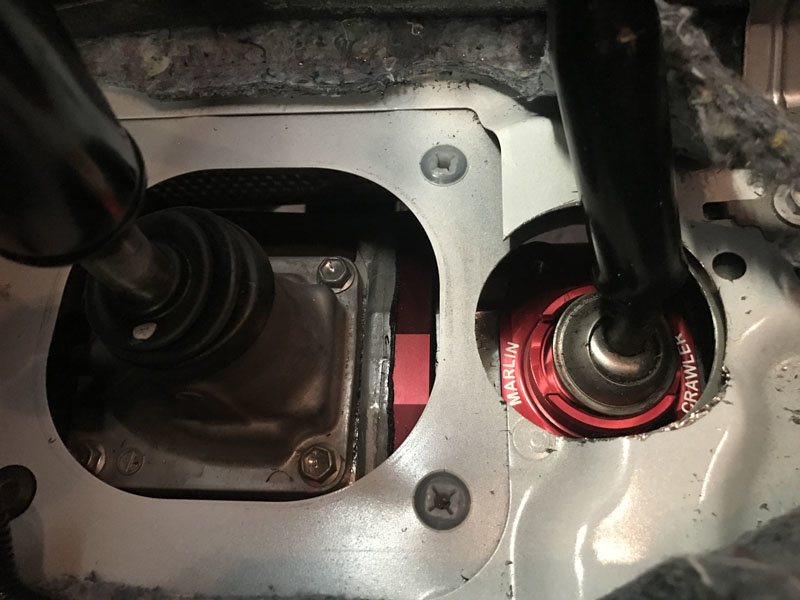

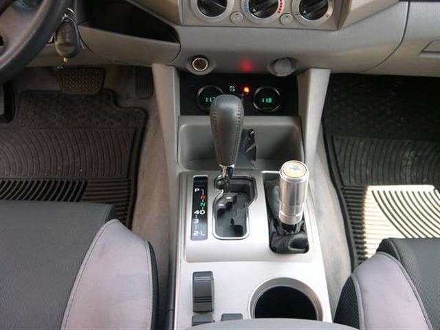

    Until I find the additional 3rd gen TacoBox install shifter photos, here is my 3rd gen/2016/3.5L V6 setup however it is very unique due to having three Low Ranges
    First shifter along side transmission is a 2.28:1 MC08 Hilux-type Unit
    Second shifter in cup holder is a 4.70:1 TacoBox Supreme Unit
    Third shifter.....doesn't exist :D I decided to keep my electronic shifter (located on the dash) which so far has not given me any grief (I avoid sand and mud because this is a Rock Crawler)
    At the end of the day I was able to have Triples while retaining two cup holders :)

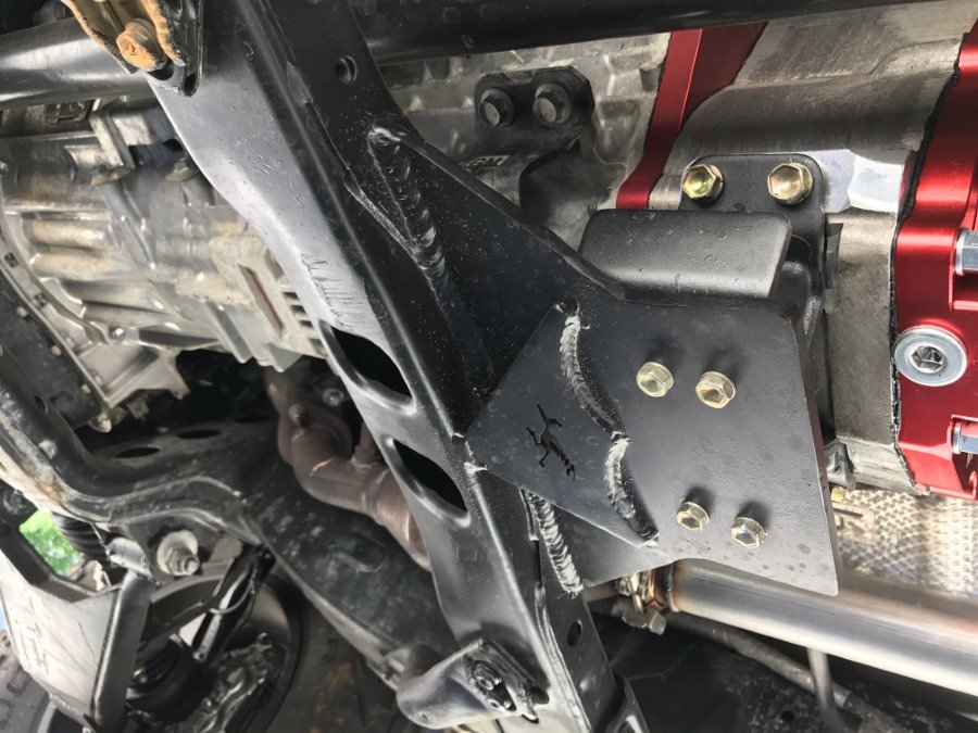

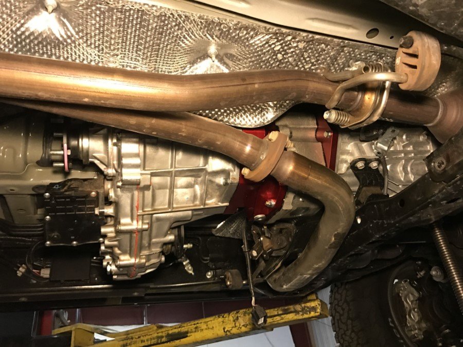

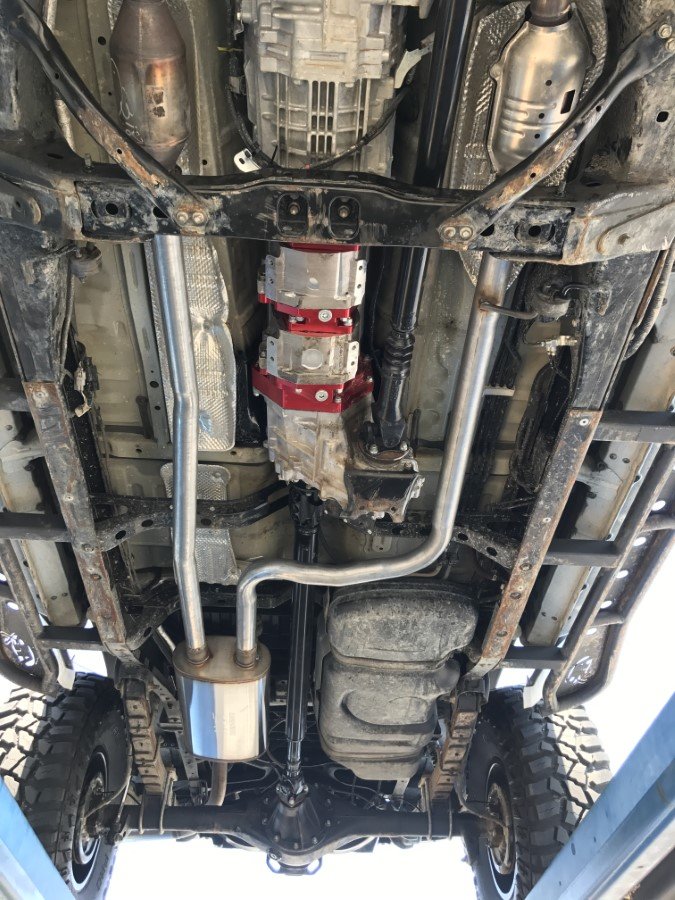

    Yessir you've got it all correct! The TacoBox includes the option of adding a second t/case mount which helps prolong the life of engine mounts. This is not required but is recommended. As for offering a crossmember, we see the market is fully saturated with full-length skids so we don't want to touch that.
    Because I have proper gearing for Rock Crawling, I am not running any skids at all, not even a front skid. I do of course contact and scratch my underbelly, and I am both (1) not-concerned because I am going slow enough to cause only cosmetic damage and (2) I am concerned that we have such little precious ground clearance under these huge trucks it's ridiculous how anyone can even add skids and then try to do highly technical trails without being hug up and high centered on hard lines. For example I don't know of many IFS rigs doing technical Rock Crawling with 40" tires like myself and yet even with 40" tires I often run out of underbelly ground clearance. The facts are undeniable: These trucks are so large that for the same height and sized tires, they have at minimum 9-inches less ground clearance than a 1st gen Hilux. Same over height, same size tires. Nine inches less ground clearance. Un----believable.
    So for (2) I am going to *eventually* design a proper Rock Crawling Tacoma Cross-member that gains AT LEAST half a foot of underbelly ground clearance and incorporates a full-length skid ......it's just that it's wayy down on my priority list at the moment. My truck is currently at 70% of my vision and by this summer it will be in the 90-percentile range which means the time for doing silly things like light bars and skids will be nigh! This Rock Crawling Tacoma Cross-member, however, will require permanent frame modifications due to how Toyota integrated the t/case skid plate which is not the same as your 3rd gen Pickup. More on this later.
    Reference Images:
    When I had our Dual Case TacoBox installed, everything fit as designed with zero modifications to the factory crossmember and exhaust cross-over pipe.
    The same also applied for later when I switched to Triples. No cross-member or exhaust modification needed:
    ...but of course that cross-over pipe is really dumb so I did a proper custom cat-back exhaust with dual-in single-out MagnaFlow 12580 muffler which I am very pleased with:
    Lastly, the Triple setup added ~40 lbs to the drivetrain so running Dual T/Case mounts was only natural since the TacoBox has the mounting provision for this just begging to be used, and I did so doing the same thing which I think you have in mind. It was very easy and also effective. For me I could even install a Third t/case mount as well but I don't think it's needed:
    Cutting the hole, at least for my 3rd gen AC was more difficult than in older trucks due to the cab having multiple layers that are also on different planes. I broke a drill bit getting the hole saw positioned just right but overall it wasn't too bad! Have a small vacuum handy because those shavings fly all over

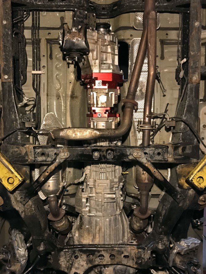

    Found one image I was looking for, and as promised here is the picture of our TacoBox in a 2017 3rd gen manual by Rock Solid Toys (https://www.rocksolidtoys.com, Southern California). Please note that RST is helping with a set number of manual installs and is not doing any more 2005+ 6cyl manual applications until further notice.
    Manuals are definitely the cleanest to install and truly looks like they came this way from the factory!
    Shifting the TacoBox is preformed at speeds 5 MPH or less and is a simple 3-position linear pattern as follows:
