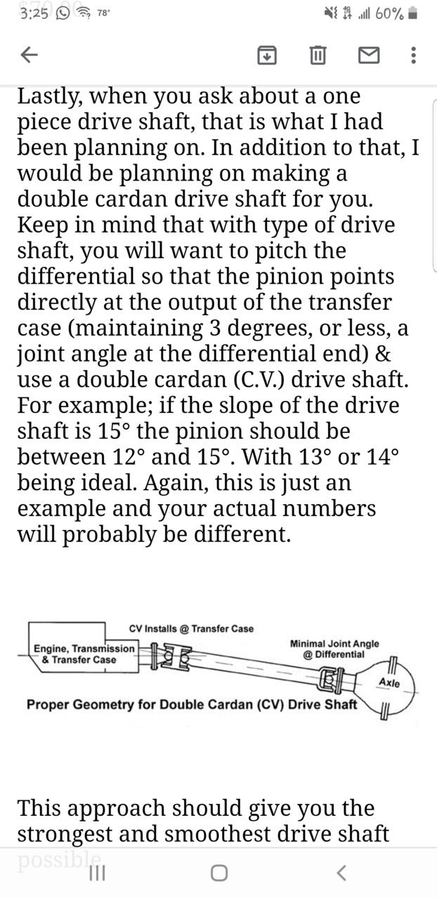

    I spoke with TW and his suggestion was a one piece shaft and he would be building based on the 1350 (beefier) vs 1310. I guess for what it is because i plan to regear at the same time, so it will already be out of comission so:popcorn:. Part of the feedback is below
