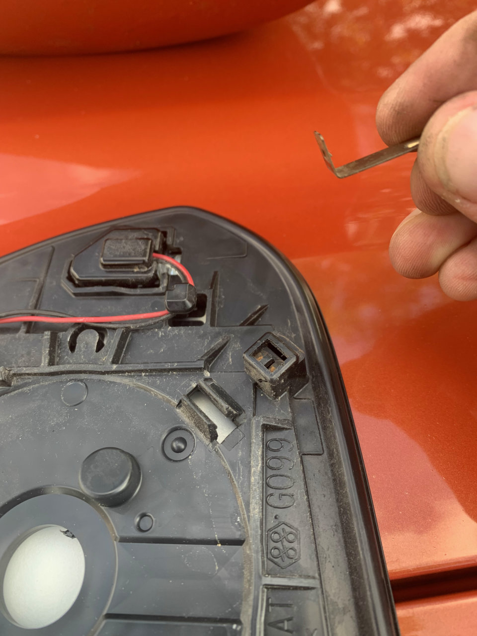

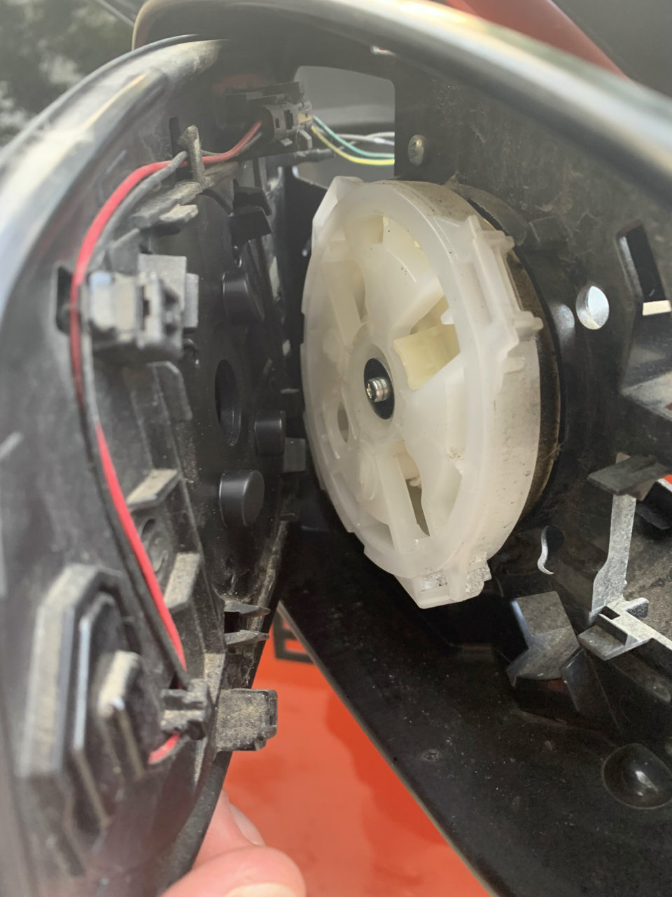

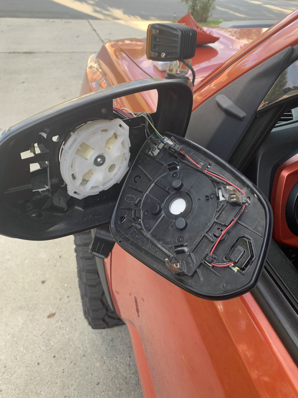

    Remove old mirror. Using a flat headed screwdriver, carefully pry and push 2x metal clips toward rear of truck / back of mirror.
    When space on mirror side, grip edge of mirror with fingers. Reach through rear of mirror housing and push on opposite side of mirror with even, moderate, pressure to pop clips on back of mirror off the attachment points on the mirror motor assembly. See picture for an idea on what the attachment points look like.

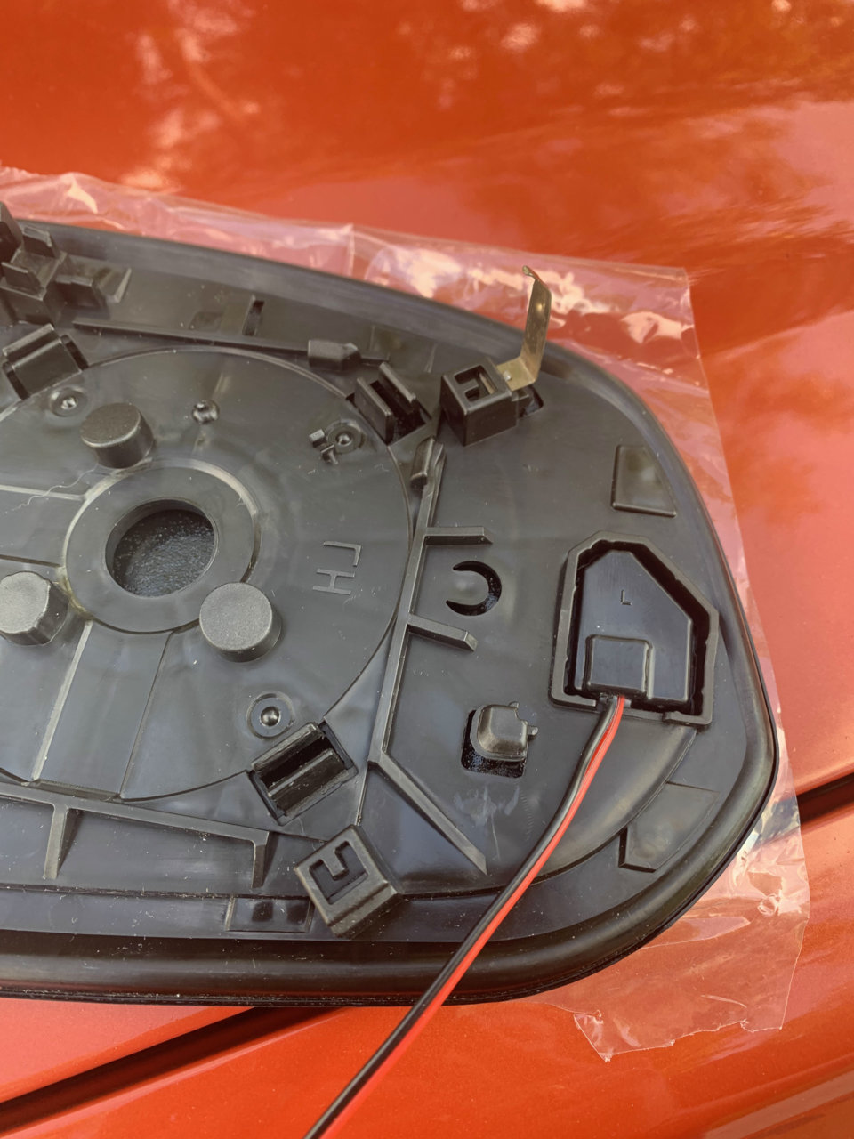

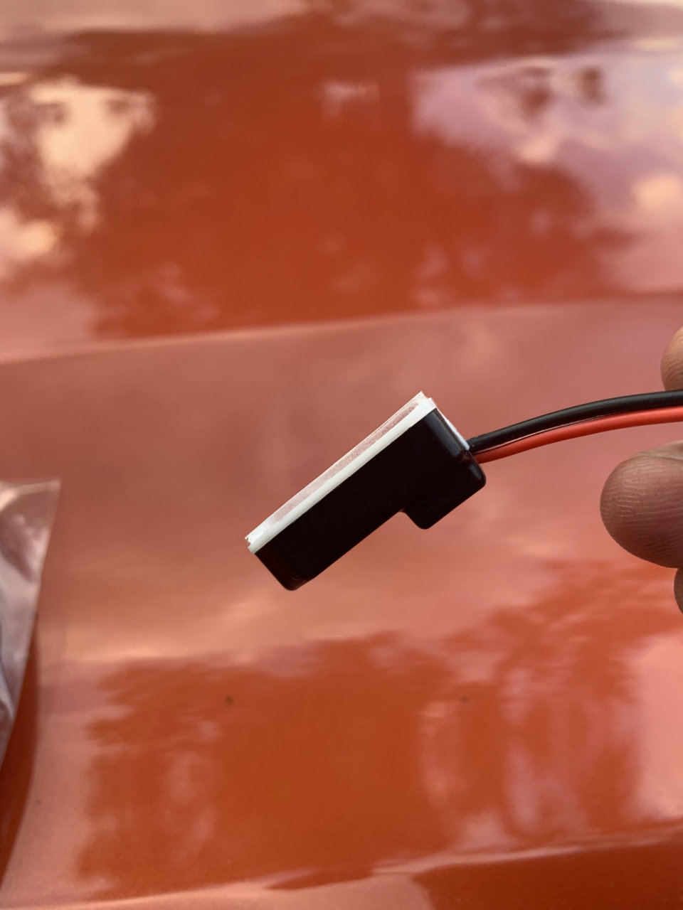

    Find correct new mirror for corresponding side of truck. If using BSM indicator, remove plastic film from front of indicator for the mirror being worked to expose adhesive. Place in mirror and press firmly to ensure adhesion.
    Step 6a:
    Remove metal clips from old mirror.
    (on mine, these were only on the driver's side)
    Step 6b:
    Attach to new mirror in same attachment points.
    Step 7:

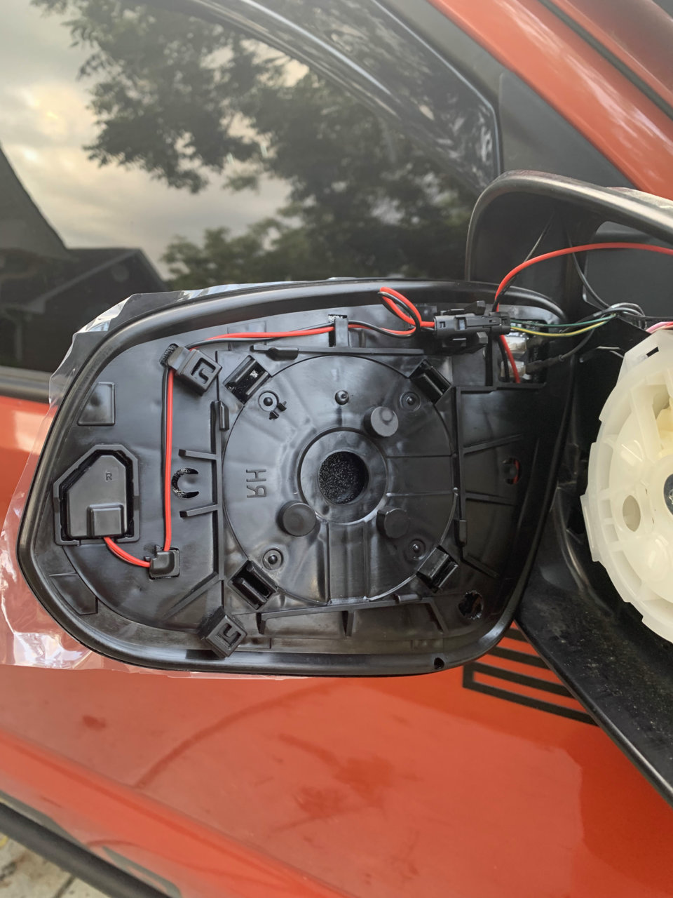

    Plug in wires. Route BSM wire around mirror motor assembly attachment points using the integrated retention clips.
    Step 8:

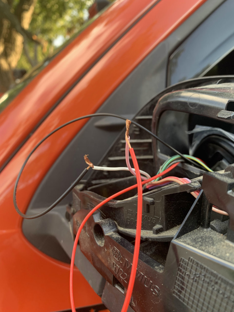

    If new mirror has integrated turn signal, pass wire through mirror housing toward front of truck.
    Step 9:
    If new mirror has integrated turn signal, splice wire leads into wires for factory mirror turn signal. Black to white, and red to pink-ish. Do this however you prefer to splice.
    Step 10:
    Carefully install new mirror on mirror motor assembly attachment points (see removal photo and below), ensuring wires are between attachment points and outside edge of mirror to prevent wear or binding. When installing mirror, provide even pressure on mirror to prevent breaking. Once the mirror is aligned properly, additional even pressure can be provided on each corner of center of mirror (recommend using thumbs) to seat clips onto mirror motor assembly attachment points.

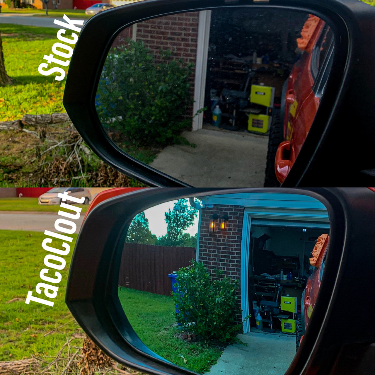

    Before / After:

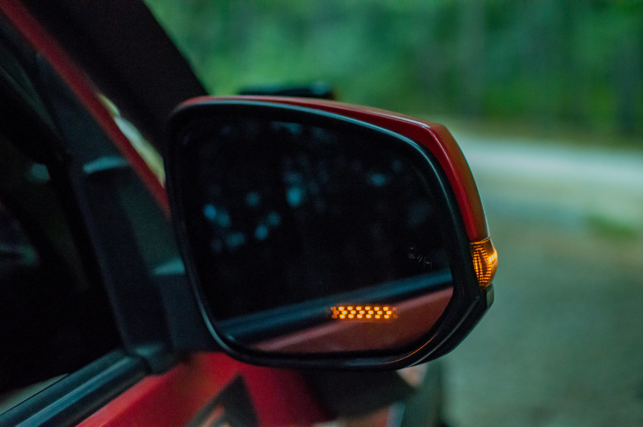

    Sequential Turn:
    BSM:
    My thoughts: I love them. The field of view is greatly improved, practically eliminating the blind spot and allowing view of the rear wheels. The integrated turn signal is pretty sweet too, especially since it is sequential like the rest of my aftermarket ones.

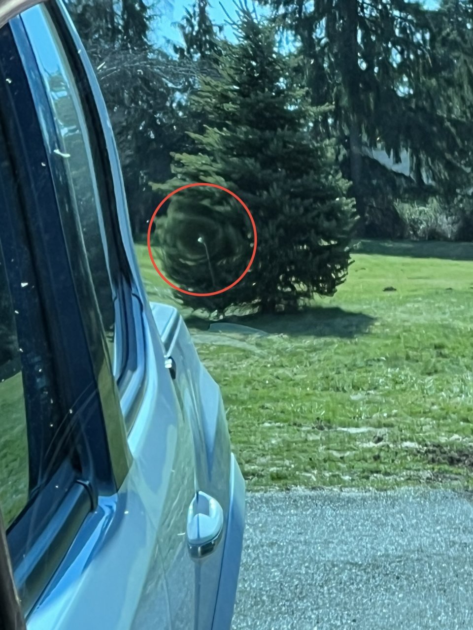

    Now the customer service story- The mirrors I received have an imperfection in the passenger side, a dimple that causes distortion.A4A6A7B0-09DA-4E7D-8C33-3F85687991D2.jpgI emailed them on a Saturday, they replied the following Monday and had a replacement set in the mail to me the following day.
