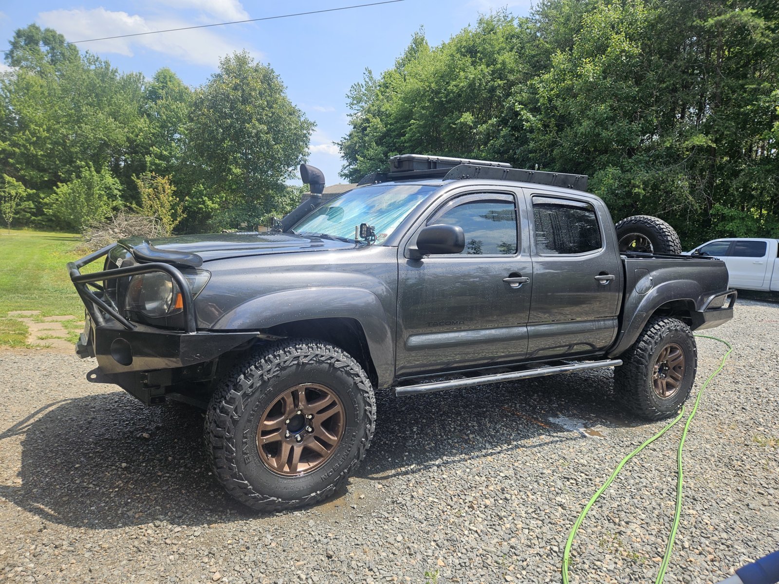

    How it sits today
    mods done so far
    susp-
    (front) King 2.5 extended travel remote reservoir coilovers
    Allpro 1.25" tubular uniball UCA's - removed
    SPC UCA's
    invisible sway bar mod
    Front Superbumps
    gusseted spindles
    rebuilt/rewelded and gusseted stock lca's with hardrace bushings and new Moog balljoints
    TC cam tab gussets
    (rear) Hammer Hangers ver. 3.0
    Archive Garage 3.6 shackles
    Archive Garage ubolt flip with speed bumps
    Deaver U402 stage II leaf springs
    Archive 2.0 shock relocation
    Fox 2.0 performance series remote reservoir smoothies
    Kartek limit straps
    Bilstein 5110 dakar leaf pack w/ second overload leaf removed, All Pro u-bolt flip kit, ATO shackle flip, XJ shackles, Superbumps removed
    engine/drivetrain-
    Home made exhaust system with rerouted crossover, Vibrant 2.5" ultra quiet resonator and Magnaflow 18" muffler using 2.5" mandrel bent stainless steel exhaust builder kit
    rerouted crossover with Vibrant bottle style resonator, Magnaflow 14" muffler homemade exhaust system made from a 2.5" mandrel bent stainless steel builder kit removed
    Airflow snorkel
    4.56 Nitro gears
    ARB air locker in rear
    Ebc stage 5 front brake kit removed
    4runner front brake conversion with stop tech slotted rotors and Hawk LTS pads
    URD Spec-U LT headers
    FJ Cruiser manual transfer case swapped in with factory j-shift
    CSF radiator with Mishimoto 160 degree thermostat
    wheels&tire-
    17" Toyota Sequoia wheels (custom color rattle can paint job) with 255/85r17 Mickey Thompson Baja Boss
    lighting-
    New HEADLIGHTS Removed
    Retrofitted (done by @Coot83 ) FXR's with 5000k lamps and morimoto ballast kit
    OLD HEADLIGHTS Reinstalled
    MGMHLM (done by @TacoAlaMode)
    PIAA Xtreme white headlights
    Nokya 2500k fog light bulbs with amber laminx film on stock fog housings removed
    Diode Dynamics SS3 Pro fogs in selective yellow
    Baja Designs amber Squadron Sport in driving/combo pattern
    @tacodane led rock light strips
    Fish eye style LED'S mounted in the front bumper wings and rear bumper for rock lights
    Additional fisheye LED'S and cheap horizontal Amazon LED pods used in bed rack for toolbox/bed/tailgate illumination
    other-
    satoshi'd grill (courtesy of @TacoAlaMode) with 70's LC emblem
    DeeZee 37" black chest style toolbox
    ImMrYo Rear-view mirror lift bracket
    Ultraguage with transmission temperature program
    Weathertech bug deflector
    Weathertech digifits
    Weathertech window visors
    SS ext brake lines(front & rear)
    Redline hood struts & tailgate ez-down
    diff breather relocate
    @rcbs204 4x4 illuminated switch (removed bc no more switch!)
    fake leather seatcovers front and rear
    Mag light mount
    Cobra 29 lx cb with 3' Firestik II antenna
    OEM roof rack (removed for a homemade/copy of a knock off prinsu)
    color matched engine cover
    homemade hi-lift mounts utilizing bed track system
    CV boot slide mod
    KB Voodoo tailgate cap
    @ruggedT side Tacoma badges and custom sized Toyota on the tailgate
    KB Voodoo side rail caps
    Cab mount chop to more than clear 34's
    @Iggy. Switch panel with OTRATTW switches
    @Mobtown Offroad tailgate skin
    Custom/homemade bedrack with CVT hybrid series Shasta with extended fly and annex rtt and ARB 4ft awning mounted
    Sound deadening installed in all 4 doors, floor and rear wall
    Soundproofing foam now installed on all doors, floor and rear wall
    Kicker CS speakers in rear doors removed
    JL C2 speakers in rear doors
    infinity reference components removed
    JL C2 components in front doors removed
    Focal PS 165 Flax EVO components in front doors
    Alpine power pack amp
    JBL BassPro Nano 6" Powered Subwoofer
    Kenwood excelon head unit removed
    Dasaita Android 13 head unit
    Custom Clazzio leather seatcovers
    Custom leather flat bottom steering wheel
    Blue Sea aux fuse block with 150 amp breaker and common connection point auxiliaries. Also 2 waterproof relays.
    Run Cool aluminum hood louvers
    body armor-
    Relentless ifs skid
    Relentless transmission skid
    Relentless transfer case skid
    Brute Force Fab plate bumper with factory fog cut outs and Now with multi hoops and winching reinforcement plates
    Custom/homemade HC rear with swing out and 16 watt pods for reverse lights and relocated back up camera with the @Pelfreybilt bracket now with full length tube frame added to the swingout to support a homemade jerry can holder and fold down table/cutting board
    Custom sized/self made sliders with kick outs.
    recovery gear-
    Engo SR12000 winch with @SoutheastOverland amsteel blue (in charcoal gray)synthetic line and factor55 flatlink E (solenoid box relocated to passenger side fender wall with upgraded 1/0 wire, wireless remote wired in solenoid box, on/off switch for remote receiver wired in cab to prevent accidental winch movements)
    Smittybuilt snatch block
    60" Hi-lift
    Trail Shovel
    3 1/2 lbs single bit axe
    8lbs short throw sledge hammer
    (2) 3/4" ARB shackles
    (1) 7/8" Crosby shackle
    12 volt Harbor freight high volume air compressor
    3"x 20' Wheelers recovery strap
    3"x 12' Wheelers tree strap
    7/8x20' @SoutheastOverland Kinetic Recovery rope
    @SoutheastOverland CV axle puller
    Accu gauge EZ deflator
    ARB CKMA12 compressor with the inflate kit installed in toolbox
    Self sourced 10lbs CO2 tank setup
    planned mods-
    A few more do-dads I'm sure. Maybe even a thinga-ma-jig or two.
    How it began -

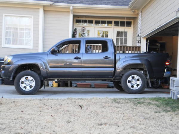

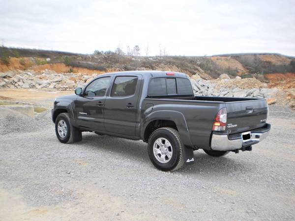

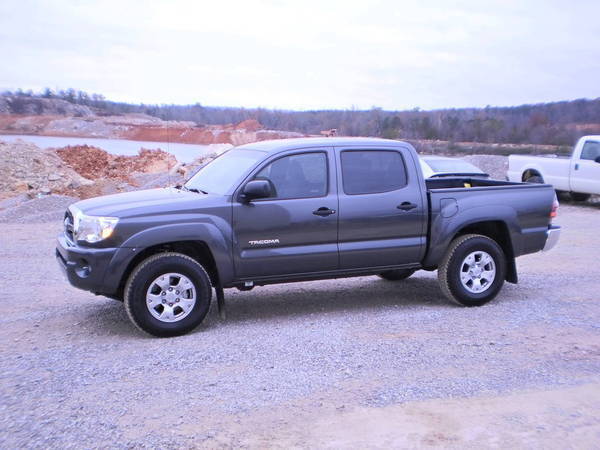

    well I got an '11 dcsb sr5 4x4 on Nov 19 and picked it up from the dealer on Nov 21.
    this is pretty much how it looked straight off the lot
    that weekend i installed my flowmaster cat back system on it.
    then a few weeks later i was able to put my lift and new headlights on. I went back to the OME 885's with the nitro 90000 shocks and LR UCA's then 1.5"aal with the OME N182 rear shocks. the headlights are just factory "smoked" trd lights. While i was swapping lights i went and put in my nokya yellow fog light bulbs and a set of PIAA Intense white headlight bulbs
    A HUGE AND SPECIAL THANKS TO TacoAlaMode and SuthrnTaco for the help with the lift install and light swap.
    Then Christmas came and I got a few presents, one from my wife and one from myself,
    (this is the one from myself Thanks Dustin from FN wheels)

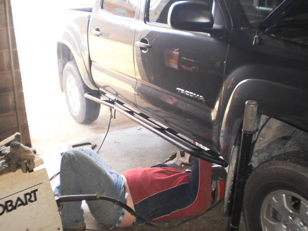

    I decided before i messed with the stuff in those boxes i needed to get what little body armor i already had installed so i went to a buddy's house and welded on my all pro sliders
    (pics are of my buddy welding not me)

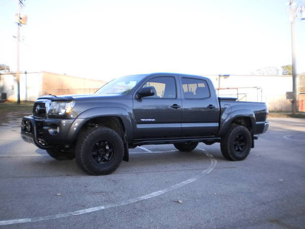

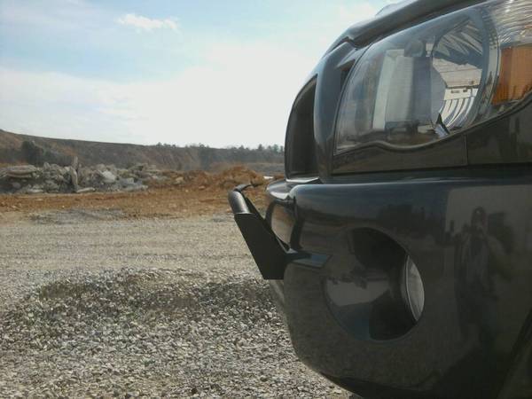

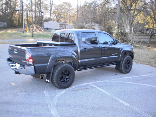

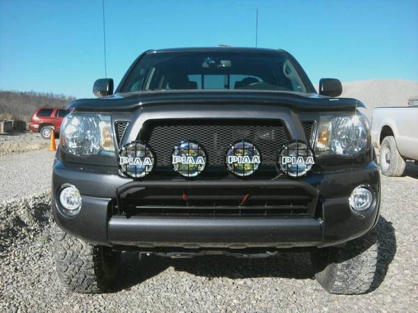

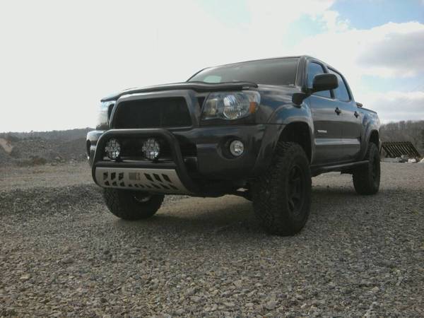

    After that i just got busy mounting everything, my bullbar and PIAA 520atp's, my weathertech bug deflector (my Christmas present from my wife and a must for AL highway driving), set of duratracs on my new wheels and the toolbox i got from Davtopgun
    so this is how she sits for now and prob for a while, wife says ive spent enough money and time on the truck for a while.....
    Maintenance notes
    Rear diff and transfer case oil change ~ 25721 (3/27/14)
    Front and rear diff plus transfer case oil change and antifreeze drain and fill 70,736 (10/29/17)
    Rear diff oil changed 75,628 (4/17/21)

    jab i plan to black out the badges next mod meet that we have. had them temporarily blacked out with plasti dip and it did look amazing. kyle said he was gonna do them "right" for me next meet. so looking forward to that.

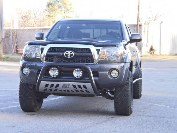

    265's and even though everyone has always said 265's will fit stock no rubbing or trimming this is the second truck i have had them on and both trucks have had rubbin issues up front. first one was on stock rims with same lift and had to get a set of spidertrax and this one rubs the mudflaps in revers starting at about 3/4 turn and will rub full turn in forward if hitting any kind of bump. no prob ill get around to taking the mudflaps off someday.
    and pnichols i am very pleased with the sliders i decided to weld them on this truck cuz i wasnt a fan of drilling holes in my frame on the last truck and dont plan on gettin rid of this truck anytime. when demodding the other truck you could actually see a tiny bit of frame flex when the sliders were off and it was on jackstands on the frame. if you do weld them on just cut out u-shaped areas where the bolts would go in the sides of the l-brackets and weld around those and the front leg and at the back of the l-bracket then it is plenty strong

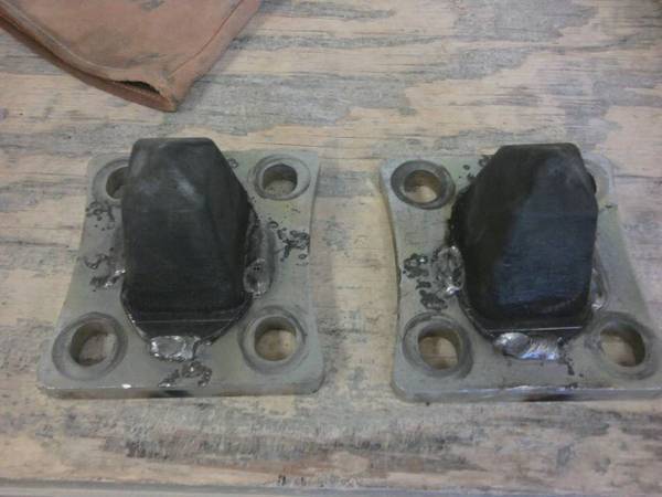

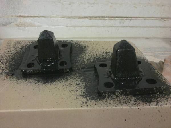

    modified and cut some stock bump stops and welded them to the plate for the flip kit so i could still have bumpstops on the back without having to give so much for the timbrens. then i decided to spray it all with bedliner to protect the welds and metal that was exposed as well as blend everything in together so it wont be quite so obvious under the truck.
    hopefully this weekend or so i will have a chance to install them as well as the front SS brakelines and rear extended SS brake lines.

    well went ahead and tried to install the all pro ubolt flip kit last night but ran into one problem after another. (man are those some strong bolts, only burnt up saw blades) gotta get them cut by a chop saw first then will put them on another day! but while i was tinkering around on the backside of the truck went ahead and installed the stainless steel rear extended brake lines. also got the satoshi put on and the holes drilled for the redline strut system on the hood (thanks again tacoalamode, gotta wait to do final install for the brackets to get back from powder coat) then finished the night off by putting on a redline strut EZdown system for the tailgate. hopefully pics of the grill to come in a little bit.
    now when i get a chance i will hopefully be able to do the front stainless brake lines and rear diff breather mod along with the ubolt flip kit (may have to wait a couple weeks and just do it at the next mod meet)

    pics of the satoshi installed
    [​IMG][​IMG]
    not the best pics cuz it was done on my phone but enough to get the idea.

    was able to get the light bar installed the other day and then installed the lights on it this weekend.
    and here is the end result.
    think i will be much happier with this bar and light setup than i was with the bullbar.
