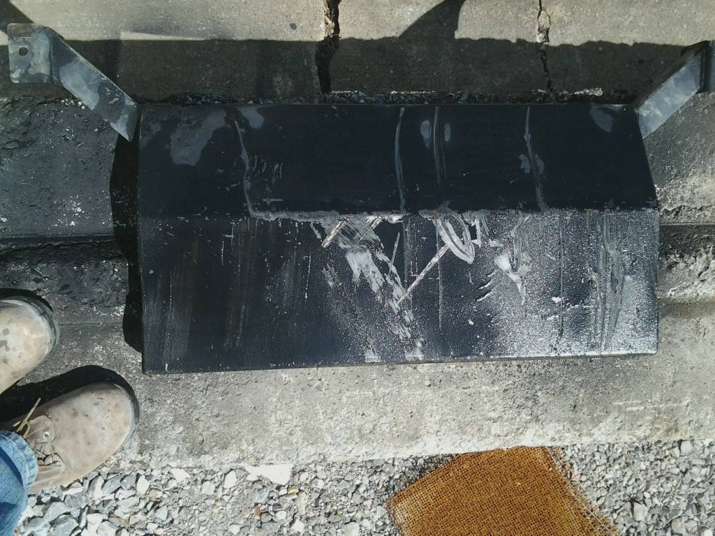

    Its bent where the arm attaches so it rubs the bottom of the transfer case. it needs bent back just a few degrees, but i dont know how to go about doing it. if i had a porta power it wouldnt take but a few minutes. but i dont, and dont know how to use what i do have to fix it.

  12. Mar 26, 2014 at 11:55 AM
    #212
    TacoFMS
    TacoFMS [OP] Bubble bubble bubble pop
    Jan 24, 2010
    #29938
    7,996
    Justin
    Louisa County, VA
    Just a vehicle to take trash to the dump
    One or two things modded... Check out the build thread
    Took the transfer case skid to work today, found the very large dent that was in it causing the rest of the tweak in mounting and the rubbing on the exhaust and transfer case itself. Pinned it down and introduced it to Mr. 8lbs sledge hammer repeatedly. At first I don't think they got along together, but after a few tries towards it, they became good friends and worked happily together. Then got my pneumatic cut off wheel out and trimmed around where the rerouted exhaust pipe runs to add additional clearance. Also decided to just play it safe and cut (2) 1/4" shims in case i need to space the rear of the skid down when re-installing it for additional clearance on the transfer case. Still need to come up with a way to cross brace the legs but i have it at least to the point where it should be ready to mount and offer as good of protection as it did before.
    pic of the skid after it was cleaned up, bedliner did pretty well because all the scratches where there is no bedliner left there is also a gouge in the metal...

    I gotta say, I think that's a bit of a design flaw. I know for sure BudBuilts and I think several other folks that make skids for the Toyota mini platforms make that a solid structural piece. Having it where it's square tube welded to 3/16" sheet, any legit force on them and it's going to deflect. There needs to be square or rectangle tube all the way across to form a true crossmember.
